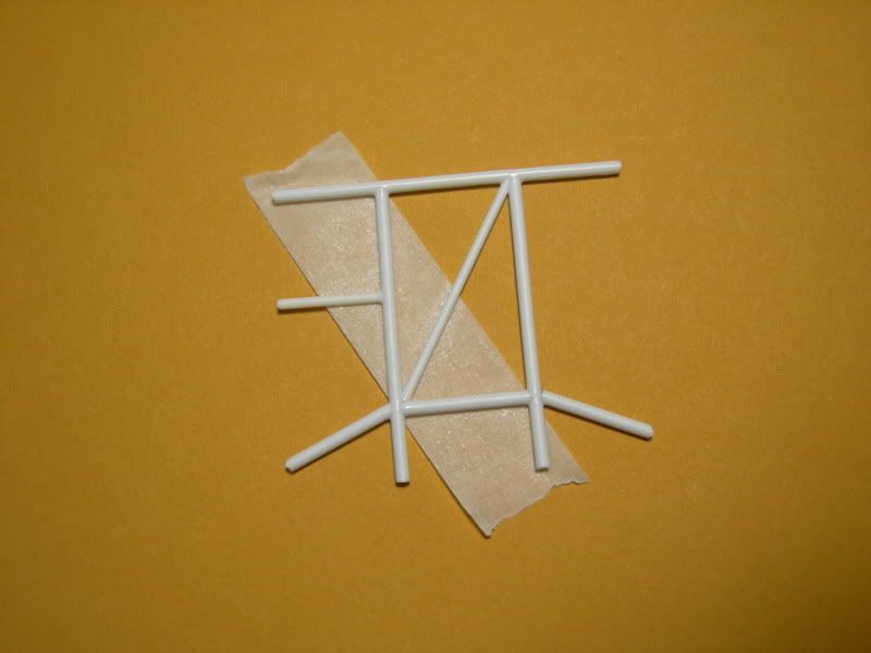

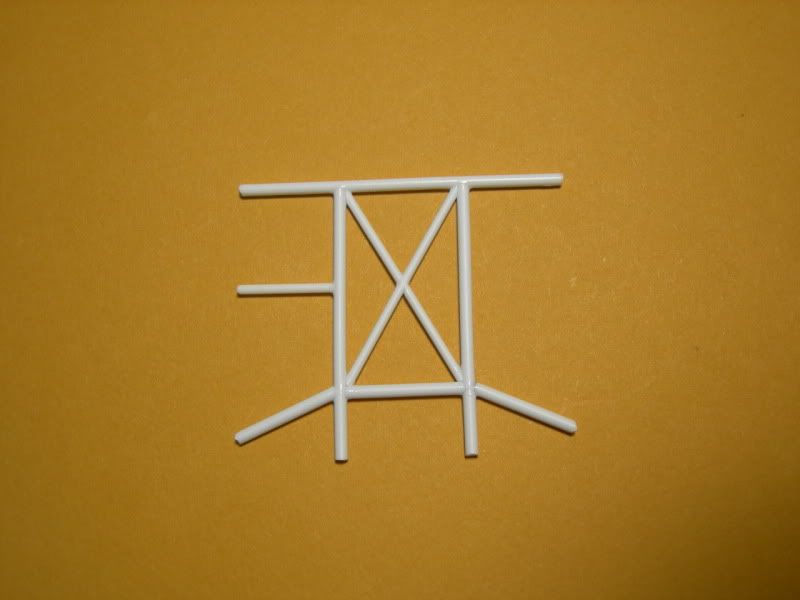

I was able to make some progress on the X-members for the central frame rail section this week. Got them finished mid-week. Wasted some styrene before I got the fit I was looking for, for the full-length diagonal. Thanks to Chris, I've learned that it's better to keep doing it until you're happy with it rather than settle...
Posted Image
As you can see above, I used masking tape to make sure I the pieced diagonals are straight. Sighting across them, I think it worked! LOL

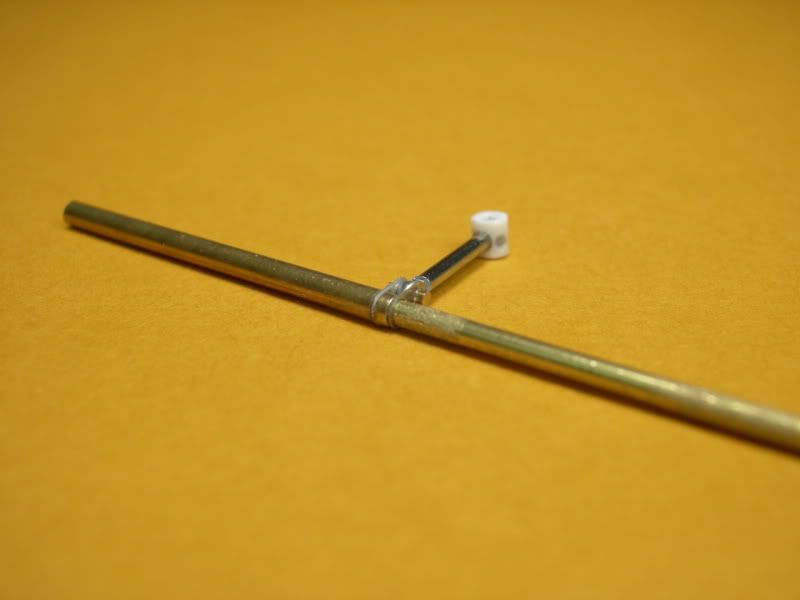

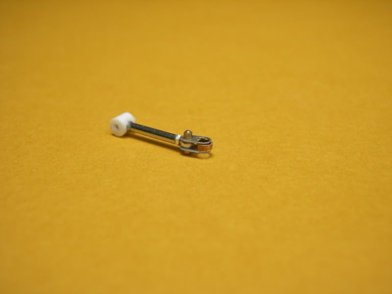

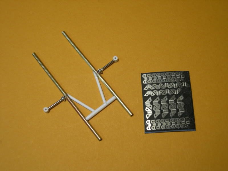

The main lower control arm is .050 stainless tubing with RB Motion 1504 rod end and nut where it will attach to the chassis bracket. .8MM brass nut, bolt and washers are from Scale Hardware. Lower strut mount is .100" styrene rod, drilled to accept the stainless tubing and provide a receiver for the lower strut mount. I cut tiny pieces of .080 brass to serve as spacers between the photo etch A-arm mounting tabs. The tabs slide over the .062 tubing and positively locate them. The width of the tabs matches (more or less) with the .080 OD of the rails. I'll have to do a tiny bit of gap filling, but it shouldn't be much.

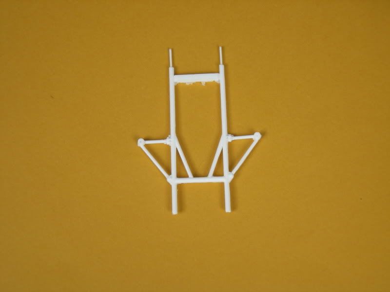

The front frame rails are constructed out of .063 brass tubing telescoped inside .080 brass. I tried to use a file to gnurl the .063 to make the fit a bit tighter. You can see where the scuffed area is.

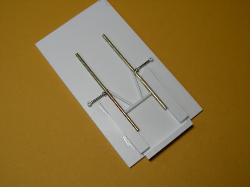

I built a jig to get the frame rail spacing uniform front to rear and to match the central frame rail section.
Posted Image

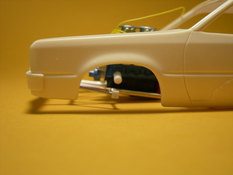

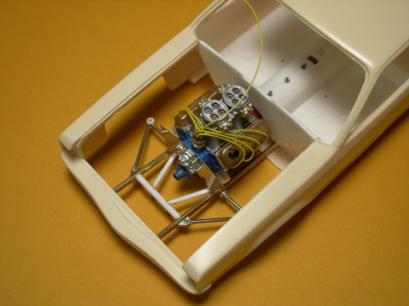

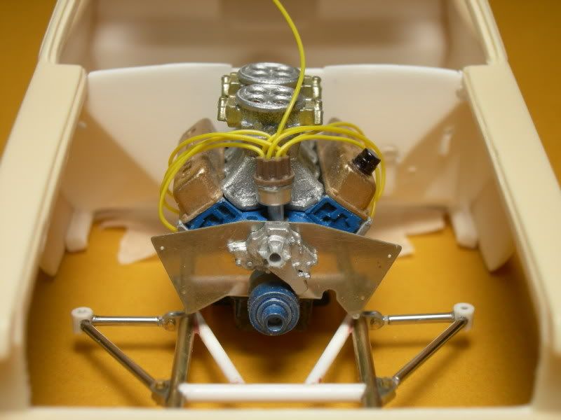

Here are a couple mockup shots under the body with a 351C setting between the rails.
Posted Image
Posted Image
Posted Image
