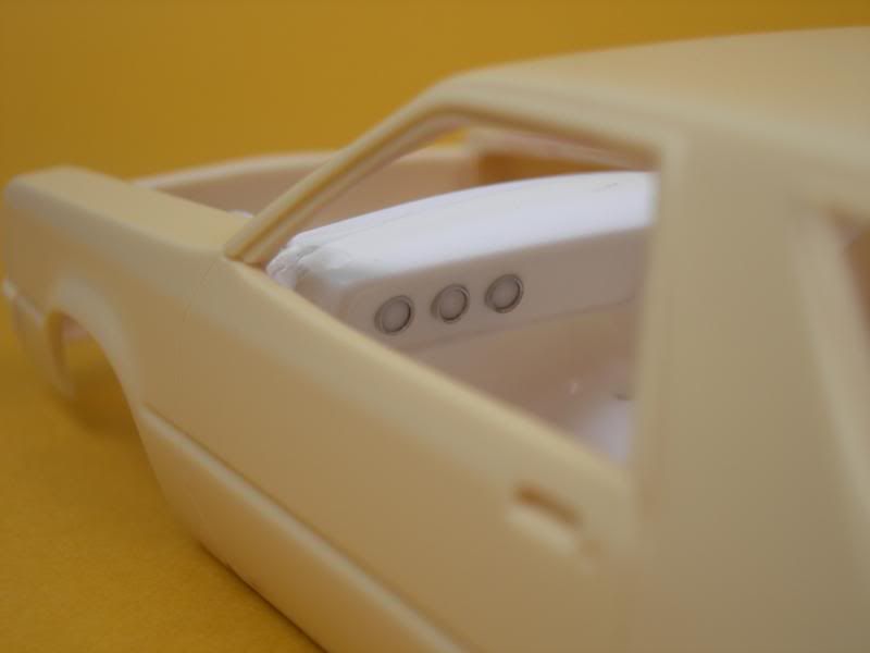

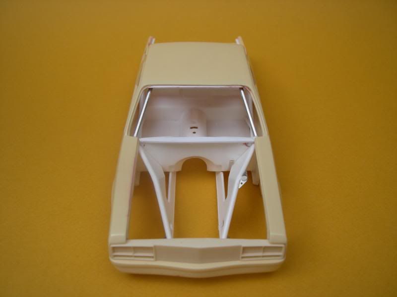

A few more pics for the night, then I won't be able to post anything for a couple days.  I removed quite a bit of material on the outboard edges of the kick-up in front of the tubs.  With the introduction of interior door panels, I am planning to make panels to fill the inside of the B-pillar down to the floor and it'll be cleaner to have one panel from floor to roof rather than fitting around that portion of the pan.
6b340b02-8c42-46a4-a9e3-55749154c36a_zps

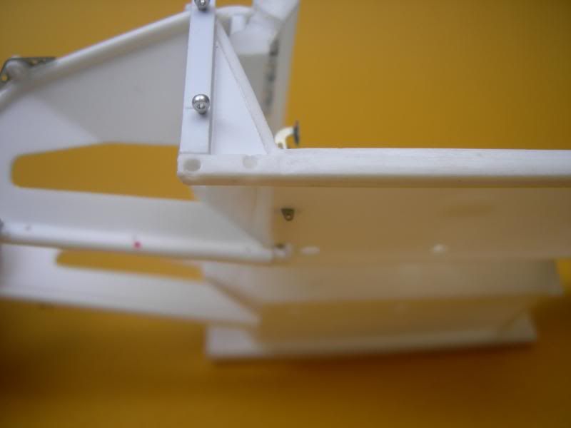

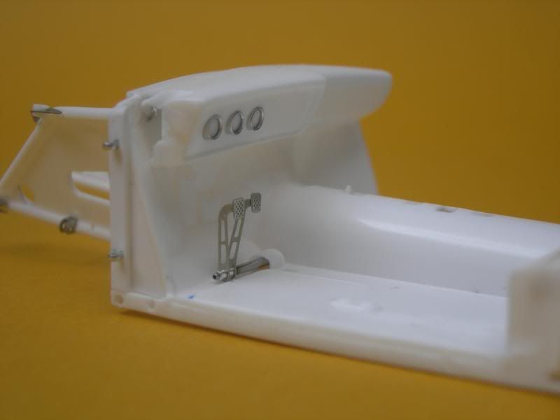

This shot gives you an idea of what the pan looks like with the additional material I added to incorporate hinges into the pan.  It also gives it a bit more of an appearance of what a firewall/bulkhead area looked like on a Fairmont body-in-white (if you stretch your imagination quite a bit).
I've also started adding framing for the trunk lid.  It will add a bit more realism, plus offer some support for the lower edge of the back window and forward trunk lid.
7c3c3b1e-4957-4f37-b451-2afbbb9f5958_zps
Here are a couple shots of door skins I've begun working on.  I chucked up a Dremel bit in my drill press and raised the bed up to where there was about a .050" distance from bottom of the cutter to the table surface.  I created a temporary stop so I could sort of control my line and "milled" some of the material away from three of the four edges of the door to make it more uniform.  There's more to do, but this at least points me in the right direction.
3851cf18-4ed5-49c6-9db3-c5ccaac07375_zps
c5de43e5-2b40-48b9-a82e-ad62ec1bcec9_zps
