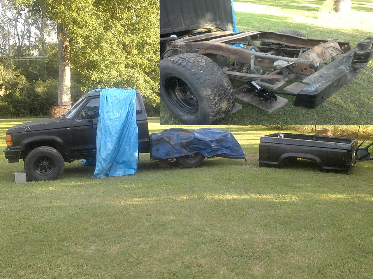

I am new here, but not to model building. I have been on a break from building for a few years and was thinking about getting back into it. I have been looking through this site and others for inspiration and ideas for future builds. Yesterday I was outside doing a little work to my 1:1 truck. A 1990 Ford Ranger Super Cab 4x4, when I started it up, I began hearing the dreadfull noise that no mechanic wants to hear. The sound of metal ticking inside the engine block. I Immediately shut the truck off to prevent future damage. I began Trying to think of the possibilities of what the noise was. I have detrmined that it is coming from either cylinder 2 or 3. I am waiting to get some money (wallet is dying of starvation) since I had just spent a good deal of money in other parts for it. When I get the chance, I am going to start tearing it down and looking into it more. I am almost sure of what it is. If it is what I am thinking is that a couple of the lifters have collapsed causing other parts to slowly wear out and cause the noises. I will have to spend a few hundered in parts because I hate taking my truck to the shop (don't trust stupid people nowadays). Hopefully, when I get the rebuild done, I can maybe get back into building models again.
Here are a few pics of the truck:
Attached File  IMG061.jpg   272.96KB   16 downloads
Attached File  IMG060.jpg   211.75KB   22 downloads
Attached File  IMG075.jpg   257.08KB   17 downloads

If the truck sat for a long time, there's a good chance you've just got a couple of stuck lifters that will free up as she circulates warm oil. 'Worn out' mechanical noises just don't start with no warning. They usually start very small and almost not-noticeable and get worse if ignored.
A noise that wasn't there and begins suddenly one day when you start the vehicle, if it's a tapping or ticking as you describe, is very often just a STUCK lifter....nothing more....and it SHOULD clear up with some gentle running and warm up.

The truck never sat up for more than a couple months at a time. And the noise doesn't go away after warming it up. I have let the truck run for about 30 minutes the other day and it never got quiter. I am going to start with small stuff and do a tune up on it such as new plugs and wires, oil change, new filters, and all that good stuff. If none of that helps it, then I will procede to start tearing it apart.
And I do know what I am talking about. I grew up in a mechanic shop. When I wasn't in the shop, I was with my dad working on his vehicles. I have learned allot more than allot of people care to. Although I am better with the V8s than I am with V6s, I still know my way around them.
