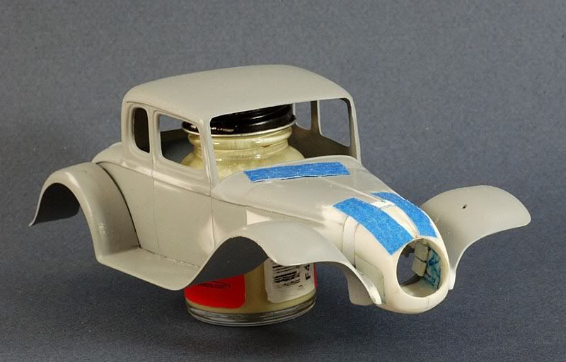

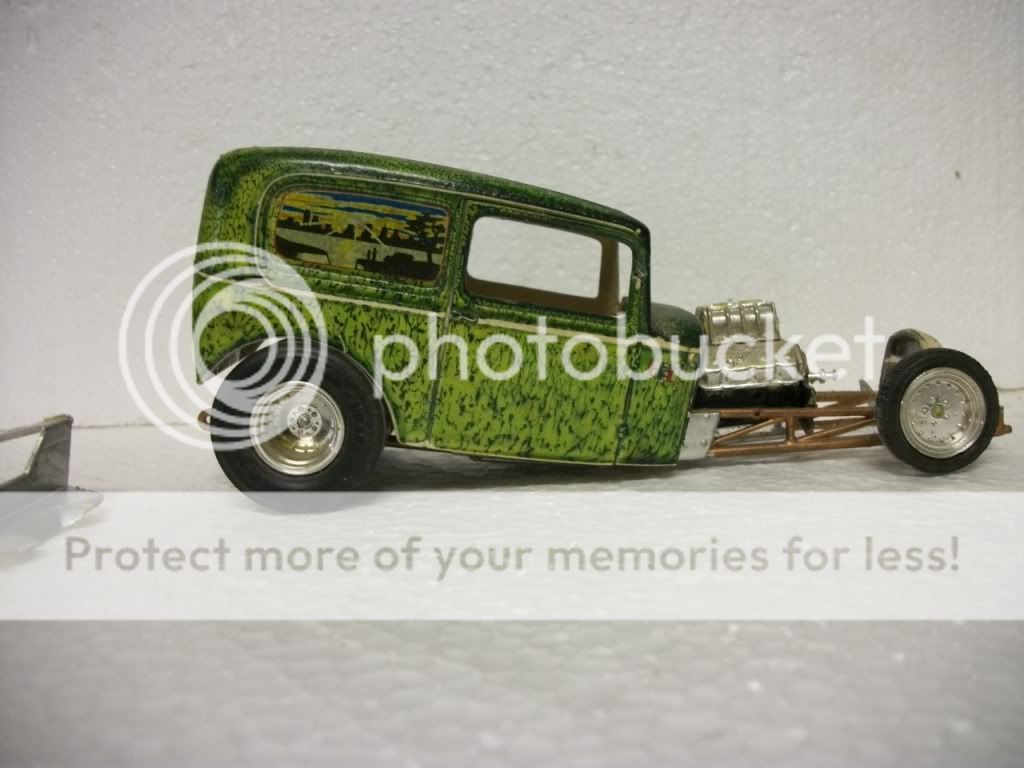

My 32 has a Revell frame for reason of access to the interior after I weld the body to the fenders, so I can't throw it into this build. I WILL be doing it in spirit though! Here's a last peek here so and you'll have to keep up with my On the Workbench build to see it progress .. but it will be slow a usual anyway.
Posted Image
All these old AMT builds here are looking really fine! :)

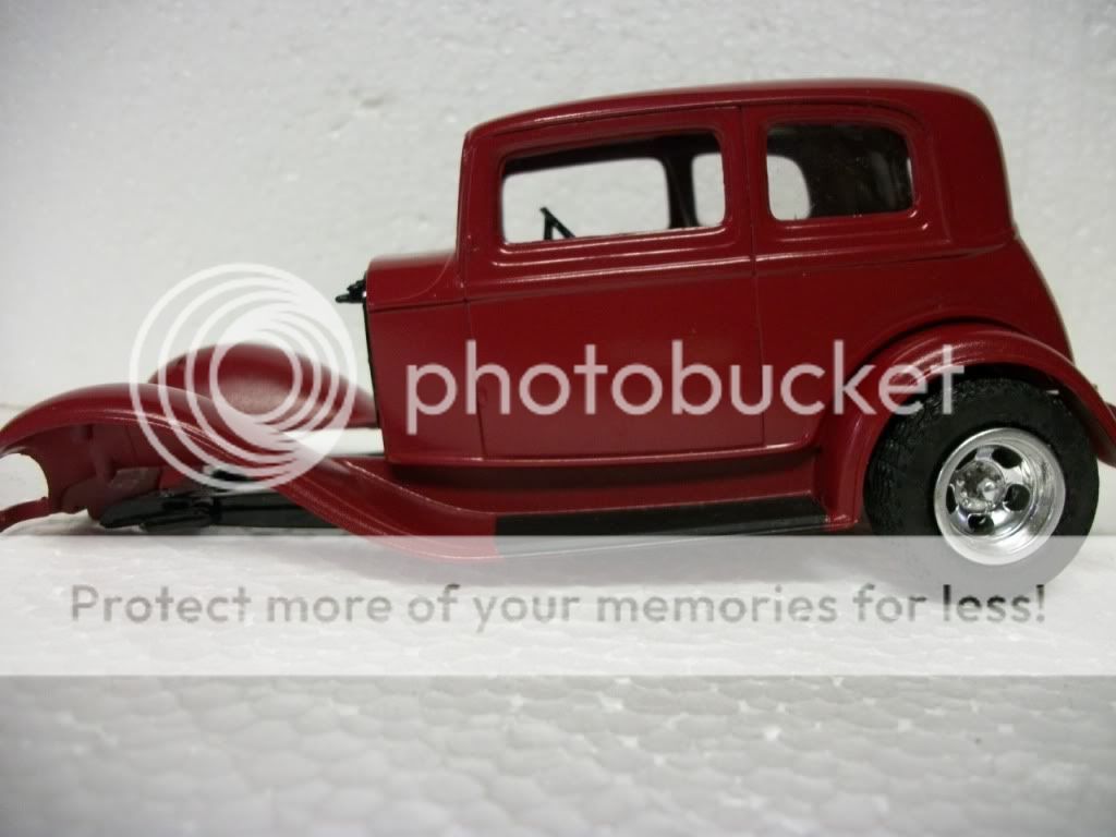

Maybe it's time to pull this baby out of the closet again then... :)
Posted Image
I´ll of course lose the Revell axle. It's mocked up on a chassis belonging to this one.
Posted Image
Which will have to wait a bit longer. :)

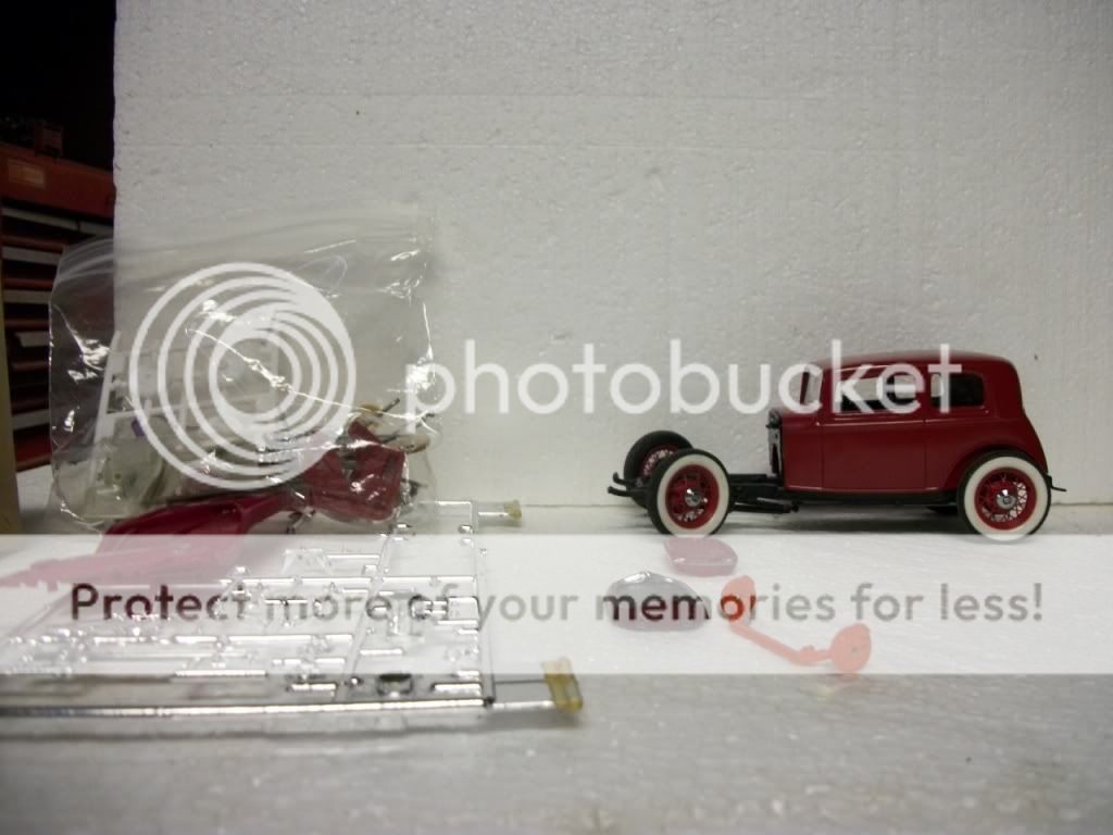

I'm going to slow down and let the paint dry. Here are my brush painted whitewalls drying on the bench and waiting for some Dullcote.Posted ImagePosted Image

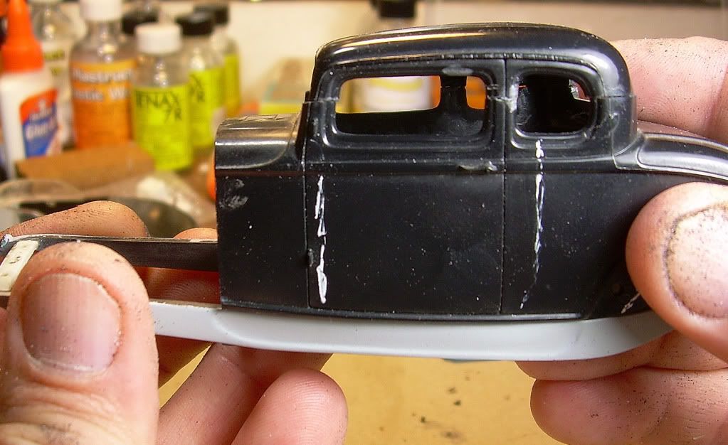

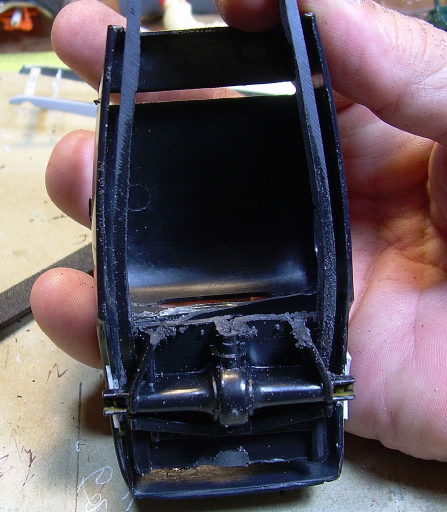

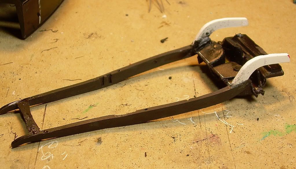

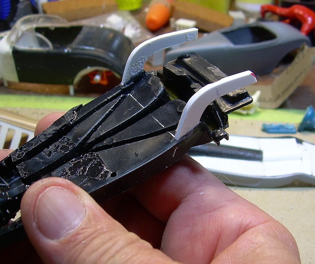

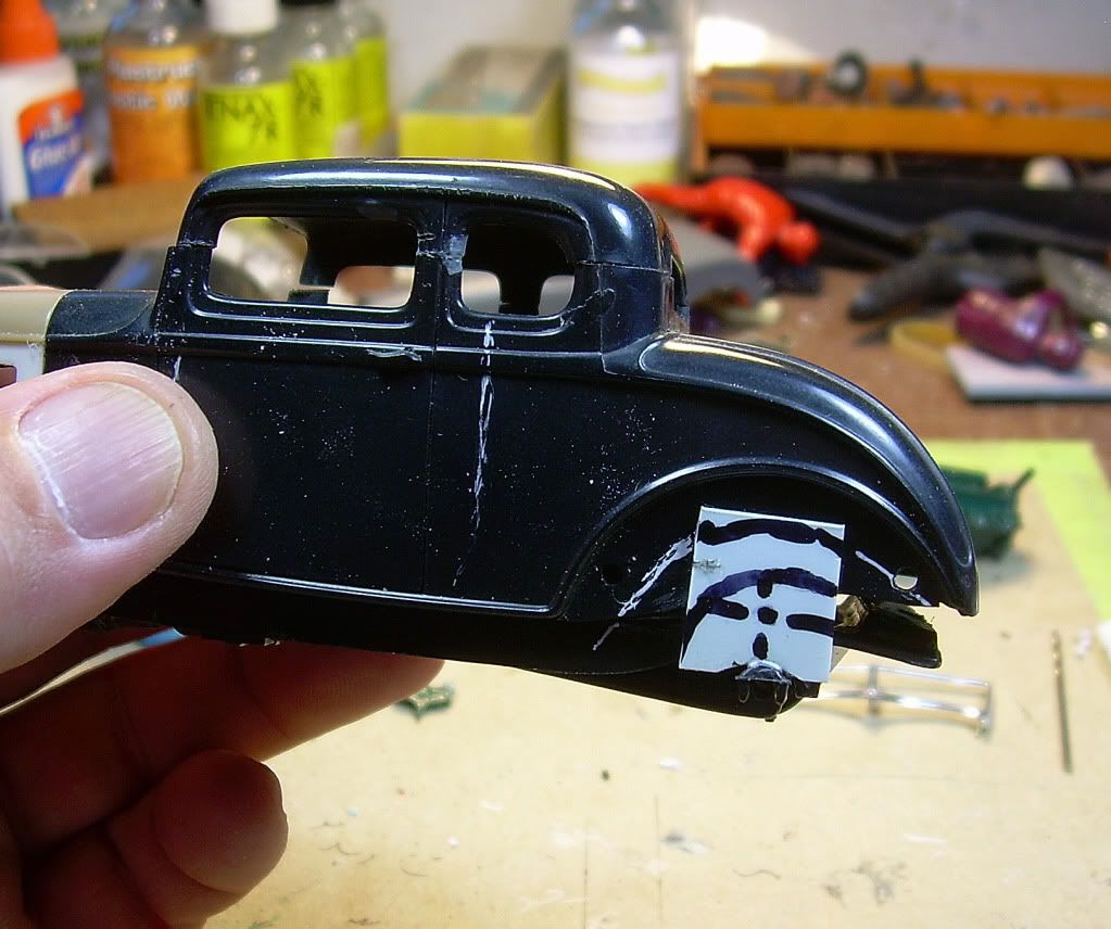

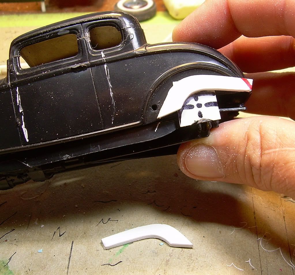

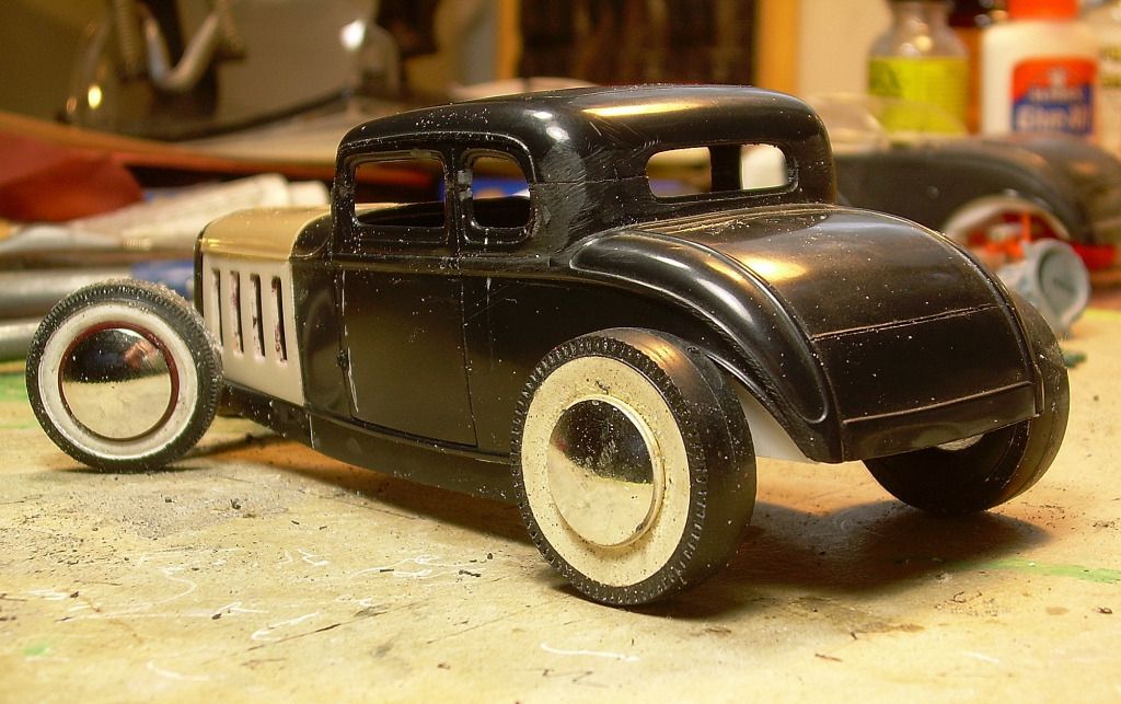

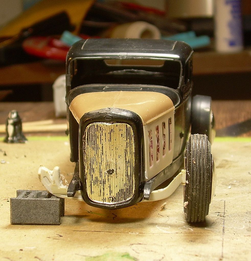

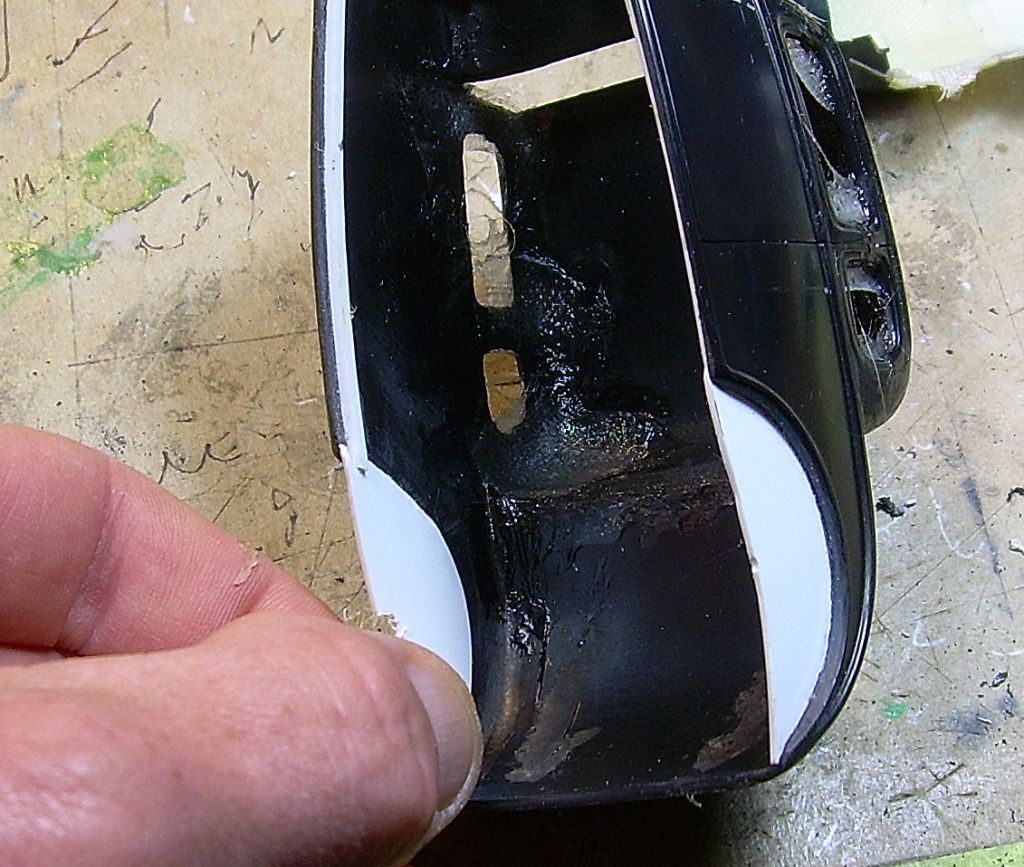

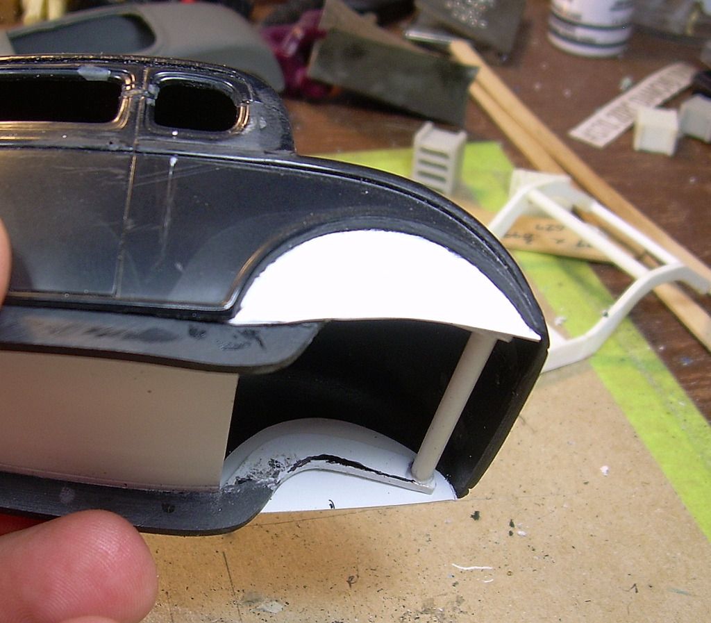

To get the stance I want with the AMT frame, it's going to have to be zeed. More like a new rear section of kickup actually. Marked the position of the axle centerline on the body, then drew in rails that would give me clearance over them for the axle tubes and spring ends.
Posted Image
Made a pair of rail ends....
Posted Image
....glued them on....
Posted Image
..... and hogged out the center of the old blobular bit. I'm leaving the rear stuff in place for strength while I re-work the sides of the rails.
Posted Image
Next trick is to widen the frame so it fits the body like it's s'posed to. It's WAY too narrow in order to clear the fender unit when it's used.
Posted Image
The rails are supposed to look like this relative to the body.
Posted Image
Edited by Ace-Garageguy, 07 October 2012 - 03:21 PM.
