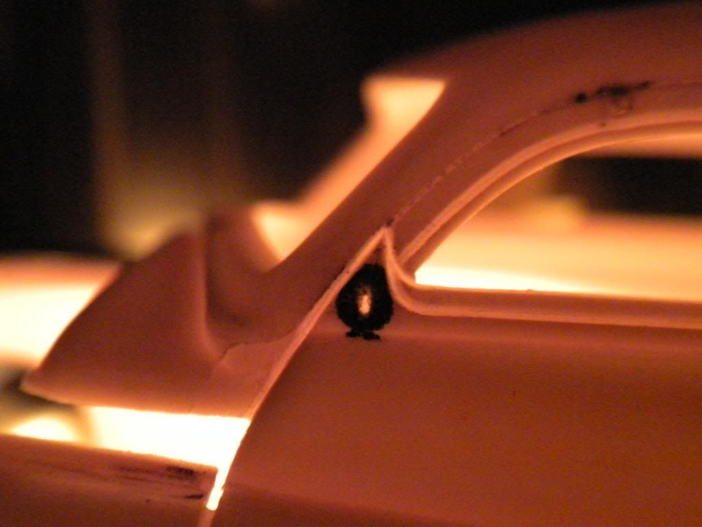

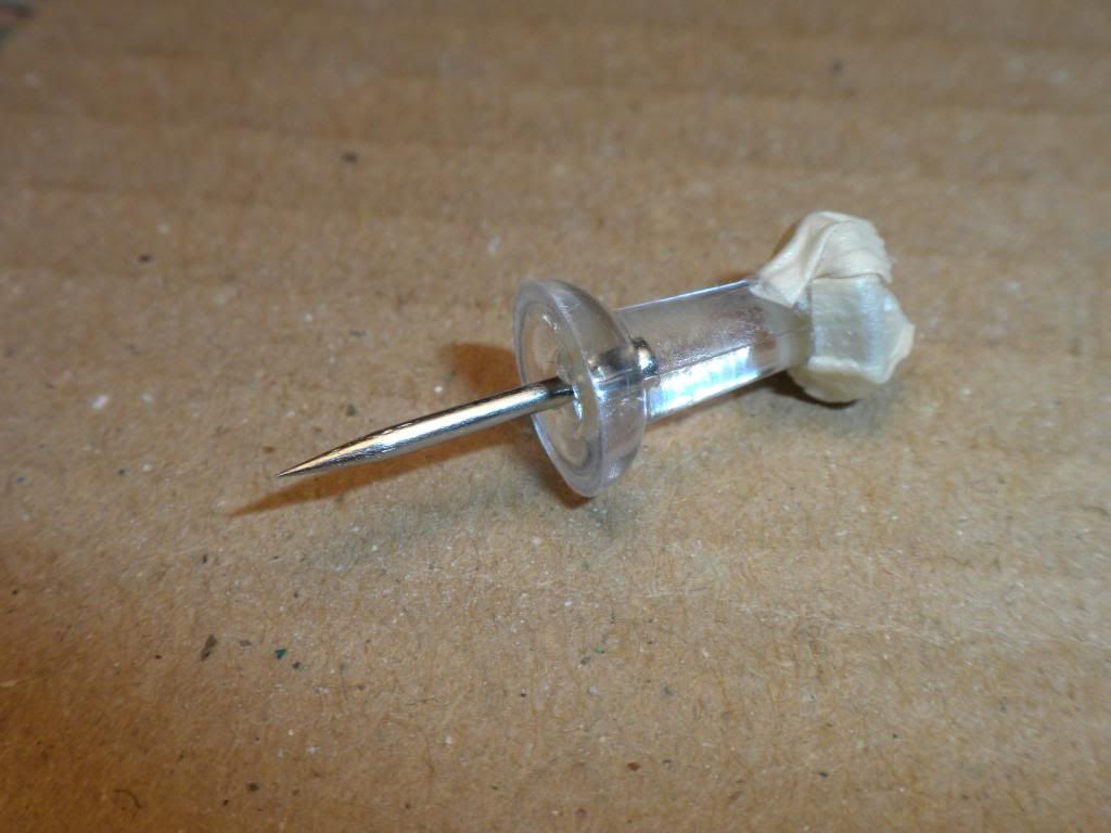

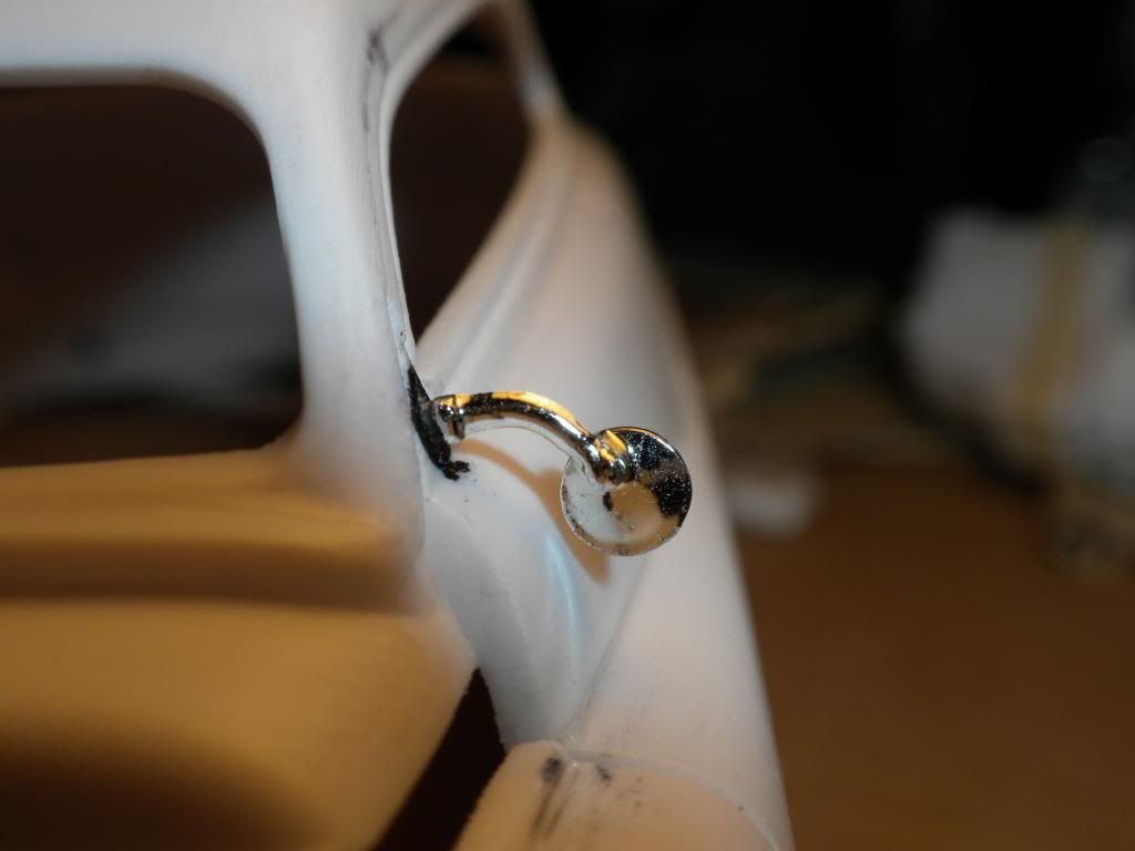

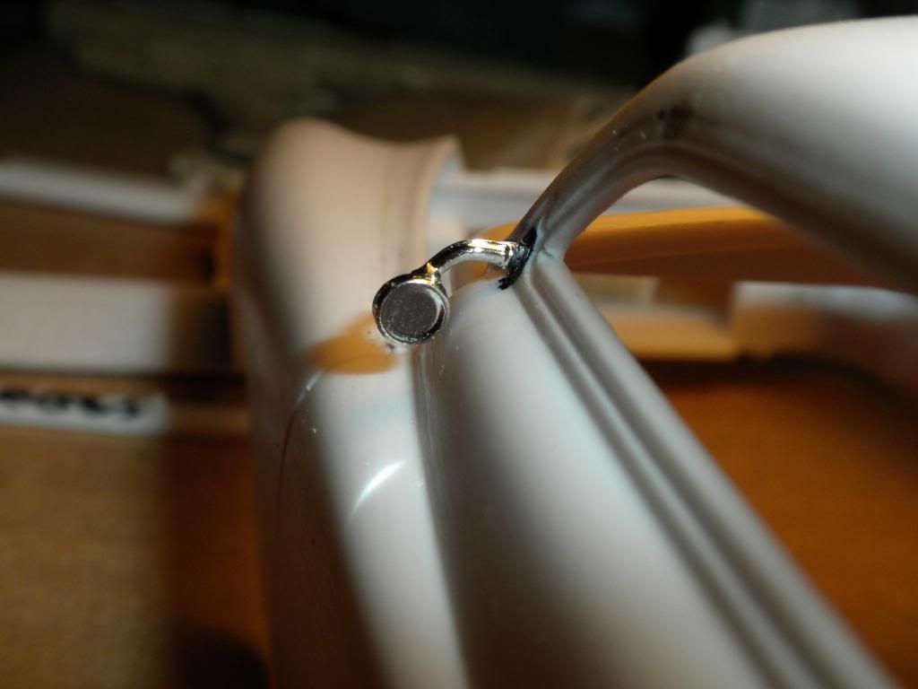

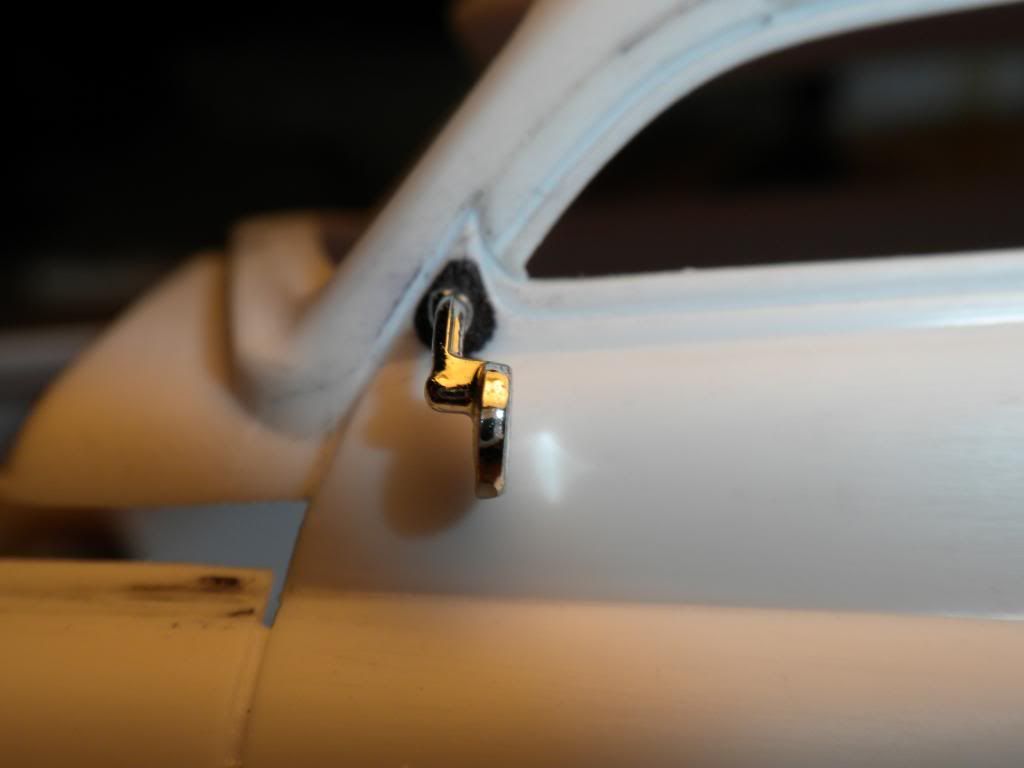

I started by moving the mirror down onto the door. Thought it looked better then were it was so I made a tiny hole with a thumb tac (only thing i had small enough to make the hole).
I use black marker as an etching guide

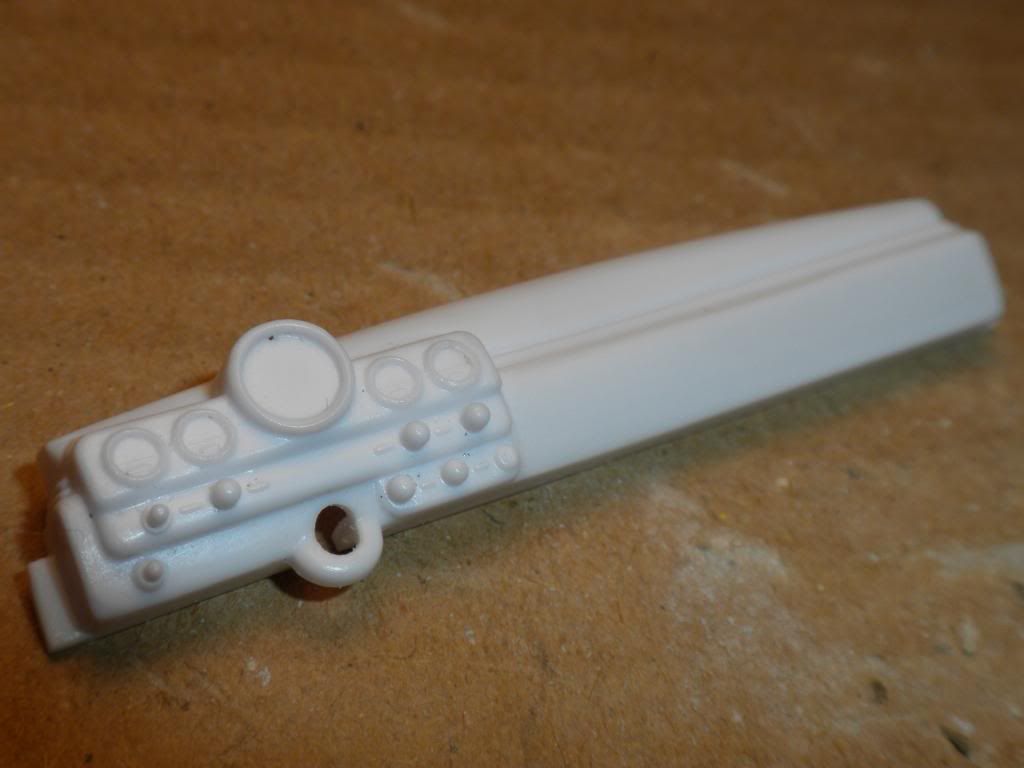

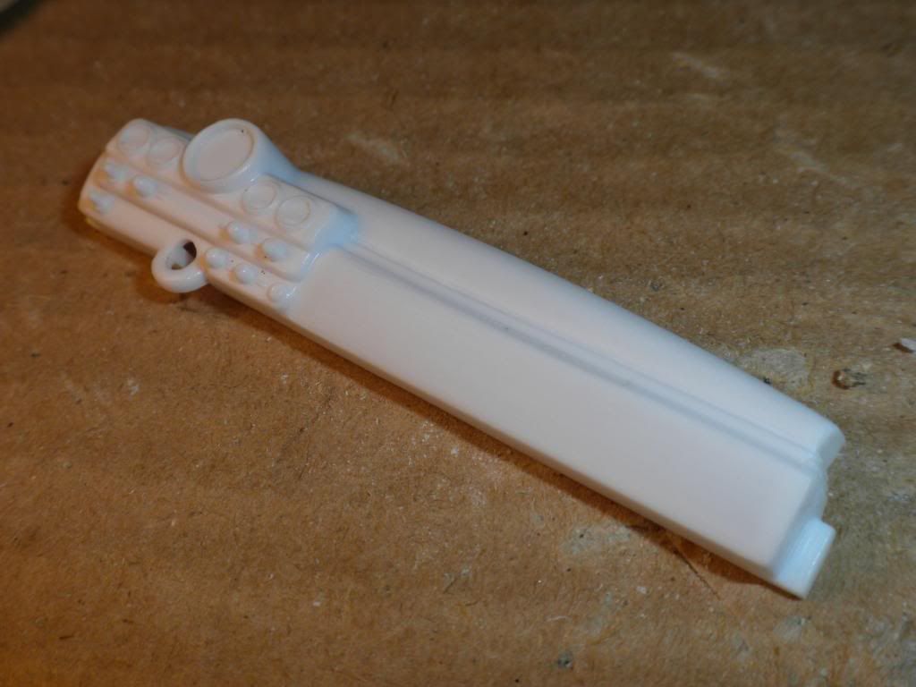

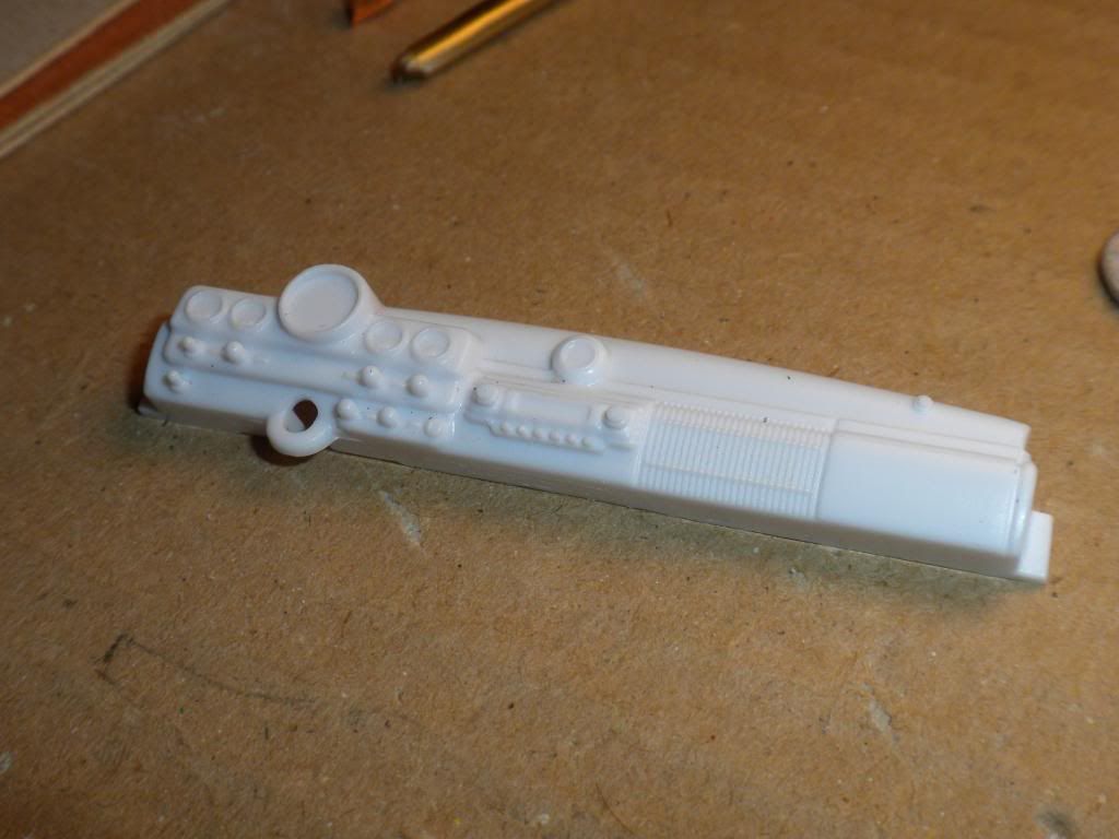

Just to clean the interior up a bit I shaved the dashboard smooth of the clock, radio, glovebox/lock, and those lines, not to sure what they are.
Then I followed that nice body line all the way through.

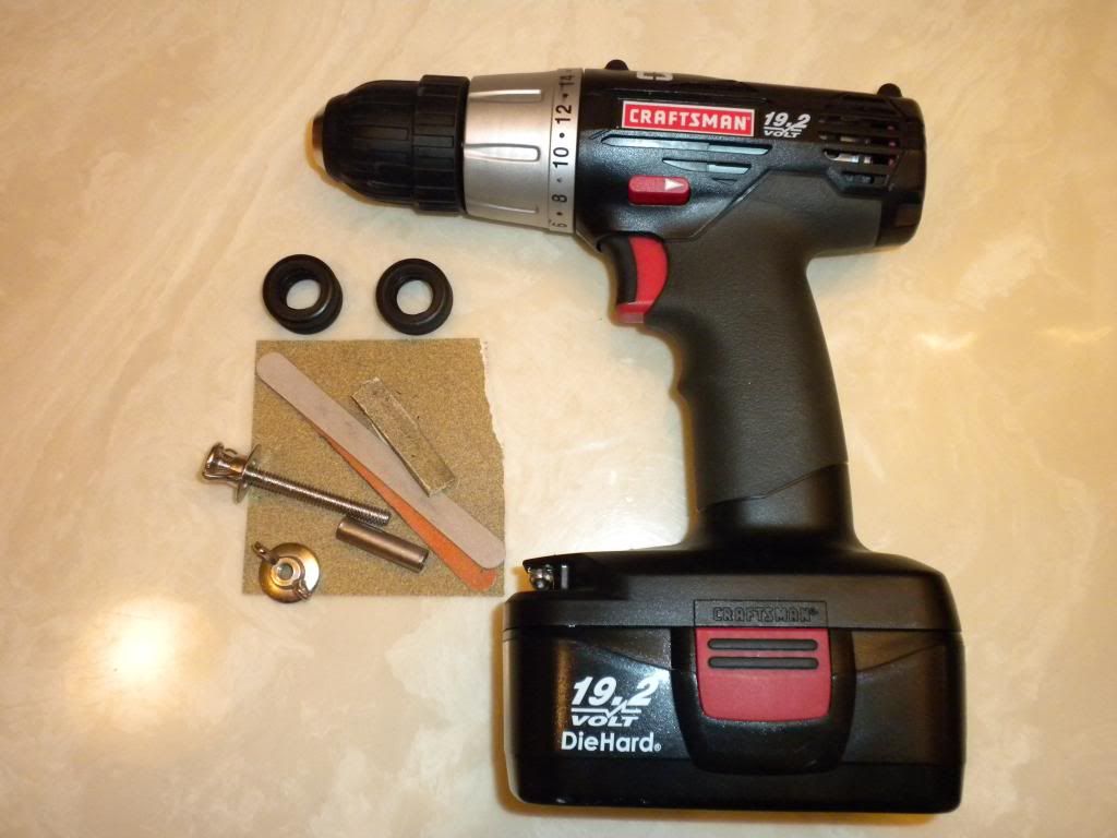

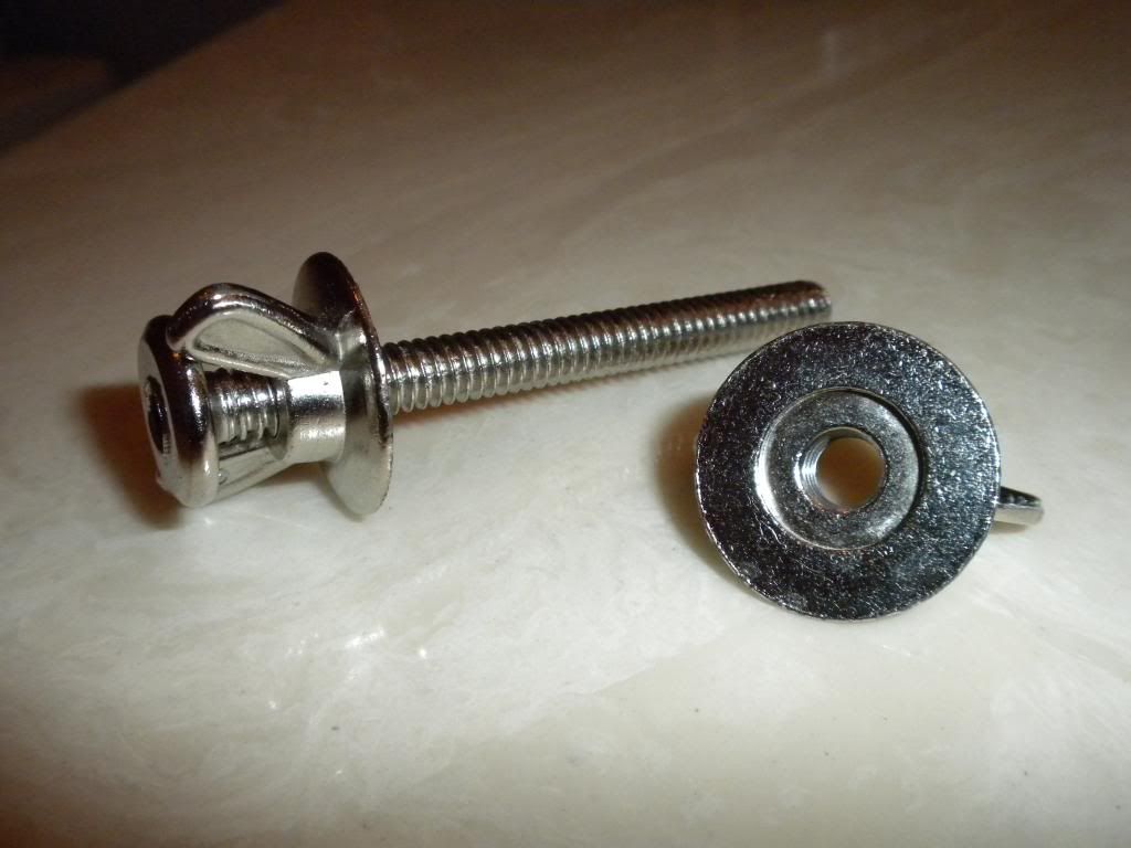

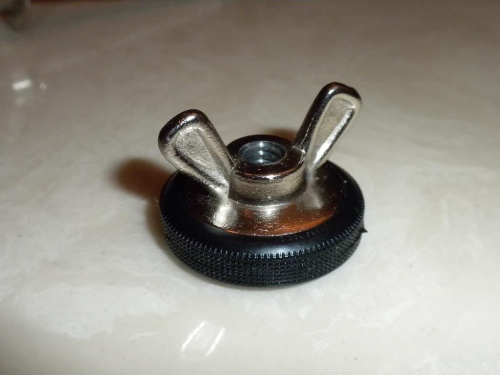

I also shaved the tires down a bit to help with clearance and get it down a bit lower.
Weapons of choice: power drill, bolt, 2 wing nuts, a spacer, and some sanding materials.
I used wing nuts with a smooth side so the ridges didn't dig into the tire.
They also fit perfectly into the tire.

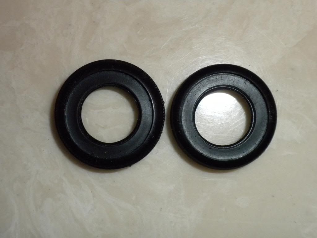

Left side: unshaven
Right side : shaved
Not much difference but you can see its a little smaller then the original.

Every thing is looking great Jason !   I really like the smooth dash ,  what a difference !
 Nice job with the tires too ,  I've been doing it that way for a long time .

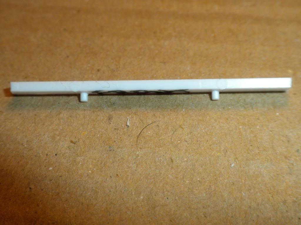

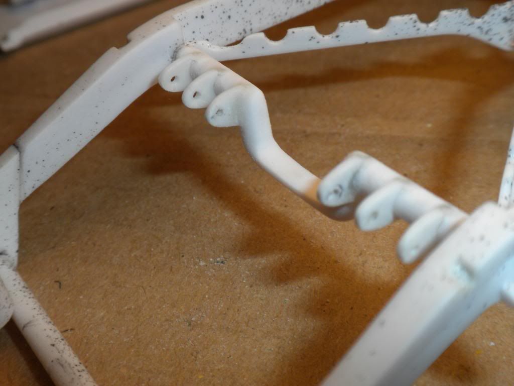

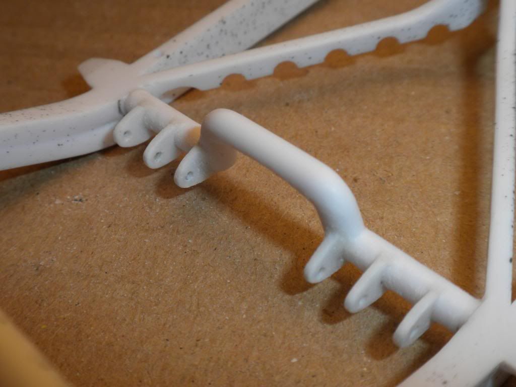

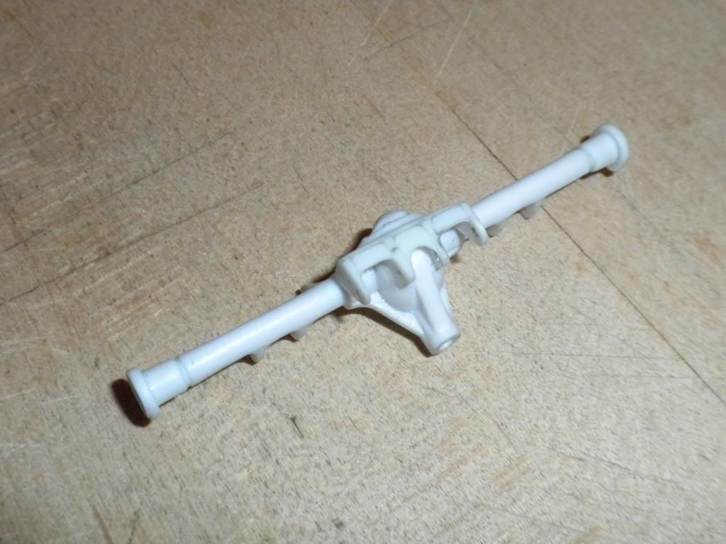

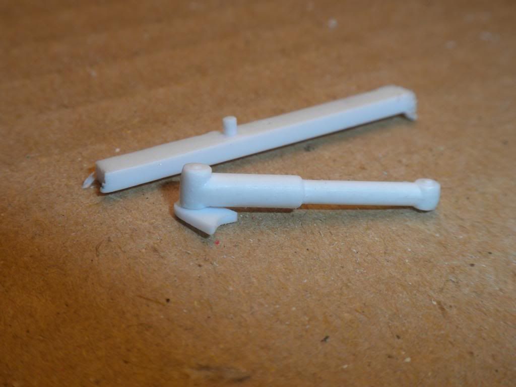

I decided to go with a 4 link. The first thing I did was make a cross member so I can attach the tabs to it.
I found this piece of old parts tree that fits perfectly.

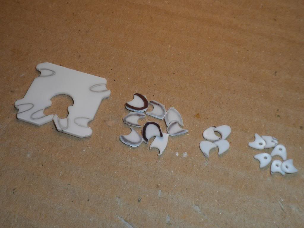

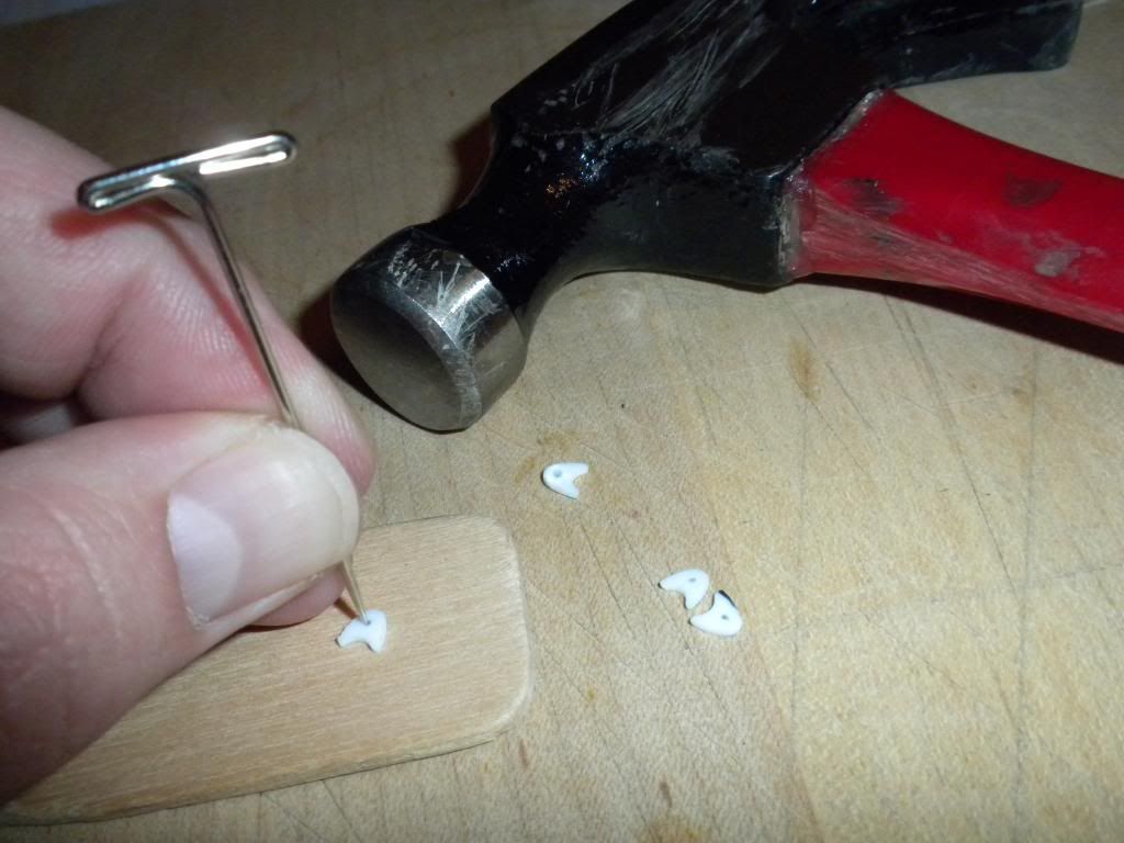

Then I made a bunch of tabs out of some old bread plastic clips.
First making rough outlines/cuts then I shaped them and last I punched some holes through.
Wasn't going to make the holes but I figured the extra step was worth it. I didn't have a drill bit small enough so I had to tap the holes out, then slowly push it through the rest of the way so i didn't split the tabs apart.

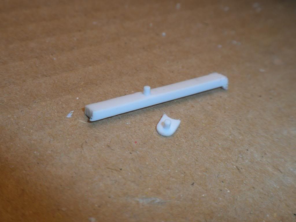

I also made tabs for the shocks out of the old cross member they used to attach to.

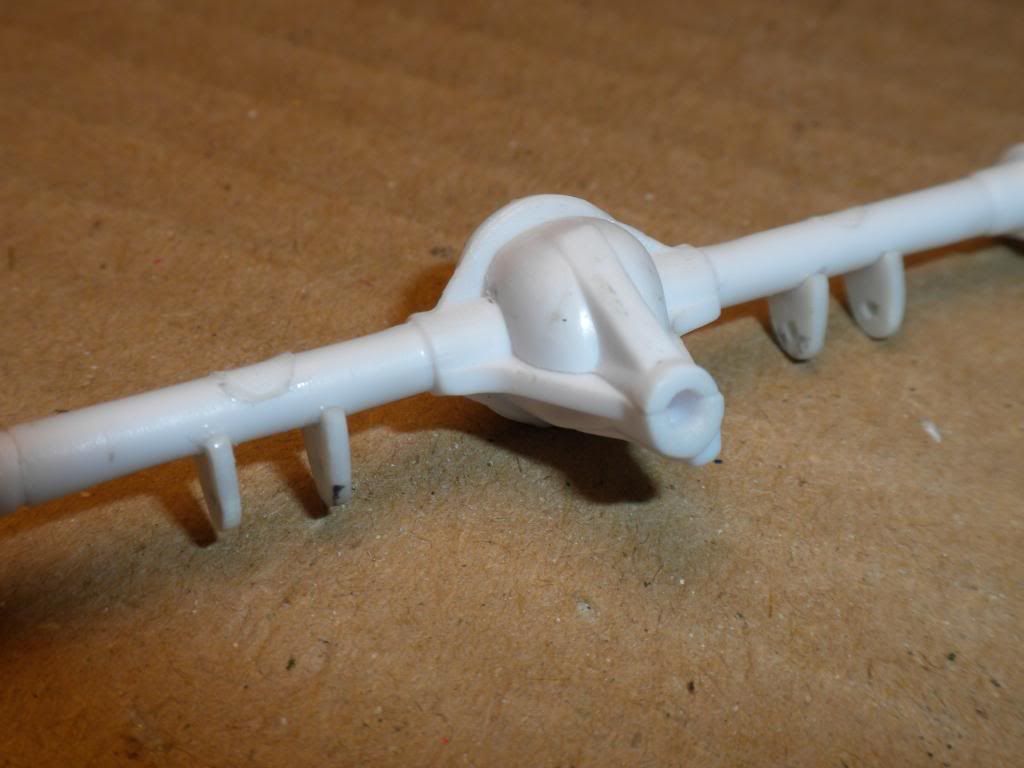

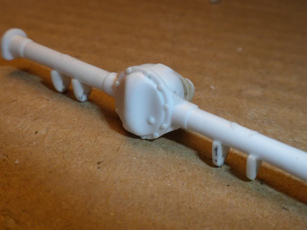

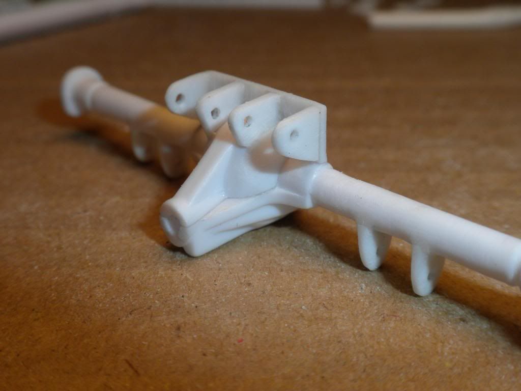

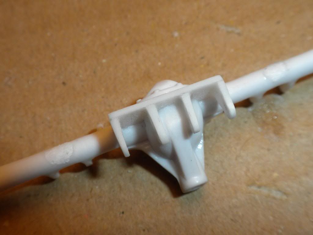

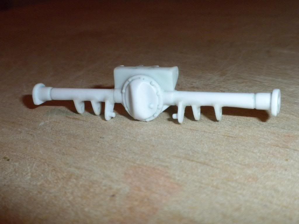

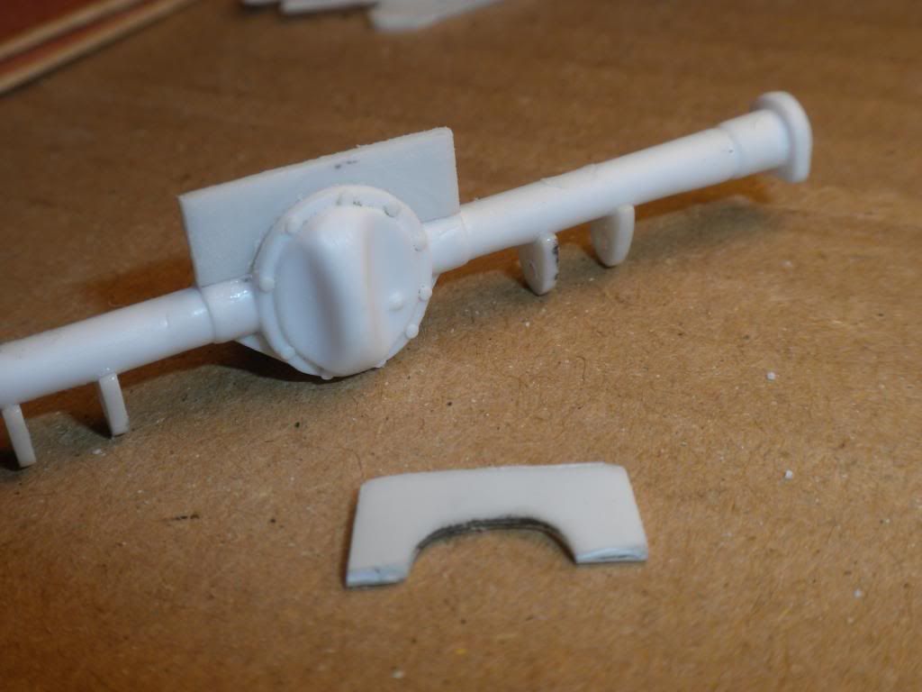

When I finished making the tabs I figured out where everything had to go. Keeping the clean look of my bridge I decided to attach them to the cross member and rear end. After that I did the body work and more shaping. Still have some touch ups to do.

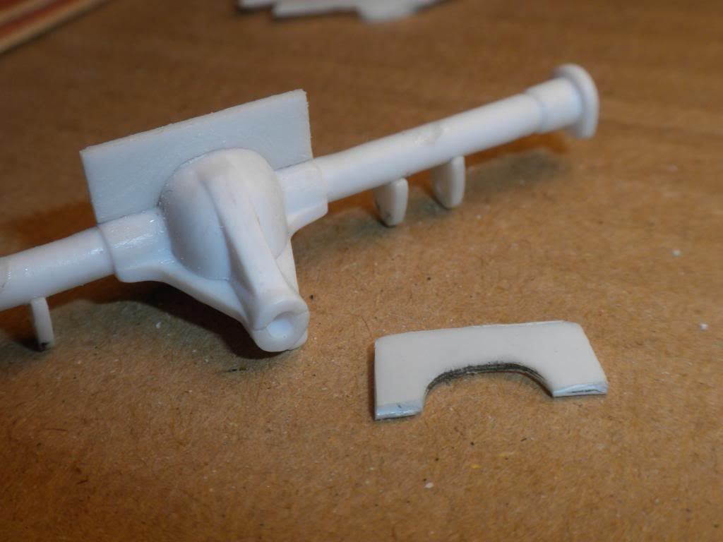

I made a backing plate so I can attach some more tabs. I made it line up with the lines that were already on the rear.
Thought it looked a little empty and weak so I added filler plates and rounded the back edge off to

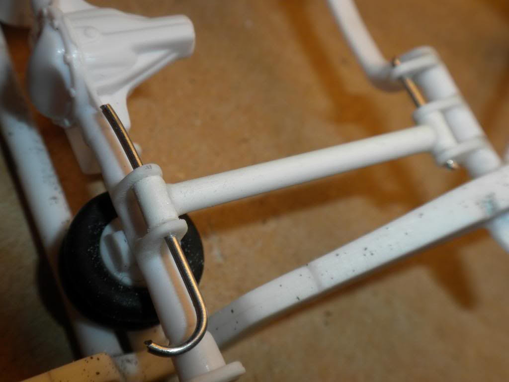

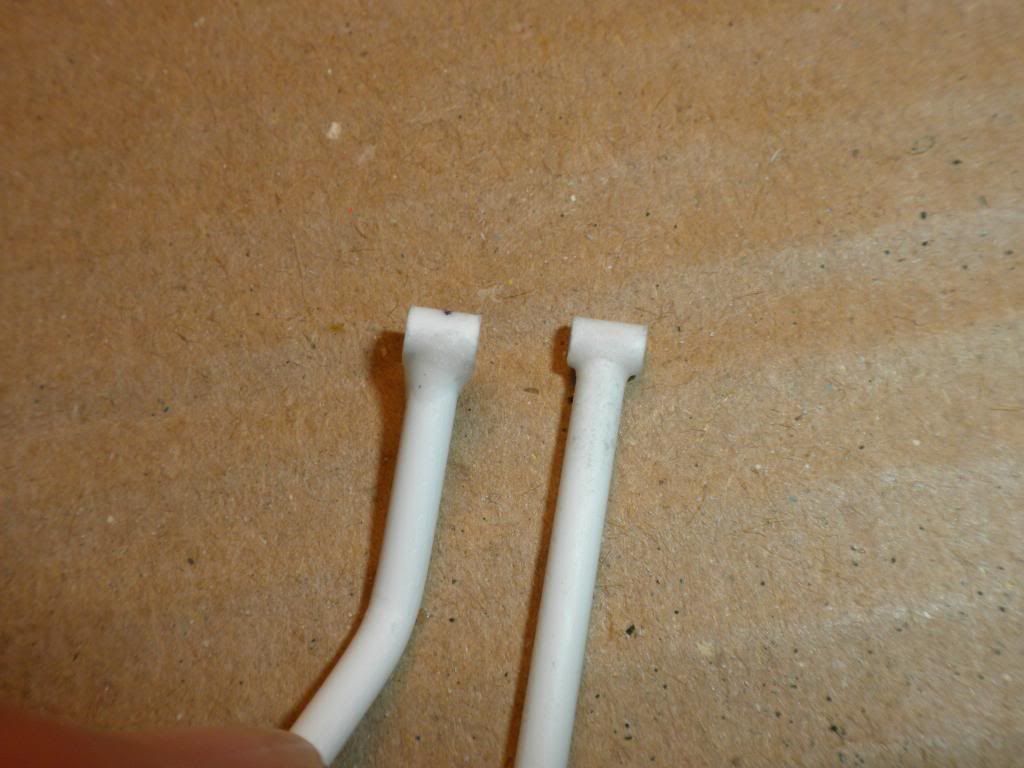

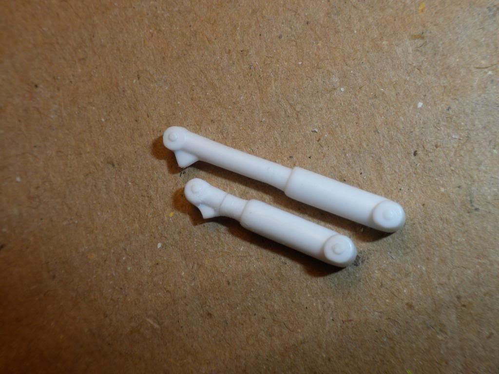

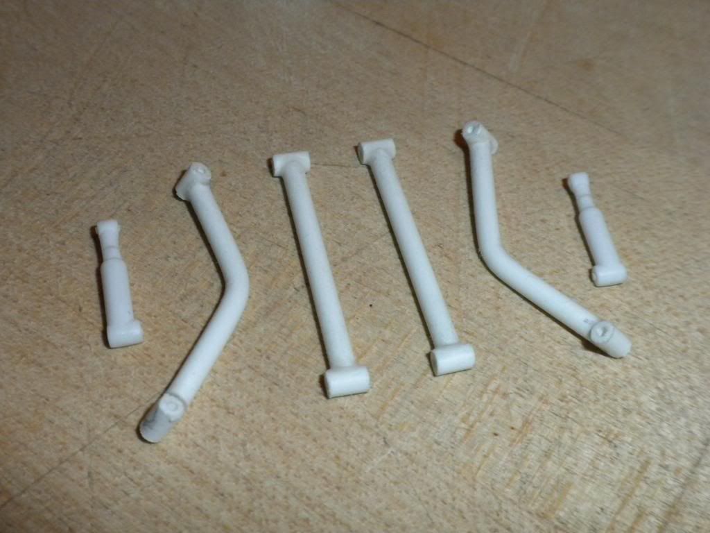

I cut the shocks down and cleaned them up a bit to fit into the scheme of things.

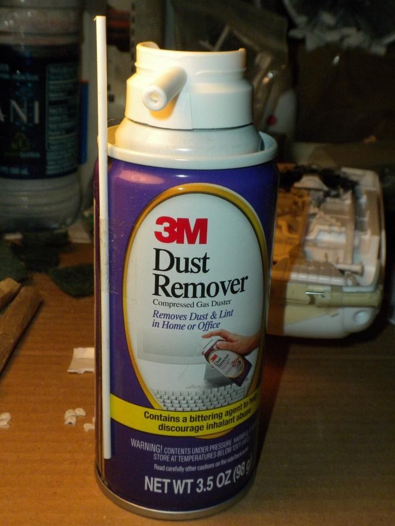

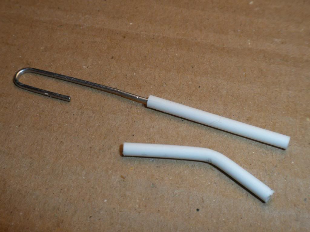

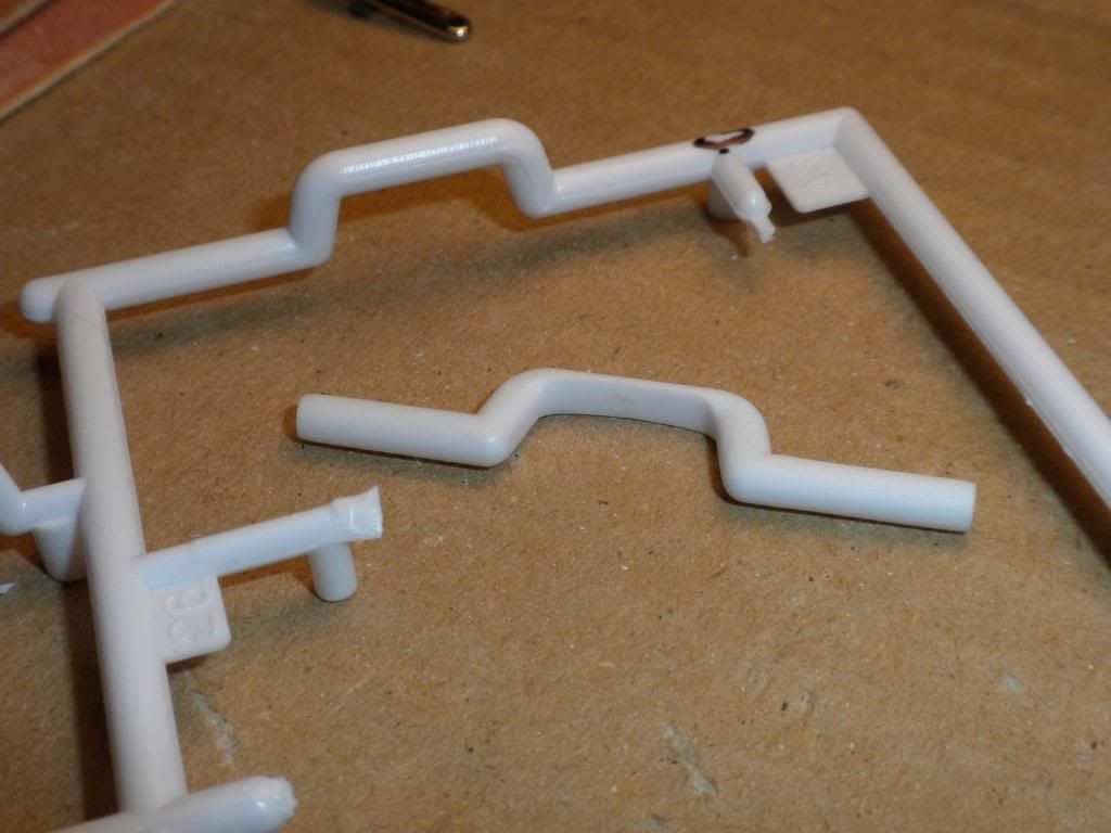

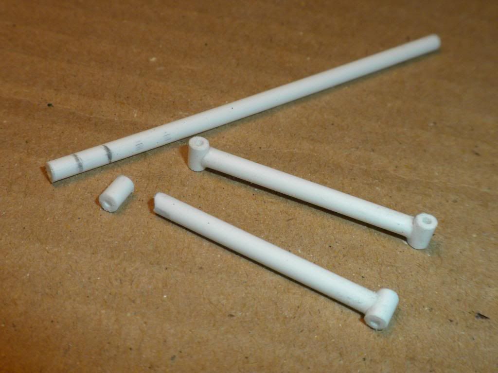

I finally found the only thing in my house that comes even close to the size I needed for the link bars and it happened to be the straw off the 3M Dust Remover can.
86f155d73522e72ec72ecc8fc4f29675_zpsc677
In order to get the bend I wanted and not have it move out of place I used a piece of paper clip to stick inside.
Did a little body work and its good to go.
I have to run out but here's a little teaser. I'll post photos of the complete set up later on tonight.

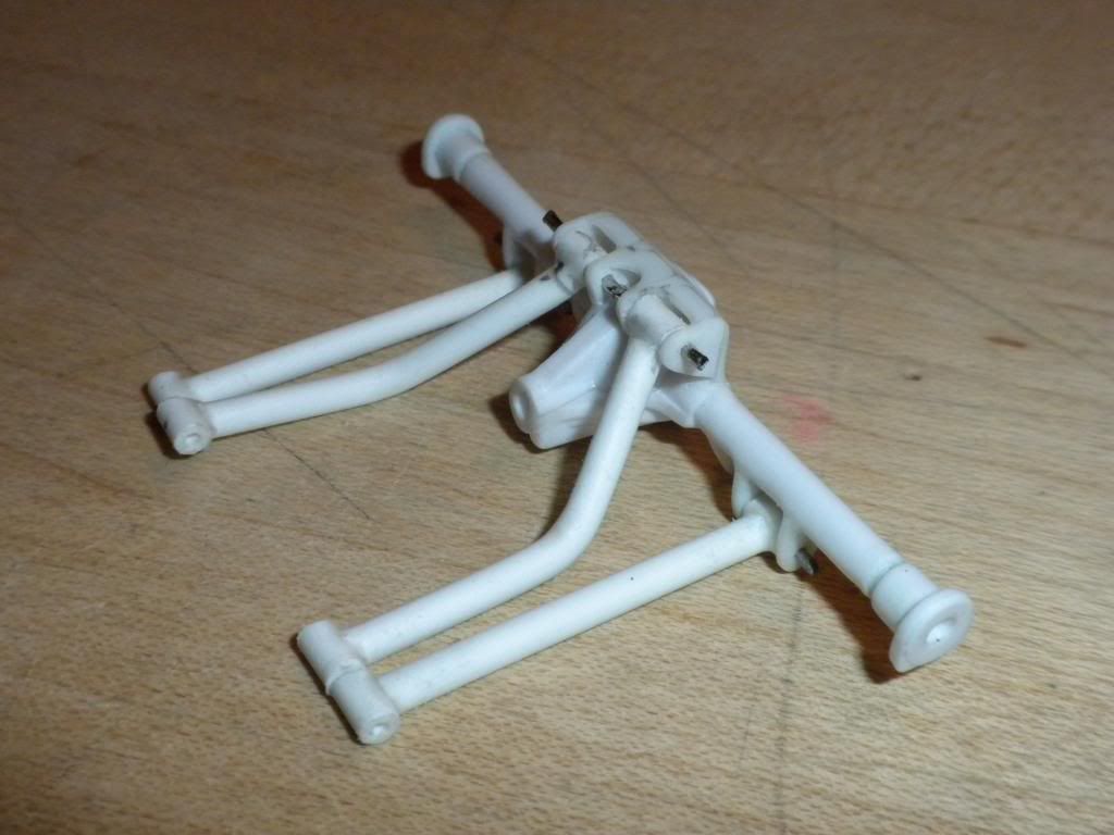

Good to see you back at this one Jason, more great work! That 4-link is shaping up nicely indeed.

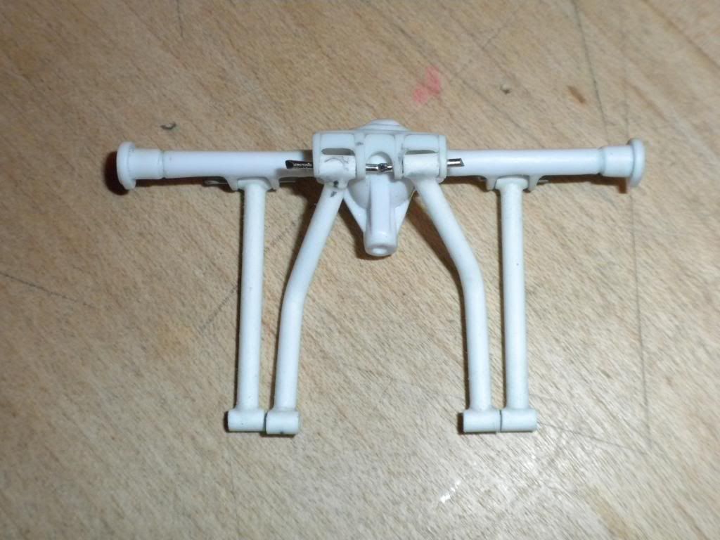

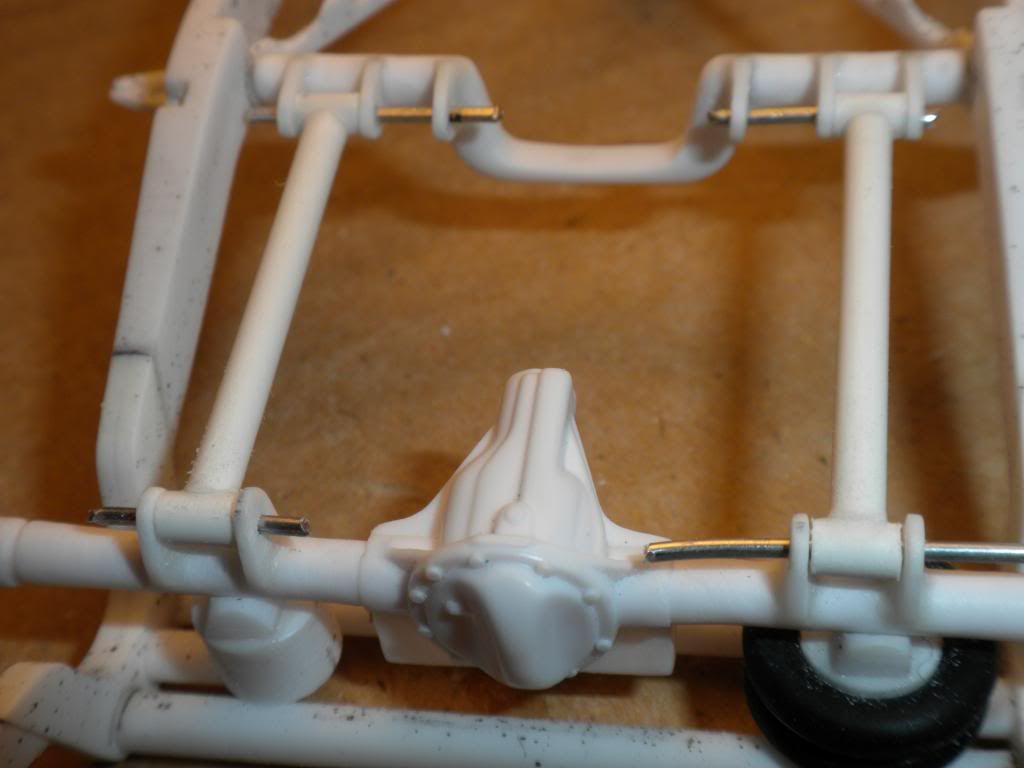

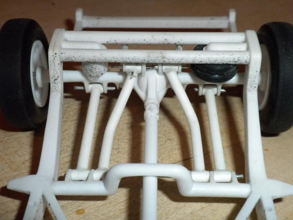

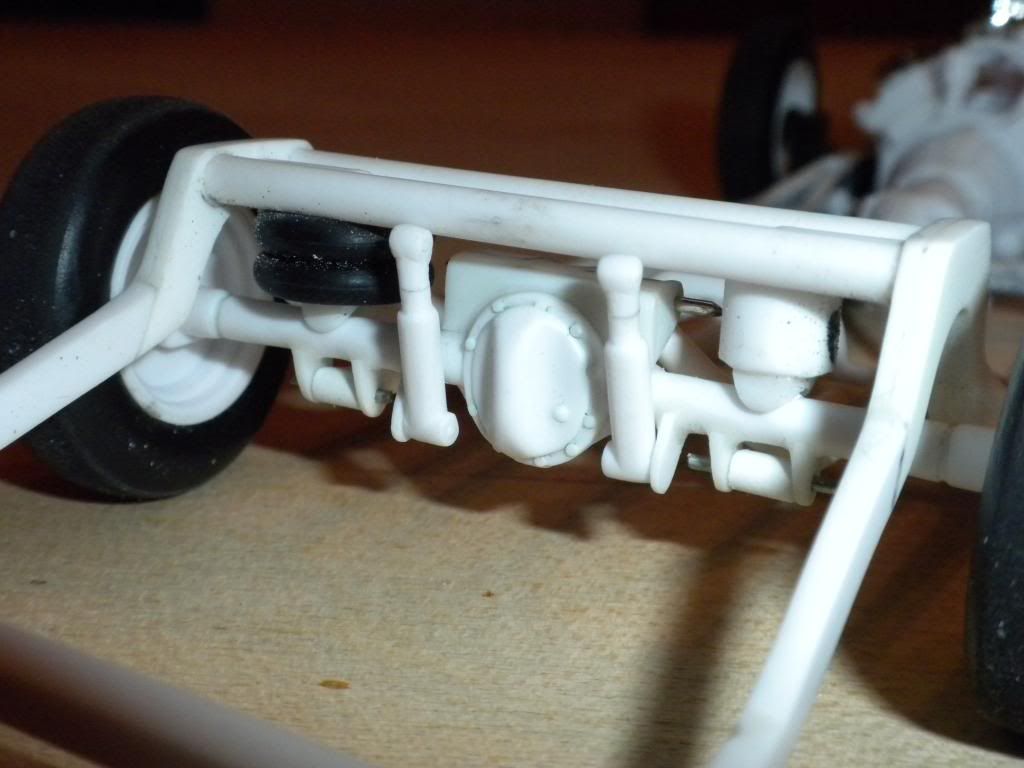

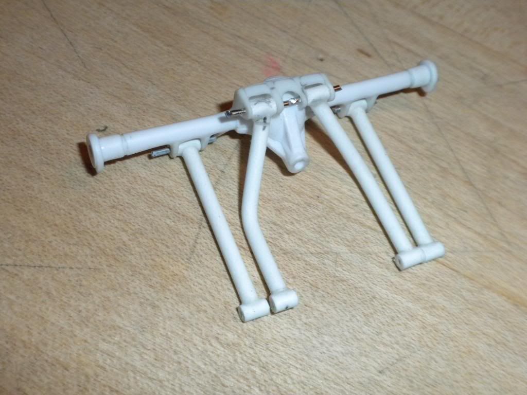

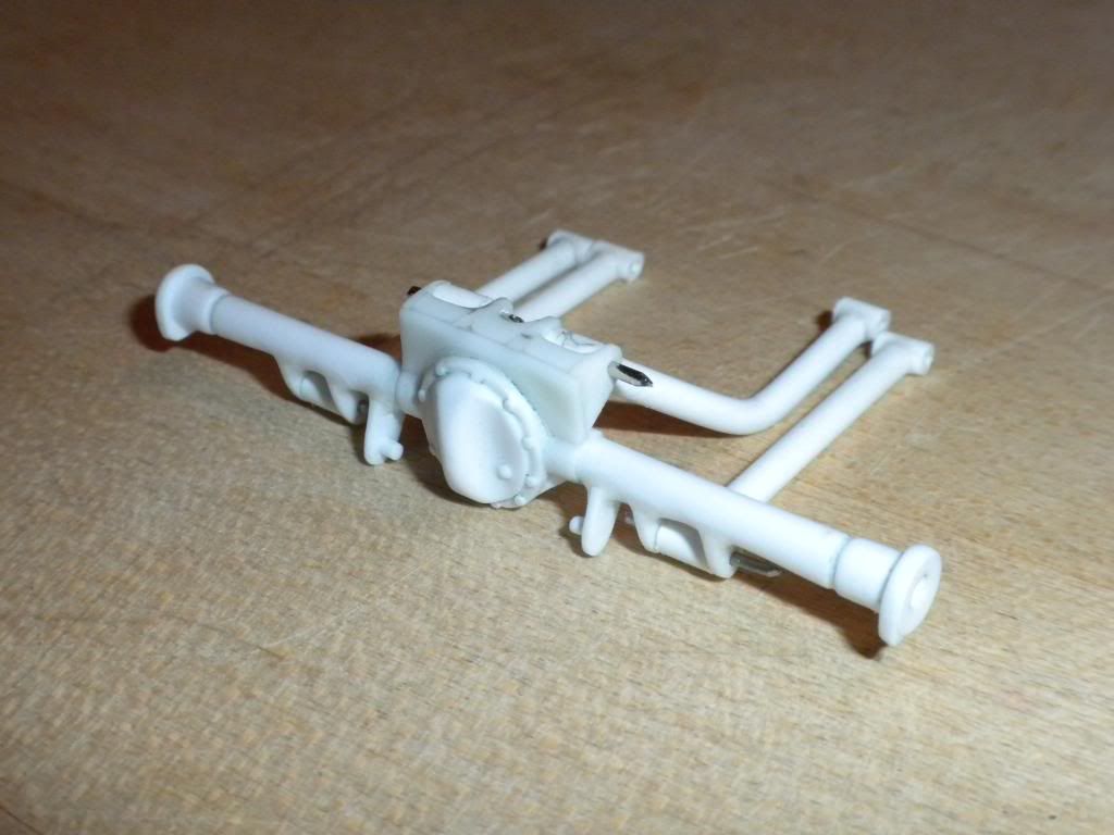

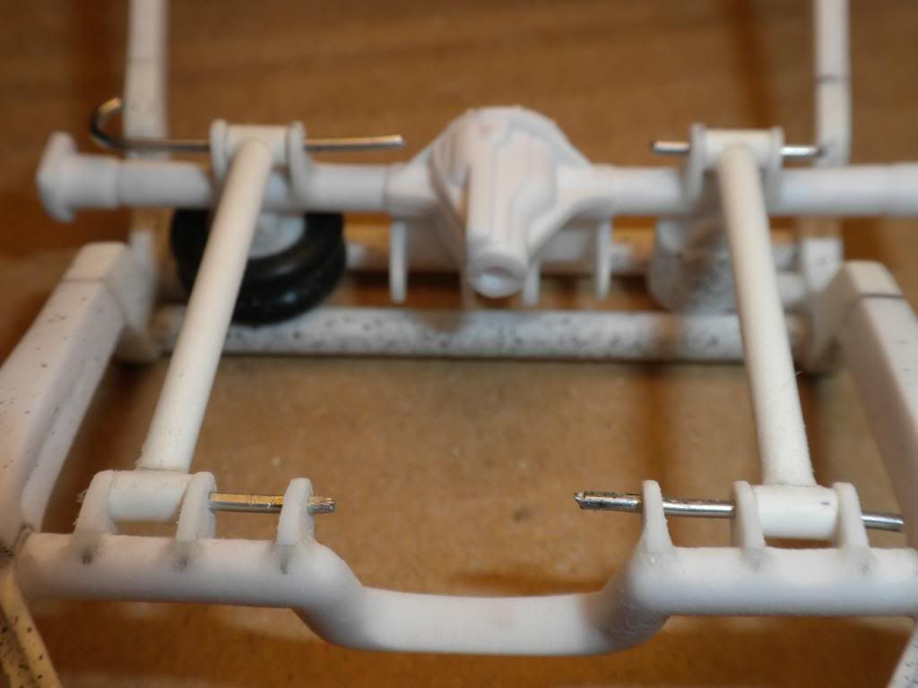

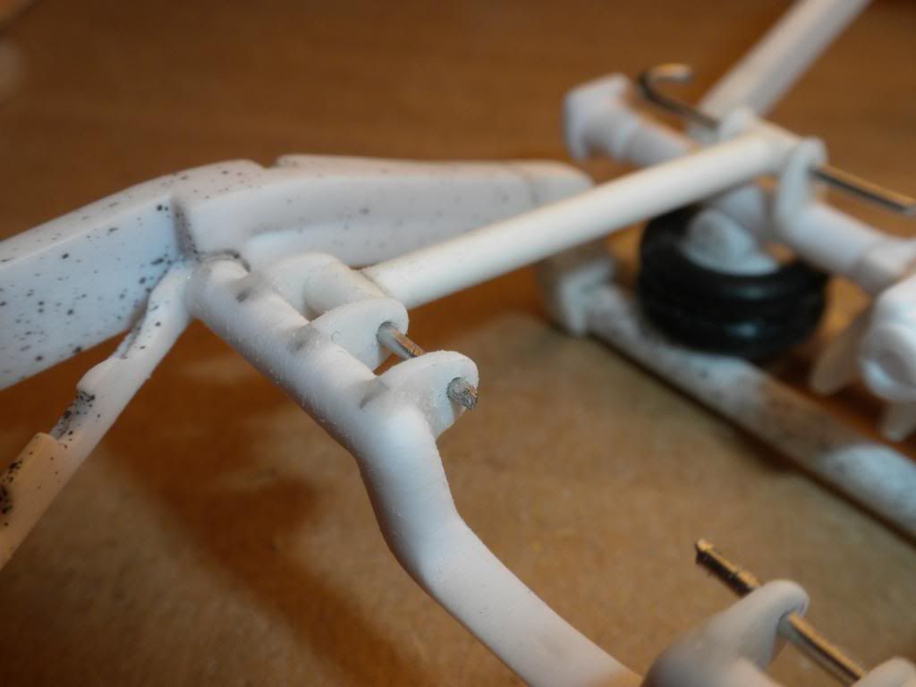

Here's the first 2 link bars installed
The finished rear with everything installed outside the frame.
Edited by JasonFL, 16 June 2013 - 08:38 PM.

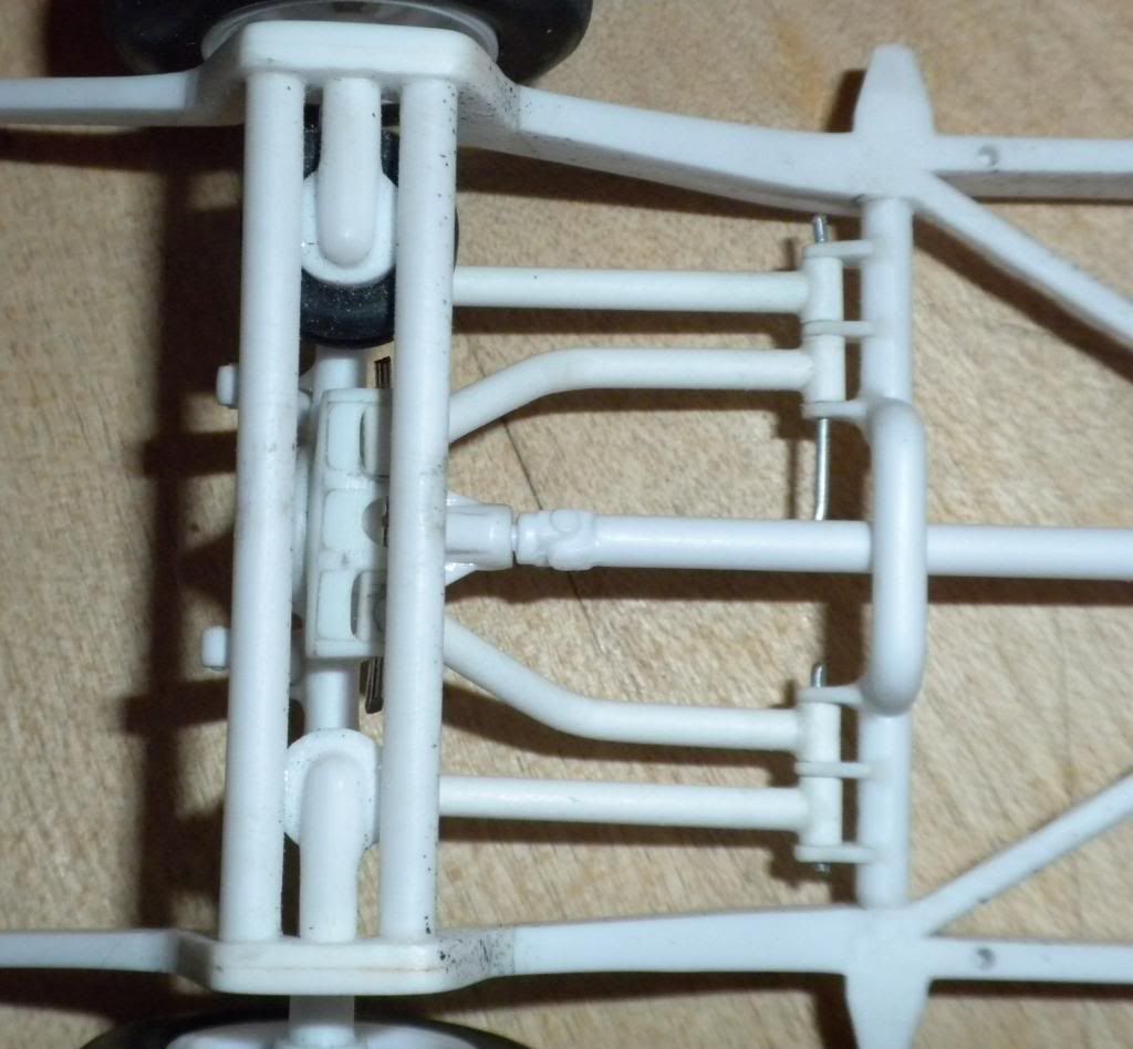

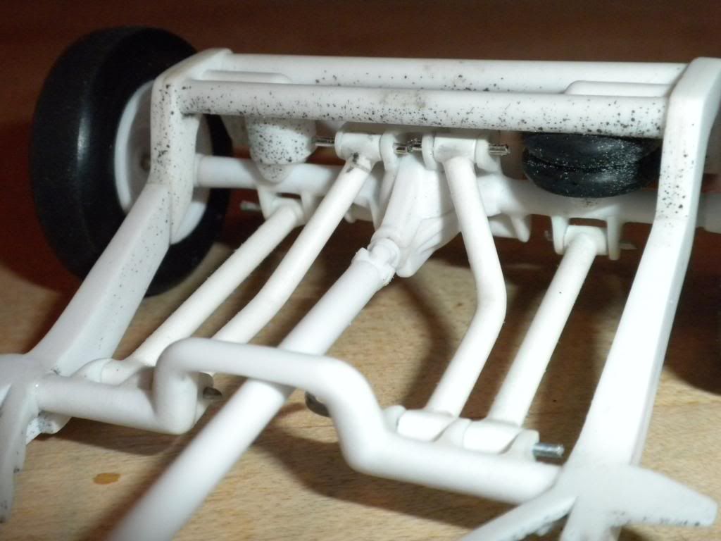

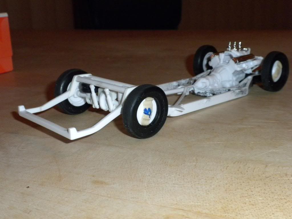

And this is everything installed on the frame. I was going for that smooth flowing look with nice lines.
Still some touch up work to do but you can see the look I was trying to achieve.
e18c1135-8342-4260-8667-ccd4b728e58f_zps

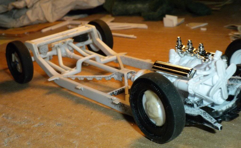

This is everything mocked up on the frame with all 4 wheels, motor, and drive shaft.
f0e29df4-7420-42e1-bb46-75e326369a8c_zps
Thanks for checking out the build. I have more photos to load with some other things going on with the build that I'll be posting soon. I think you guys are gonna dig it.
