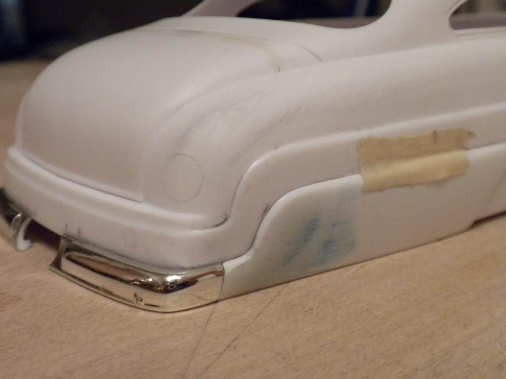

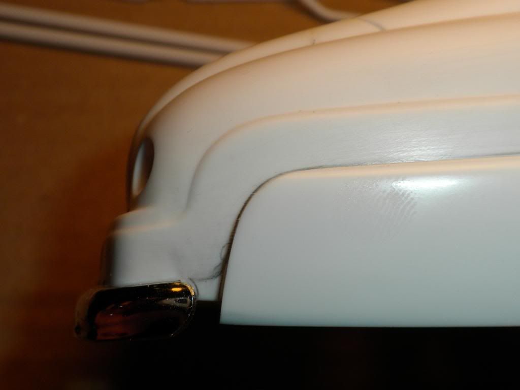

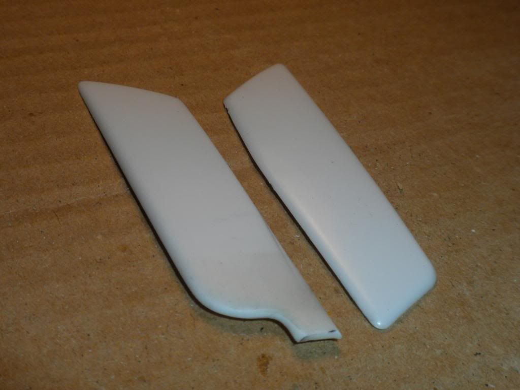

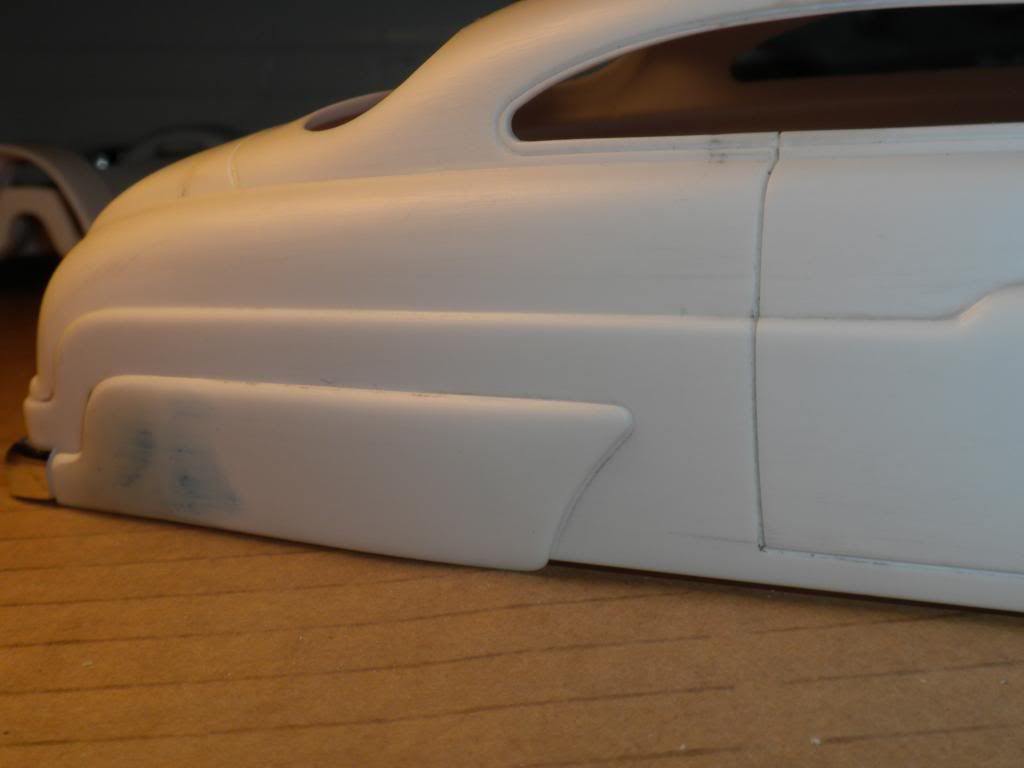

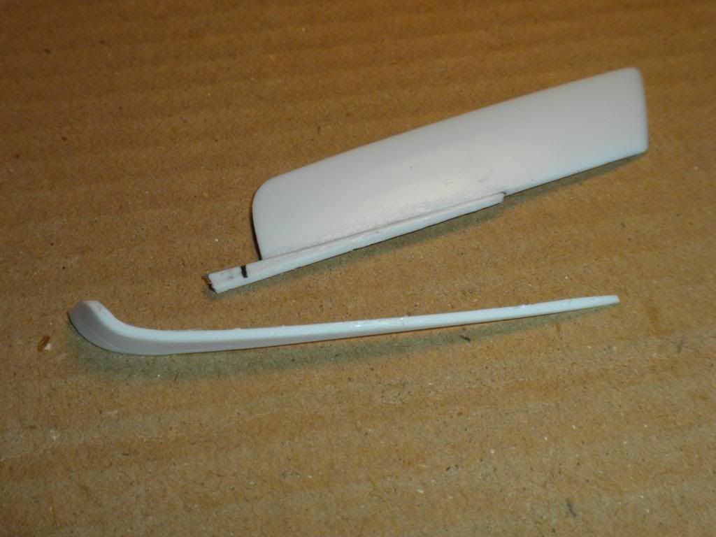

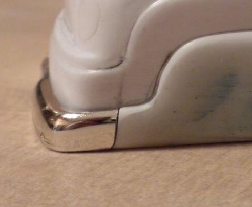

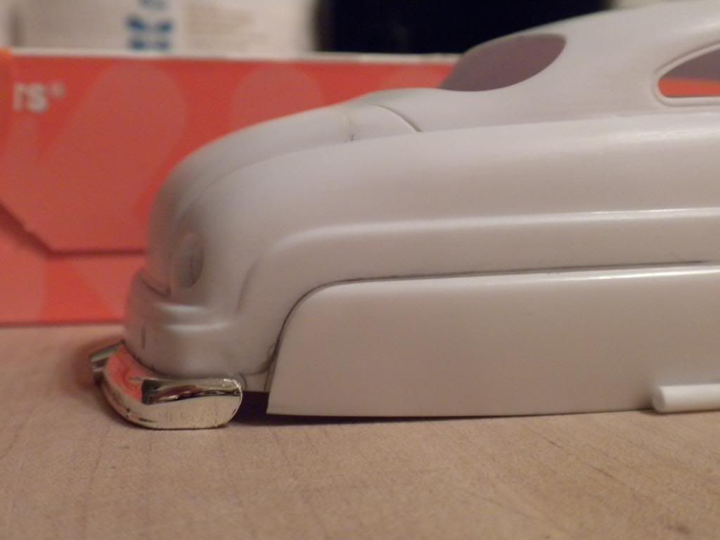

Like I said before I wanted the skirt to flow so I started by shaping the top part to match the body line but then it just drops off so I'm going to make it flow into to bumper as well.
Started by leveling the bottom out and then used an old scrap piece from the hood to make it sit flush on the ground.
Then I cut a rough piece of plastic out, glued it on, and stared shaping.
This is the end result compared to stock. After using some filler I was pretty pleased with it.

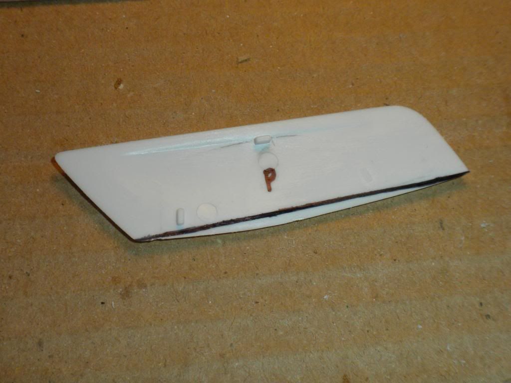

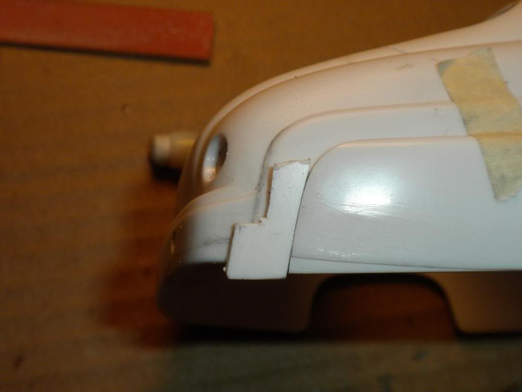

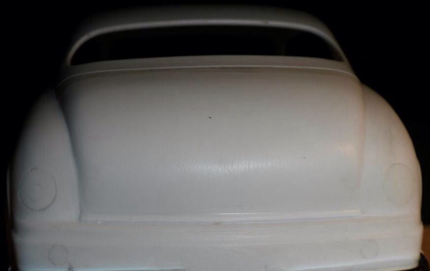

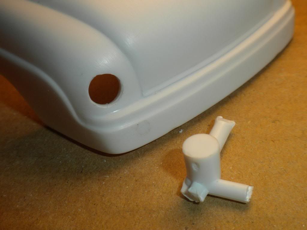

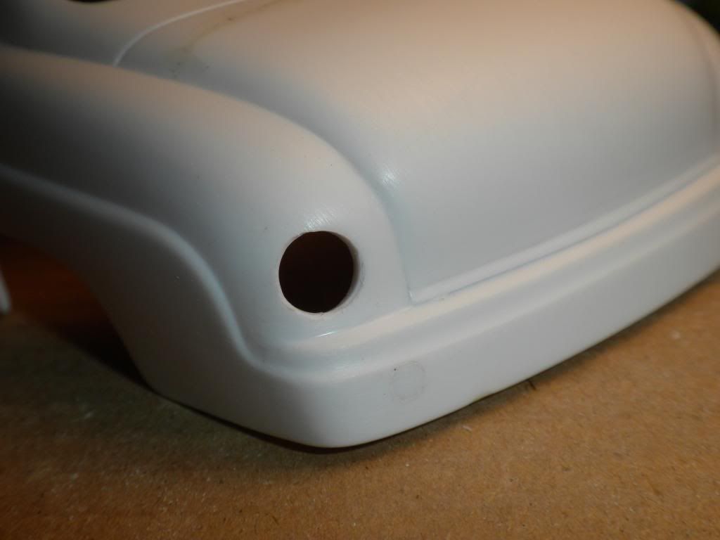

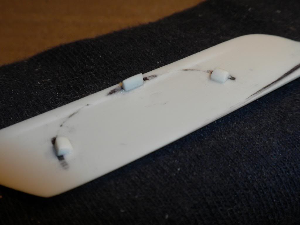

I got rid of the old brackets and made new ones so it would slide right in place and line up without thinking twice. I also put a bracket behind the new plastic for extra backing support.

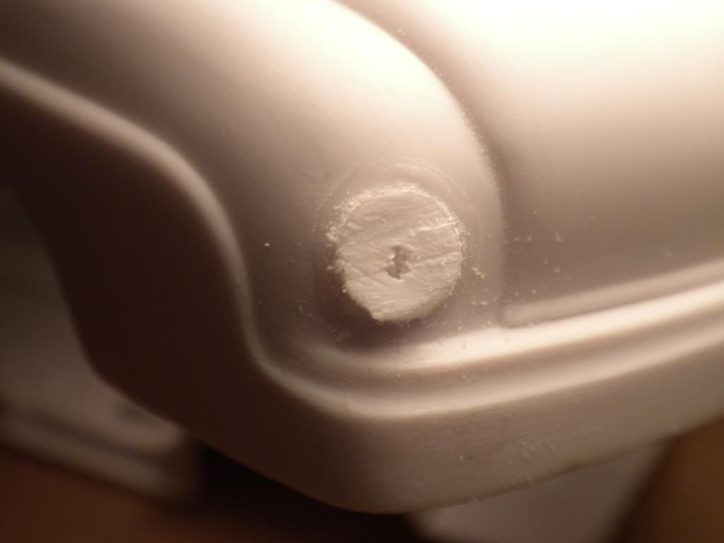

While doing the skirts I shaved the the tail light buckets and old bumper holes.

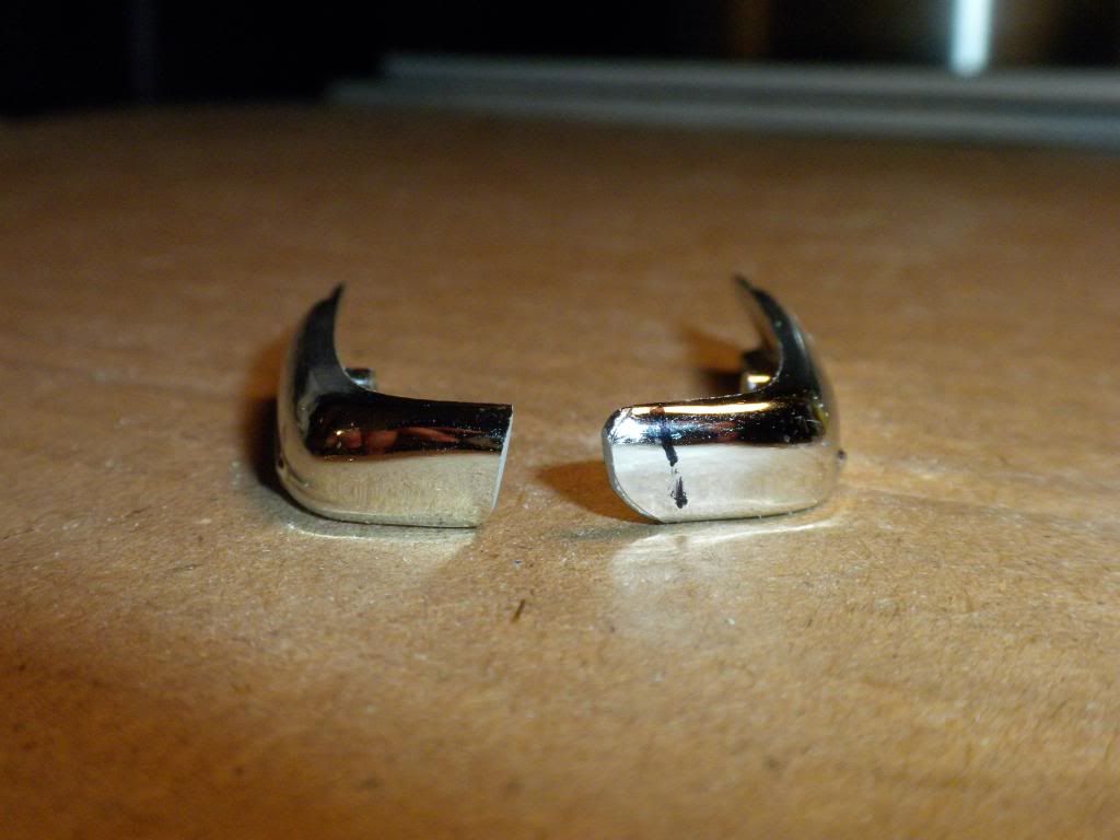

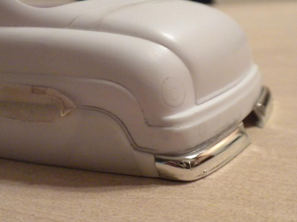

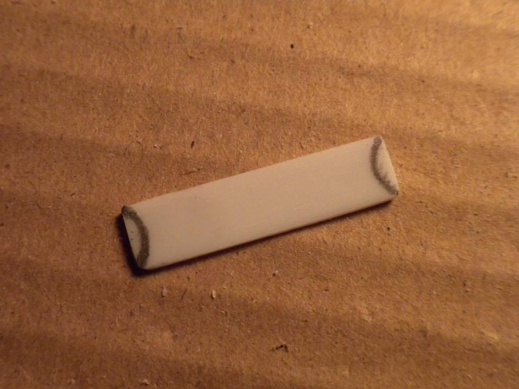

To help the flow I shaved down the corners of each bumper at the same angle as the body line and shaped them to fit the side skirts.
0191ca33c13353ab8d1e12ba94f06e48_zps8c2c
Added a little curve to the front of the skirts for more attitude.
I'll up load more photos to photobucket this weekend.

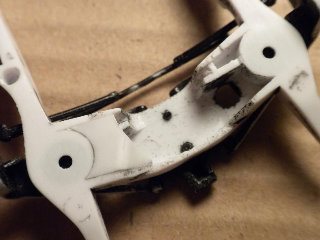

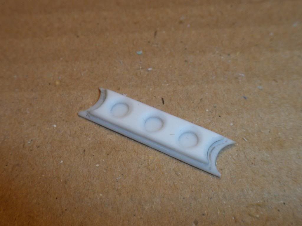

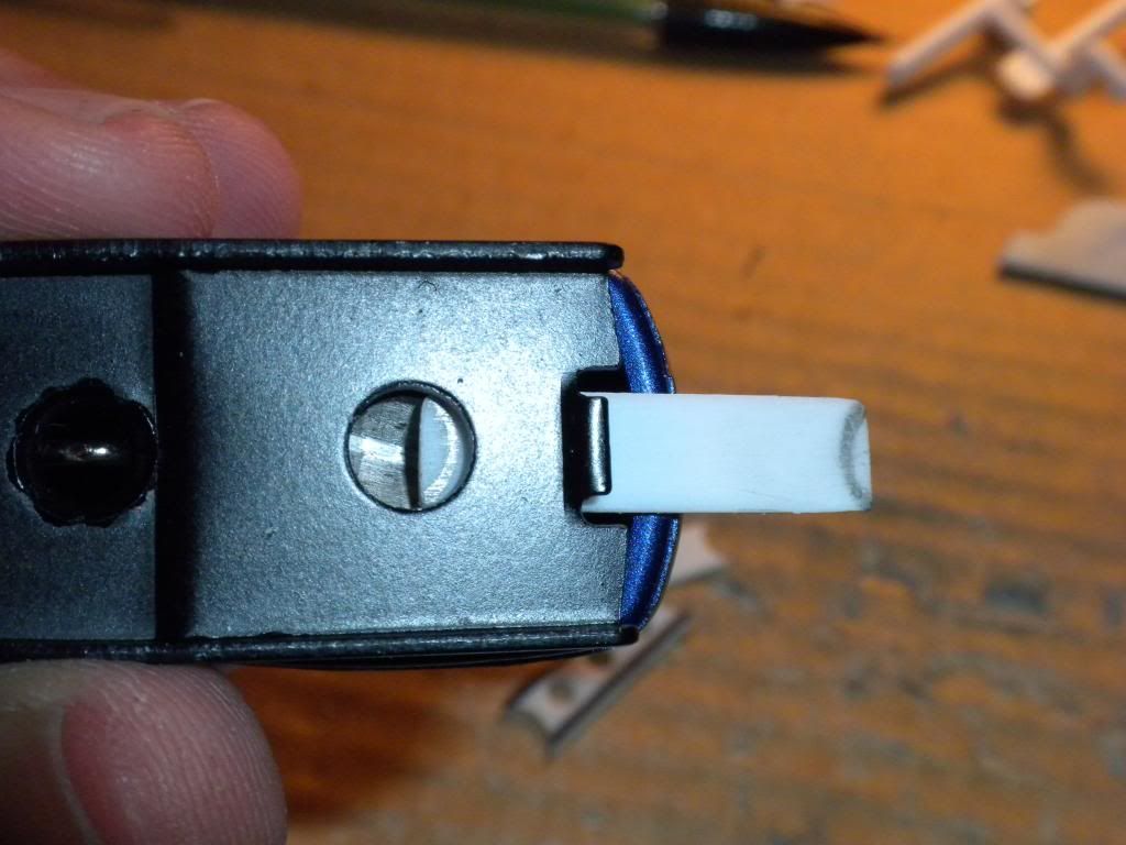

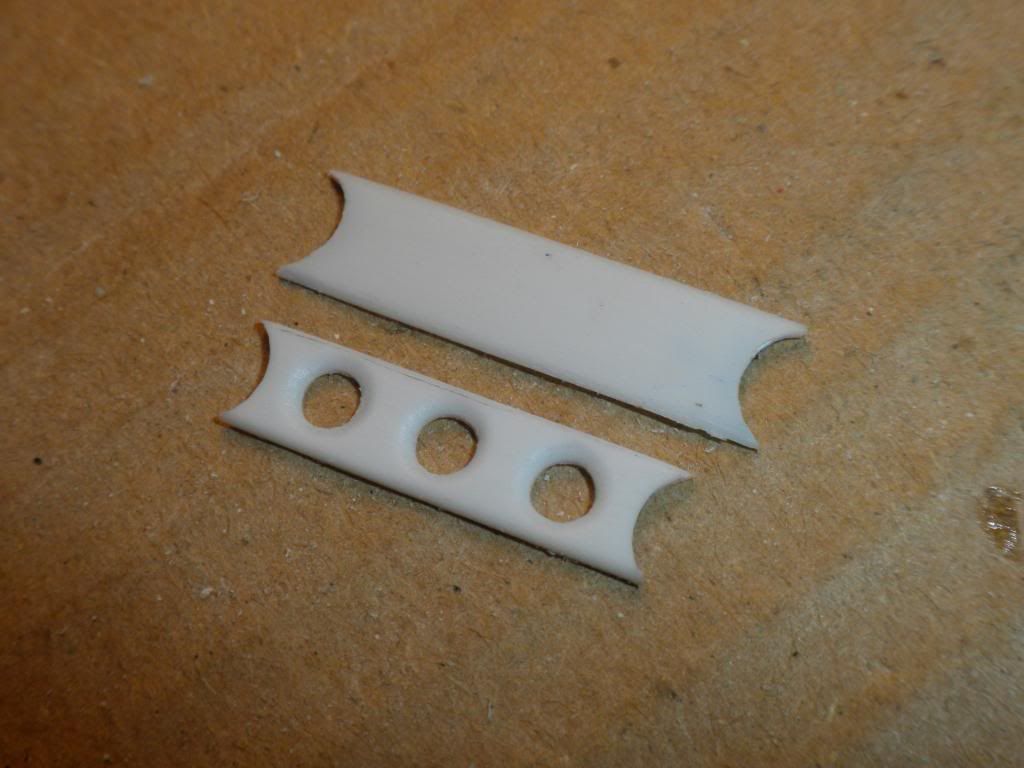

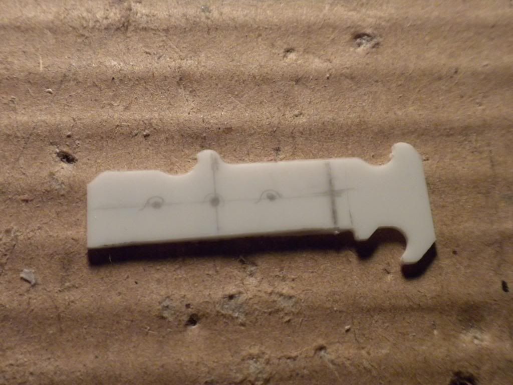

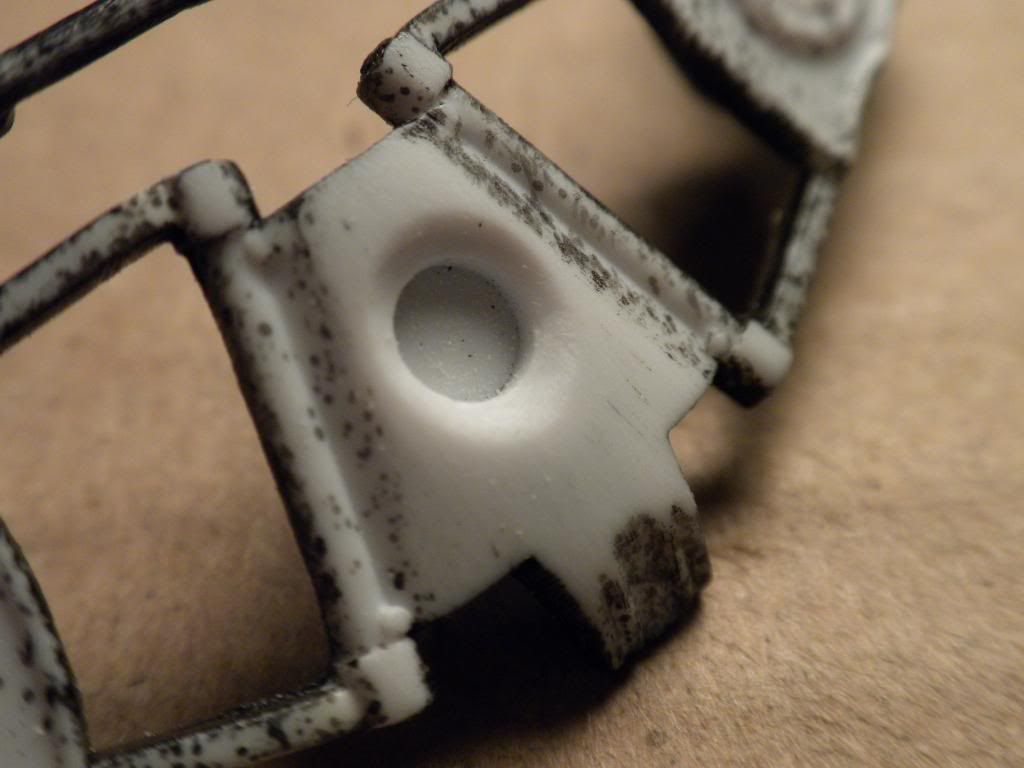

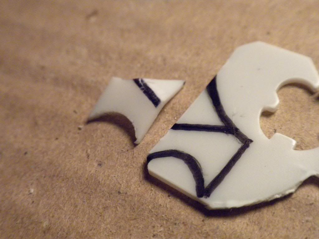

More Updates

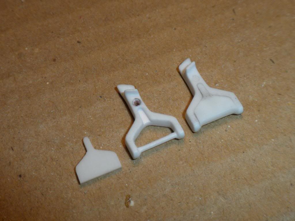

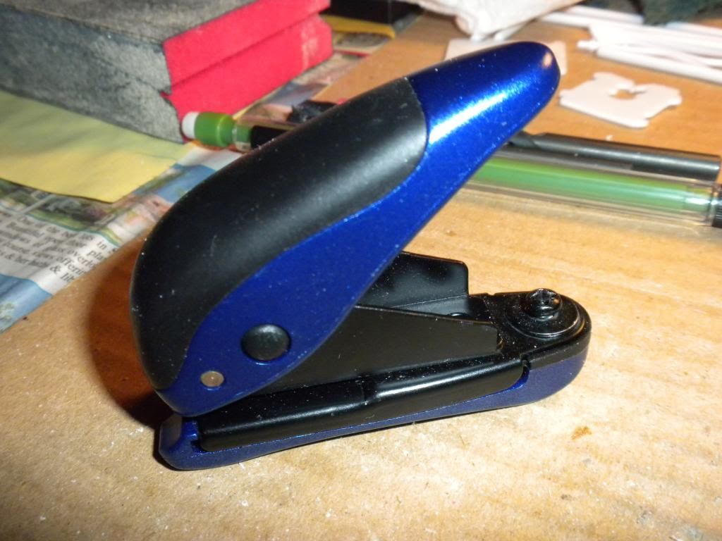

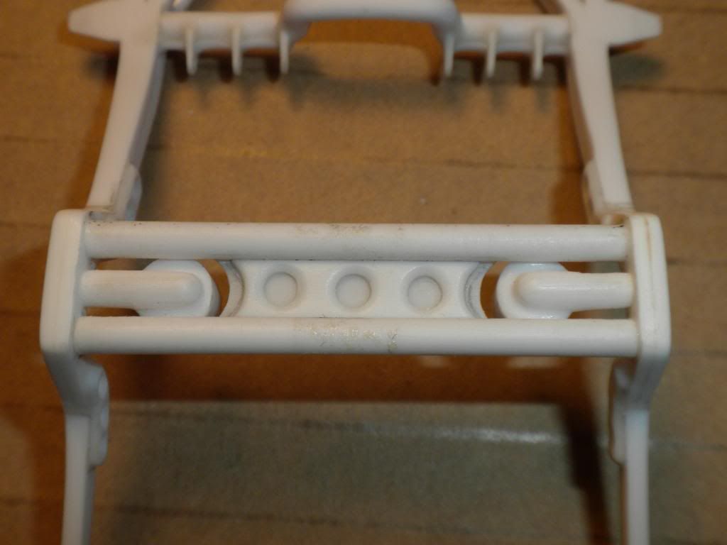

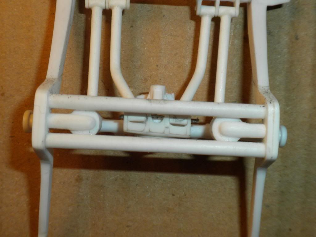

I really didn't like the look of the rear end through the bridge setup so I decided to clean it up.
The first piece was cut out then used my wife's hole puncher to cut the edges off. Works great when you unscrew the bottom, then you can see where to cut it.
I wanted the second piece to look like a metal dimple die punched it out. The dimples had to be the same size and spaced holes as the ones cut out in the middle section of the frame.
I used one drill bit to make the hole and another drill bit 2x bigger and turned it counter clockwise. Took a lot of test tries but that was the best way to give it a smooth look.

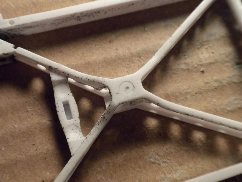

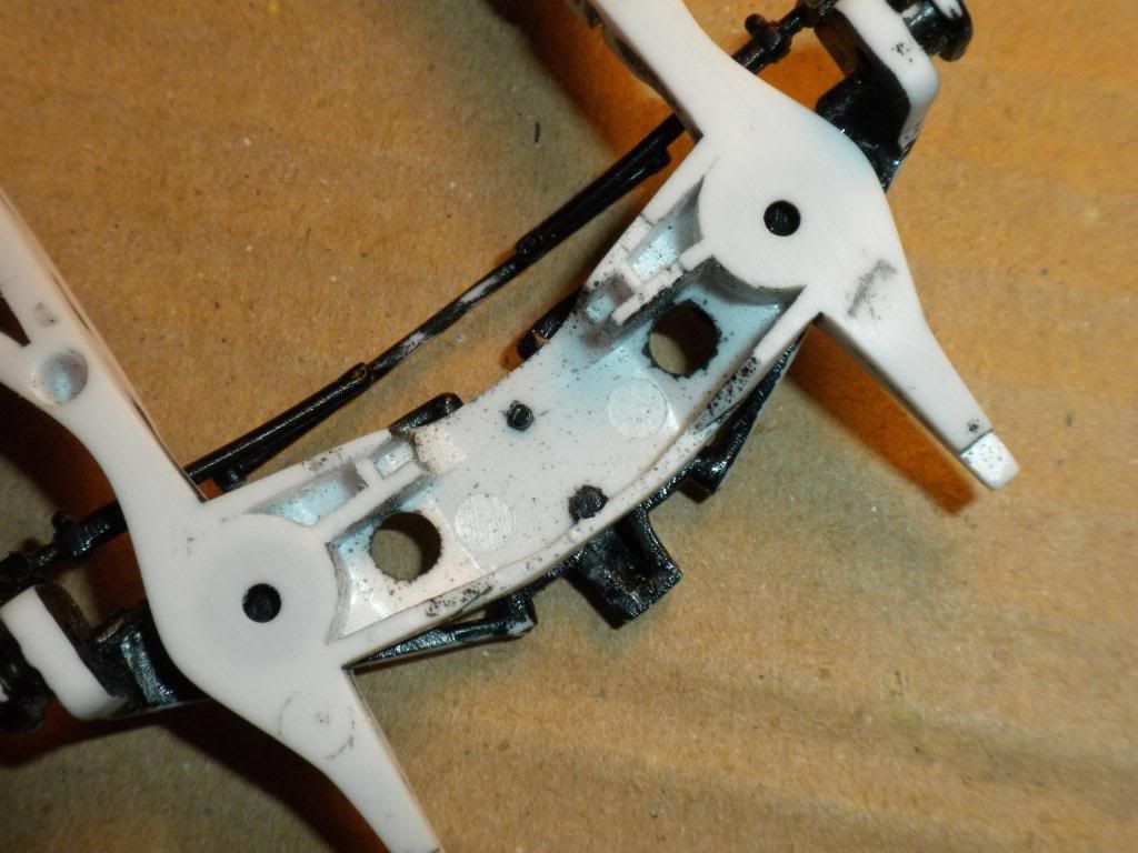

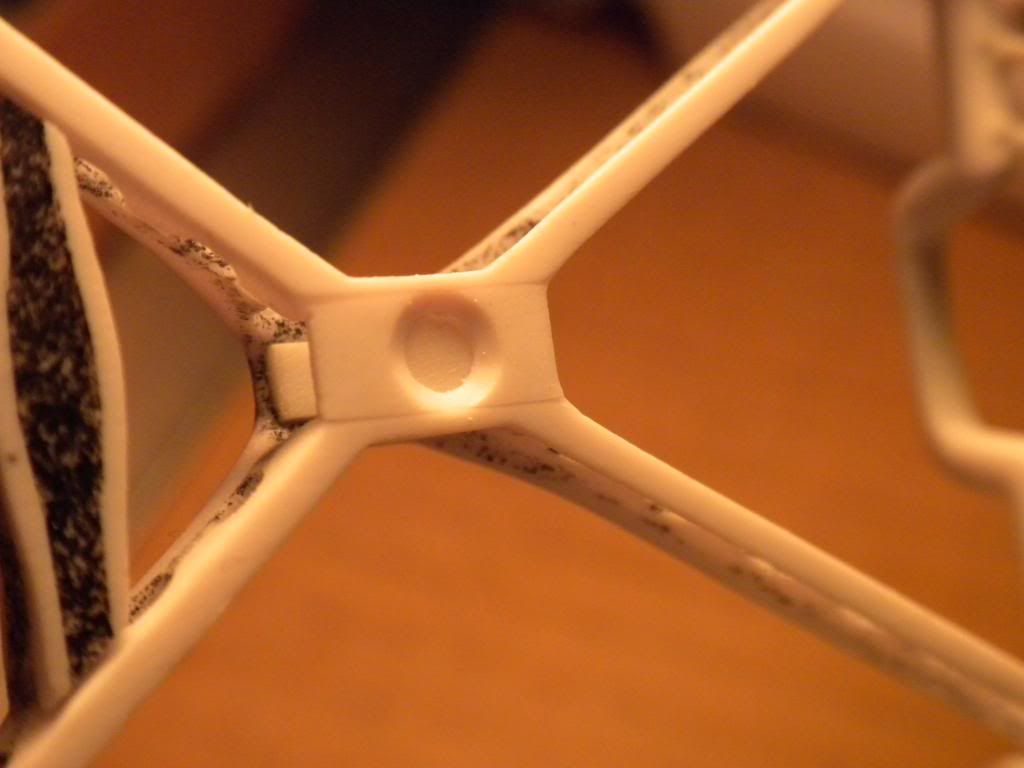

#239 JasonFL
JasonFL
  • 933 posts
  • Location:South Florida
  • Full Name:Jason Brackney

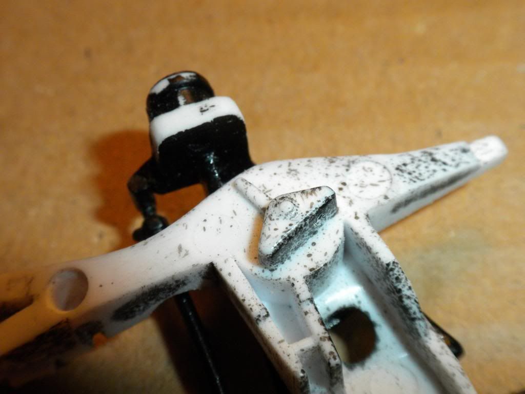

Posted 02 November 2013 - 09:54 PM
This hole was already there so I figured why not make it match.
Then I added this accent dimple to both sides just for the hell of it.
Why not the upper control arms.
Edited by JasonFL, 02 November 2013 - 09:58 PM.

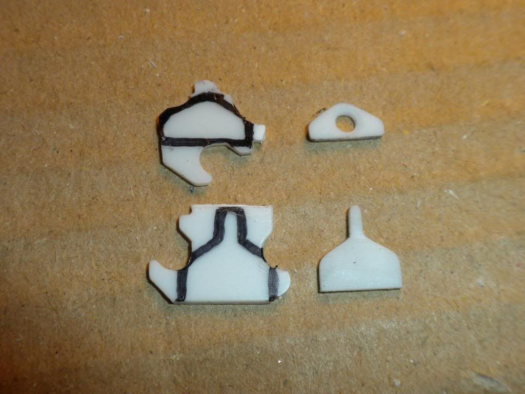

#240 JasonFL
JasonFL
  • 933 posts
Posted 02 November 2013 - 09:59 PM
With such nice control arms now this area just looked ugly as sin so I cleaned it up.
Much better.
