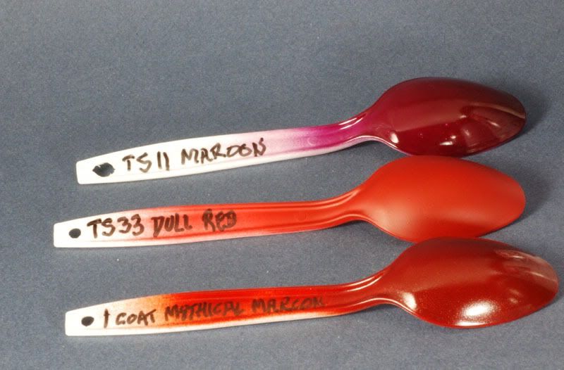

Not much for an update but the nose is taking better with lots of sanding and shaping. Time for some body putty now. I like how the extension has pushed the front of the hood forward in profile.
Posted Image
Posted Image
I got lucky at the hobby shop an hour away as they had two of the Maroon colors I wanted to try. Also got some flat red. Mow I have to put some Candy Apple Red over them to see ow they look. I might have to try some darker primer as the white spoons made them look pretty light

Nose is looking good. I like the first red. Has a little tint of that plum color they used on the prowler mixed with a hotrod red. They all look like some nice colors, I'm starting to really like the flat red more and more.

The first red ... Tamiya TS11 Maroon looked way off when I first sprayed ... thought it was too light compared to the can color, but it's looking better the more I look. The color itself is nice. We'll see when I put some candy red on top of it. I may try some darker primer in another test .. just some of my usual grey undercoat.

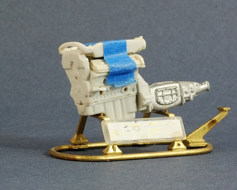

Posted 19 September 2012 - 05:42 AM

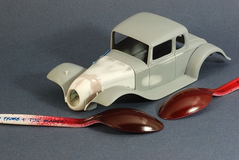

Been awhile but I HAVE been working. I ended up gluing the hood and nose the get everything blended. I'm not sure if I'll cut apart in the end or just leave as is. Having the nose on body while the engine is exposed will be better but maybe I'll just hinge the whole thing at the cowl. This is the first coat of putty sanded a bit.
The spoons show the paint I decided. The darker one is with a black undercoat and that I will use.
Posted Image
I moved the motor mounts almost a quarter inch up on the engine to clear the hood and got the mounting pins installed. Also got the mounts on the frame done and looks like the SHO engine will clear the hood. I'll probably gouge a bit under the hood to insure clearance also.
Posted Image

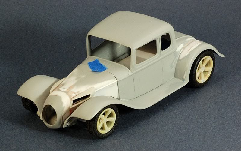

Posted 01 October 2012 - 08:21 AM

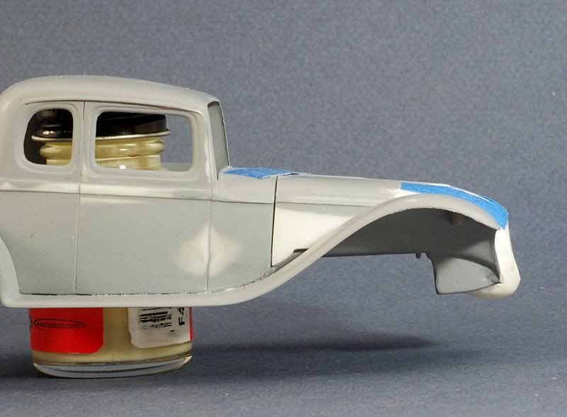

The hood was much more work than I thought, but half of it was reinforcing and re-gluing the joints! It just needs a little putty along the headlight pod edges before primer! I had to cut some pretty big holes to allow the headlights to slip in from the rear. The body trim was extended onto the hood with triangular strips.
Posted Image
Posted Image
Posted Image
Posted Image

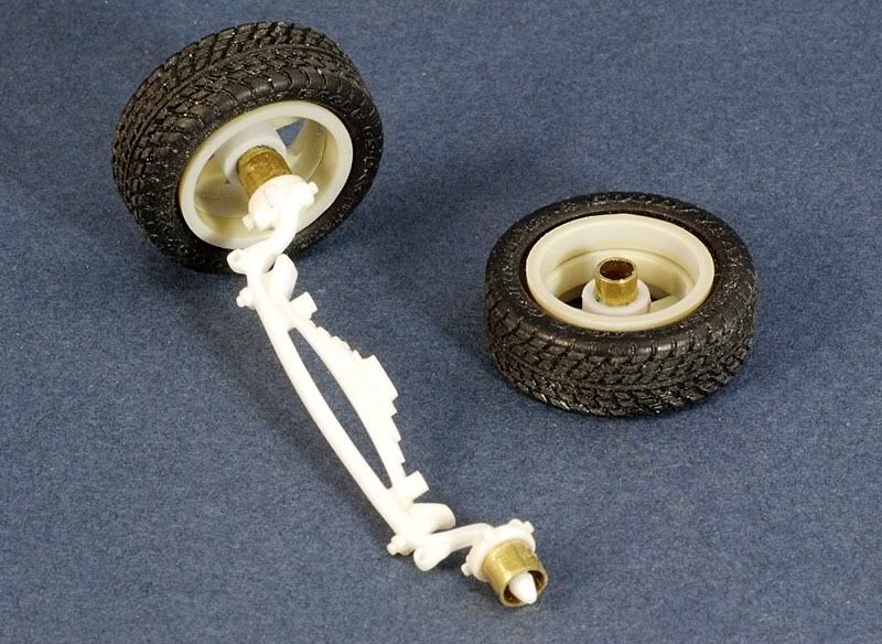

I also got the front wheels spaced and ready for mounting. It took 3 cylinders in plastic and brass for mounting. The rears are similar but only needed 2 plastic tubes.
Posted Image
