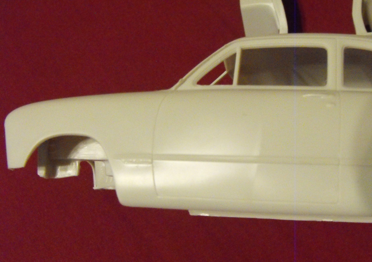

Thanks guys. I got tied up and didn't get to play with the body. This is not a great picture, but maybe you can sort of see it in the middle of this door.

That is not a disaster. Clean the body real well with some soap & warm water and scrub with a brush and some abrasive cleanser,then prime lightly and continue with the build. Don't forget to wash all the parts too.

As Mike said...paint that puppy!

What you may be seeing is the "flow" pattern of the molten plastic into the molds during the injection molding process. Styrene plastic is heated to the consistency of warm pancake syrup, then injected into the molds under tremendous pressure (upwards of 100-tons or more) and then the molds are cooled by circulating cold water through a water jacket which is quite similar to the water jacket in your car's engine. This solidifies the molten styrene so that when the mold is opened, and the parts ejected out, they are solid plastic parts. However, all the stresses pressed into those cavities of the mold will be present in the resulting parts, and upon painting with certain types of paints (lacquers, for example), those stresses tend to be "relieved" at least a bit, showing up as a pattern of "frosting", even severe crazing on the surface of the model part (body shell). Sometimes, those flow lines, especially on the largest surfaces of any model car kit (the body shell) can be visible, even felt at least slightly, but they can be dealt with almost always.
