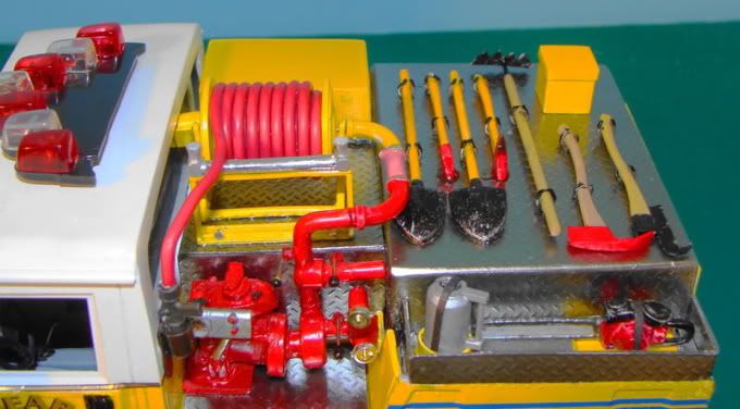

For you fire apparatus modelers out there, take a simple flat round headed pin and file the top and bottom 1/3 of the pin off to give yourself a "T" handled valve. This type is commonly found on a pump panel and pulls outward. For gated type valves, cut a small piece of plastic rod or sprue. Lay the disc flat and drill a small hole the diameter of the pin(round headed pin) into the side. Cut the pin to length and glue in place. Below is an example of the gated type ball pin valves:
Posted Image
Hope this helps.
