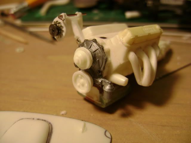

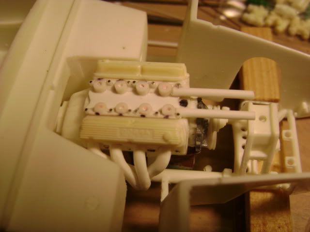

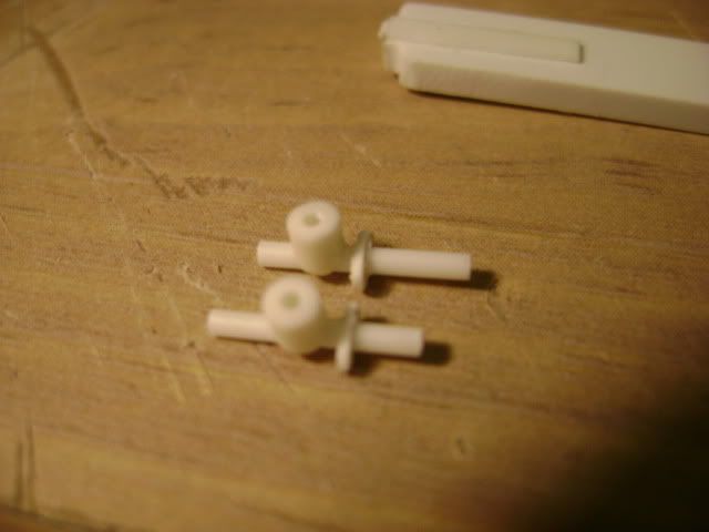

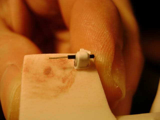

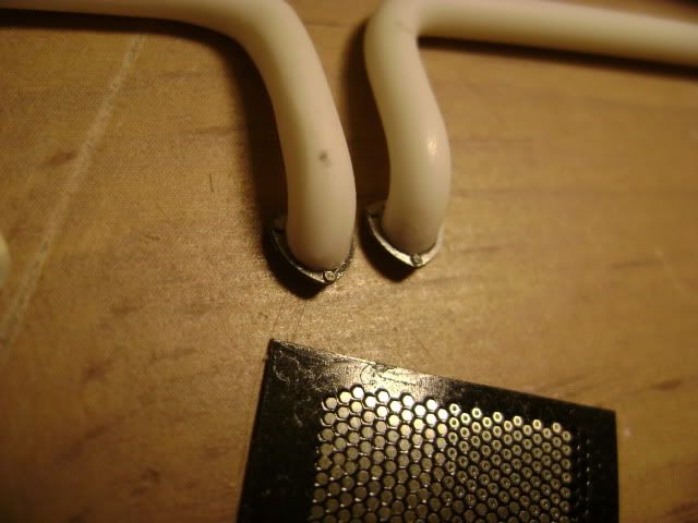

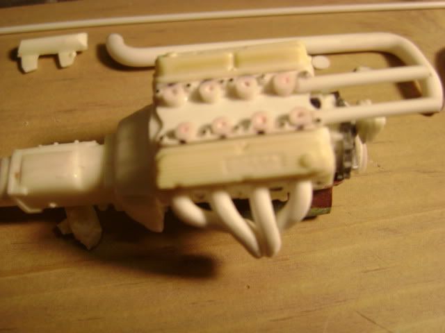

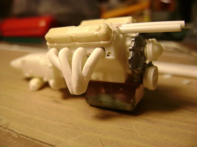

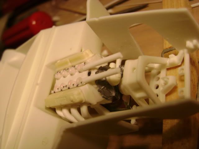

I got some time to work on this beast today. I swore I would not make this a stalled, super detailed build and, well...
I did a white glue build up of what I have so far on the motor. Today, I added the bolt detail to the intake and flanges and bolts to the side pipes. I also cut the pulleys off the belt assembly and did some re-shaping. Then, stuck them in my poor-man's lathe (drill) and cut a grove in each. I also added a harmonic balancer (something that always seems to be left off the engines). There are pictures of the motor a-la-cart and of it sittin pretty in the bay.
Posted Image
Posted Image
Posted Image
Posted Image
Posted Image

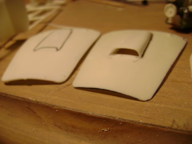

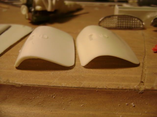

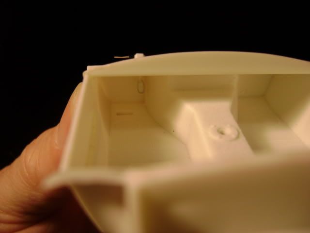

Other things I did but don't have pictures of are cut the hood scoop hole, glued on the scoop and then thinned the hood to the thickness of the tab pockets, trimmed the hood opening and added a thin piece of sheet plastic to create the shelf the hood sits on. I'll use thin black wire to adjust the hood to sit flush with the body at the same time imitating the weatherstrip. I tried bending a hood hinge last night but gave up after about 3 tries. I also opened up the ducts on either side of the grill just as the 1:1 Executor had. I also got some of the 2.5mm ferreles and they are going to make the carbs really stand out. They are wonderfly thin and being copper, don't take all that much to cut and file down to the right size, and since they are tin plated, they look good. Thanks for following my never-ending high-detail torment...

those flanges look great!

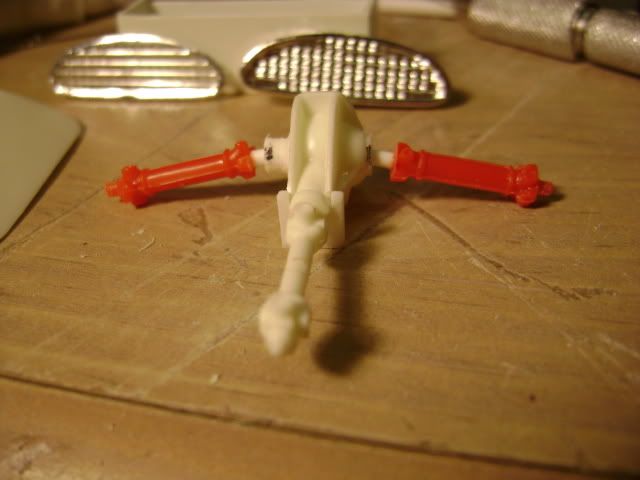

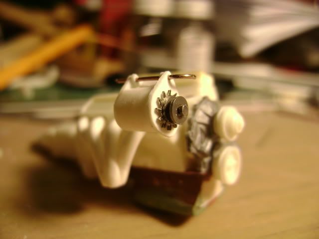

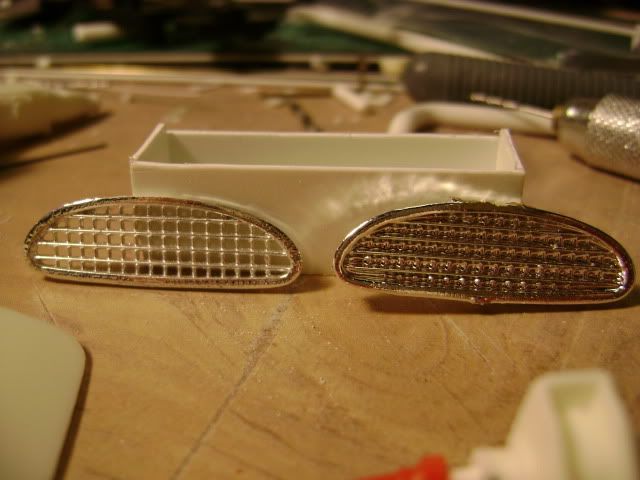

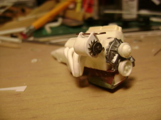

Got a bit more work done on this little Ferrari slaying beasty. Got the decals to do the Coventry Motors Executor along with a few other parts from HRM. Started working on the generator, pully and mount. It's not exact but looks fair and eleminates the "magic" alternator/generator problem that plagues so many models. Also worked on thinning the trunk lid, trimming the rear differential, the red half shafts are from a doner Vette. Have a bracket on the front of the differential so it does not hang mysteriously in it's place. Still have to create the top mounts. I have also started creating a fuel tank for the trunk. I added two little filler pieces to the front wheel skirts to fill the area behind the grill. Speaking of the grill, the Executor uses a stock grill painted black. I don't like slab type grills you can't see through so I took some time and began sanding the back of the stock Cobra grill from the AMT kit. After quite a while and a lot of sanding, I ended up with a large quantity of fine, white polystyrene dust and the grill you see on the left propped up against my fuel tank sub-assembly. The untouched kit grill is on the right. Of course, comments and critisism welcome.

nice work on that grille! it looks so much better like that.........

Thanks Bryan! I am pretty happy with the way it came out too. I thought for sure the detailing was so shallow I wasn't going to be able to do it but, there it is. I'm still following that V12 '30 build!

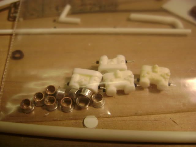

Ive been working on the kit carbs for a bit. I shaved off the trumpets for some made out of tin-plated copper crimp ferrules. Drilled a bit of a throat for a little depth and then drilled a center hole for the little tube that goes in the center of that. I also drilled linkage holes, glued really thin pieces of wire in them and small pieces of insulation over the wire for spacers. I also drilled a small hole for the float level adjuster nut. Other than that, I don't think I am going to much further in accuratizing the carbs. The kit carbs are way off but with the mods I have done, they will look good and a bit more accurate. I can't wait to see the linkage all together! Here they are, bodies and trumpets waiting paint and assembly

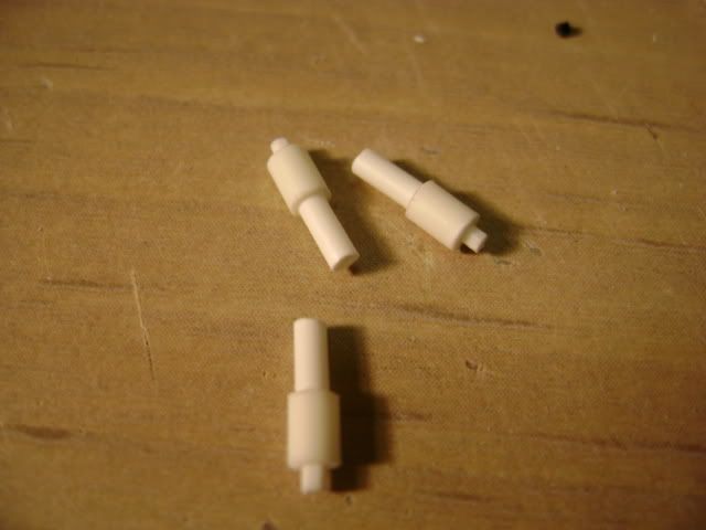

Here is the accurate ones. The real ones are fluid cans with clamp type brackets mounting them to the front of the driver's footwell. Here, you see the body, the hex fitting on the bottom of the can and the cap (yet to be cut down to size). Still got to build the brakets.
Posted Image

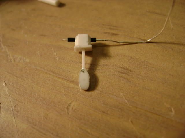

Now, the piece I'm pretty proud of. I created the gas pedal assembly from three pieces of plastic, one piece of wire insulation and the kit gas pedal. I created the basic shape then laminated a strip across the top, then cut and glued to a mounting plate. Then drilled the bottom for the thinned kit gas pedal. Finally, I drilled a hole in the top of the driver's footwell for the pedal to hang down from.

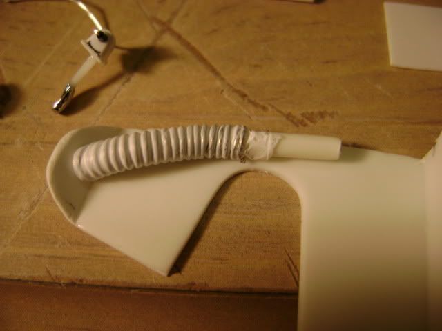

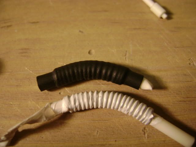

Now, some experementing with making the passenger vent hoses. The black one is plastic tube wrapped with wire with heat-shrink over it. Looks okay and is already black but lacks definition. The white one is something I read about somewhere. Same plastic tubing and wire wrapping but used teflon tape, the type used for plumbing connections to wrap it. The second pic shows it bent into a rough shape for the tubing.
Posted Image
Posted Image

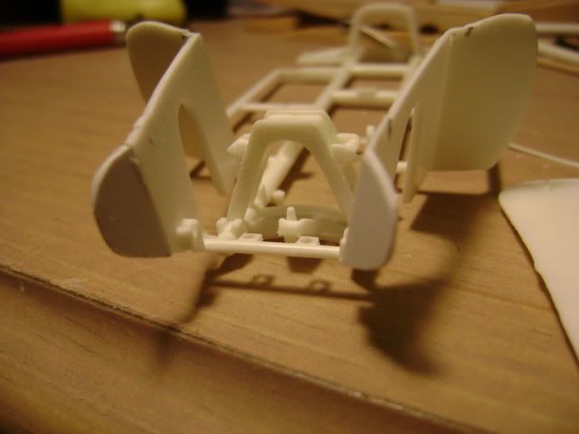

As you can see from the last pic, I separated the fender skirts from the frame as well. That should help with the detail as well as I will most likely thin those too.

Andrew this is looking great! May I ask where the PE bolt heads, nuts, and alternator blade are from? Your doing a super job!

Thanks Shucky! I can't remember where I got those nuts/bolts from but it had to be over 20 years ago. I loved them because they are on that black rubber piece and had no tabs to deal with. I wish I could find more. Maybe Replicas & Miniatures of Maryland? The alternator fan is from an engine detail set from Detail Master. I would love to find someone that just sells a sheet of these fans as I could use that much more than a the rest of the set. Just did some research and it appears DET2510 has FOUR fans plus brackets and so forth. Looks like I found what I needed! The pulley is actually two little pieces out of a watch gear lot I found a few years ago (thanks to Cranky). I was looking at them and realized they looked very close to a deep groove racing pulley when put face to face and the hole is the right size for a small pin. I filed the head of the pin to appear like a bolt and voila! I think they came out very convincing but I'm a little partial...

Excellent build and great craftsmanship !!   I can't wait to see it finished.   Where were you able to got the 2.5 Ferrels for the weber carb stacks ?   I am currently working on six cobras, for a car hauler load.
