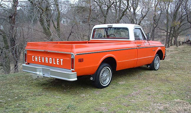

hi,thanks for the ideas on how to do the lettering,they will come in handy when i do the 72 stepside.i should clarify what i want to do,this picture shows the tailgate lettering that needs to be painted.(it is even on the same truck that i am building) the kit is the AMT 72 chevy fleetside.any ideas??

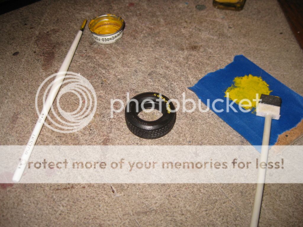

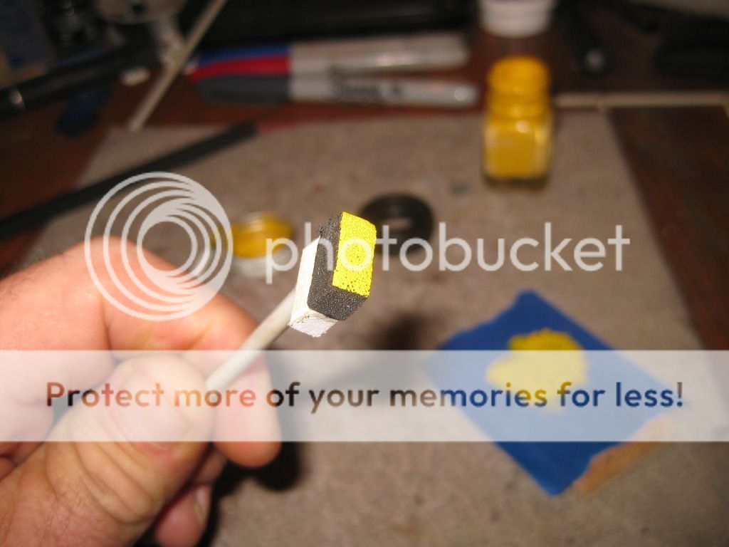

my technigue--as done on raised letter tires as well
Posted Image
in this pic is a piece of sprue, glued to a piece of square stock, and a piece of 3mm craft foam glued to it
loaded with paint
Posted Image
touch to raised lettering lightly, repeat if necessary
Posted Image
and here is results
Posted Image
this is enamal paint on a vinyl tire, treated with future
Posted Image
in this pic is a piece of C, and a piece of 3mm craft foam glued to it
loaded with paint
Posted Image
Posted Image
and here is results
Posted Image
Wouldn't a foam paint brush trimmed down do the same thing? No offense intended by what I am about to say and I apologize if I do offend, but that doesn't seem to deliver the cleanest end result.
The CD technique sounds like it would deliver a very clean looking end result, but seems like it would also be very frustrating not being able to see what you are trying to paint. So what if you combined the two.....
I can't say for sure because I haven't tried it, but in theory, I would think that using this setup without the foam piece on the end would give you the best of both worlds. The same smooth, clean application of paint as the with the CD, but with the ability to see and control where the paint goes.
I'm anxious to see how this idea would work. Who knows, it could be total garbage... lol
thanks-epi

I like the tampo method Garry demonstrated on the tires. Try using a 3M wet sanding (sponge) block they are like a 3 X 5 block of fairly dense foam (this is a "harder" foam than shown in the demo), you can cut a whole lot of little blocks from it too. The smoother the finish if the foam, the smoother the transfer and paint laydown onto the painted surface. I would also use enamel paint to spray or tampo the raised letters.
