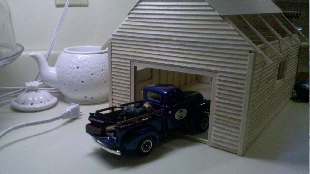

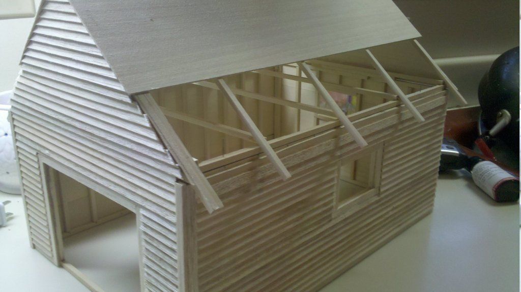

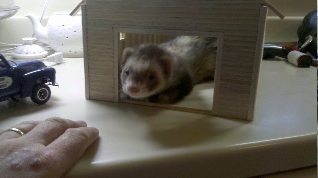

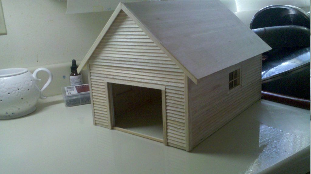

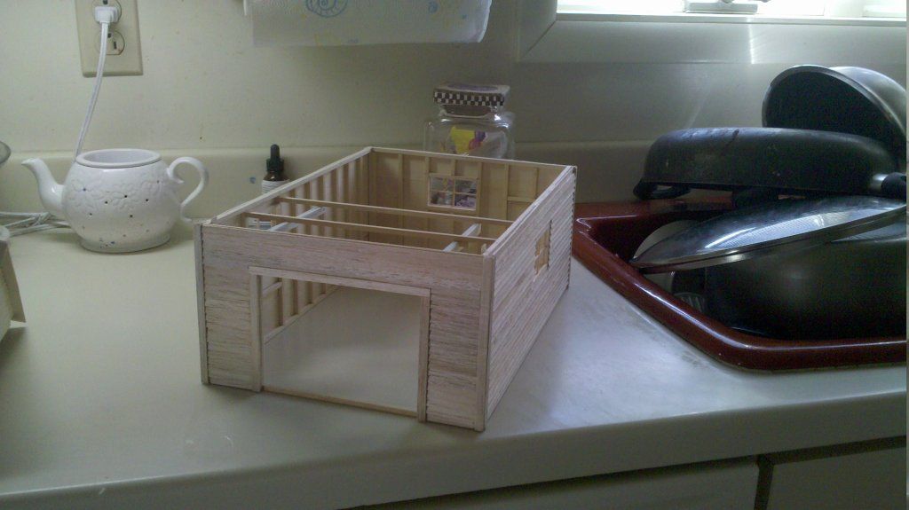

I finally got the front and rear of the peak up and put siding on. I have alot to do to get rid of all the gaps in the siding. I am also going to extend the front and rear of the roof out more and add soffet and facia (not sure if thats how you spell it, but oh well). I had also added 2 more windows on second photo. My ferret (Willy) convinced me that I really need to get a garage door on to keep the varments out.Posted ImagePosted ImagePosted Image

I've been considering a building similar, in that I was planning the same type siding application, so I was quite anxious to see how yours turned out. Looks good, but I'm wondering about the width-size slats (6" scale). They lend themselves quite well to either a vintage building that used the more narrow slats or a contemporary garage - would look fantastic whether weathered or painted. Still, did you at any point wonder if you should have gone a bit wider?
Really nice job.
Yes I do wonder if I should have gone wider, and I also wonder if I should have gone a little smaller in size, and if I should have made my peak shorter and I am still kicking myself in the butt for not putting a side door on. This is my first diorama ever, and as fun as this one is I will be definately be building another one more up to scale and planning ahead a little better than I did this one. This build was kind of just off the top of my head winging it kind of project.

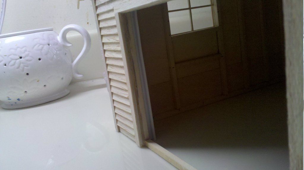

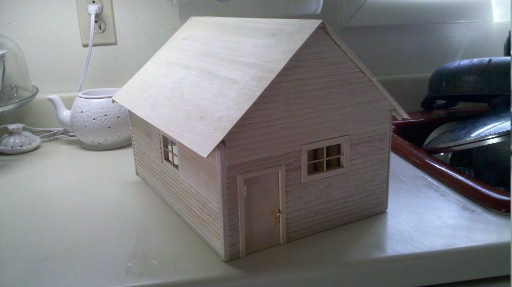

I decided to put an entry door in the rear. Let me know what you think. Posted ImagePosted ImagePosted Image

Well yeah. I garage should have a side door. Looks good. Do you have plans for the floor yet?

Wow, that looks great so far. You need to put some fire blocks between those studs though, or the building inspector's gonna shut you down.
By the way, I like your friend.

Well Jim I havent really decided on a floor yet. I am still not sure what I am going to do about roof as far as shingles or steel roof. I thought about shake shingles, but I triesd a couple rows of them , and it just doesnt look right.
Shardik, I am going to put fire blocks between the studs, but I am out of balsa studs and hobby lobby wont be getting any in for a week or so. If anyone has any ideas on a roof or a floor I would be interested in hearing them.

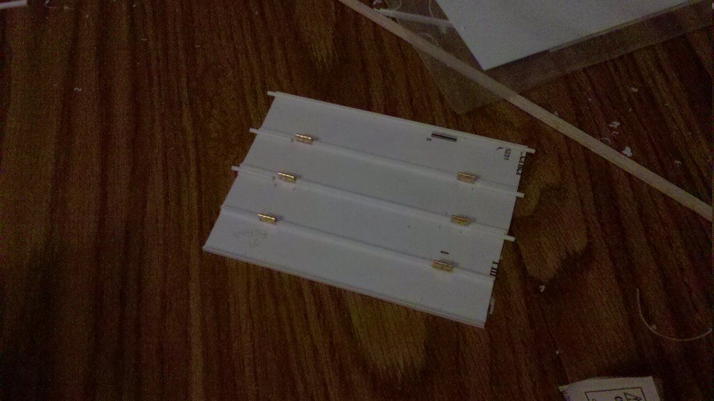

I am starting to make progress on roll up garage door, but it is putting up a heck of a fight. I will post a couple pics when I get off work.

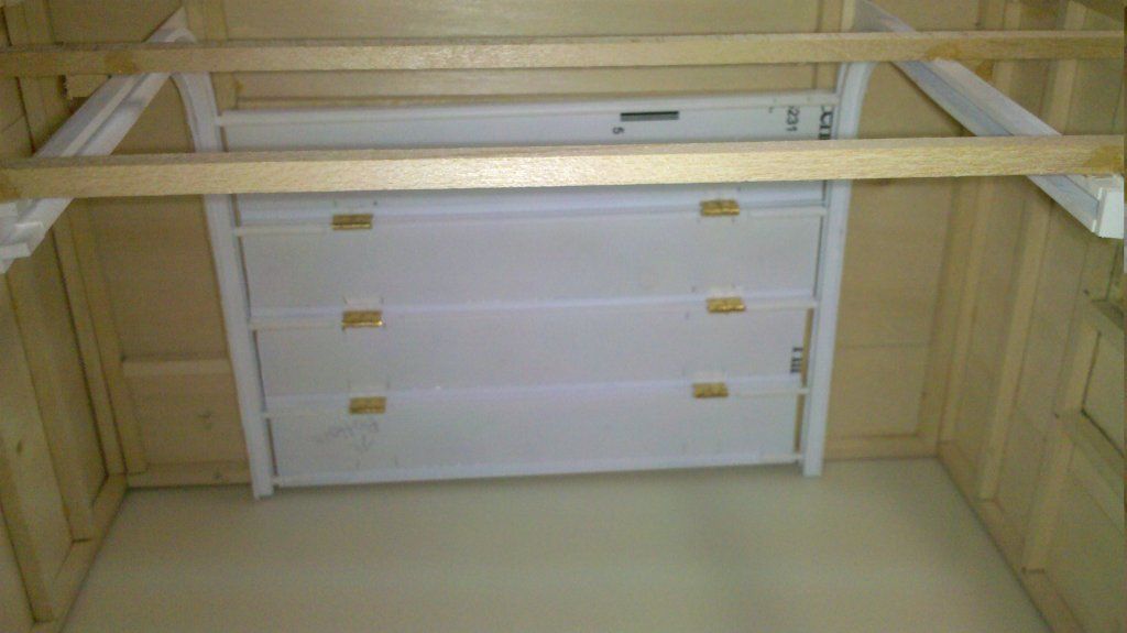

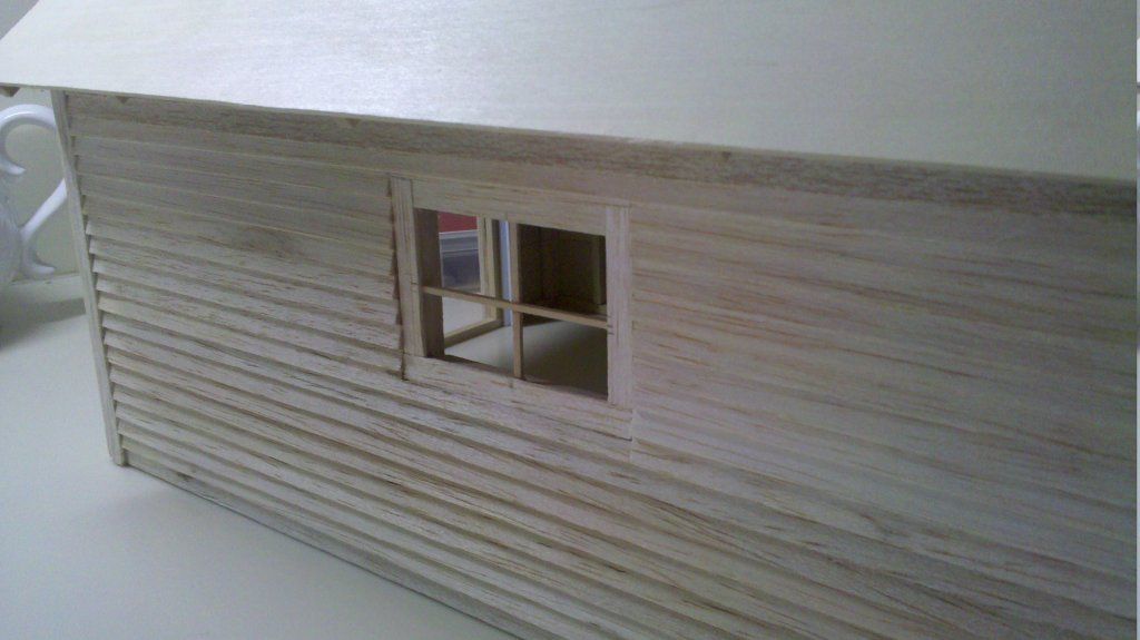

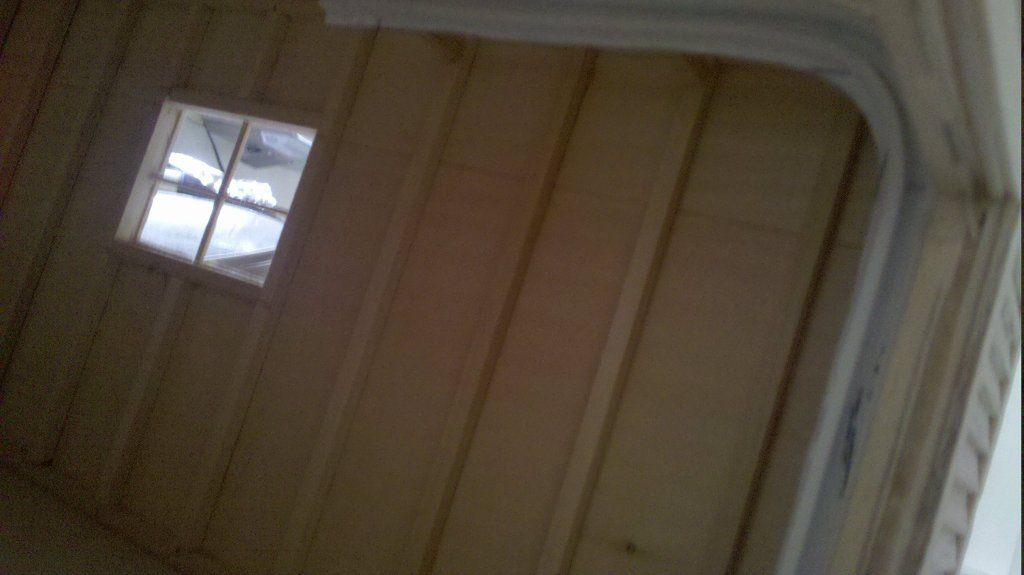

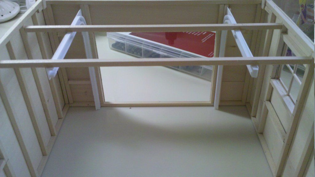

Here is where I am at so far. I finished the door railing and am now glueing the hinges to the door. I had problems with putting too much glue on my hinges and glueing them shut so they wouldnt move, so I had to do it all over again. I had also finished up all the siding and most of the trim. I am waiting on more balsa to finish trim and a few other exterior things before I shingle and paint. I am still not sure what I am goint to do for a floor. I really want to do a full diorama with a small yard and gravel driveway, but I dont have enough room to store it or to show it off.Posted ImagePosted ImagePosted ImagePosted ImagePosted Image

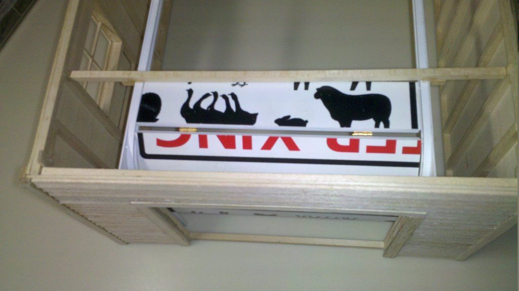

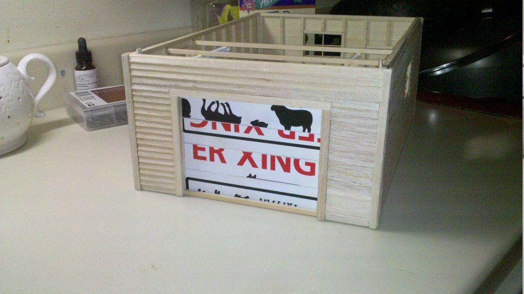

Here is a couple more, and 1 of the door (it is still drying, so I didnt want to turn over). The door will have a little more detail to it once it dries.Posted ImagePosted ImagePosted Image

Did you just bend some Evergreen channel for those rails?

Thanks Junior, and no Jim I glued two everfreen strips to a piece of styrene sheet and then cut around it later on. I tried using channel, but I couldnt get two seperate pieces to shape exactly the same.

hey jerred to make the side entry door i used elmers foamboard but its alittle to thick if you got some sheet styrene might work better. but icut the foamboard 1and 1 half inch by 3 and 1 half inch. then i put it between 2 peices of smooth plywood and pounded it with ahammer to make it thinner .For the window i cut the opening to the proper size and used clear cd case for the glass just scribe it 4 or 5 times useing a metal straight edge it breaks just like real glass .for the window trim i used square kitchen matches i painted mine white first then cut al the pieces .i glued the sides and top and bottom and let that dry then the center one let dry then the small crosstrim .after dry a drop of white glue in each corner then set the glass the doorknob i used stiff copper wire its a little smaller then house wiring coating removed cut to lenght you dont want it stick out to far it wont look right i used BBs for the knobs use gel super glue for these HOPE THIS HELPS its not done yet i need to do a little fine tuning yet.some more trim oh i forgot grind the copper door knob thingy flat so the BB glues solid to it.Attached File  door.jpg   131.09K   8 downloads

Thank you Maynard that tutorial will help out a lot to redo my door.
