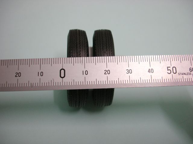

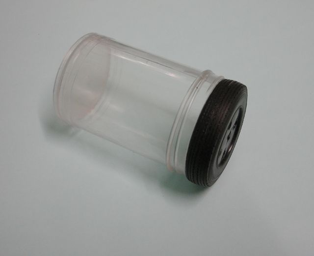

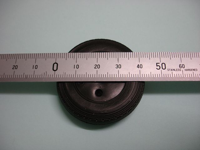

Start by measuring the tyres diameter and width.
Posted Image
Posted Image

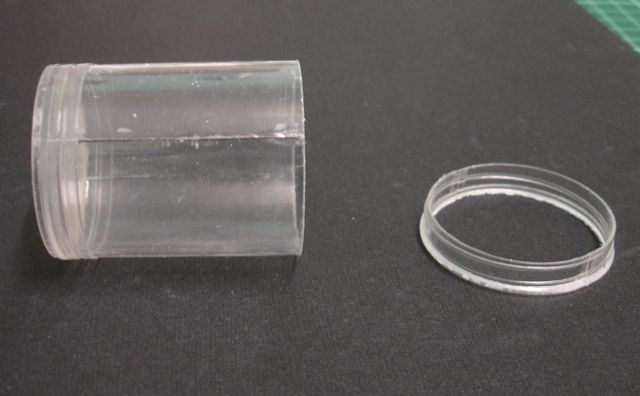

Find a suitable container that is simular in diameter to the tyre and has a seam going down the centre on both sides.
Posted Image

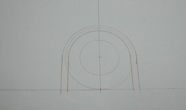

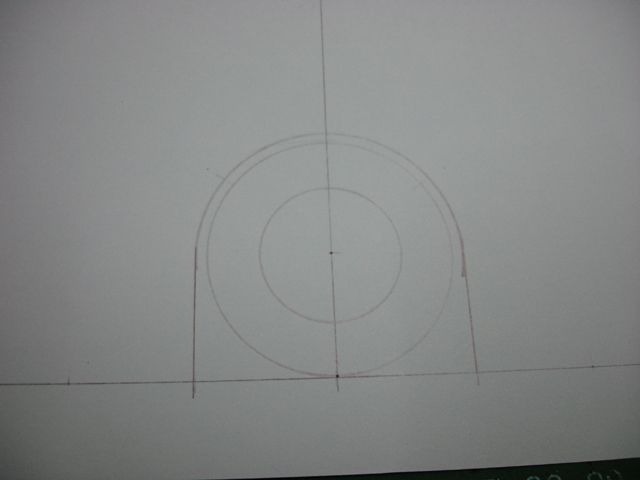

On a piece of paper or cardboard,with a compass draw the tyre diameter,then add 2mm and draw the
outside shape of the guard/fender.
Posted Image
Subtract 4mm on the compass setting and draw in the inner lip.
Posted Image

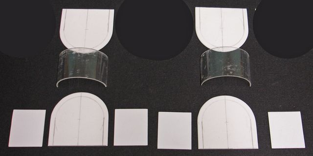

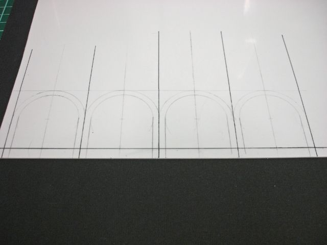

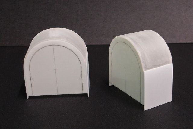

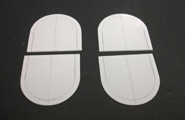

Transfer the drawn dimension's from the cardboard/paper to some 1mm styrene sheet x4
Posted Image
Cut out,shape the top radius and sand a small bevel/angle(hard to see in the pics) around the radius and side edges.
Posted Image

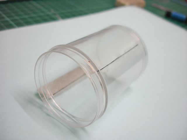

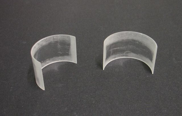

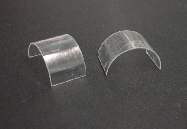

Mark the centre seam on the container.
Posted Image
Using a razor saw cut the top portion off using the lip as a cutting guide.
Posted Image

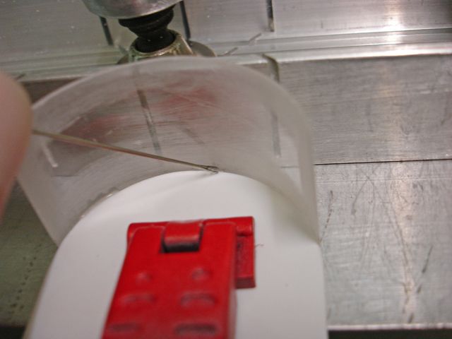

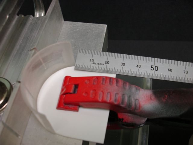

Add 4mm to the width measured from the tyres earlier and set a compass to that measurement.Using the top of container as a guide scribe around it.
Posted Image
Using caution and go easy as the container will break if too much pressure is applied.
Cut the width first then cut along the seams.
Posted Image

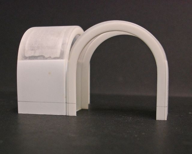

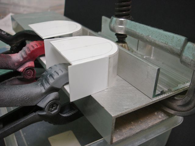

Cut some more 1mm styrene to the width dimension's and the length of sides with a few extra mm added.Sorry didnt get a pic of this but the following pics will explain.
Overview of components
Posted Image
Scuff the inside edges of the top radius piece with a coarse sanding stick or 320 grit,this will help the ca glue adhere better.
Posted Image

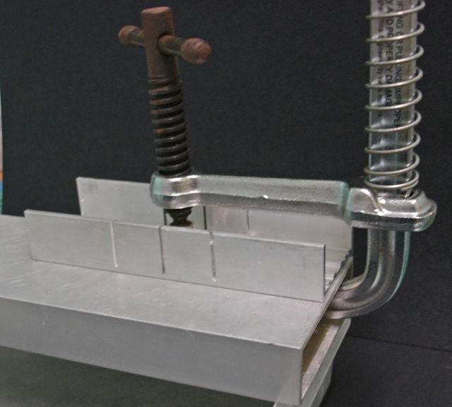

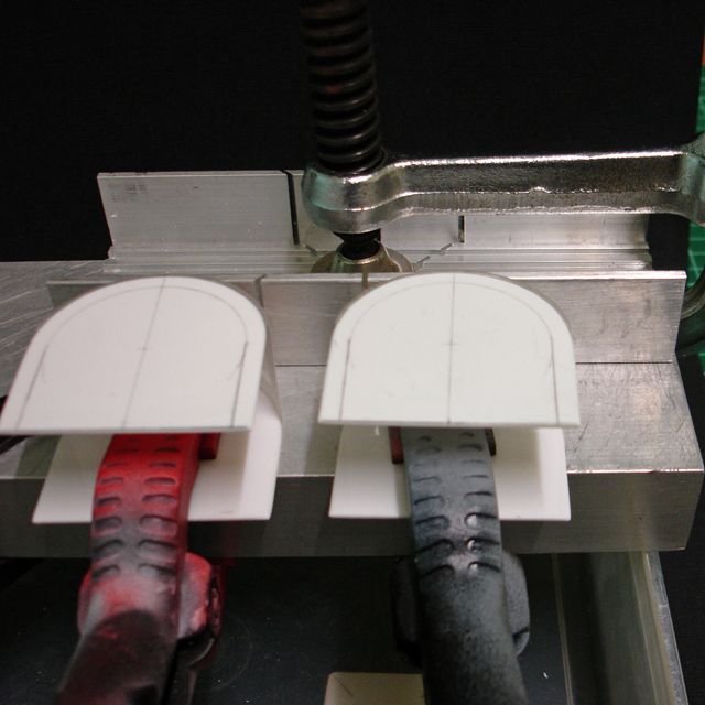

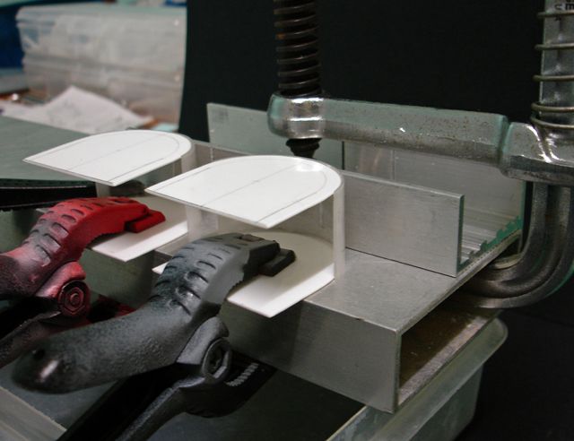

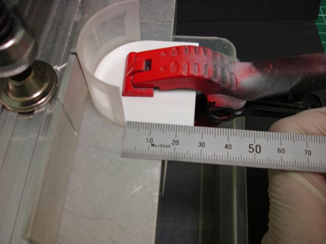

Set up a jig simular to this.
Posted Image

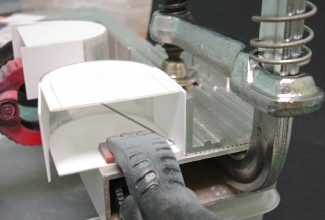

Postion the radius piece against the back,postion the other piece with lines facing down and clamp it.Measure both sides making sure they are equal.
Posted Image
Posted Image

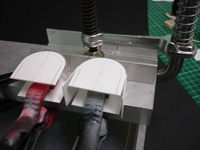

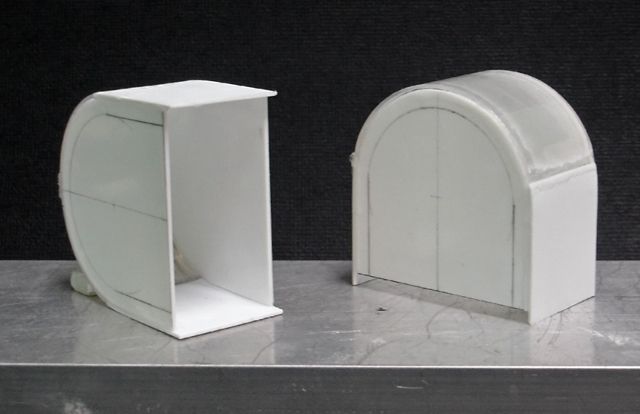

Using ca glue run a good bead around where the pieces join.Allow time for the glue to set.
Posted Image
Flip it over and repeat the previous steps,dont forget to make sure the lines are on the outside.
Posted Image
Posted Image
Postion the other side pieces ,but only glue them to the edge of the radius piece.Allow glue to set.
Posted Image
Posted Image
#73 Cool Hand
Cool Hand
  • PipPipPipPipPip
  • 408 posts
  • Location:South Australia
  • Full Name:Luke
Posted 21 September 2012 - 06:25 AM
Continued.
Reposition the side against the back and push the pieces together, clamp and glue.
Once glue has set up repeat for the other side.
Posted Image
When fully made, run a bead of glue over all the joins inside and out.Allow glue to set.
Looks rough with all the glue on the outside.Next step will fix that up.
Posted Image
With 320 grit and a coarse sanding stick,sand and blend all the outside joins smooth.Try not to remove lines when sanding.
Posted Image
Posted Image

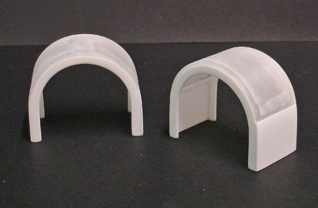

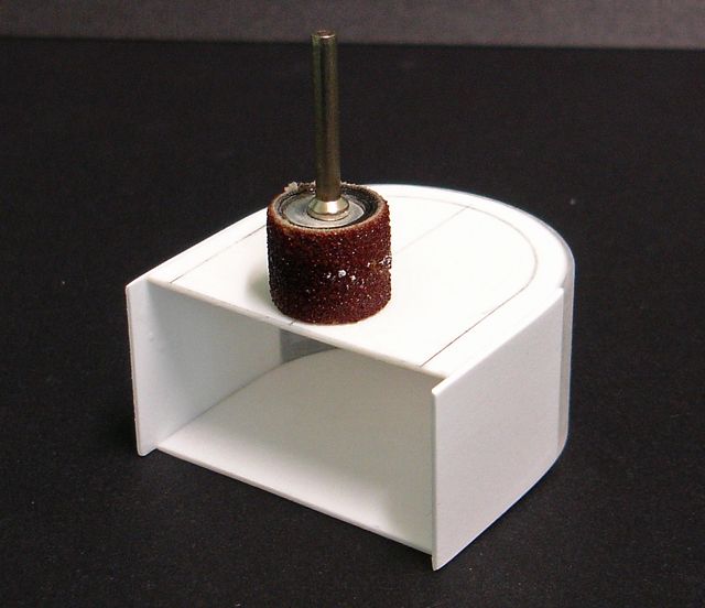

Using a dremel with a sanding drum attached grind out the inner shape of the guard/fender.
And remove excess material on the sides.
Posted Image
Posted Image
Edited by Cool Hand, 21 September 2012 - 07:35 AM.
#74 Cool Hand
Cool Hand
  • PipPipPipPipPip
  • 408 posts
  • Full Name:Luke
Posted 21 September 2012 - 06:32 AM
Continued.

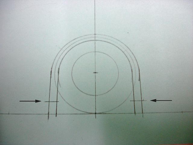

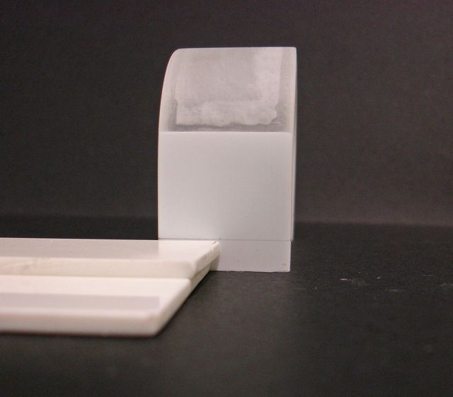

Work out how much ground clearance is required,i chose 6mm.
Posted Image
Find some sort of flat material that matches the ground clearance mesurement ,and use this a guide and mark the bottom of the guard/fender.I used two pieces of 3mm acrylic.
Posted Image
Posted Image
Mark around all the edges.Then cut off with a razor saw
Posted Image

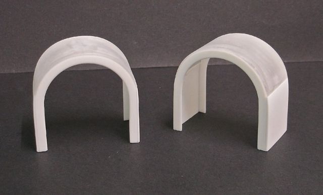

Well there you go thats how I made the guard/fenders.
Final step is de-burr and round off edges and sand all surfaces with 400 grit and they are ready for a coat of scratch filler primer.
Posted Image
Well hope that helps,probly many other better ways to make them.But this is how and what worked for me with the materials,tools and minimal skills I have.
