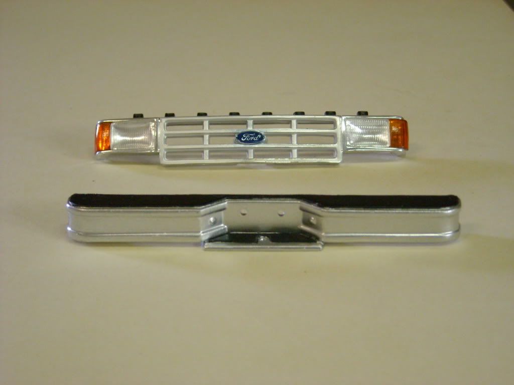

Beautiful Hudson, Art. Another option is Future. The badge on this grille was painted with blue enamel and then coated with Future.
Posted Image
