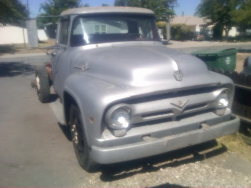

The F500 doesn't have the widened fenders like the F800. Here is a pic of a 55 F500
Posted Image
And a stock 55 F100
Posted Image
And an F800 with the wide fenders
Posted Image
The F500 is only a 5 ton truck, it may not really be worth it when I can also widen the fenders and have a much higher weight truck. I was thinking of making some kind of a medium duty wrecker, I have a couple of 53 Ford cabs laying around and was looking for a project that wouldn't need much body work.

The front fenders are the same width...just larger openings. The cab, hood, doors, dash..all the same. No changes.
I have a 56 1:1 and am in a F series club.

Ah, right- a 500 wouldn't have the wider fenders, just the larger openings. Wasn't sure at what weight class the wider fenders came into play. That being said I'll still see if I can get some photos/measurements this weekend, the guy should have a suitable reference truck out there.
