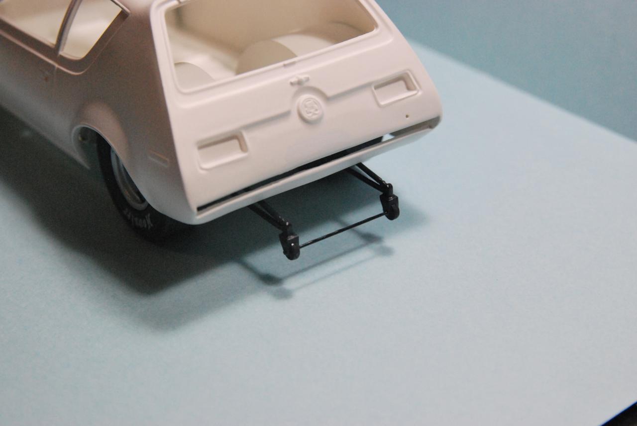

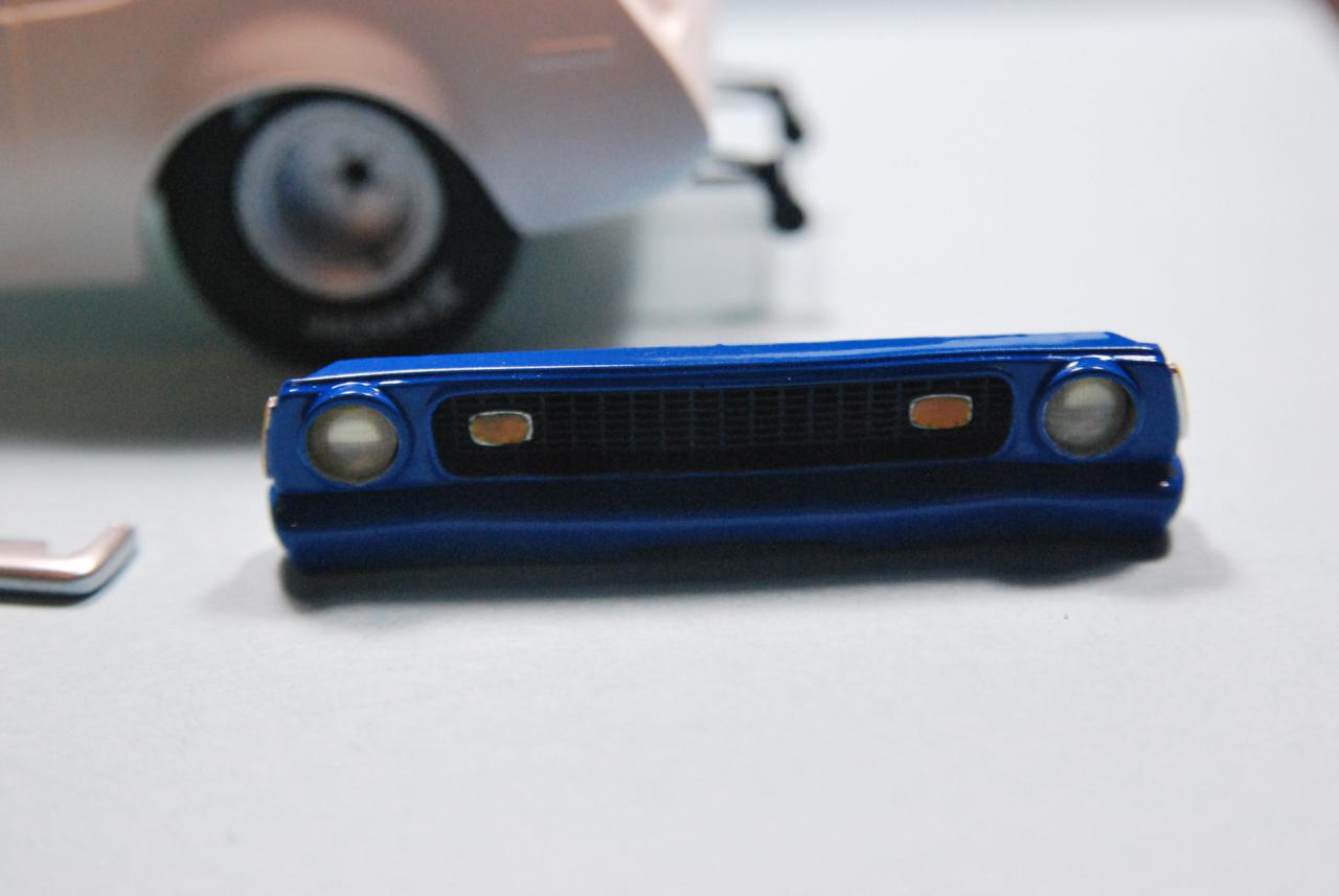

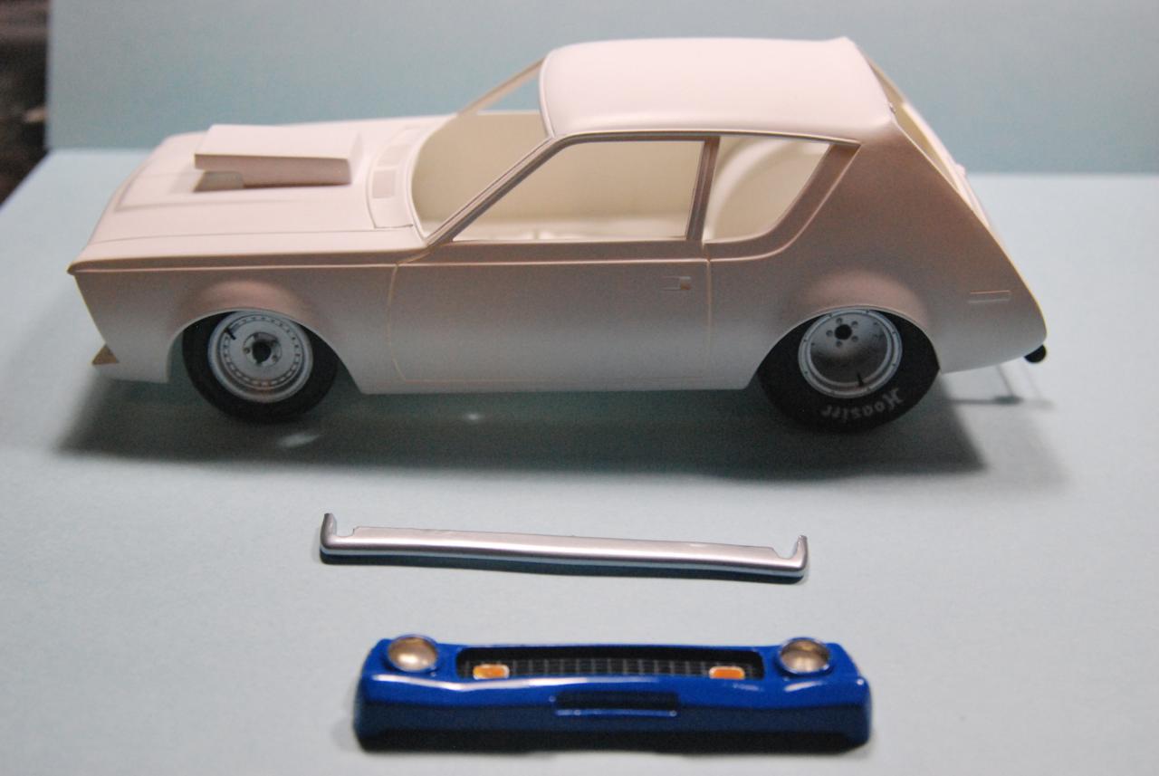

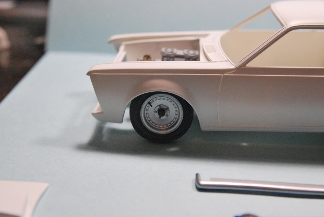

This is the Round2/AMT re-issue. I used the '72 front end from the AMT Gremlin Funny Car and modified the rear bumper to look like a 72-73 bumper. Paint will be Tamiya Pure White (TS-26), Tamiya Bright Red (TS-49), and Tamiya Brilliant Blue (TS-44) - all airbrushed. The chassis is a modified MPC Pinto ProStock. The hood scoop is a modified hood scoop from an AMT ProStreet Chevell. The engine is from the kit. The intake was augmented with an upper plenum from a Jo-Han Maverick ProStock. The carbs will be from a Monogram T-Bird ProStock. I matched the red and blue in the decals to the Tamiya paints. Decals are available from Scale Auto Details. I'll post more pictures once I make a little more progress. I saw the restored car at the York, PA show last year and had to build it. A ProStock with the aerodynamics of a brick! Go figure.

The Mustang II chassis has a slightly longer wheelbase than the Gremlin. The old MPC Pinto ProStock chassis has the same wheelbase as the Gremlin which is why I used that chassis instead of the Mustang II. I suppose one could shorten the wheelbase on the Mustang II chassis and make it work. To use the Pinto chassis only requires cutting a little off of the back and widening it with styrene strip, then it fits like a charm. I am also using the interior parts from the Pinto on this build. The rear bumper can be easily modified to mimic a 72-73 rear bumper by cutting the bottom off and molding it to the body as a rear pan. The resulting narrower rear bumper then looks like one from an earlier Gremlin. You also need the front pan from the Gremlin F/C. There may be a resin front end available to back date the AMT kit. I have not yet checked into that.

Another tip on this build. I cut ot the cowl panel on the Gremlin because the molded on windshield wipers went right over the vents and there was no way I could save the vents once I removed the wipers. I cut out the cowl on the MPC Pinto prostock body and it fit on the Gremlin with a little modification and the molded on wipers from that body did not go across the cowl vents. Problem solved!
