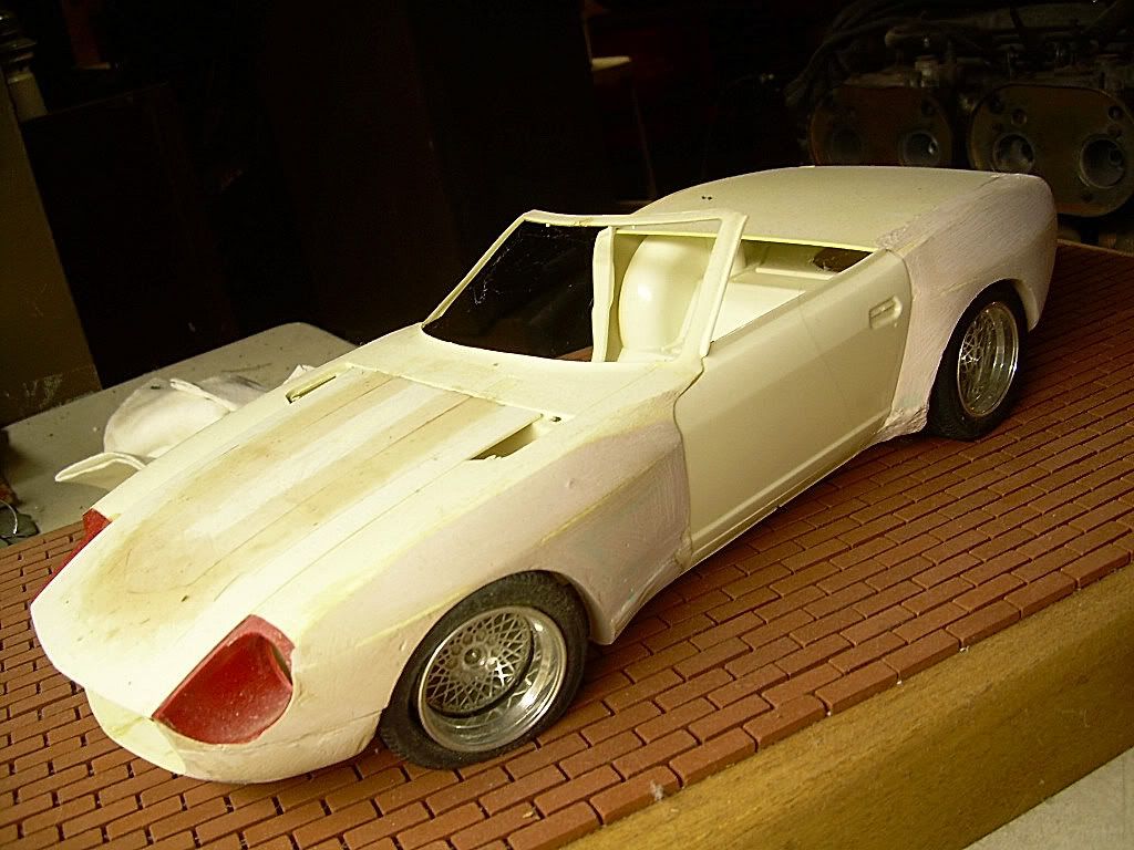

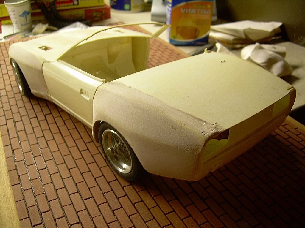

Tamiya 1/12 scale z-car kit, convertible-ized and fender-flared. Custom nose and hood treatment.
I built the first 1:1 Z-car convertible on the planet back in 1974-76. This will be what I'd build if I did it today.

Do you have any flare development photos?
I haven't done the passenger side flares yet...wanted to work out the process on the one side first. I'll post WIP shots as they get done. The plan is to take molds off of the completed flares and make them in scale-thickness (or close, anyway) fiberglass.

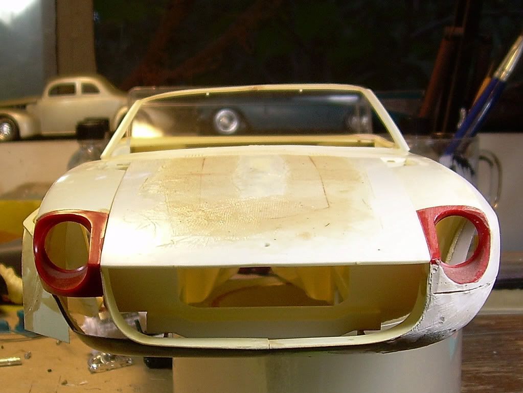

Here's the trick to making flares. .010 styrene lips added to the original fender openings. Character lines in the fenders extended outwards and tapered into the body with .030 styrene. Fill resulting areas woth bondo. Sculpt to shape.
Posted Image
Similar technique used to do nose cheeks. Bulge has been removed from hood, filled with sheet styrene, 'glass reinforced.
Posted Image
