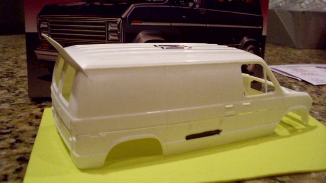

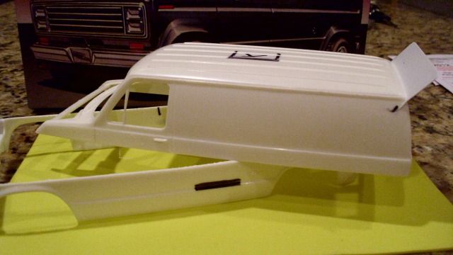

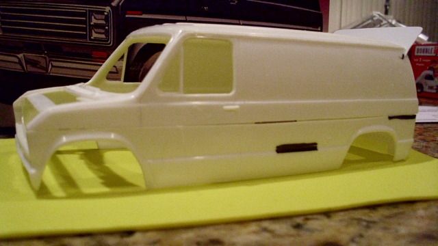

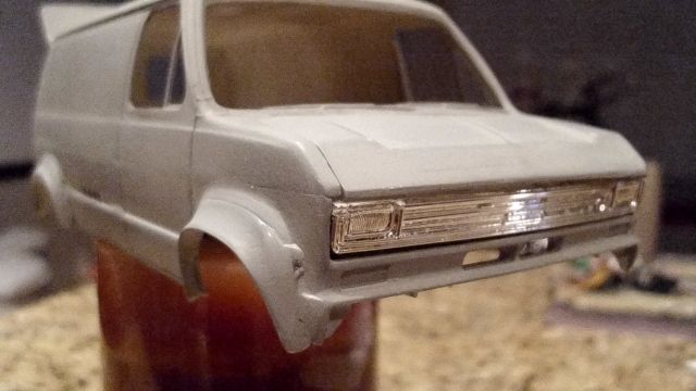

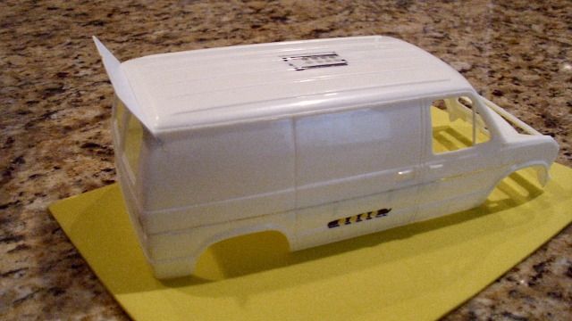

Someone stole the middle of my van !! I guess I will just have to run with it. I sectioned about a scale 6" out of the middle. The rear windows will be blanked out. I cut a slice in the body for the rear roof spoiler. I have a couple other ideas but till I decide I will keep them to myself. Thanks for looking.

Hi Ray, You are hard to keep up with all these builds :) :) Looking foward to what you come up with!
Nice work on removing the middle section.

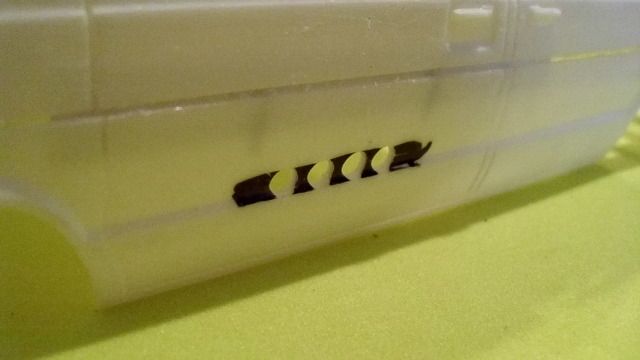

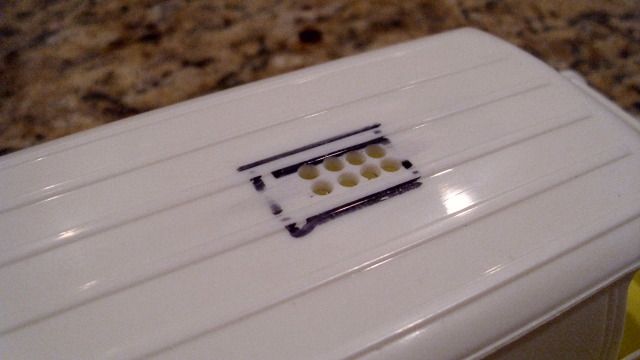

Gee, now look what happened. First someone cut the middle out of my van and now they drilled a bunch of holes in it. I would'nt be surprised if the next thing they did was to mount the flares and start slinging some putty. See ya next time. Thanks for looking .

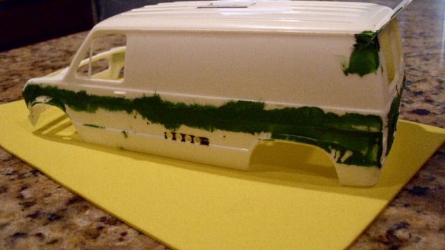

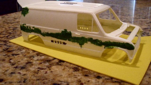

Slung some putty on the van yesterday. I think I am going to need more putty.......and sandpaper !
Ray. Another method for filling the section gap is by using very thin styrene rod and Tenax liquid cement. It melts the plastic rod into the gap and effectively welds the parts together. Then you just sand down the rod and then check for bad spots. You'll use a tenth of the filler you are using now.

Thanks Rob. Thats a great tip. Where the heck were you 2 days ago ! : )

Yep, what he said. I've come to use putty only as an absolute last resort. Plastic makes a much better filler. :)

I will for sure try that on my next slice and dice project. Thanks Gluhead. I kind have a feeling my project may not turn out the way I have planned in my mind.
