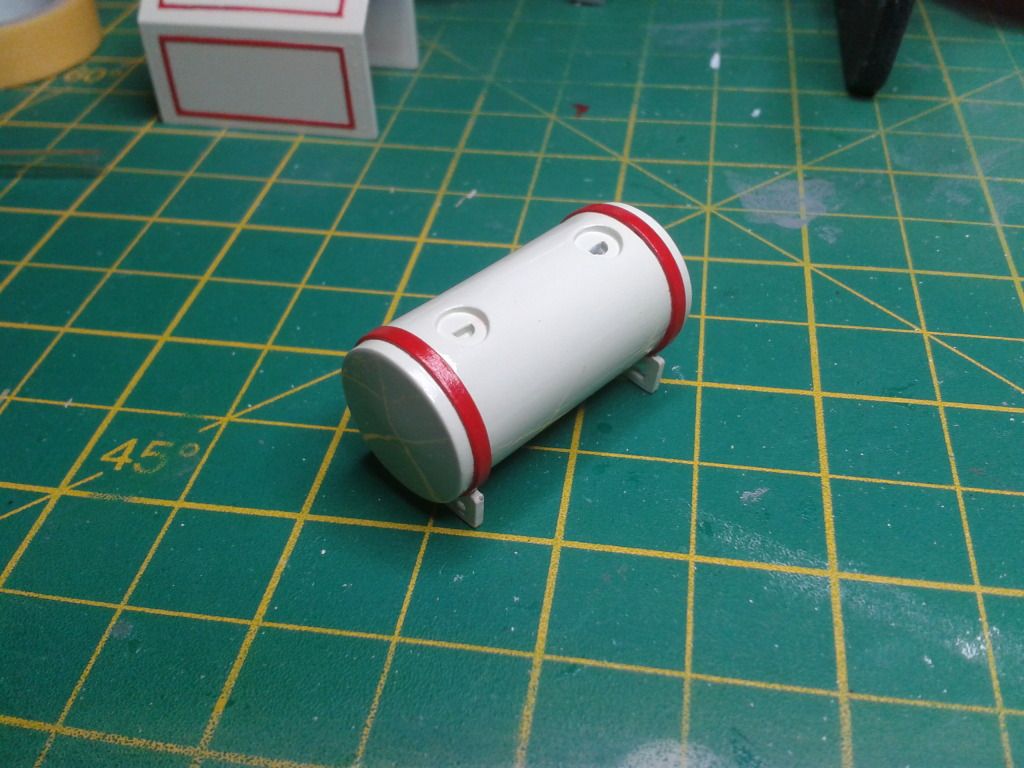

I agree with Harry about pinstriping tape. Here is a selection in a variety of sizes from Model Expo. The tape brand is Line O Tape. As for the gas tank, I wonder if red sidewall tire striping might be useful for the gas tank? If not, a circle template and red Sharpie or other pen would work. I don't know what brands are available in Britain. Otherwise, the ridges that need to be painted appear to be strong enough for using masking tape to paint with a brush.

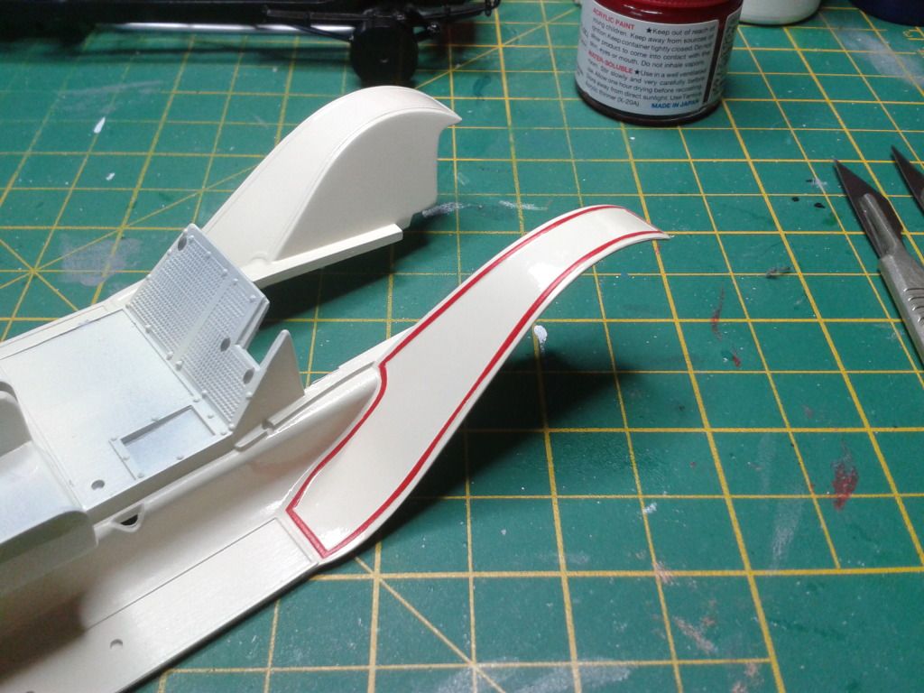

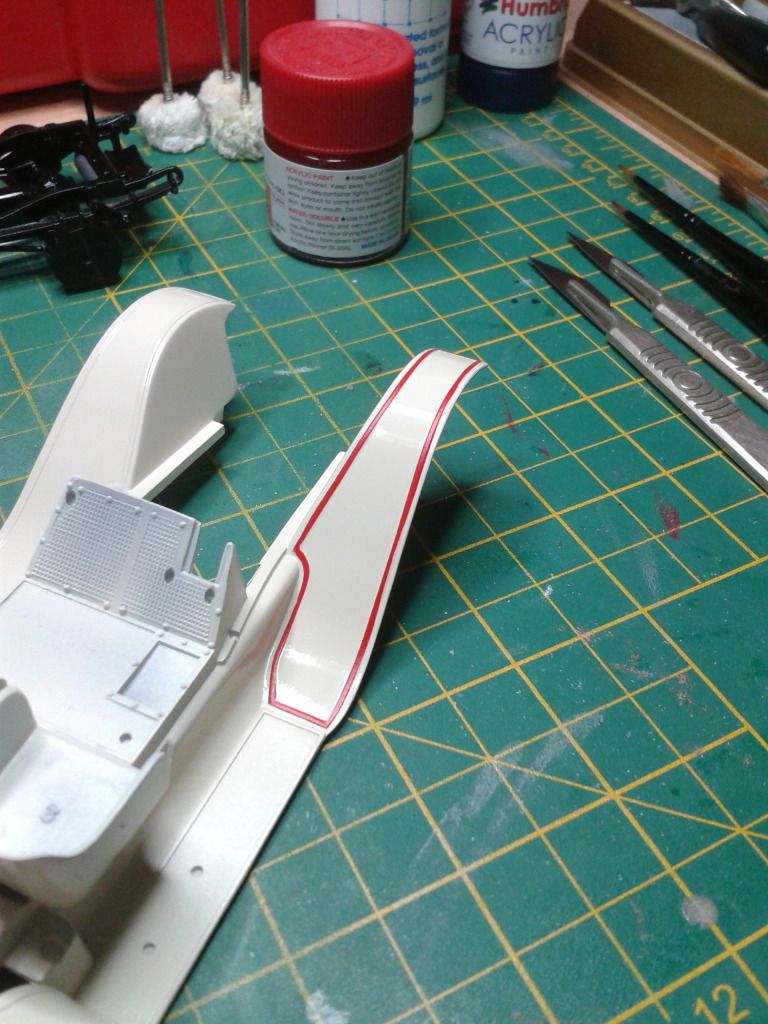

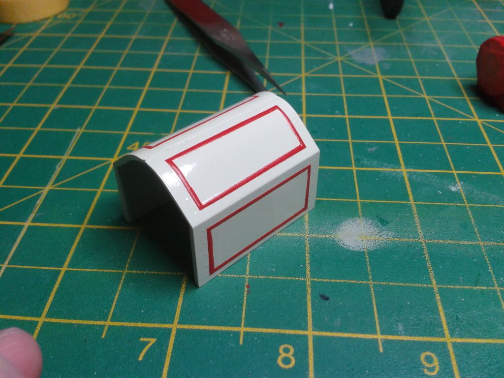

Took a deep breath and airbrushed the coachline, did it in a few thin coats as I didn't want any paint bleeding under the masking tape, not perfect, but I'm happy with the results, now I know it works I can carry on and do all the rest now ....

Very nice job on that !!! .. whew, as he lets out a breath! :)

Your masking seemed to do the trick. Very nice work.

Jolly good.

Well done! When I did the Munster's Koach I used BMF to mask.

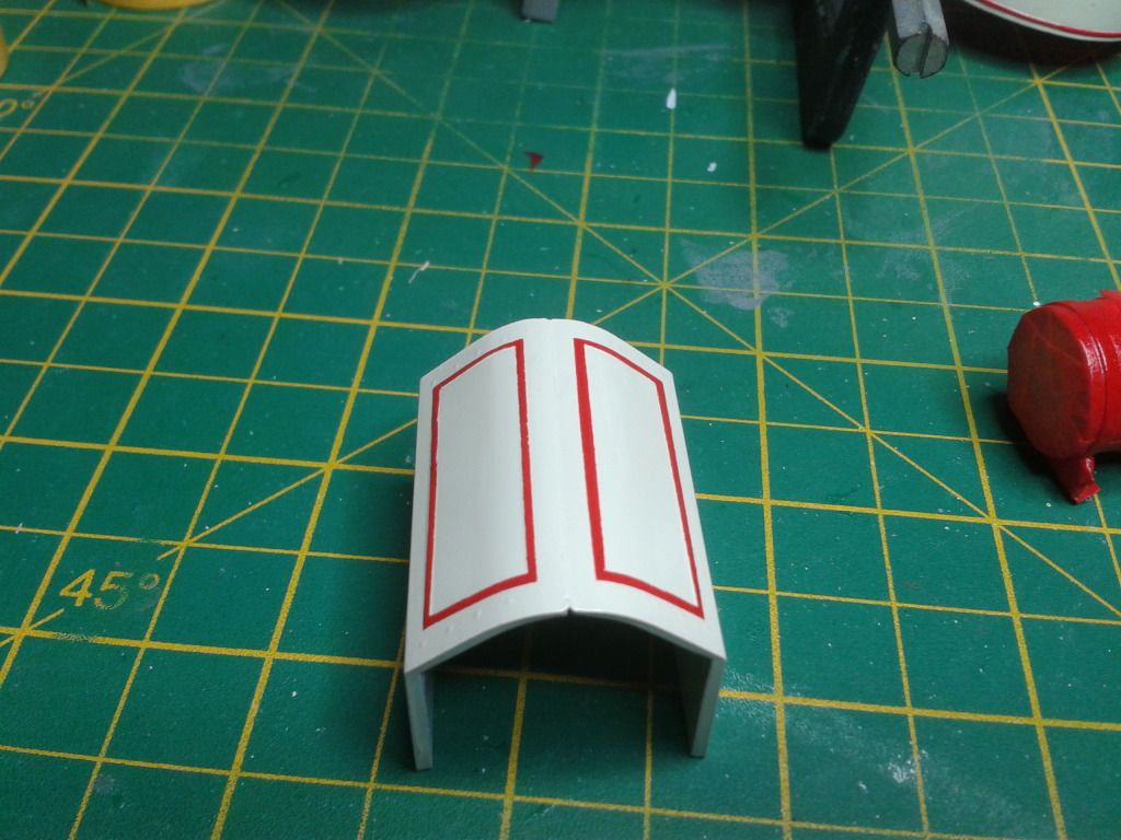

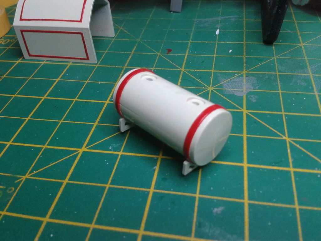

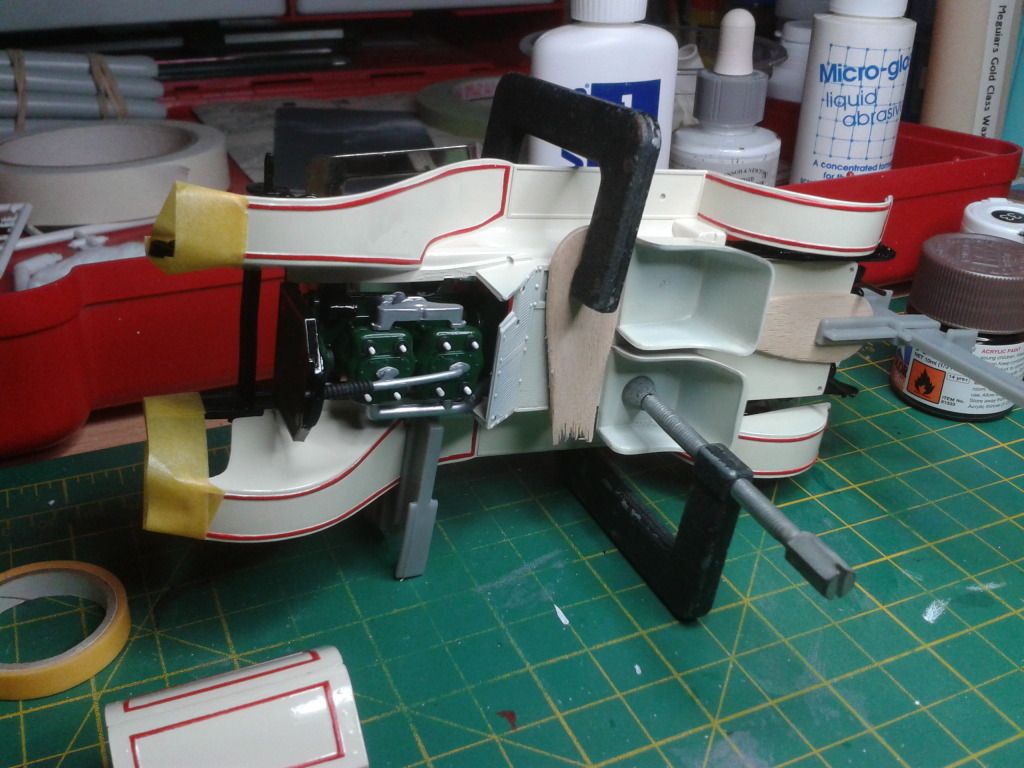

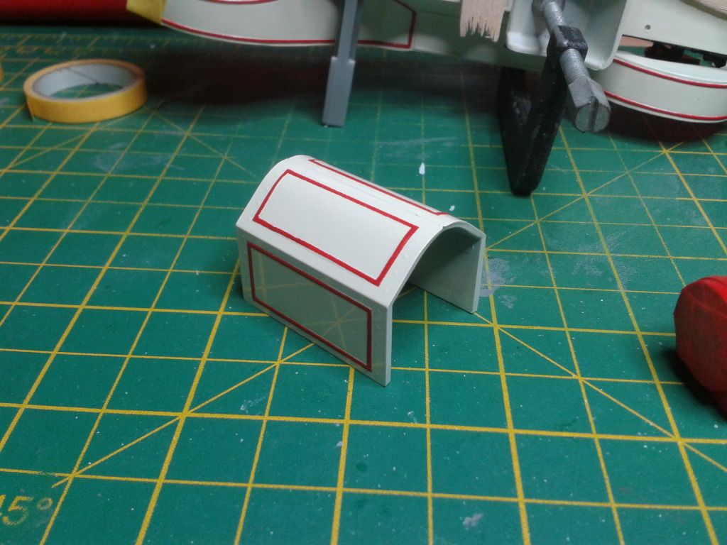

Only the two rear wheel arches and the bonnet to do now .....

Love it! great work\

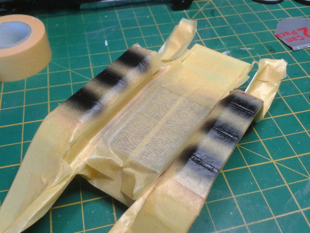

Getting there slowly with the body, only one rear wing to do now and the body and chassis can be mounted together, but then I spotted the woodgrain underneath, so it had to be masked off and airbrushed Tamiya Desert sand, it will be dry brushed using Tamiya bronze and a coat of clear orange on top, it's a shame it won't be seen once the model is finished ....

nice work Geoff. cant wait to see how the wood turns out.

Jolly good, as Skip said, is right! Those stripes came out beautifully! The wood looks like it'll shape up nicely, too.

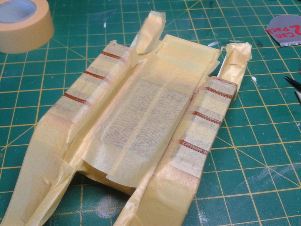

Before finishing off for the night, I got the dry brushing done on the wood, I used Tamiya bronze for it,

nice! cant wait to see the clear orange on there........ive got to try that technique one of these days.

That wood looks great. Does the bronze leave any metallic finish at all? That would be my one reservation about trying it with that color. That aside, Geoff, it really looks nice.

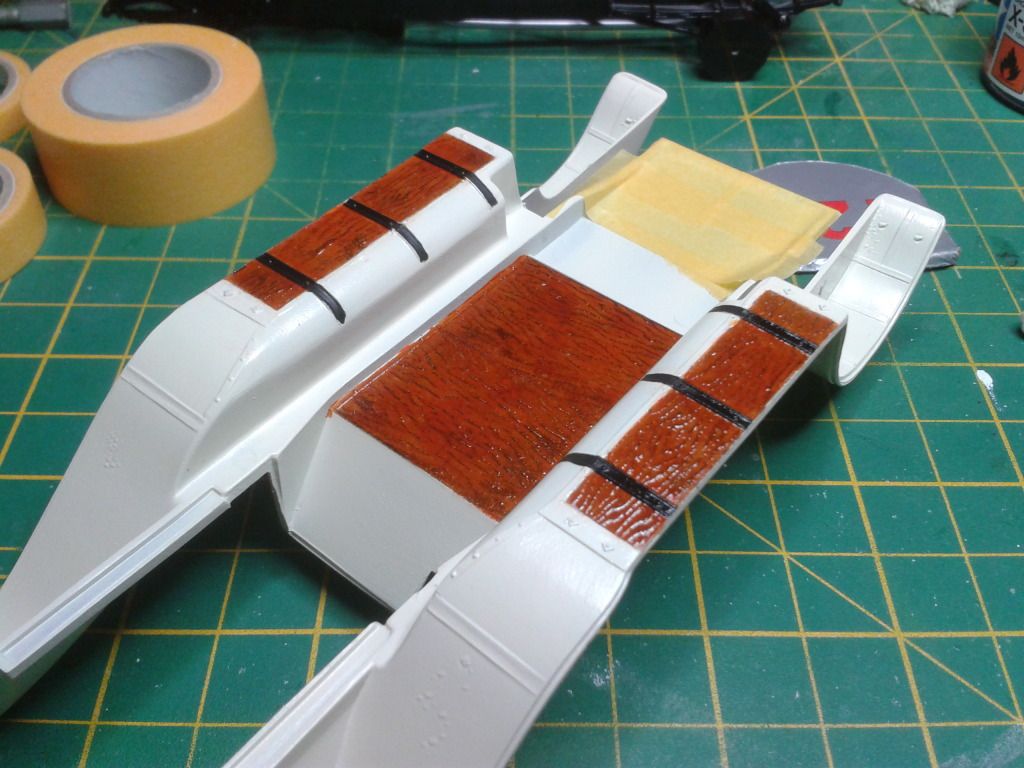

No it doesn't, see for yourself Charlie, after watching a couple episodes of Mash (One of my favorite t.v programmes) I though I would get the clear orange on, it might need a second coat, I'll make my mind up in the morning when it has all dried up
