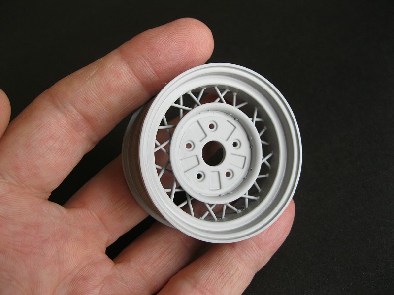

I know I am not alone in this, but I always thought that the Big Deuce needed a nice set of wires..........these were loosely modeled after the 1935 32 spoke variety.......the rim and center section were 3D printed with the spoke holes in place at the correct angles and all.............032" piano wire was used for the spokes...........the rim is sized to fit the Deuce tire (this being the rear) and the the rear backspacing / offset, as well as the bolt circle matches the steel wheels found in the kit..........the hub cap is a first pass at something appropriate........

Here is a front and rear wheel, with a bit of color, in the early Firestones..........

TDR has listed the rim, hub and hub cap pieces in their catalog at Shapeways:
http://www.shapeways...hops/tdrcatalog
Some assembly required...................
