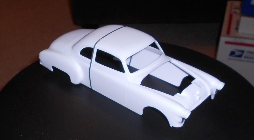

Well, tonight the top came off. I decided to go with the more difficult chop where you cut the roof into quarters. I like the look better, the new roof is wider which plays up how low it is and the rear window doesn't slant as much and I don't really care for the fastback look on this car.
The first cut I made was across the roof width wise at the door line on the B pillars.

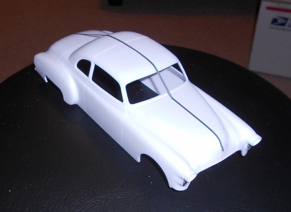

Next was the lengthwise cut.
Posted Image

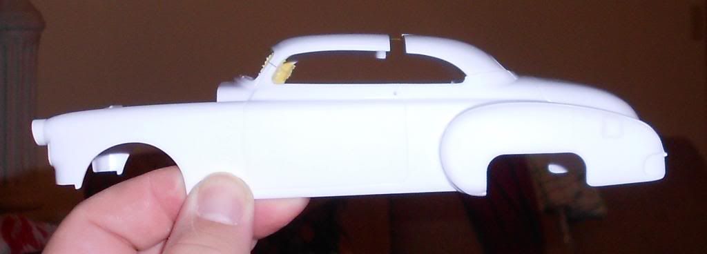

Here the roof is quartered and the B posts have been removed, the A and C postd have been cut down about six scale inches.
Posted Image

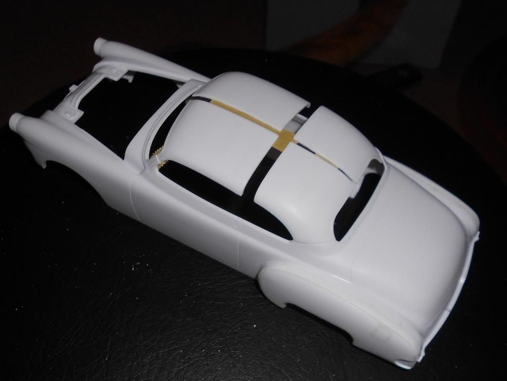

Here is the roof tacked in place with tape, you can see how much will need to be filled.
Posted Image
This is the new roof profile, it still needs some fine tuning and I need to decide what to do with the B posts. I also removed the drip rails from the roof side and the chrome strip from the top of the doors.
Posted Image
