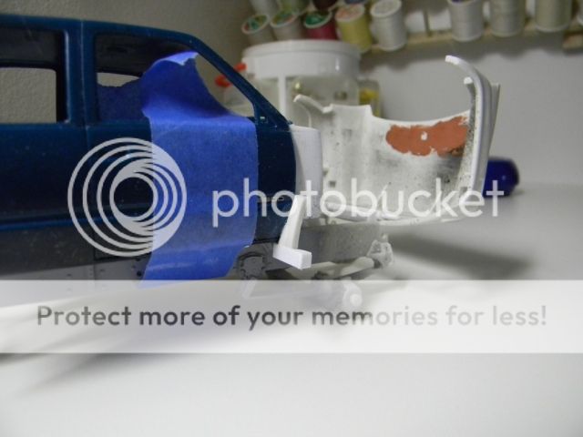

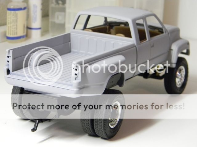

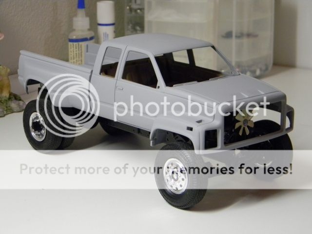

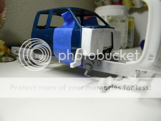

Now the first mock up of the hood, cab and bed together on the shortened frame.

With frame shortened and aligned I can start on the hood hinges. Once I get them in place I can make the vertical cuts on the lower fenders for the tilt hood.
Work has started on the rear roll pan. I filled in the area with strip styrene. Once it dries I will use some fine strip styrene to fill the gaps and shape the end caps. I haven’t decided on a bumper yet. I’ve seen a lot 1:1s use just the frame end cap and some with custom bumpers. Either way a trailer hitch will be added.

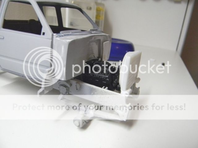

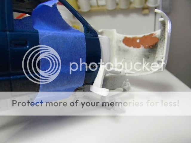

Everything finally seems to be coming together. With everything in place and aligned I started built the hinges for the tilting hood. I attached two small pieces of strip styrene to the front frame rails to support the tube styrene for the hinges. I attached a length of tube styrene to the front frame rails and supports.
Posted Image
Next I reattached and aligned the hood and cab to the frame. I used Plastruck liquid weld to attach each end of the tube styrene to the leading edge of the hood. Using a piece of scrap styrene as reinforcement I welded the center section of the tube styrene to the leading edge of the hood.
Posted Image
I let the assembly set up for several hours and then cut tube styrene on each side of the center reinforcement. I inserted a piece of styrene rod through the cut tube assembly. I made the vertical cuts in the lower fenders and the hood tilts forward like the 1:1.

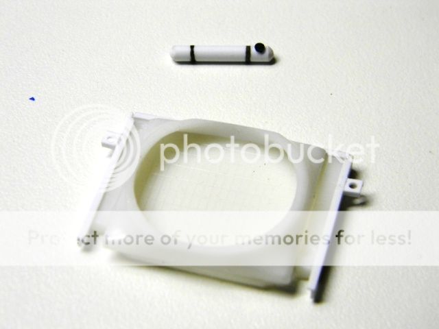

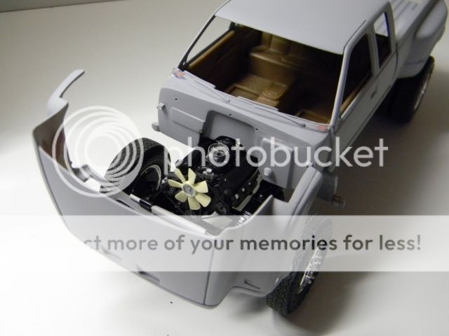

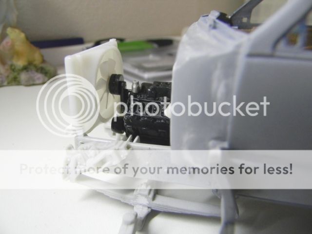

The work continues, but a little slower this last week. I’m trying to spend more time on the 71 Daytona, my other wip. The water pump was modified to try and match the 1:1. From pics of the 1:1 engine and water pumps the pump has been elongated so the pulley/fan assembly is centered within the radiator/shroud. I used strip styrene to extend the pump and several parts box pulleys for the pulley/fan and crankshaft pulley assemblies. I also had to fab up a taller thermostat housing. The 1:1’s also appear to have a 2 into 1 configuration. So two different sizes of styrene rod were used to make the housing.
I lucked out and found a fan and radiator/shroud in the parts box that fit perfectly. The radiator/shroud assembly was mounted to the frame rails using white glue for the mock up. Ultimately I’ll use styrene channel to build the bracing and frame around the radiator like the 1:1.  The engine was aligned and the location marked on the frame rails for the engine mount locations. The mounts were made and glued to the rails. With  the engine finally in place the mod made to the water pump centered the fan in the radiator shroud.

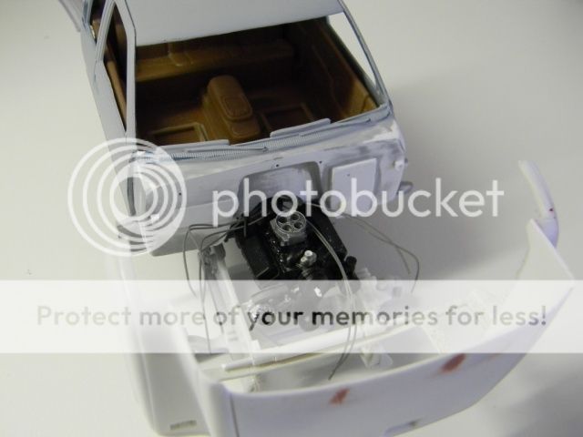

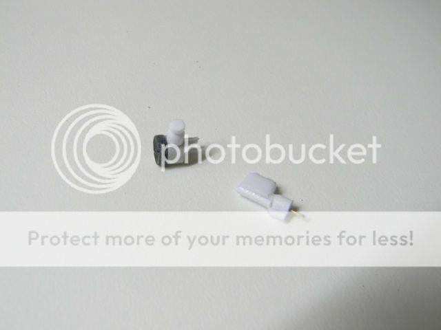

I’ve also started work on adding firewall detail. Holes were drilled for pinning the master cylinder, power distribution box and washer fluid reservoir. The rubber firewall seal for the steering column was cut from the Ford Louisville steering column. It was glued to the firewall and drilled out to accept the new steering column.
Next the work on the under hood components and drive accessories has started. The master cylinder was made from a parts box unit with the help from some styrene rod. The power steering unit was made from a flat head v8 generator, parts box pulley and styrene rod and channel. The wire is used to pin the units to their respective mounting points for reinforcement. The alternator is another parts box piece and is currently in the purple pond being de-chromed.

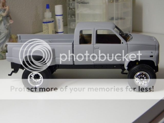

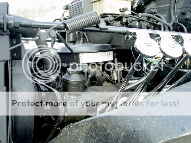

Thanks for the comments and concerns. I've have over 100 pics of various commercial and custom Topkicks I've gotten off the web for my inspiration.  As to the cab height and engine compartment here are couple of 1:1's for comparison. Also my camera creates a fish eye view when I take really close up pics so it distorts the actual dimensions of the build.
One of my favorites
1212dp_03december_2012_readers_diesels19
and one of the cleanest Topkick engine compartments I've found

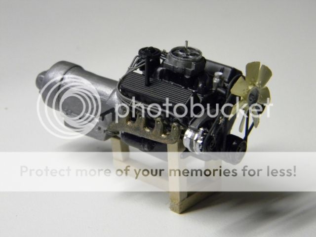

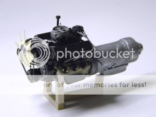

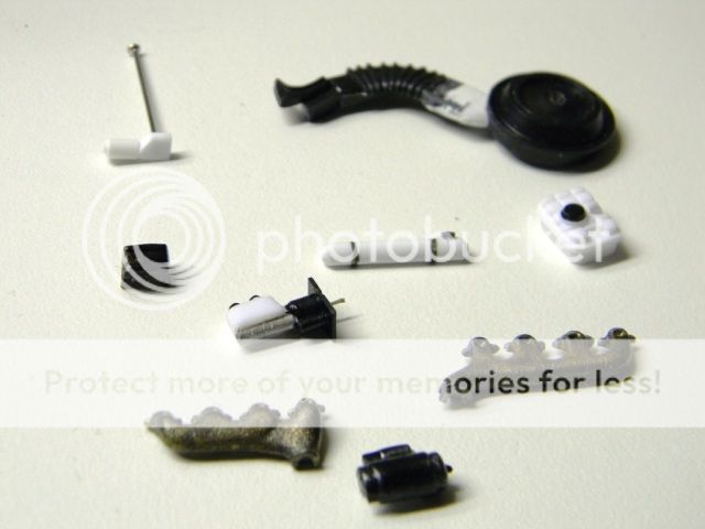

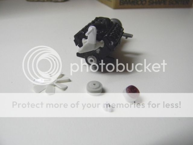

Just a quick update, not much getting done during the holidays. Anyway I’ve completed the exhaust manifolds, master cylinder and starter. I used parts box pieces to make the power distribution box, windshield washer fluid reservoir and air cleaner. The coolant reservoir and windshield wiper motor were scratch built from rod and sheet styrene.

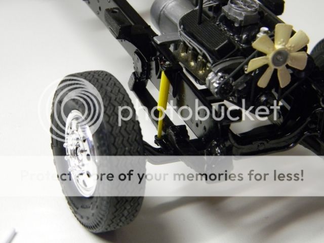

The radiator frame and supports were made from channel styrene.
The engine is almost complete. The power steering reservoir and alternator were attached with scratch built brackets and push pins. The drive belts and fan attached. The TBI was made by removing the float bowls from a Holley dominator carb and using rod styrene to add details. An oil filler tube was made with rod and tube styrene. The HEI distributor was provided by MAD.
Test fit of engine with distributor installed.

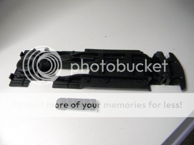

Fuel tank cut from promo Silverado undercarriage and filled with strip styrene. Tank will be shaped and fitted to the underside of the bed above the frame rails.

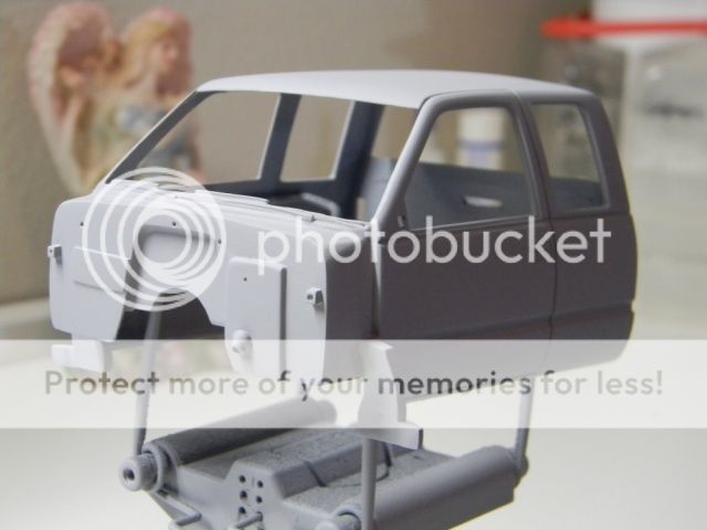

Cab with it’s first primer coat. The finish looks great with only a couple on imperfections to fix.
Planning to continue preparing the cab, hood, bed and frame for paint. I need to decide on a paint scheme so I can start work on the interior. Thanks for looking...

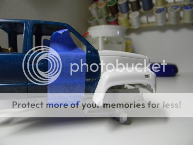

A Chevy Silverado promo kit was used as a donor for the cab, bed and interior. I got lucky and found one cheap on ebay.

From a DG Productions promotional bank like this one:
http://www.ebay.com/...=item27ce585ad7

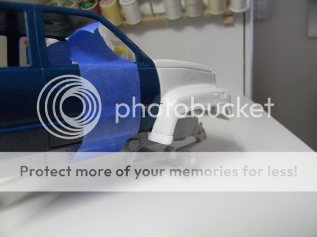

Again I lucked out, a seller on ebay was selling the cab only for $4. I just cut the front clip off the Silverado and the hood off the Topkick and mated them together.
