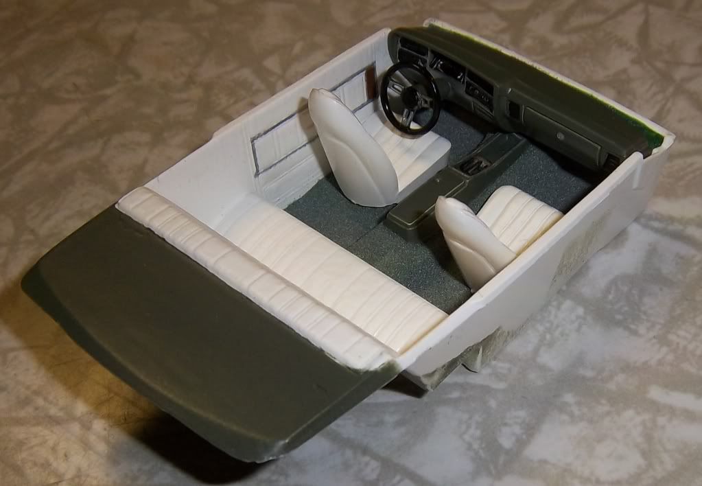

If you're using a tub interior brush painting with acrylic provides enough "stick" and can give a little more control around molded in details like this console
Posted Image
