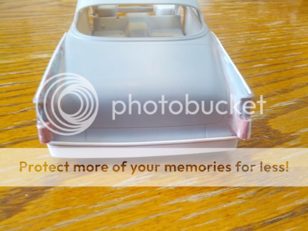

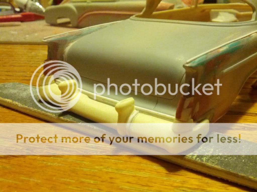

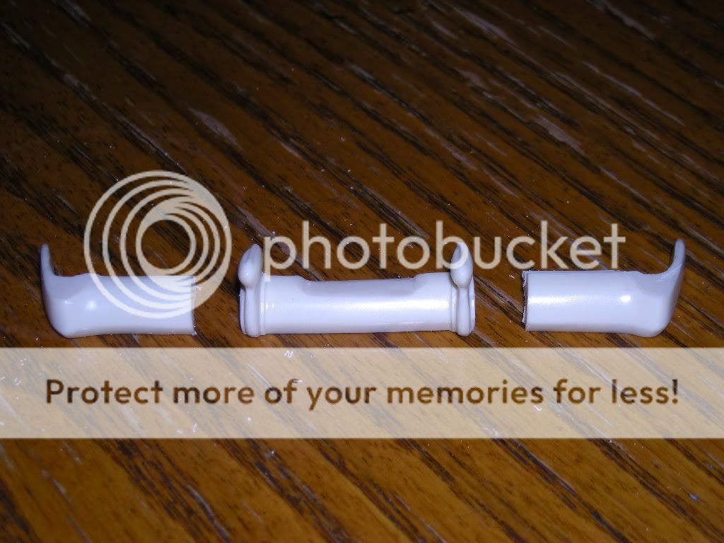

I received my 50 Caddy rear bumper. What a nice piece.
I began cutting some of the width out of it and I had to grind out some of the back of it to get it to tuck up to the body.
This is where it sits now. I haven't gotten back to finishing it.

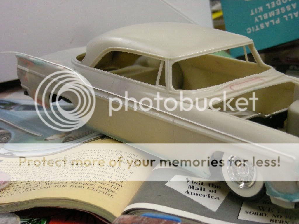

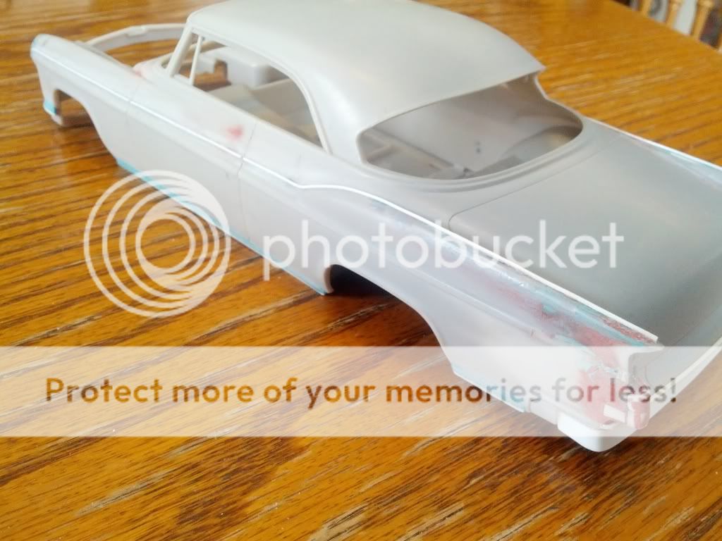

So, after sanding down the second coat of putty and a quick coat of primer I got to work on the side trim.
I added a small strip of styrene to extend the bottom piece of trim with the idea of making the trim to replicate the molded in trim. Then I came to my senses and I think I will be making a mold of the lower trim from a second body to replicate this. I think it will be the easier way to go. So I will be removing that small strip of styrene near the taillight.
Next I took a strip of .020 X .020 and glued it in place for the upper trim piece.
Now to get the driver's side to match.
That is all I got done on my breaks last night. At least I'm making forward progress. Once I get the trim on I think I will be finishing the door panels OR chopping the top. Stay tuned.

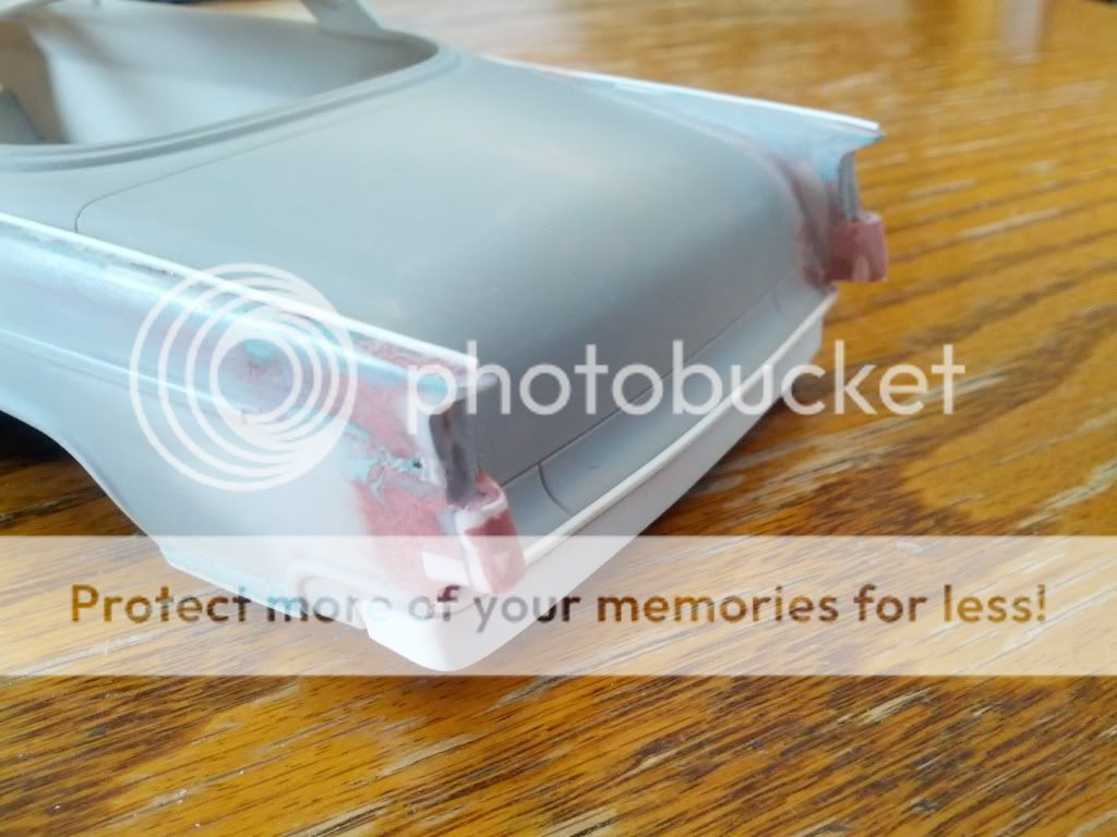

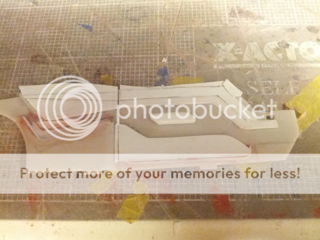

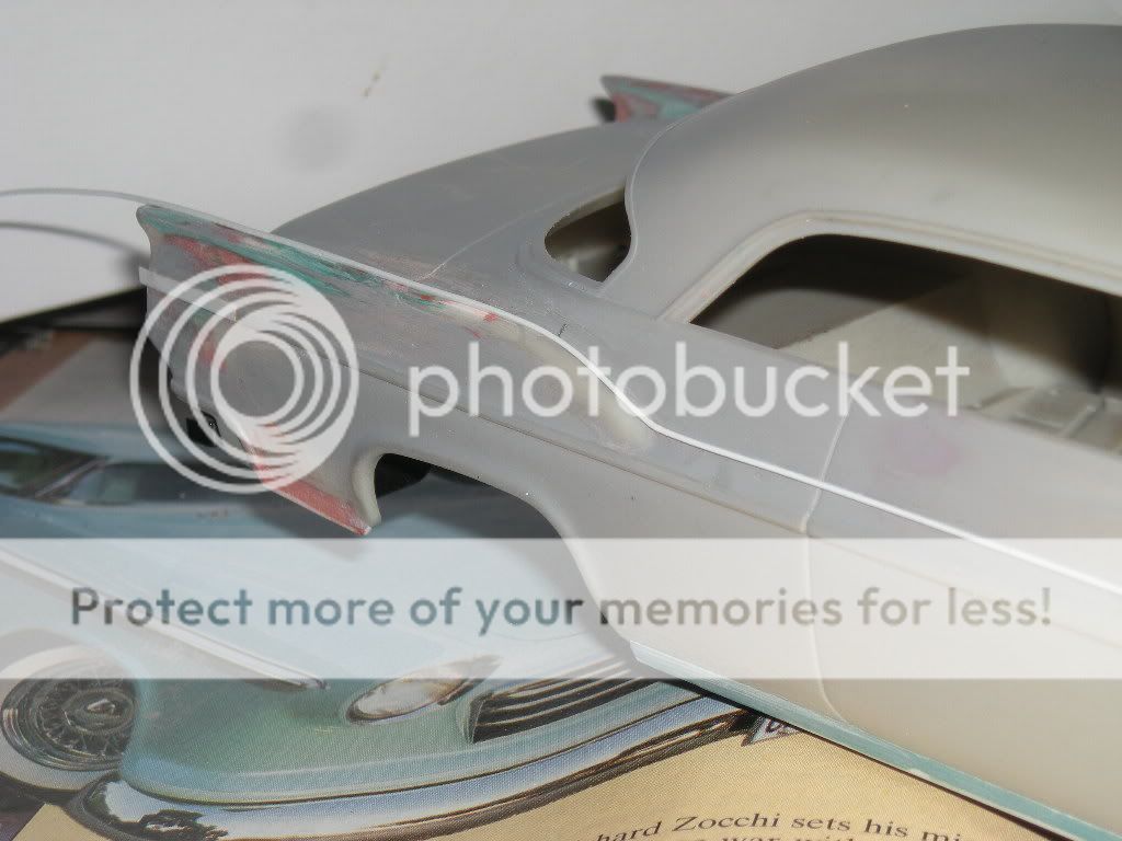

I got the driver's side chrome on to match the passenger side. It's not as pretty but it'll work. I did some more work on fitting the rear bumper but it is fighting me. I had to build up the lower part of the taillights and that is in the first stage. Gonna take quite a bit of work there. To help save my sanity I worked on something simple. I began constructing the interior door panels. First I removed all of the molding. Then, using the only two photos I have of the interior I made my best guess.
Here is one of the photos from the mag article.
Here is what I have so far.
After I primer and paint these I will add the chrome accents using thin wire.
Now that I look closer at it the top piece
should go all the way to the top of the door. The upper chrome accent is in the center of the light blue section. Should be an easy fix by making another piece ti glue above it and the chrime accent will go over the dividing line. I'll fix thar in the morning.

This is the fix I was talking about.
The top of the door panel needed filled in. It took about a minute to do with scrap. Once the glue dries thoroughly I can trim and sand it to shape. Then I can put the wire on it after paint. Got to do the passenger door now.

I got the door panels to the primer stage. Nothing exciting there. I added a styrene strip to the area behind the rear bumper to give the three pieces something to attach to. Fitting the rear bumper is proving to be a real chore. the wrap around portions don't fit the profile of the rear fenders so I had to make a relief cut on the bumper to tuck it in.Fits much better now.
I have done quite a bit of work shaping the lower rear fender and taillight areas and about have it down.

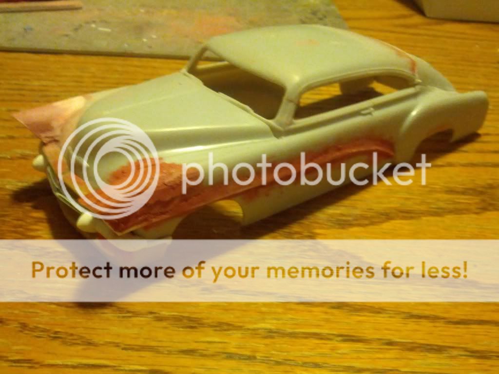

Now for a few photos of my newest project that I'm using as fill in.
Copying some ideas from this 1:1 for my 51 Fleetline.
