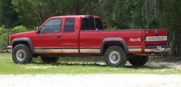

Posted 24 October 2012 - 07:05 AM
Posted Image
heres one

What year is the truck? We need some more info to be able to help.

Posted 24 October 2012 - 08:05 AM
that one is a 1993 model * 350 V-8
* 4 Wheel Drive
* Automatic Trans
* 3/4 ton
* Torsion front suspension.
* New Shocks,
* New PS Pump,
* New plugs and wires.
* Very Well maintained.
* Full size bed has RinoLiner.
* Club Cab with back folding seats.
* Lots of cabin room.
* Heavy Duty Tow capable with Hitch.

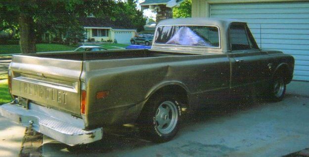

Posted 24 October 2012 - 11:31 AM
Posted Image
heres a 1968 chevy long bed
