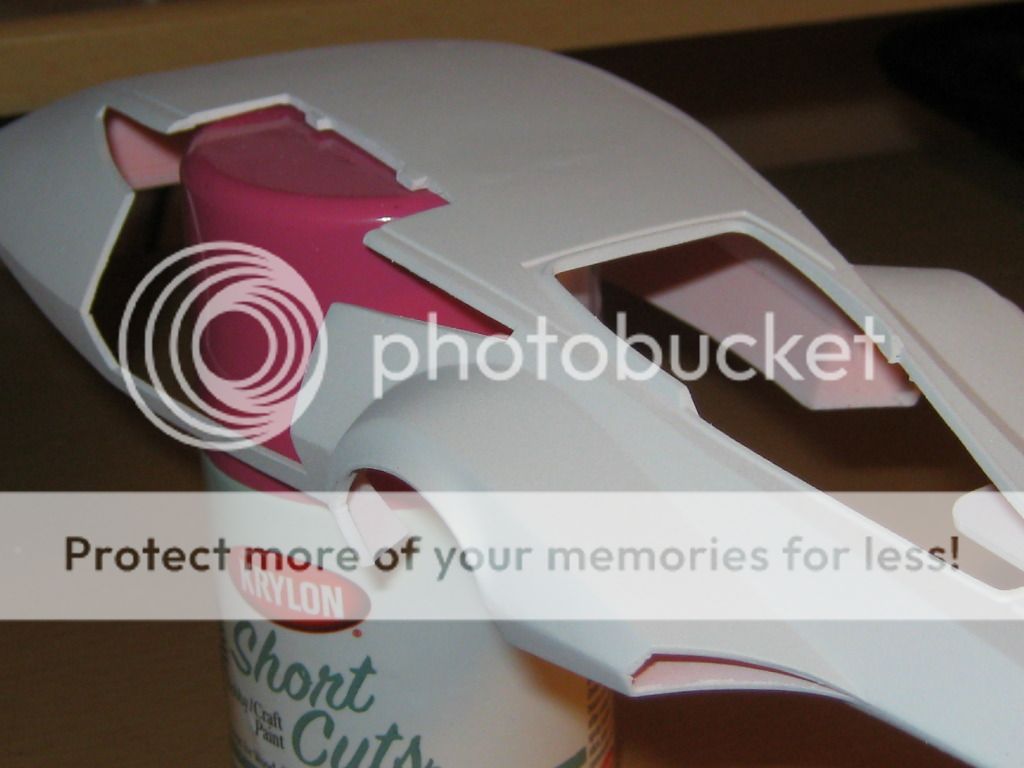

I start with an old soda bottle, usually from a 2 litre. It's already curved so after cutting out a sizeable piece and washing it thoroughly, I'll cut a piece a tad larger than I need and super glue it into the fender well perpendicular to the fender. Then smooth it in with 3M putty.

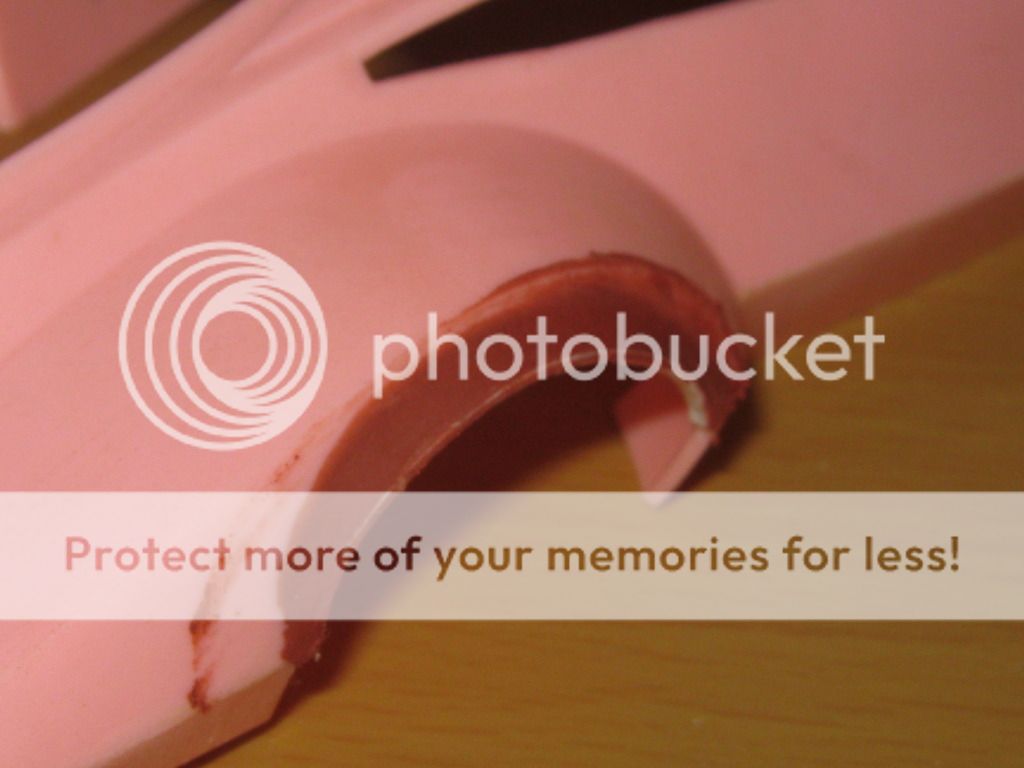

For my ongoing Pink Panther build I used sheet plastic. Forced into place with a toilet paper roll and liquid glued.
Posted Image
Trim them to size
Posted Image

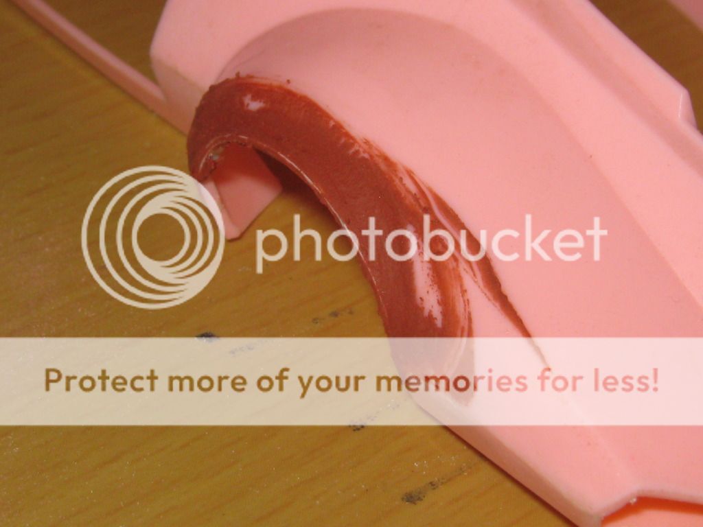

Blend in with putty
Posted Image
Sand to shape
Posted Image

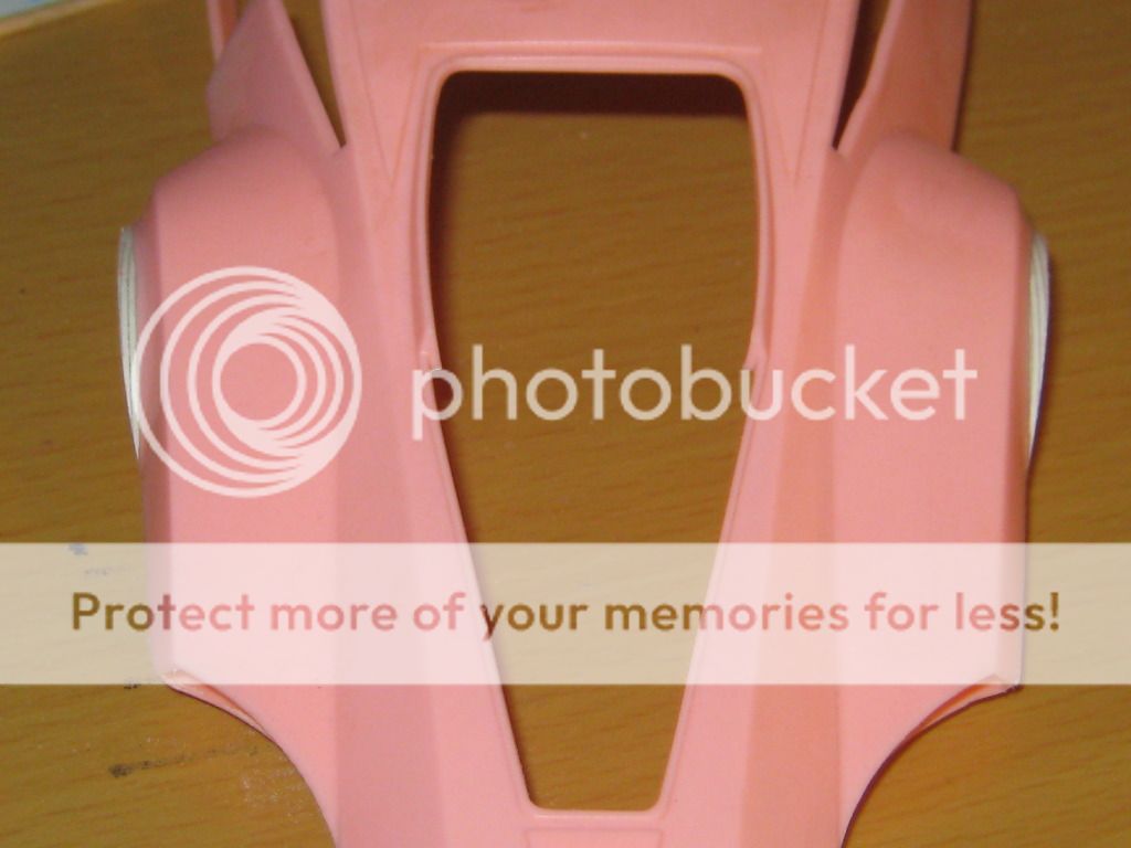

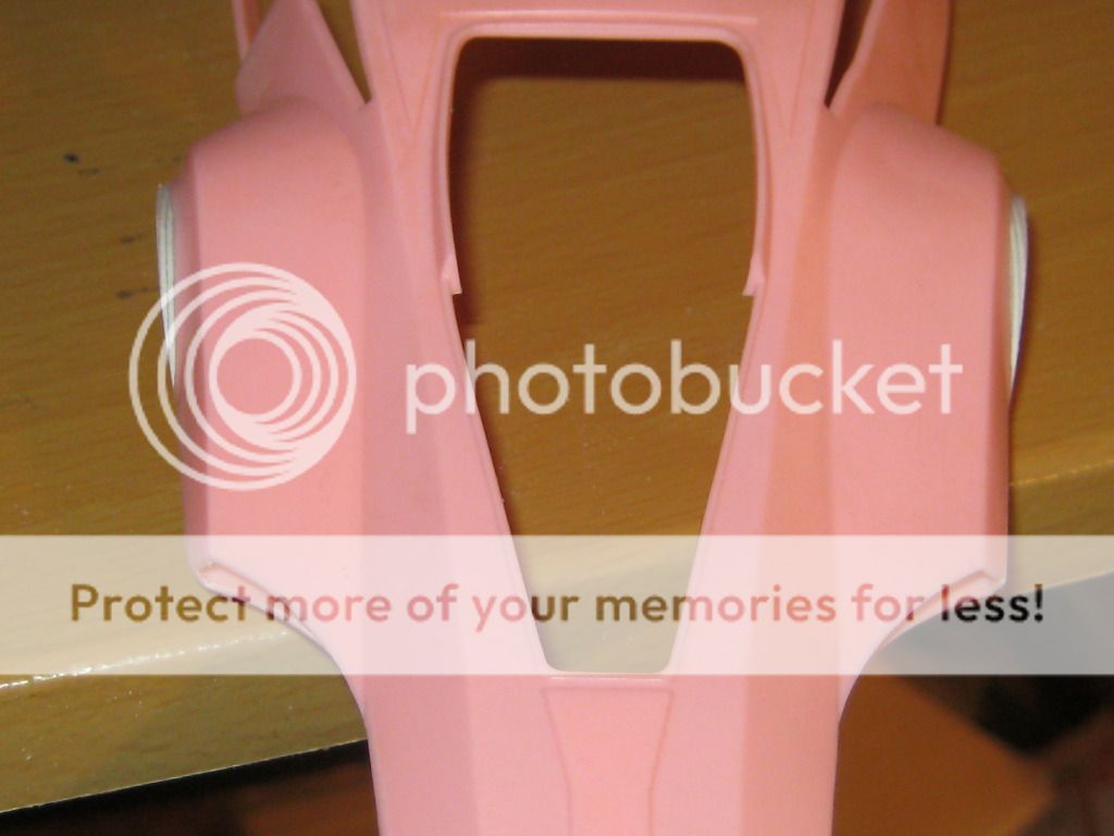

And prime
Posted Image I hope this is a help. :)

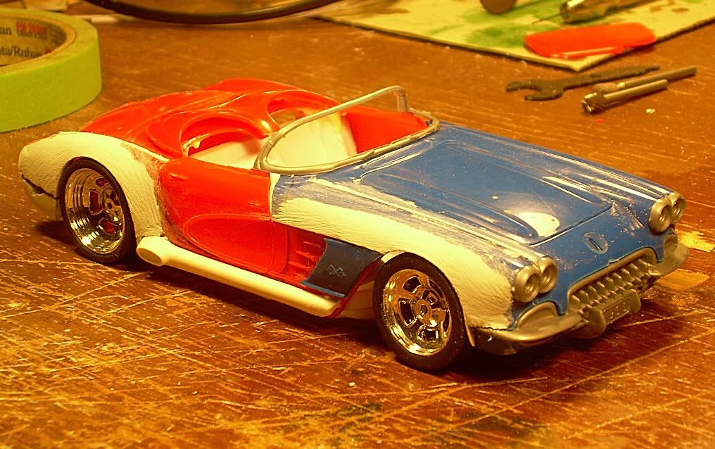

Very nice, futurabat. Basically the same as my technique. Cut the wheel opening to the radius you want, liquid-glue in a strip of .010" styrene perpendicular to it....
Posted Image
Then fill the flared areas with bondo and sculpt to shape......
Posted Image
Same idea, just larger, and with additions to define the fender character lines....
Posted Image
Posted Image
The real trick is if you want the flares thin enough to fit down over the tires....with the tires up inside the flares. About your only option then is to make molds of your finished parts and duplicate them in fiberglass.

Yes, and if you look closely, you'll see the tops of both front and rear fenders on the Corvette model above have also been split and widened using a similar technique, which I posted on another forum 2 years ago.
