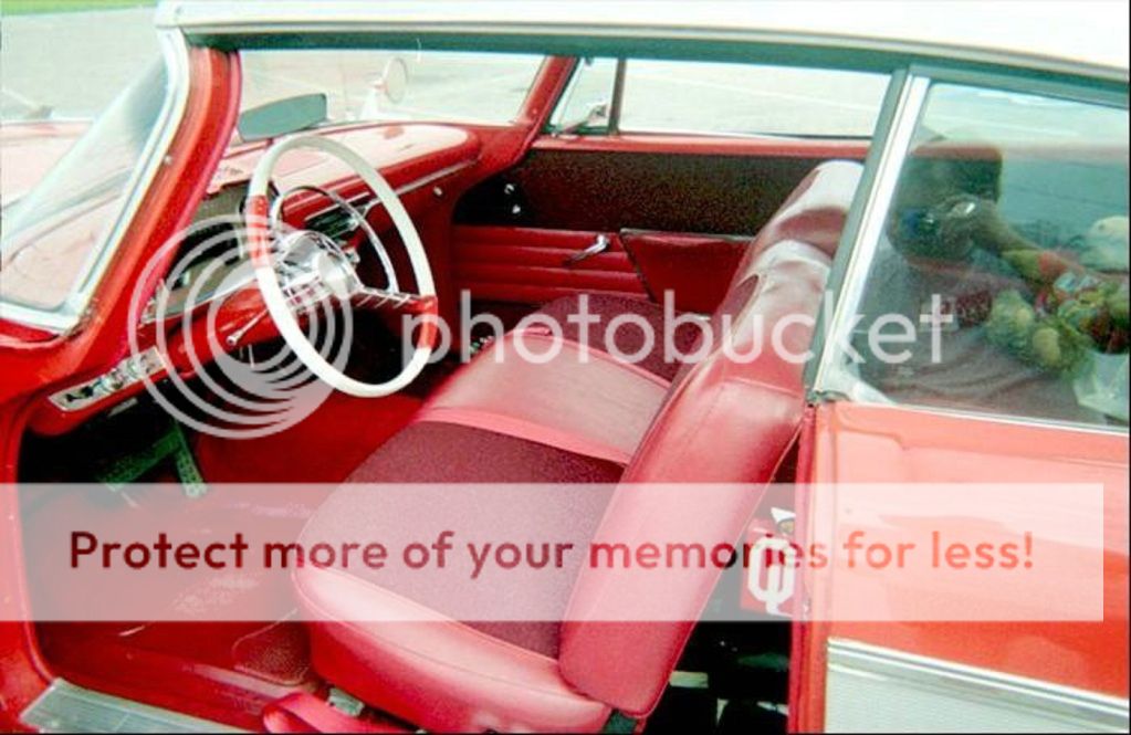

OKAY!I'm seeing it mow that Harry pointed it out! The roof sweeps downward too soon forcing the rear window to look a little shallow. That would be a fairly easy fix. ;)
Chris, I have the proper twin carbs and cleaners already so we're good there. Where do I look for the best possible 318 without going to a Ross Gibson?
I know the interior was customised a bit, so i'm going to start researching that next after I get back from Dayton today. If anyone has pics they can post it would sure ly help. :) In the meantime here is what I have of a Christine movie used car.
Posted Image

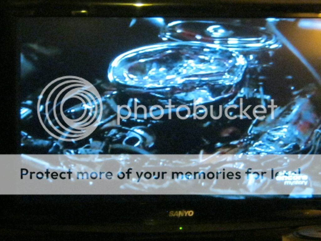

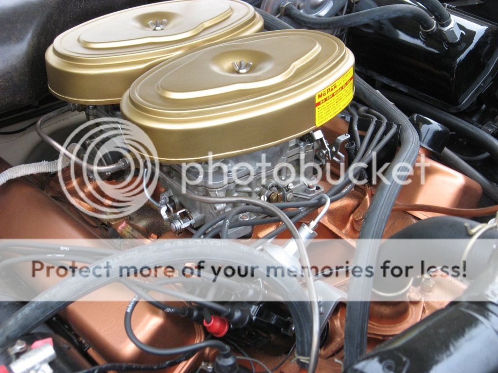

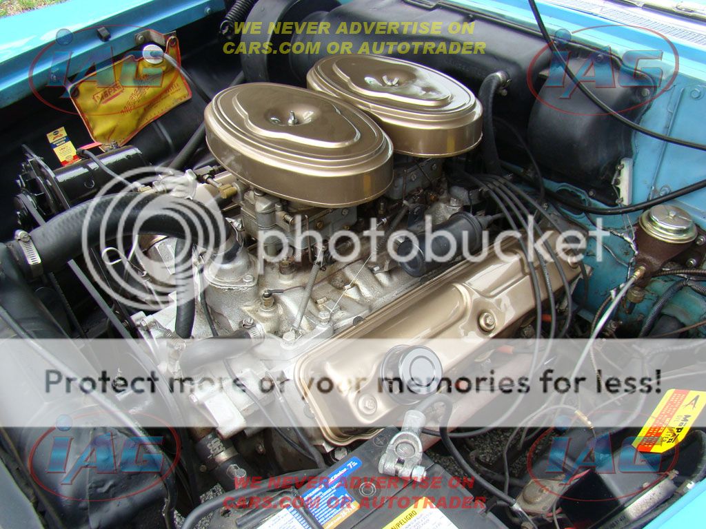

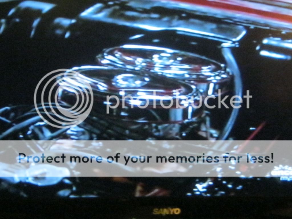

At this point I think I have what I need about the body information. Let's move to the engine. I've been lucky enough to find exactly two pictures of the engine bay.
Posted ImagePosted Image
Then I tried some screen caps. My Powerdvd is glitching so I literally took pictures from the TV. :lol:
I actually have the twin carbs and air cleaners and they're in the molds right now. Does anyone have a good pic of the decal on the valve covers?

Your silver engine photo, with the gold valve covers (the shape of the valve covers is the give-away) is a polyspherical-head engine, possibly correct for the '58, and based on the early hemi bottom end. The copper engine has the distributor forward and on the passenger side, and looks like a B-series wedge, built starting in '58 and also possibly correct for the car.
Though the air cleaners are similar, they're two different, distinct engines.
