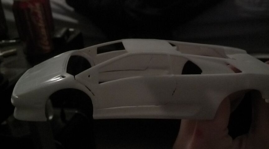

I did a little work on the body and doors today. I'll have to add material back in some areas for sure, but considering this is only my second door job im happy. SORRY for the dark pics
Posted Image
Posted Image
I'll try to get more done tonight and get more uploaded.

next up came the boot. here it is with the creases highlighted for my terrible eyesight. it didnt help. i still ended up marring up the surface of the boot lid a little, but fitment straight after cutting it up was fantastic so i'll take what I can get.
Posted Image
cut cut cut cut
Posted Image
that's what I'm talking about!
Posted Image
last thing i began working on was starting to cut off the last piece above the grill on the rear end. here it is all together, it'll be a bit before i can finish ripping it off.
Posted Image
I really need any tips you guys want to toss at me for getting those door lines smoothed up, thanks!

#14 robiwon
robiwon
    MCM Friend
  • PipPipPipPip
  • 120 posts
  • Location:Danville KY
  • Full Name:Robert Cass
Posted 05 November 2012 - 01:02 AM
Sand the edges of the doors and the door jams on the body until they are smooth and even. You will wind up with a rather large gap. You want this gap to be as even as possible all the way around the opening. Next, take some strip plastic and glue a strip around the front, bottom, and back edge of the door. Hold the door to the body and see how big the gap is. It should be a closer fit now. If the gap is suffeciant, you can now start sanding the edges of the strip styrene on the door to blend into the door panel. You may have to do the same with the door jam on the body, depending on how much material was removed to make it square.
