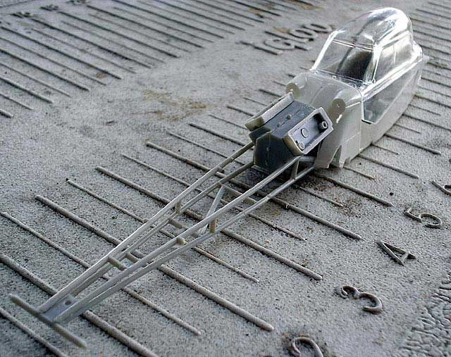

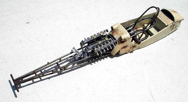

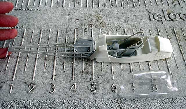

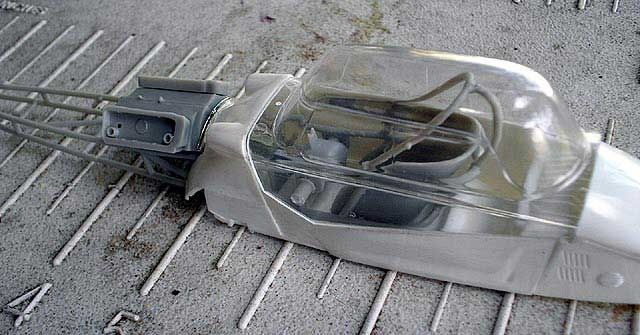

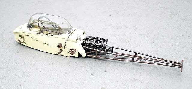

Body will be well weathered with obvious torch cuts and riveted patch panels. Chassis will be raw steel, but maybe showing some oxidation. Hemi block is a place-holder... something wilder will take its place soon!

That is gonna be one awesome build.Great idea,now I know what those butt-ugly cars are good for! :D

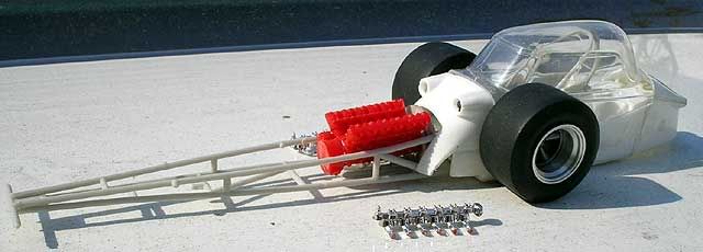

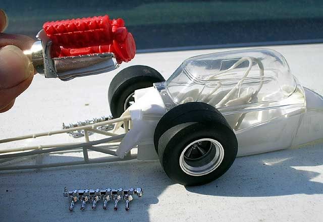

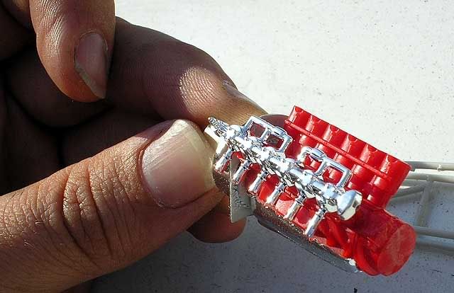

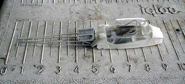

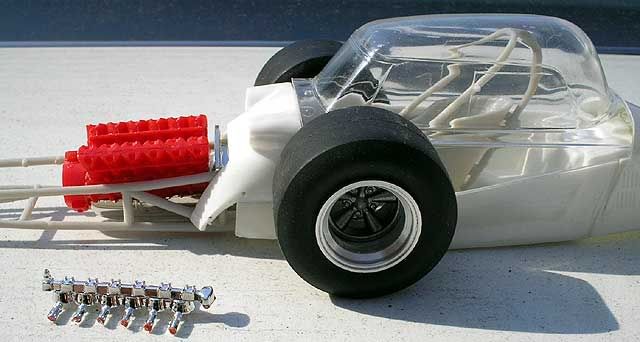

Made some progress: siamesed two Red Baron blocks to create a V-12:
Posted Image
Posted Image
I'm going to front-mount a centrifigul supercharger, and run the magneto(s?) off that bellhousing-cum front cover. Those are wheel centers from a Stinger T behind Detail Master hoops with Tamiya 1/20 scale F-1 tires standing in for 14 inch slicks

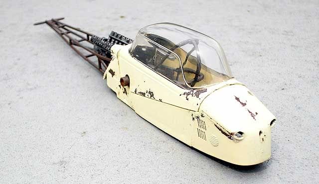

Started some paint today:

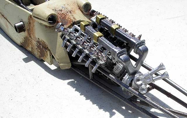

I did a little more on the engine since our last installment:

Very real lookin rust.. Dave is the rust from one of those antiquing kits or your own ?,,,,,,,,,,, super job.

It's sort of a combination. I sprayed the body with mist coats of Tamiya Light Gunmetal and Floquil Roof Brown until I got a good base oxidized look, then I masked the areas that I wanted peeling/chipped paint using moist table salt. After I shot the Testors Light Ivory on thoise areas, I flaked off the salt, exposing the "metal" underneath. I used the RustAll system to add both washes of rust red-brown and blue-black, adding texture using their pre-sifted dirt.
Truthfully, anybody could come up with the elements of RustAll on their own, the manufacturers just pre-package it, saving you the trouble of thinning out acrylic paint to the right consistency and sifting all that topsoil. I'm not sure what goes into their "Dead Flat" topcoat, but that one component is worth the price of the whole kit when it comes time to finish off the model.
