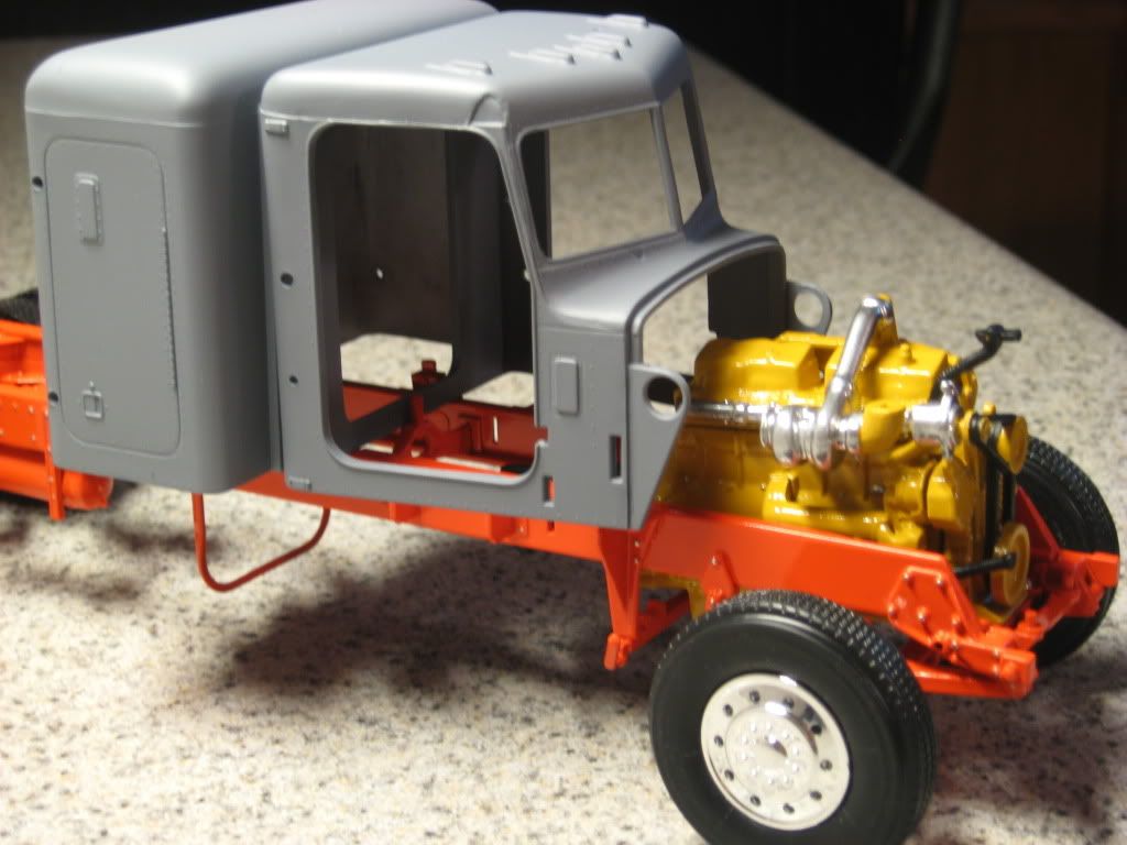

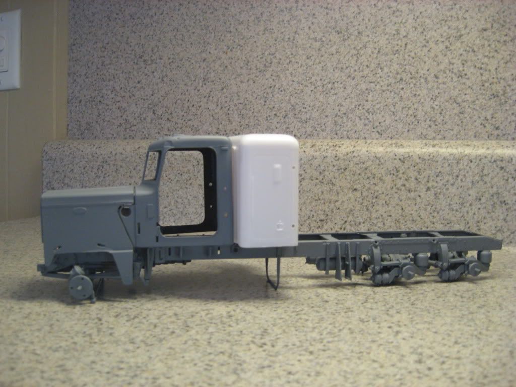

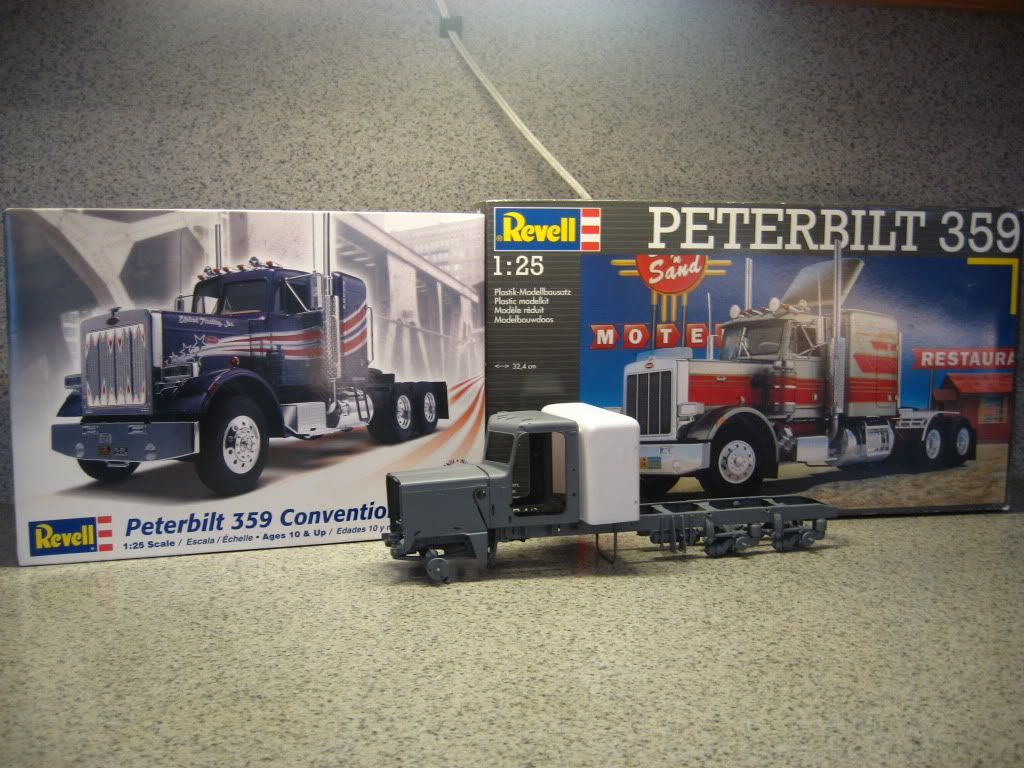

I did this but I used the Revell germany 359 that originally comes with the 63 inch flat top not amt 359. The Revell Germany 359 cab and hood is more accurate than the the revell snaptite 359. Here is mine with the sleeper cut from a the snap pete matched to the the revell gremany pete. I hope this gives you a better idea. It was not hard at all to cut apart with a good sharp blade in the xacto knife.I would recommend cutting close to the cab as possible to resemble the boot between the cab and sleeper on the new truck you put the sleeper on.I also had to make a floor for the sleeper and again it was easy with parts from the parts bin or sheet styrene.I also recommend sanding and filling the interior snap holes that are visible on the back of the snap sleeper.Again I hoped this helped.
