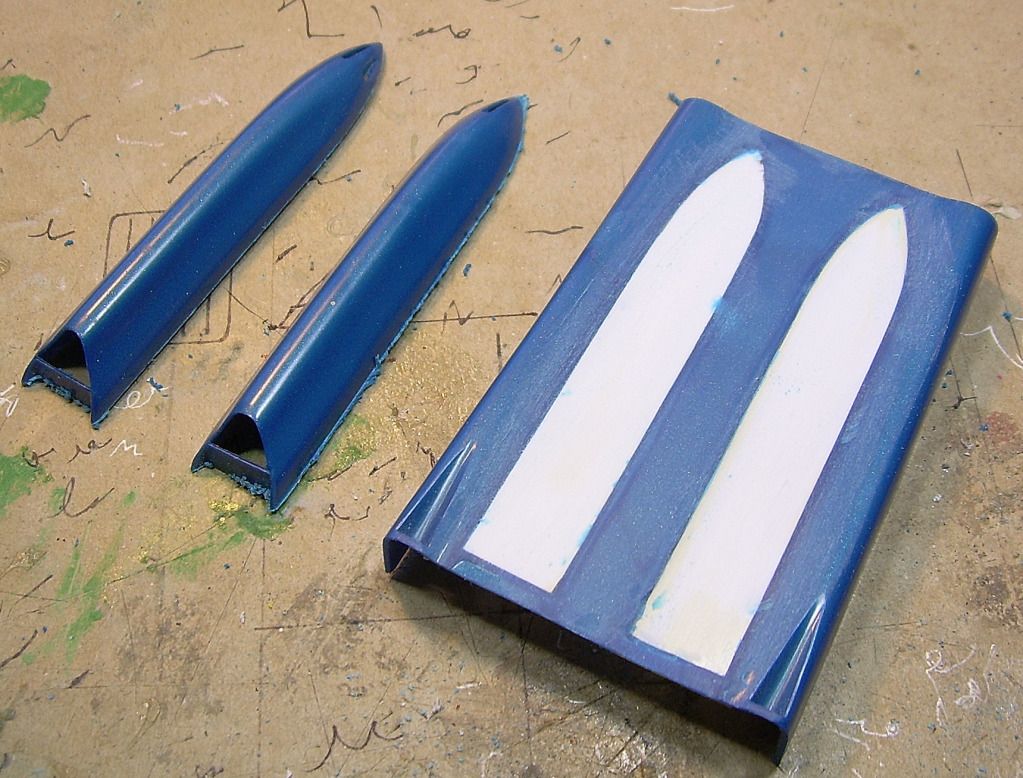

Started filling the underside of the hood before removing the scoops.......

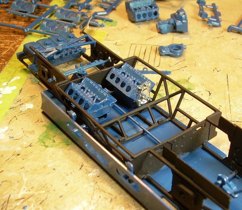

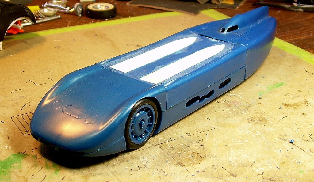

Posted 18 November 2012 - 04:37 PM
I appreciate the interest in this build. This is without doubt one of the more challenging kits out there, and the deeper I get into it, the more respect I have for Revell being able to produce this without CAD back in the '60s. It is quite an accomplishment, and the kit underscores Mickey Thompson's mechanical genius like nothing else can.

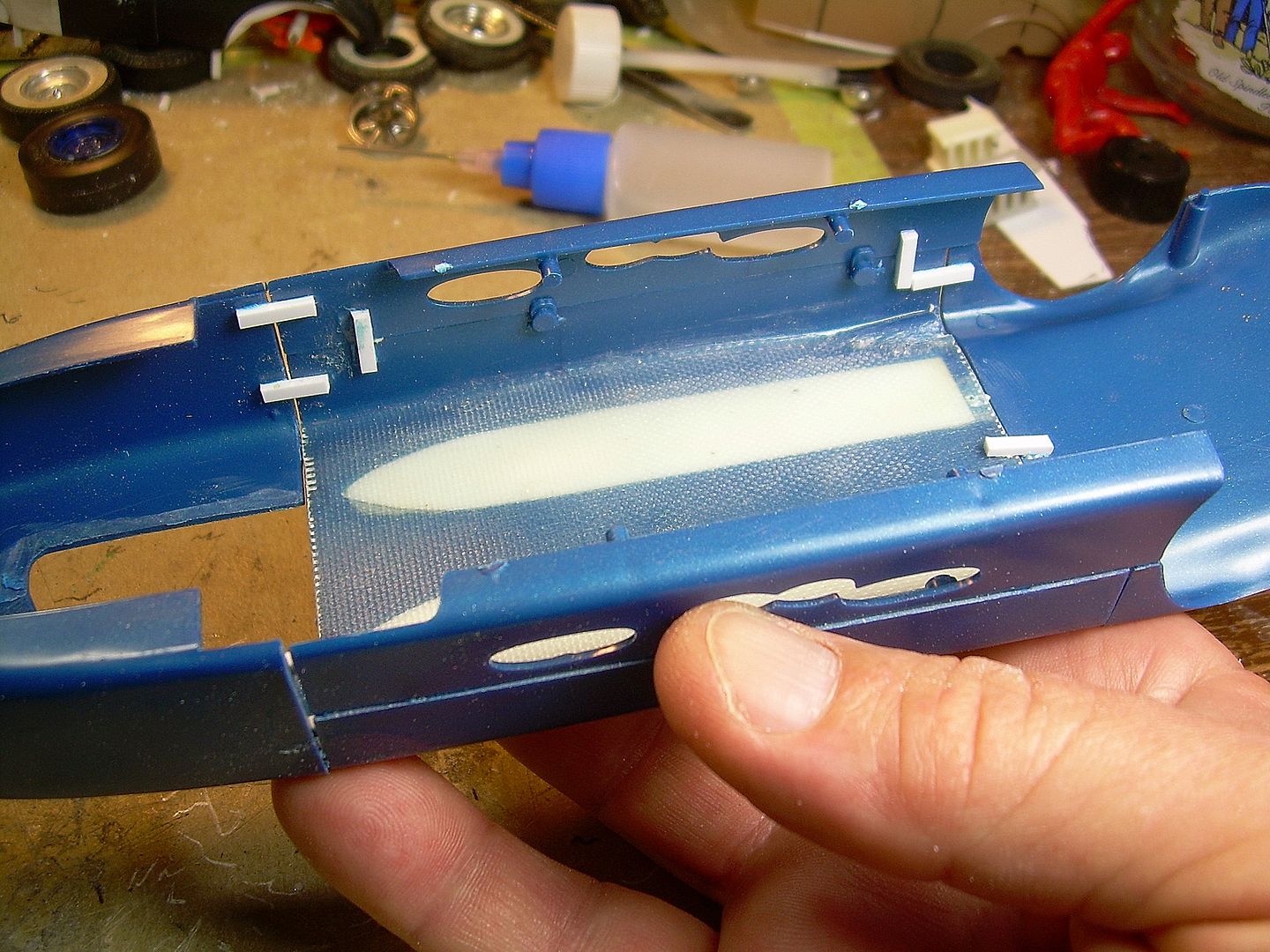

I've glassed the underside of the center body panel with two plies of very fine model aircraft cloth and epoxy resin. This will keep everything together and aligned while I remove the scoops. The limited bonding area around the periphery of the styrene inserts isn't sufficient to trust during the cutting operation.
Posted Image

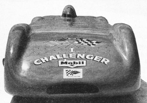

This is a trial of the technique I'm working on to represent raw aluminum bodywork. I don't want to use Alcald as it's too regular, and straight buffing-metalizer doesn't give exactly the effect I'm after.
Posted Image

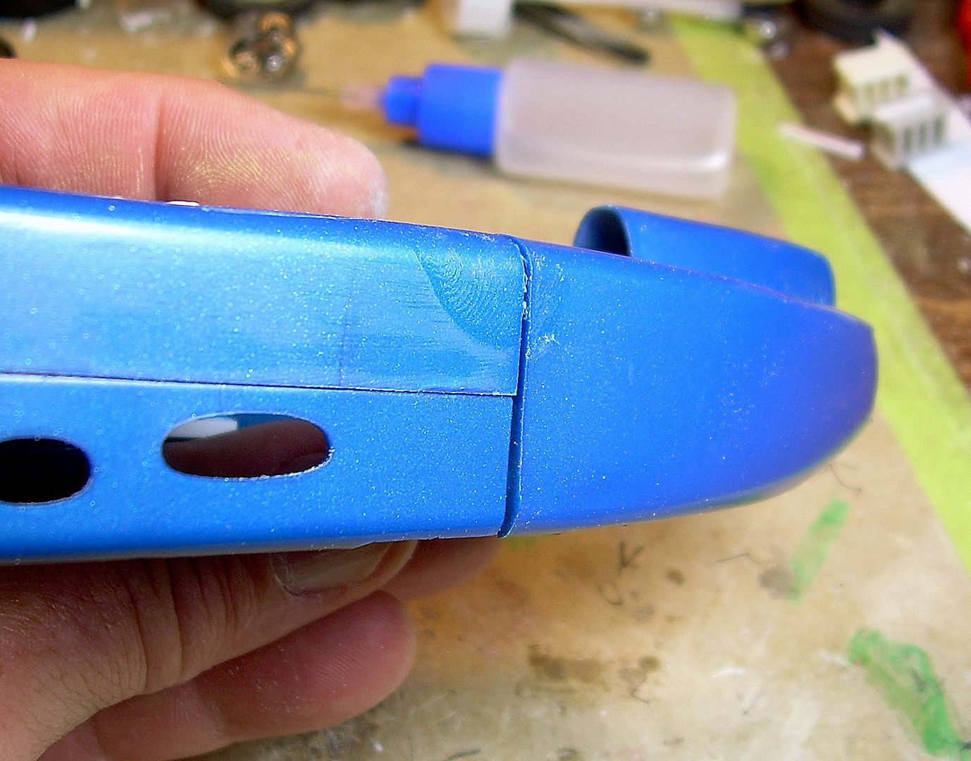

I realize now that part of the reason I made such a dog's breakfast of this kit when I was young was my lack of understanding of the functions of the parts represented. Though this is a GREAT kit, it takes some massaging and light modification to get it to all work like it's supposed to. For example.....the steering shaft location in the center of the car isn't really illustrated very well on the instructions, and there are no locating tabs for most of it. Test fitting showed that it has to be installed slightly offset at the front, in order to hook up correctly to the steering linkage on the front axle. Although the steering box and shaft are correctly molded to allow for this, the instructions don't mention it, and nothing will fit right in front without the offset, as shown.
There is also a hooya in the lower frame rails at the bottom of the photo. This is introduced by the locating tabs on the bellypan being just slightly too close together in this area. They will be modified.
Posted Image

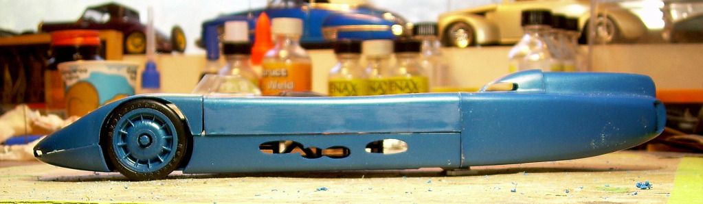

Posted 25 November 2012 - 09:42 AM

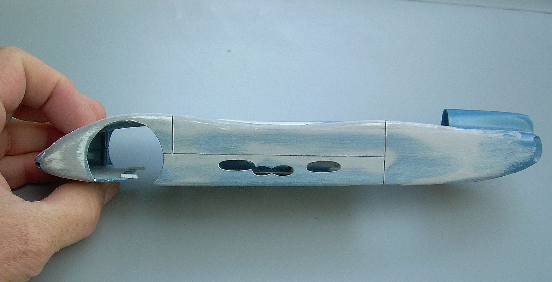

With the center hood nice and rigid from the 'glass, I was able to carefully saw the scoops off and preserve them for something else, which was the plan.....
Posted Image
The profile of the car just isn't as voluptuous as the 1:1 shots appear, so that will have to be addressed.....

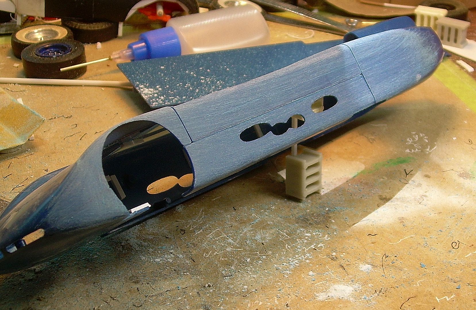

Posted Image
Still, I really love the look of purpose and speed this car always presents. There will be considerable test-fitting and minor mods to make everything fit, skinwise, as well, but this is a truly outstanding kit and everyone who is interested in the history of motorsports needs one of these. It will make a better, more patient builder out of you, too.

Looks great, Bill. I see what you mean about the voluptuousness factor not quite being there yet. Looks as though the upper mid-ship needs a little dipperty action along the corners, and the back end of the panel when it comes up to the cockpit given a little rise in the center.
Still, looks ready to rip.
