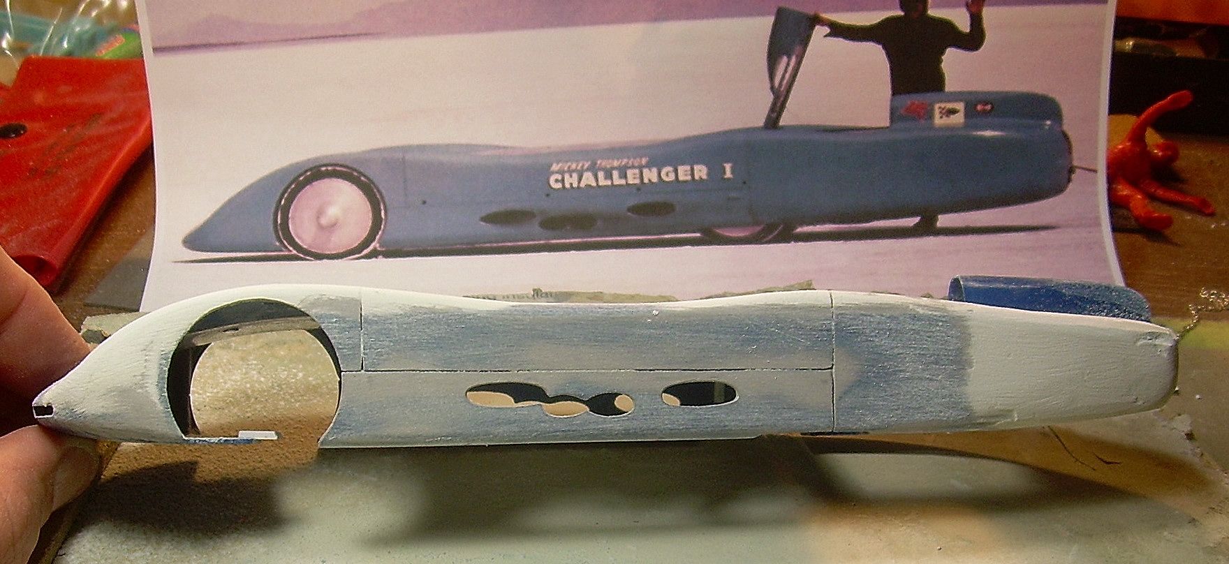

I've been thinking, and because the revised body panels have to fit EACH OTHER perfectly, the only way to get it right is to fixture all of the body panels together while i sculpt the modified shapes. I've glued temporary alignment jigs on the insides of all of the panels, and left enough of a gap on the end pieces for a razor saw blade.
Due to variations in the thickness of the kit parts, you get an idea of why this model has a reputation for being difficult. Still, this is one of my favorite kits of all time, and all the thickness and fit issues will be corrected as I go along.
Everything is stable, so the sculpting of the new shapes can commence, with the assurance the body sections will actually match up when the thing is assembled. This is another case where taking a break while thinking through the best procedure is going to streamline the work, and make for a much better model.

First things first. Got the sides flat to give myself a clean starting point by block-sanding with 80 grit open-coat paper. Seems a little brutal, but it's effective.
Next up, the voluptuous curves of the original body on Challenger begin to sprout. There's a LOT to get this body looking like the real first incarnation. Every panel is different, except the canopy.
Edited by Ace-Garageguy, 22 April 2013 - 01:07 PM.
Lovely! So what exactly are you doing here, building up the surfaces with filler then re-contouring them?

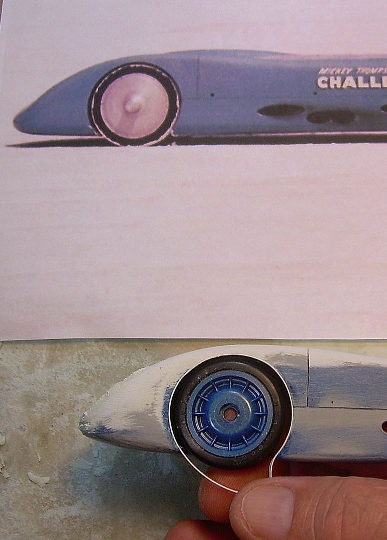

...... So what exactly are you doing here, building up the surfaces with filler then re-contouring them?
Yes sir, exactly. I'm trying to get the profile of those really pretty curves developed close to the left side of the car. They're very subtle and kinda tricky to get right. When I'm happy with the profile, I'll make transfer templates so I can make both sides match. Then, I'll go back and fill in from the outside edges to the correct width, then finally round all the contours till she looks right. The profile templates are absolutely necessary to keep it real though, in my opinion.
