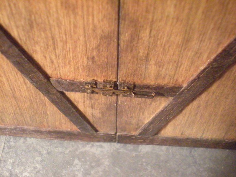

I'd asked elsewhere on the forum about weathering the wood door, and was offered some great examples. However, I really wanted to keep it subtle on this piece - used but not forgotten...something like that anyway. The whole thing already being stained helped that a good bit. The alky/ink bath didn't penetrate all that much...but just enough, I think. I wanted a little more in the lower parts, so I rubbed cig ashes into it then pulled the whole thing together with another wash. Finally, I dirtied them up where workin' hands and boots would have been grabbin' and kickin' at them day in and day out.
Then I went to work on the hardware, that I'd been picking away at over the last couple days. It's all shaped out of aluminum printing plate, drilled for rivets and attached with stretched sprue heated on each end to form a rivet head.

This looks great Chris. What did you use to paint/tint/annodize the aluminum?

The door hardware was just painted with acrylic black, shook up in a bag of real rust dust while still a bit wet, then given a blackwash to knock back the bright orange. I'm working on the electrical stuff now, on which I'm pretty sure I'll use oven cleaner and a wash or two.

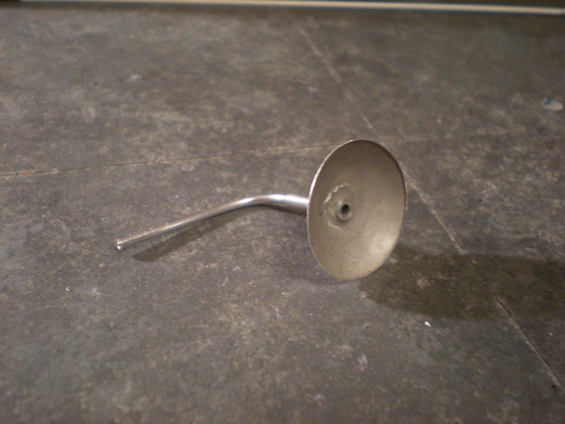

Let there be light! Okay, well...at least something for light to shine from...
Posted Image
Posted Image
I took a bunch of pics while I was making the shade, but managed to do so with the memory card sitting in the computer instead of the camera. Doh! I annealed aluminum printing plate and mini-metal-worked it out. It's got a good many slight imperfections...which are fine with me. Gives it a nice worn-in look. Next I'm at the lhs, I'll pick up a bulb for it.

Glu - your electrical stuff is over the top. I'd like to hear more about this annealing process you did with the printing plate because your light shade looks amazing!!

Annealing this stuff takes very little. I waved it over my soldering torch for about 30 seconds per side, just making even passes back and forth to get it all. It gets pretty soft. The thinner stuff was too thin and tore under the stress of working it into a dome, but the thicker material was good. I'm pretty sure I could have gotten a deeper dome if I'd tried. I may yet.
