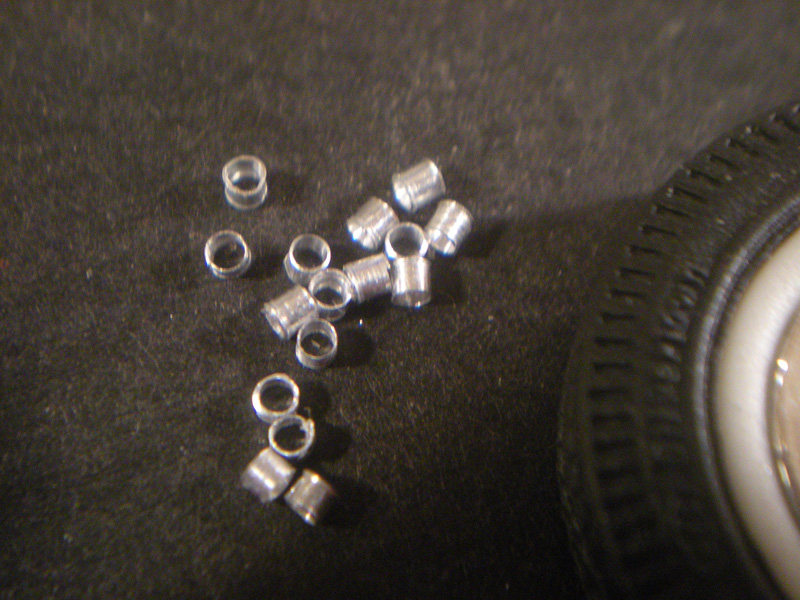

Not much new tonight other than a bunch of nasty little tedious carp out of the way. Took a little head scratching to figure out how to make those little sleeves without destroying them in the process. Finally figured out to score the aluminum tube first then let the drill separate the pieces as it bored the inner diameter larger. Good little trick to remember for down the road...I'm sure it'll come in handy again on other things.
I need to scratch up two outlet boxes, then I can start painting and weathering this stuff.

Yep, more printing plate. Cut a strip, and bend a 90 near one end. Then I taped a scrap piece of the rod they'll be used with to a wood stick, and with the 90 up against one side of the rod just bent it over and pushed the other 90 in with my fingernail. A quick push in on each 90 with the end of a file to make it nice and crisp, drill and trim, and that's that.
