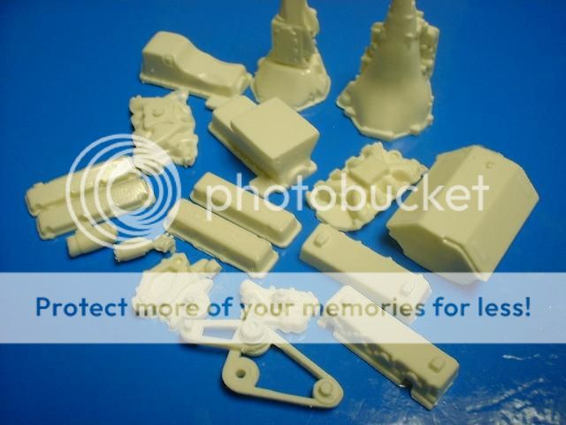

This is how I've been casting my engines. Block and all components are cast as individual pieces. Some are tougher to do than others! LOL If you have any questions, feel free to ask...

Casting a complete engine would be a mess. Many, many opportunities for air pockets and bubbles, not to mention tearing up the molds getting the things out. I agree with casting the block as one piece....I've done many engine molds this way. Most of the rest of the pieces can be done as open face molds - the easiest kind to work with. Be sure to cover the mold after you pour your resin so you get a perfectly flat mating surface. Your problem areas, or the parts that will cost you the most time, will be things like belt/pulley assemblies, exhaust (if you include them) and small parts. The block, heads, intake, oil pan, etc, are all pretty simple.
I pulled molds and cast the entire 429 Ford from the Revell Torino a few years ago. I was pretty happy with the results, though some of the problem parts I mentioned above needed a good bit of cleanup.

I've done it both ways. The main impetus for doing the 429 that way was that it came with a four-speed trans in the kit, and I wanted to build a replica of my racecar, which at the time had a C6 automatic. Casting the entire block/trans as one piece is problematic.....too many undercuts. If I was doing it, I would join the halves of the engine/trans and then separate the trans, but you'll probably have to have two kits to do that, because of the material you'll lose cutting them apart. You might well be able to add the missing material from thin sheet plastic. Casting the engine/trans halves works OK but if there is any warpage in your parts you end up with the two halves not matching exactly. That was my experience, anyway. Large lumps of resin like that can warp a bit and with something as long as the engine/trans, a little warpage can be a real problem.
