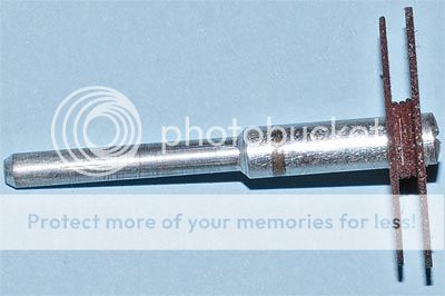

If you want to chop a Top or section a body this works out well. Take the Sanding/Cutting Disks and stack them with broken ones as spacers. This combo works out to a 1/25 scale 3" cut and as long as you have a steady hand the cuts will be parallel!
Clever idea! I'll have to give it a try. Thanks!
#17 Crazy Ed
Crazy Ed
  • 674 posts
  • Location:Pearce, Arizona
  • Full Name:Ed Erbeck Jr.
Posted 10 November 2012 - 02:30 PM
Much as I'd like to take the credit for the idea it wasn't mine, just one of those things that too good not to pass along.
