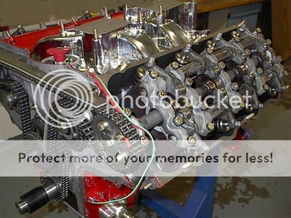

And an additional pic of the cam-drive chain arrangement. Judging from this and the second photo futurabat posted, it COULD be possible to drive an alternator from the chain....through one of the holes you mention in the housing.

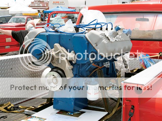

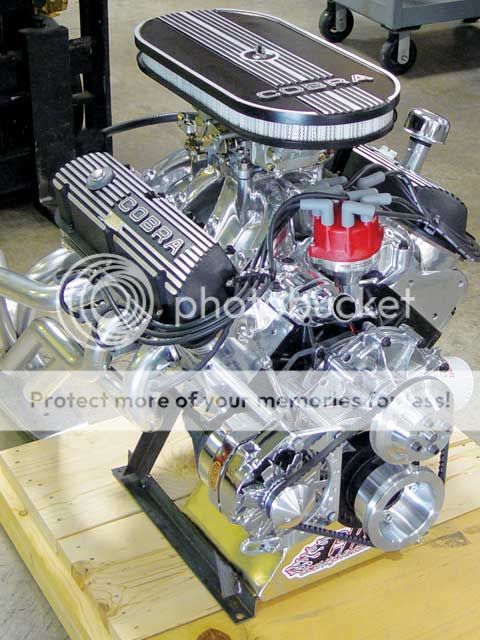

Here are a couple of photos I took at the recent Corvette and Muscle Car Nationals. Maybe these would help.
