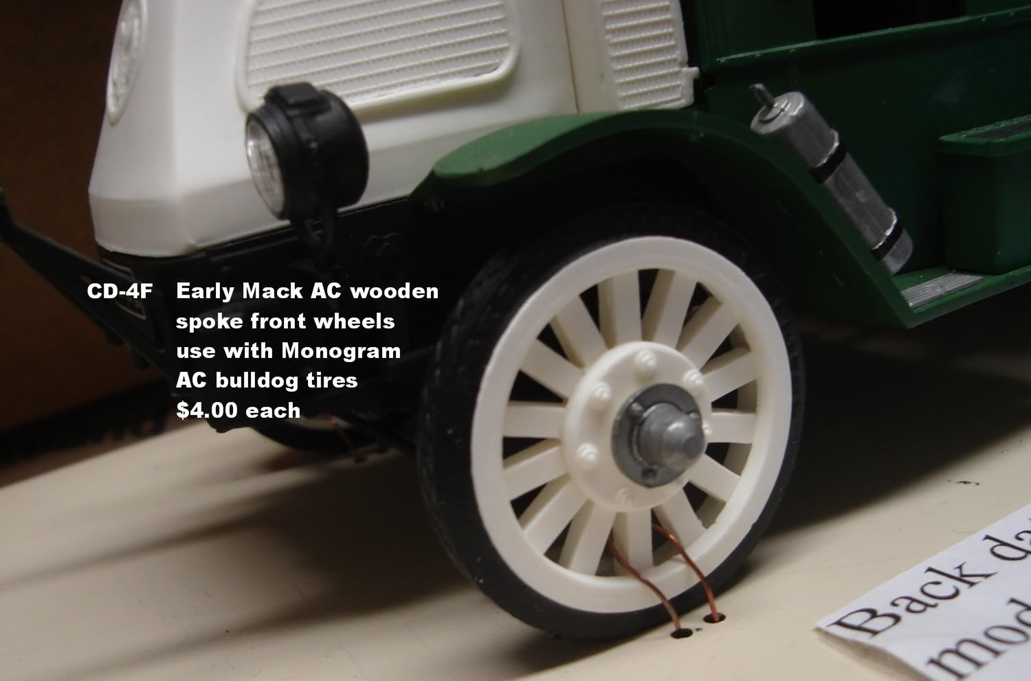

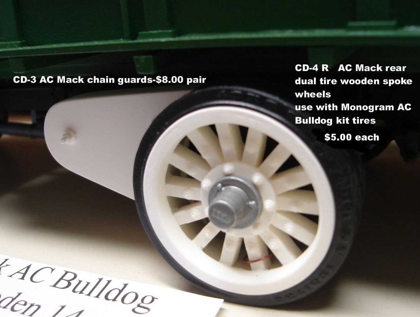

For those interested in a little different option, AITM is now offering wooden spoked wheels and some back dating pieces. Their quality and price are typical of AITM. I have given my wife a printed out order form to add to my Christmas list(hint, hint). Here are some photos that Dave Natale sent following my inquiry about these items. I am not affiliated with AITM, just a satisfied customer who appreciates the unique and quality items that he offers.

Thank you so much for all who posted. I will investigate the suggestions. All good information

Iam also lookinginto the new parts for one from AITM Dave does have some great stuff and Ihave bought from him before.
