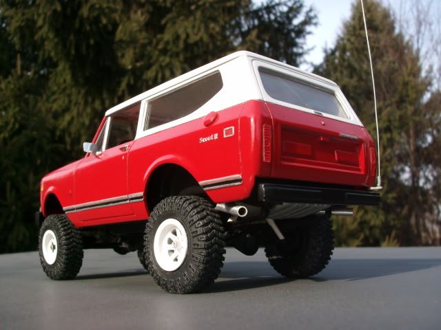

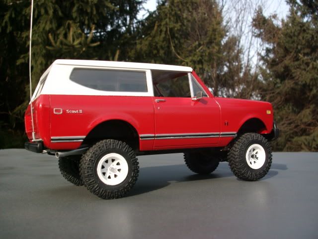

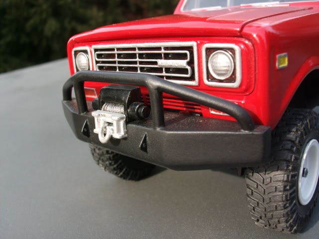

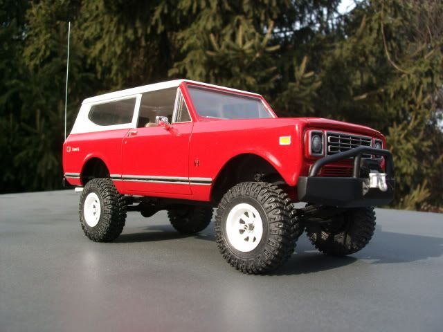

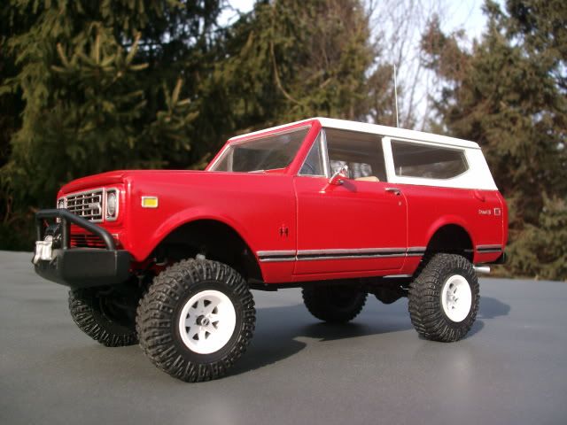

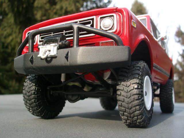

My take on the AMT Scout that Jeff (jeffs396) alluded to in my introduction post. I scribed in the various missing panel lines on the body. Lift came via a spring over conversion. Baja Claws from Ma's Resin, mounted on wagon wheels from the Swamp Rat Jeep. The wheels are 6 bolt and wrong for a Scout, but it didn't bother me. Scratch built the front bumper and winch (hook and framework the cable comes out of from parts box). Spruced up the lackluster engine bay with a master cylinder, washer bottle, and scratched heater motor. Painted in Valspar IH Red and Krylon Gloss White. A fun build. I've got another one in the stash I need to dig out and build one of these days. Thanks for looking...

Really cool,been eyeing a few real scouts in my area.I am in the midst of on of these scots and it is a pain in the tail.What did you do to raise the suspension on it?

The stock suspension has a spring under setup (leaf springs under the axles). So to lift it, I did what they do with a lot of the 1:1's, a spring over. I carefully removed the leaf springs from the axles and remounted them on top. In doing this, the front sat slightly lower than the rear, so I fabbed up a crude set of shackles for additional lift. Here's a couple of pics I took during the build. Hope this helps some.

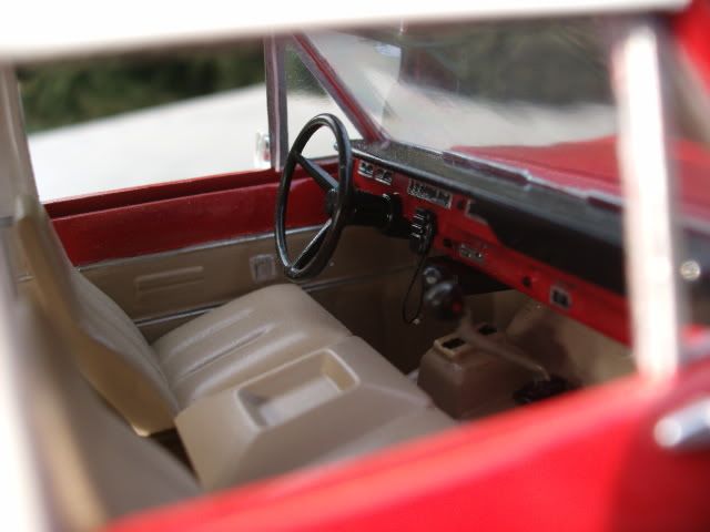

Tony, you really did a great job best build of this kit l have seen. What color and brand paint did you use on the interior??
Thanks Carl.  I believe it was Valspar Urban Beige for the interior.
