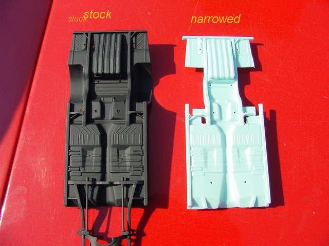

first off, i believe the revell kit is 1/24th. if so, the chassis out of any pro stock  revell kit (any pro stock firebird or camaro) the wheelbase is almost exact and the chassis futs under it real nice. if you are pro touring it, usually the tires for a pro sturing are not as wide, you can carefully cut the area from the gas tank to the frame rail out and move it (the frame rail inboard to the gas tank. check out the hoto, this is a GTX frame, but you should get the point. find what tires you want first and then you will know exactly what path to take. lowering is easy, just depends on how much detail you want under it.
