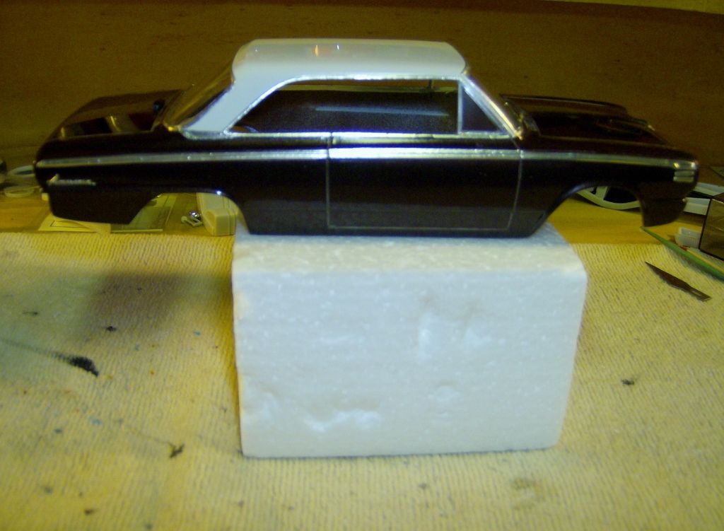

OK...  five hours to trim the BMF on this beast...  my eyes hurt...
It all came out pretty well...... except...... when I peeled off the excess foil on the long side trim pieces, apparently the new XActo blade cut through the paint in spots and the excess foil pulled off teeny, tiny chips of paint...Grrrrrrrrrrrrrrrrrr!!!!!!!!  Plus the BMF is not totally even along the side trim.   This only happened on the side trim.
My plan is to remove the foil on the long side trim, touch up the paint with a teeny brush and allow that to dry.  Then I'll clearcoat the whole body.  Once that is dry and polished (if necessary) I'll reapply the foil on the long side trim, that way the XActo blade will be less likely to cut through the paint again.  It's extra steps that I wasn't planning on but I feel it's necessary to have the model look good.

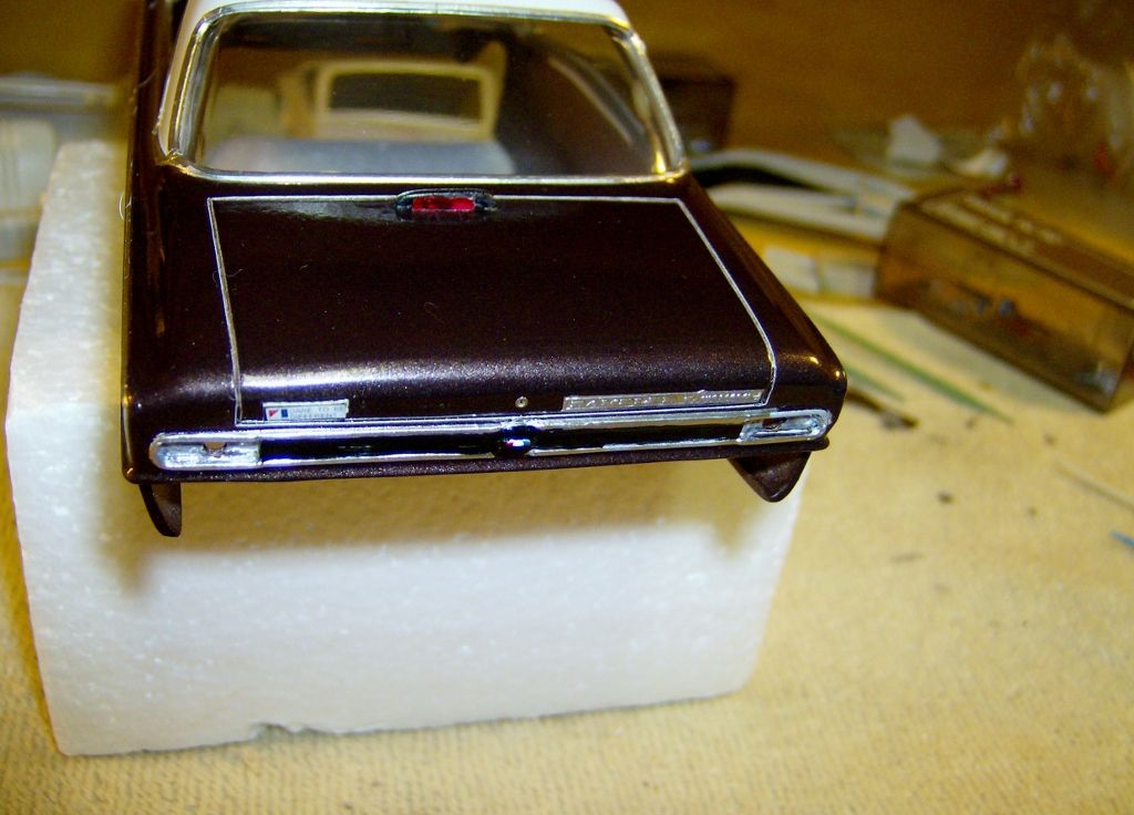

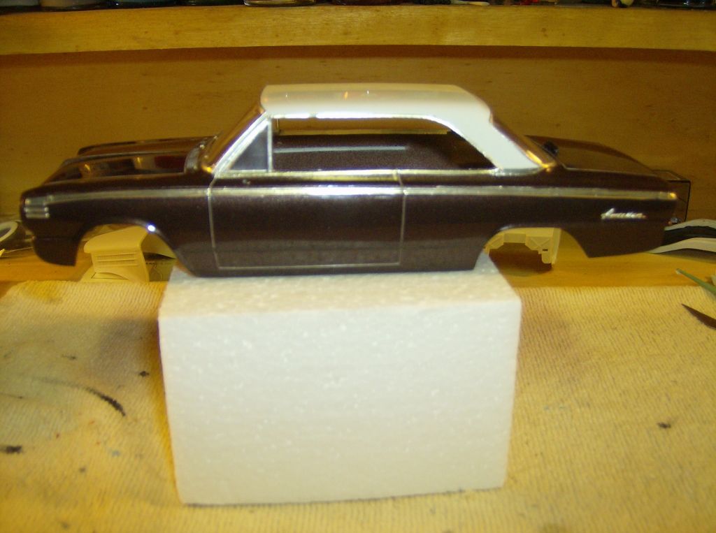

Okedokey......  I touched up the paint, clearcoated the whole body, polished it out and reapplied the long side trim BMF.   Pics follow...
On the right rear of the trunk I attached an AMC sticker that I cut from a photo of the rear of my friend's car.  It reads "Dare to be Different".  I also glued on a PE trunk keyhole.  I also painted the insert between the taillights black as on the 1:1 car, and I painted the gas cap handle red, white and blue as my friend did on the car... I also installed a 3rd brake light as is on the car...
