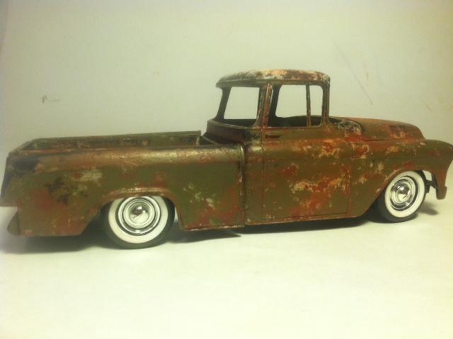

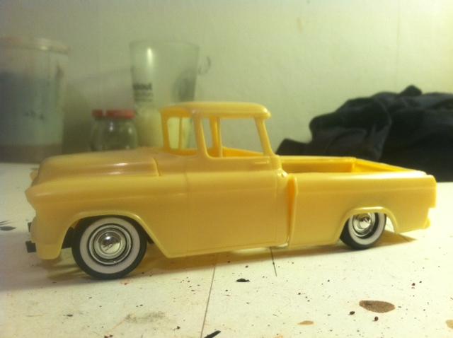

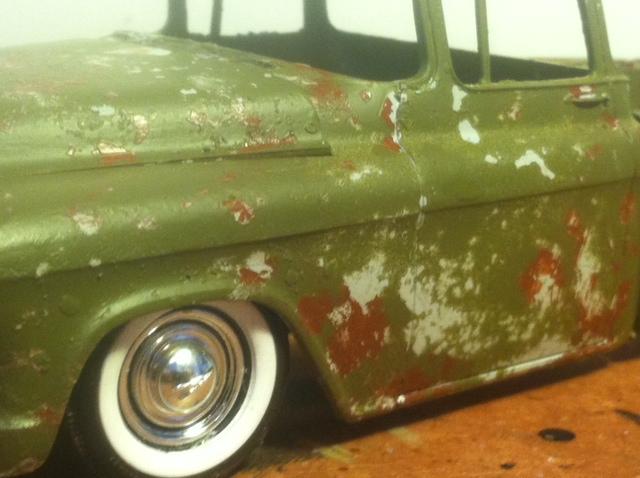

hello ya'll here is my version of rusting plastic. i started with amt's 55 chevy cameo this will be curbside so i notched the body for stance.
and the rest will be body work and a little interior work.Attached File  photo (101).JPG   25.54K   9 downloadsAttached File  photo (102).JPG   27.72K   9 downloads
after cleaning up the body a bit lay down your primerAttached File  photo (103).JPG   25.48K   9 downloadsAttached File  photo (104).JPG   28.58K   16 downloads
let primer dry then lightly sand spots you want rusty and brush on rust enamel pretty liberally.Attached File  photo (105).JPG   36.25K   23 downloadsAttached File  photo (106).JPG   27.88K   25 downloads
let dry then run under the faucet the wetter the better. sprinkle salt everywhere you want. the water allows the chipping effect where primer shows along with rust.Attached File  photo (89).JPG   29.93K   22 downloads

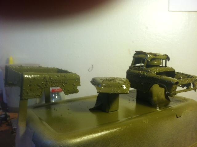

spray your main color while still wetAttached File  photo (90).JPG   25.1K   26 downloads
let dry fully then run under hot water brushing salt and loose paint off. Attached File  photo (91).JPG   37.28K   27 downloadsAttached File  photo (92).JPG   30.93K   27 downloads

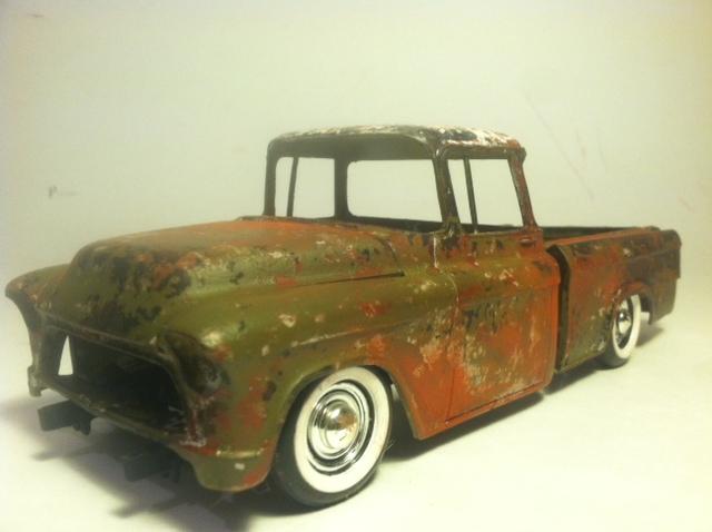

brush on drawing ink i use higgens black magic for my drawings and now for my modelsAttached File  photo (93).JPG   28.35K   26 downloadsAttached File  photo (107).JPG   44.4K   23 downloadswash off after about 2 to 3 minutesand it will fill lines and leave a bit of black chippingAttached File  photo (94).JPG   31.58K   29 downloadsAttached File  photo (95).JPG   42.24K   36 downloads

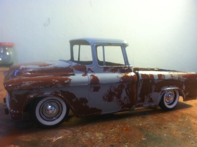

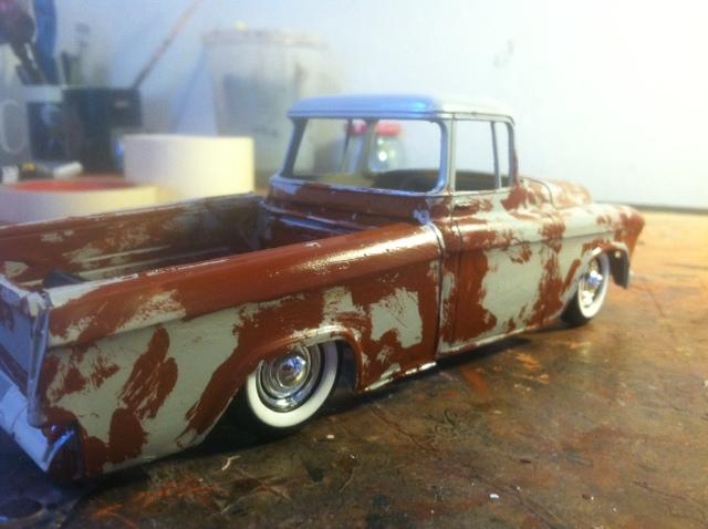

then i go back with the rust enamel and some sand paper and hit spots that look to man made
Attached File  photo (96).JPG   22.84K   41 downloadsAttached File  photo (97).JPG   25.84K   45 downloadsAttached File  photo (98).JPG   32.51K   42 downloadsAttached File  photo (99).JPG   32.87K   36 downloadsAttached File  photo (100).JPG   27.07K   22 downloads
thanks for reading and hope it helps. ill post this in the under glass forum by the end of the year i hope
thanks again  ryan
