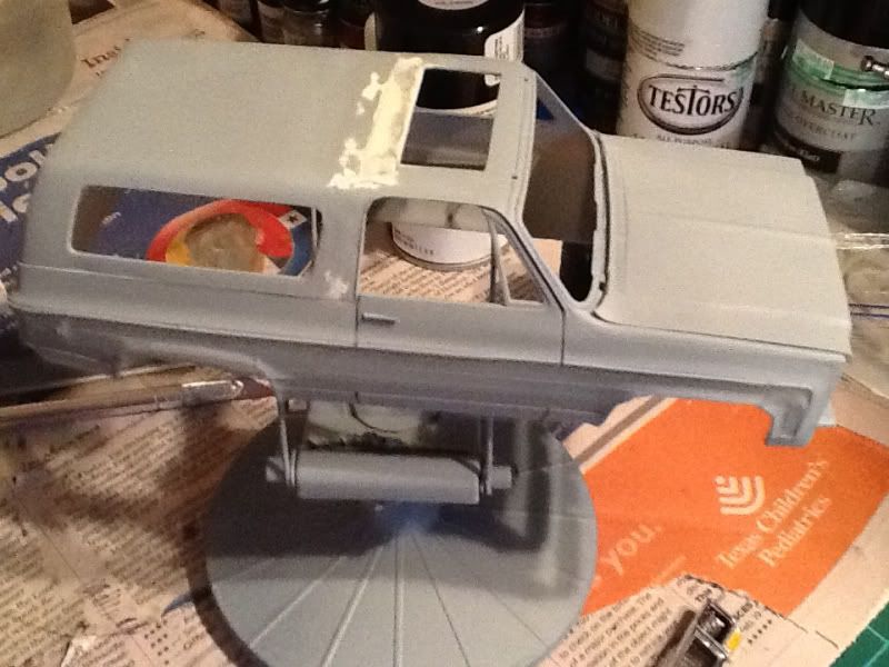

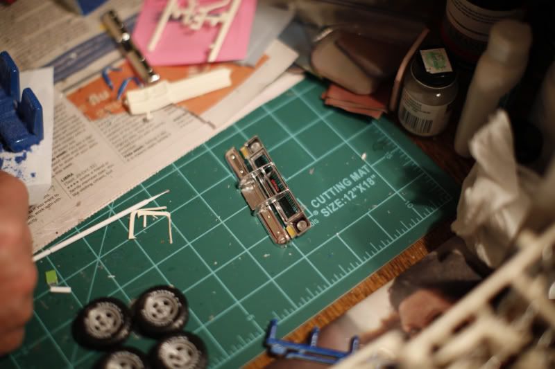

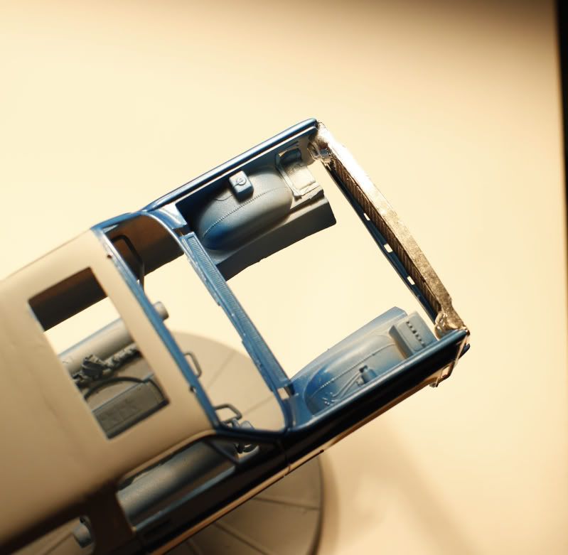

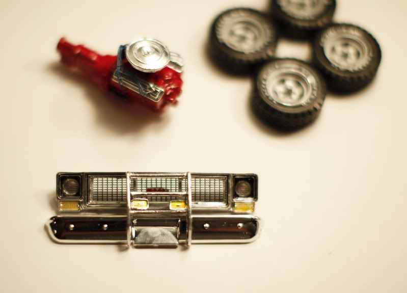

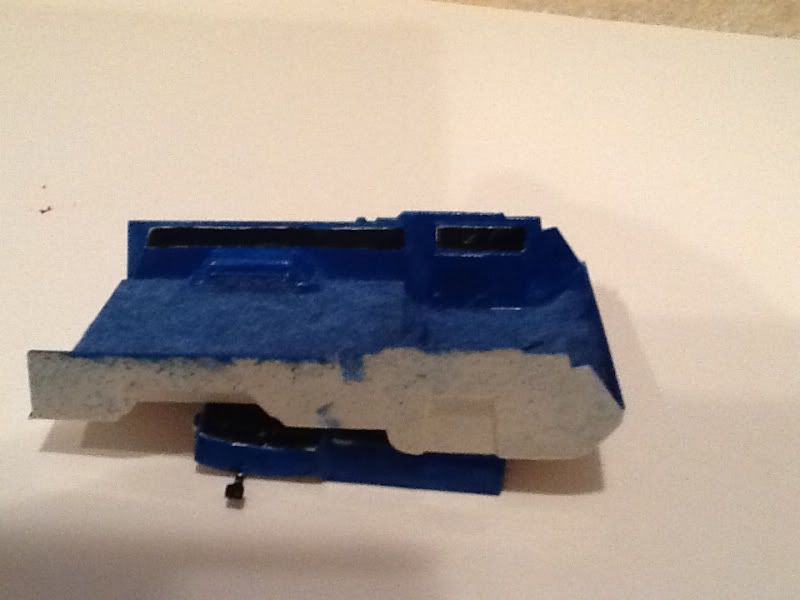

Back in 74 I bought a74 GMC Jimmy that had a lot of after market items installed on it. I don't have any pictures of it but I do remember what it looked like so that is what I'm working from and the old GMC brochure. My truck was blue with the wood grain on the sides and a white top. This is the kit that I'm starting with. It's a 77 or 78 so I've started by adding the side trim molding fixing the top to go up to the windshield and remove the door frames. I have also reworked the front grill.

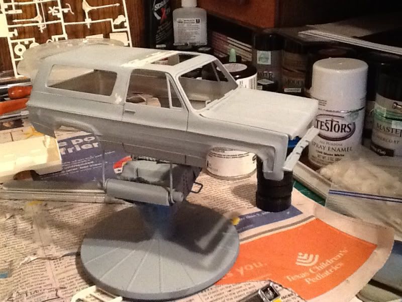

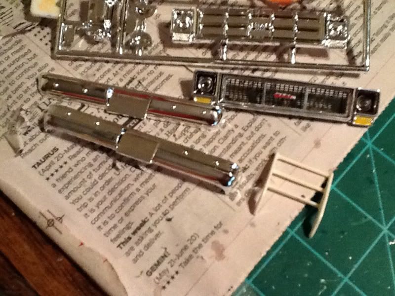

I also picked up the new GMC snow plow truck to use the bumpers and hood to match the 74.

Sounds great!  That grille looks nice already, what did you use on it?

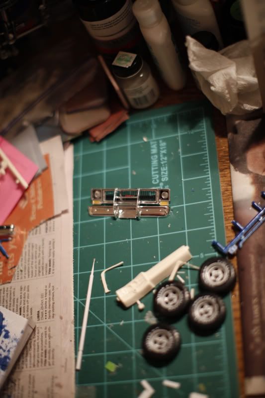

Posted 05 January 2013 - 01:31 PM

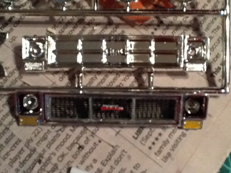

I just cut the center out of the 78 and added 2 sections with some photo edge gril behind it painted black. I also cut out the GMC painted them red and glued it to the gril. I used a bic black felt pen to fill in the black lines.

Posted 07 January 2013 - 04:25 PM

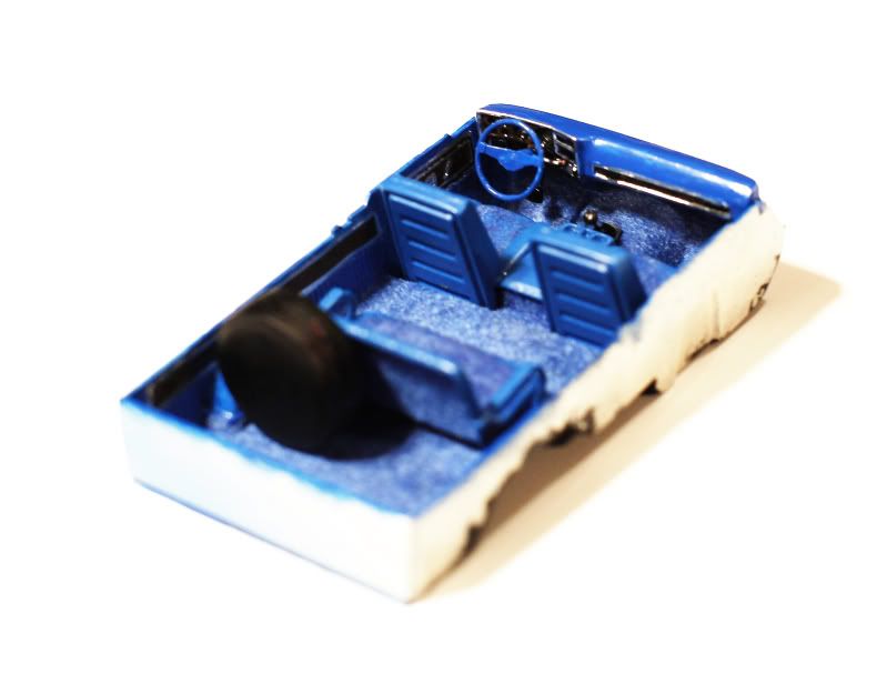

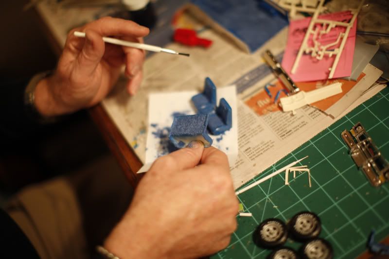

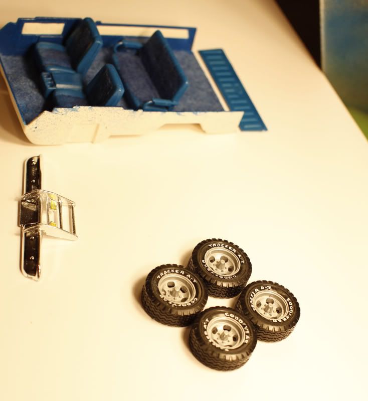

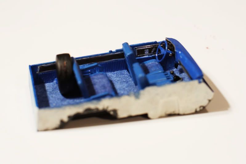

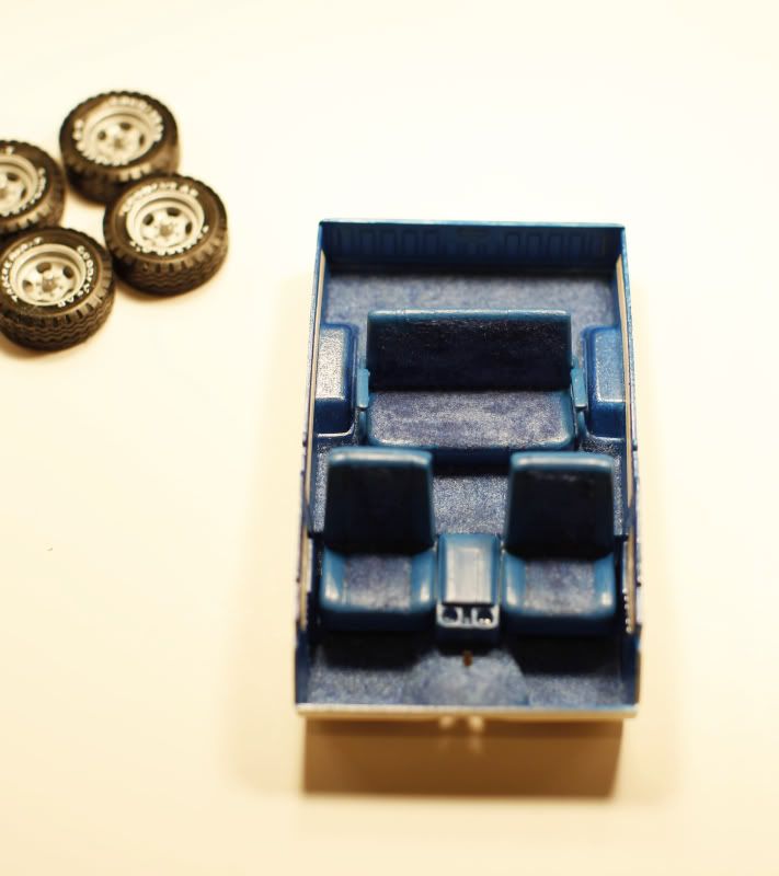

Here are a couple up dates I've painted the wheels and the raised letters, also cut down the front brush bar and put BFF to make it chrome. Started working on the interior with some blue flocking on the floor and on the seats for the cloth section. I have a question the kit has 2 bateries one on each side. I don't remember on mine but I do know that I only had one battery but I don't remember what side it was on. Help please what side should the battery be on. Thanks.

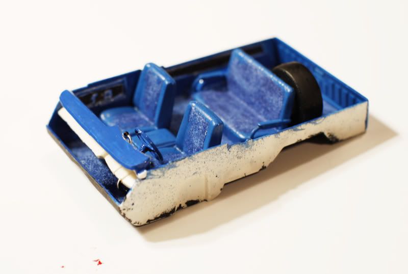

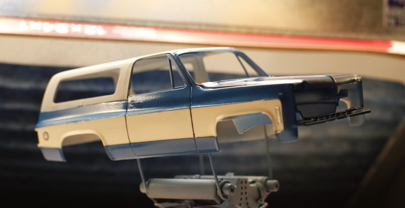

Posted 11 January 2013 - 02:57 PM

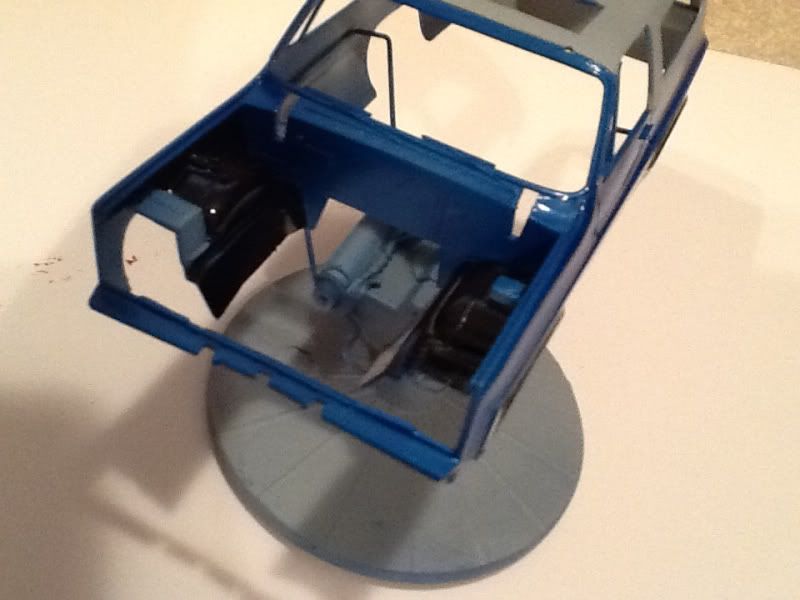

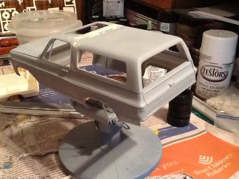

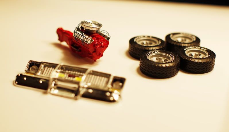

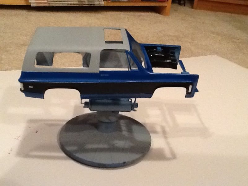

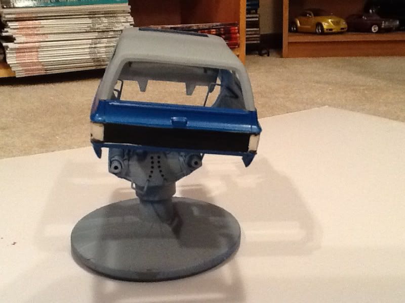

Here are this weeks updates. Worked on the interior with flocking on the floor and to make the seats cloth by using flocking and covering it with flat clear coat. Added fog lights to the brush bar and started work on the engine added spark plug wires and changed out the air cleaner. Also started painting the body. The white mid section will be wood grain and the top will be white. I'm working on how to create the wood grain and would appreachate any ideas on creating the wood grain. The white sections in the interior will also get the wood grain.

#8 Mopar - D
Mopar - D
  • PipPipPipPipPip
  • 339 posts
  • Location:Houston
  • Full Name:Dan Slade
Posted 11 January 2013 - 02:59 PM
#9 Mopar - D
Mopar - D
  • PipPipPipPipPip
  • 339 posts
  • Location:Houston
Posted 11 January 2013 - 03:01 PM

#11 Mopar - D
Mopar - D
  • PipPipPipPipPip
  • 339 posts
  • Location:Houston

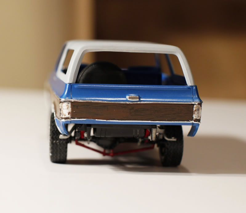

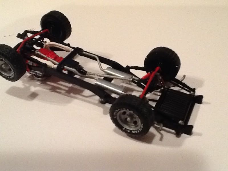

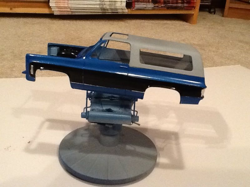

Posted 13 January 2013 - 06:38 AM

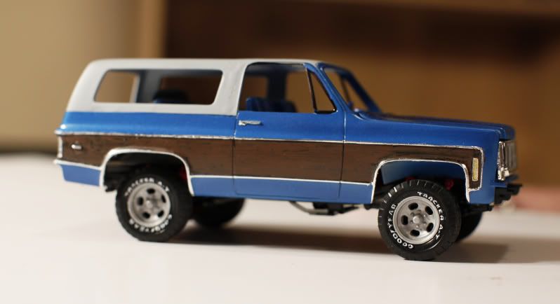

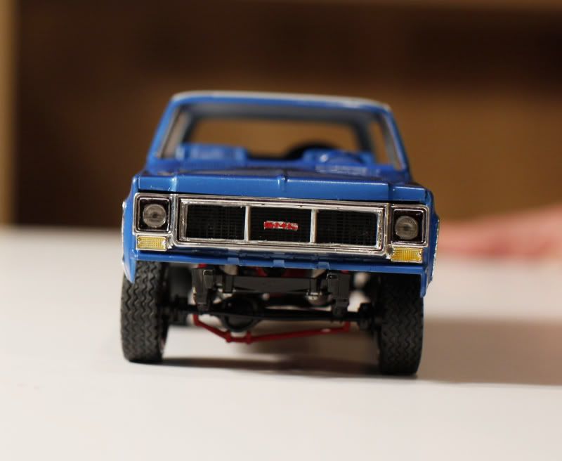

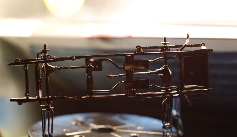

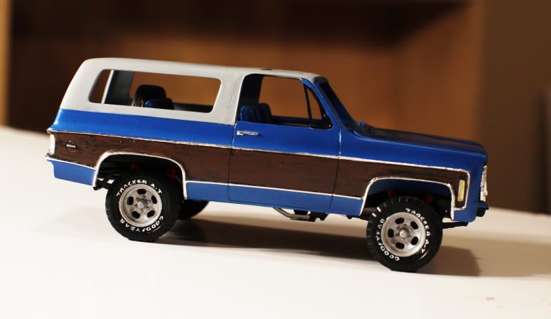

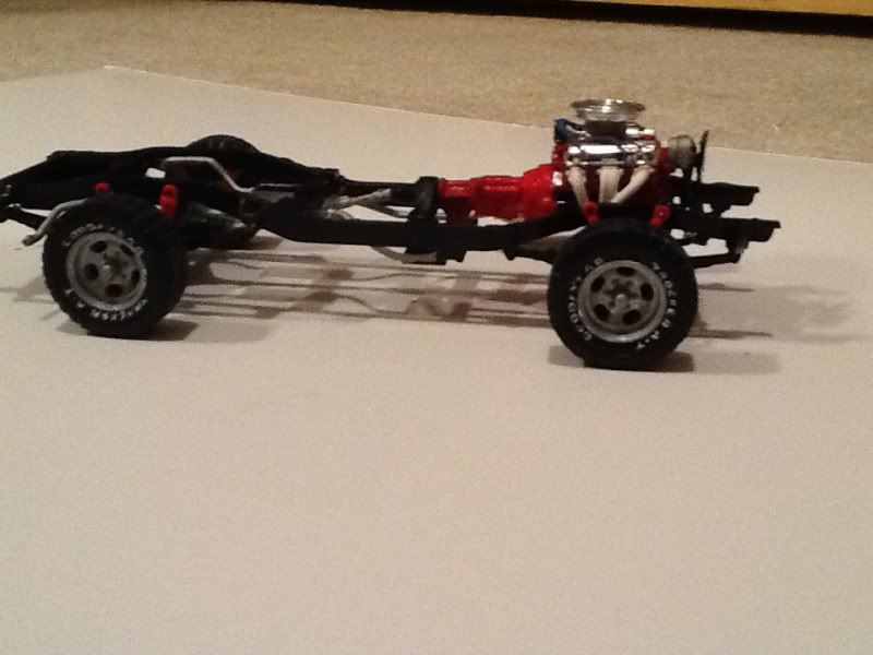

Made some more progress with getting the engine and frame put together with the wheels. I have been testing different ways to create the wood grain and have come up with a black base with Tamiya red brown streaked over it gives a good close repersentation of the GM wood grain. Just have the black base on now will put the red brown after its dry and BMF the trim around it.
#12 Mopar - D
Mopar - D
  • PipPipPipPipPip
  • 339 posts
  • Location:Houston
Posted 13 January 2013 - 06:40 AM

Looking really nice. I love the carpet floor effect.......don't totally get how you did it but very nice indeed :

Posted 15 January 2013 - 02:55 AM
Rob, for the floor carpet first paint the area to be covered with a color close to the carpet then I use A brush to put Elmer's glue where I want the carpet to be and then spread the flocking over it very heavy and pat it down just a little after it drys I just brush off the extra. It is a good idea to do all your painting around the carpet area first as the lint from the flocking will get in your paint.

Posted 15 January 2013 - 03:13 PM

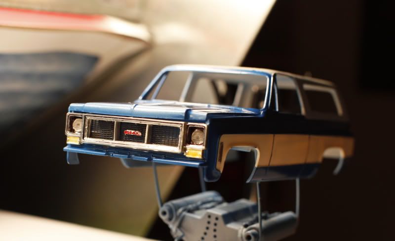

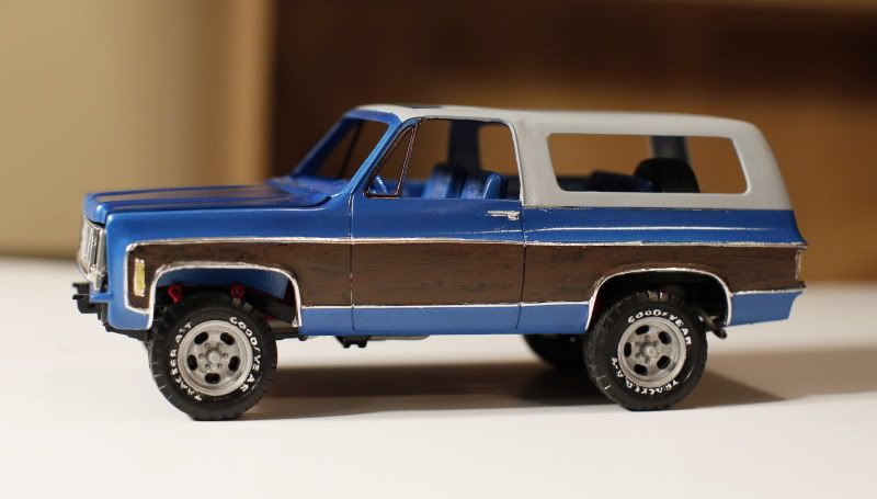

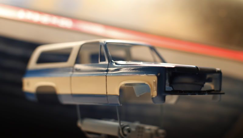

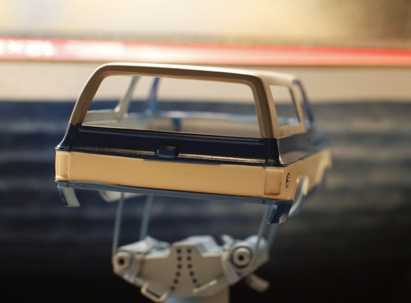

Today's updates with the wood grain and BMF and interior together.
#17 Mopar - D
Mopar - D
  • PipPipPipPipPip
  • 339 posts
  • Location:Houston
Posted 15 January 2013 - 03:14 PM
#18 Mopar - D
Mopar - D
  • PipPipPipPipPip
  • 339 posts
  • Location:Houston
Posted 15 January 2013 - 03:16 PM
