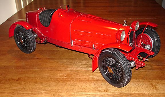

#27 Harry P.
Harry P.
  • Administrators
  • 17,915 posts
  • Full Name:A mere layman...
Posted 06 January 2013 - 08:33 AM
#28 Cato
Cato
  • 863 posts
  • Location:Eastern East Coast
  • Full Name:See below:
Posted 06 January 2013 - 09:17 AM
^^^Just beautiful. Painting makes a lot of the laminate construction of the rim 'go away'.
Thanks again and keep it going-can't get enough of your detail work.

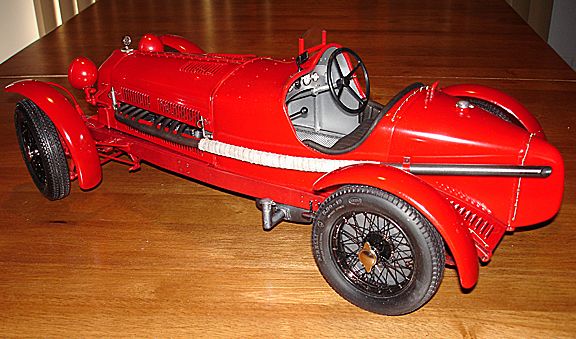

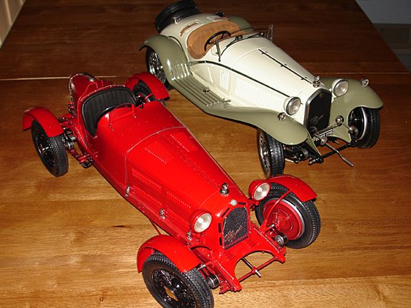

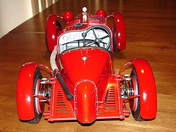

#29 sjordan2
sjordan2
  • 4,812 posts
  • Location:Knoxville, TN
  • Full Name:Skip Jordan
Posted 06 January 2013 - 09:20 AM
A true masterpiece, Harry, and excellent text. This is definitely material for the magazine -- and a special occasion, since you actually FINISHED it!  :lol:
However, it would be good to see more full-body shots from a variety of angles. I'd like a better look at your hood piano hinge.
