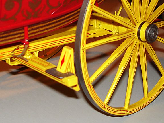

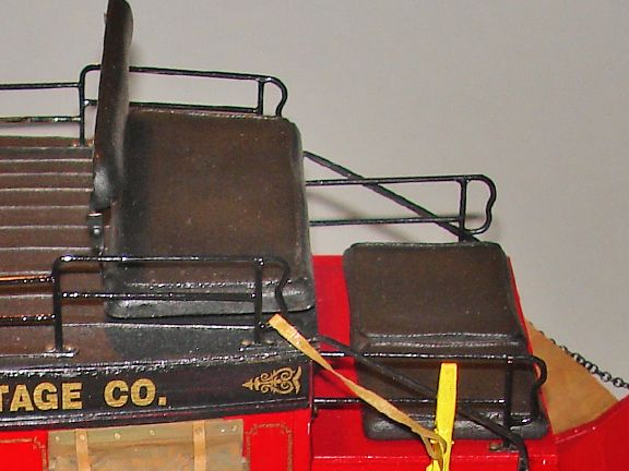

Anyway, enough of the history lesson. The kit is mostly wood (laser cut pieces) with a lot of smaller detail pieces being cast white metal. The roof rails are brass rod that the builder has to bend to shape and assemble. There are also photoetched parts (mostly buckles and stuff like that). The model is built pretty much the same way as the original-piece by piece, tiny bolts holding everything together. While the bolts are all real, individual pieces, they are not threaded... you hold them in place by gluing on tiny cardboard "nuts." The front and rear axle assemblies alone have dozens and dozens of individual pieces to them... once everything is assembled and painted, it's hard to see how many pieces are actually in there, but there are a lot!
Each wheel spoke has to be carved to shape by the builder, which is a very time-consuming process. The "leather" luggage boot is actually paper that I painted with acrylic craft paint to look like leather. The chassis and coach body are painted with acrylic craft paints and glossed up with Future. Pinstriping was done with red and black fine-tip Sharpies. I scratchbuilt real padded diamond tuft upholstery for the two interior benches. Here are the pix:

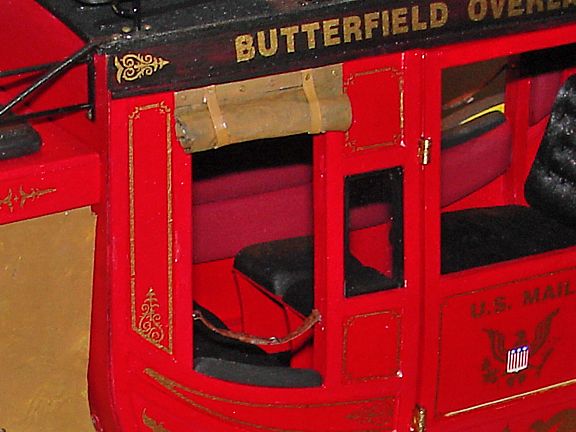

The coach was equipped with heavy leather or canvas shades that could be rolled down to cover the windows in bad weather:
It's hard to see, but here is a shot of the interior:
The brakes were nothing but large wooden blocks that rubbed against the iron "tires" when the driver pulled the brake lever:
That brake lever was to the right of the driver:
