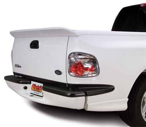

Is there a way to remove the transparent red from parts such as taillights?  I need to take taillights like these
p66319_large+1999_Ford_F_150_Lightning+R
to ones that look like this

Is the transparent red plastic or is the transparent red paint?

The only way you can get clear lenses is to make a mold of your existing tail lights and cast them with clear resin. There's no way to remove the red in transparent lenses since they are molded in red.

Some models do have just painted clear pieces which can be removed in normal ways.

In 99% of the models I've seen, ( thousands) the transparent red pigment is mixed into the clear styrene the parts are molded from. To be sure, break or cut through the sprue the parts came on. If it's red all the way through, you're out of luck and will have to make molds and reproduce the parts in clear resin, as suggested above.

u can also vac-um form the lens..

Kinda figured but thought i'd ask
