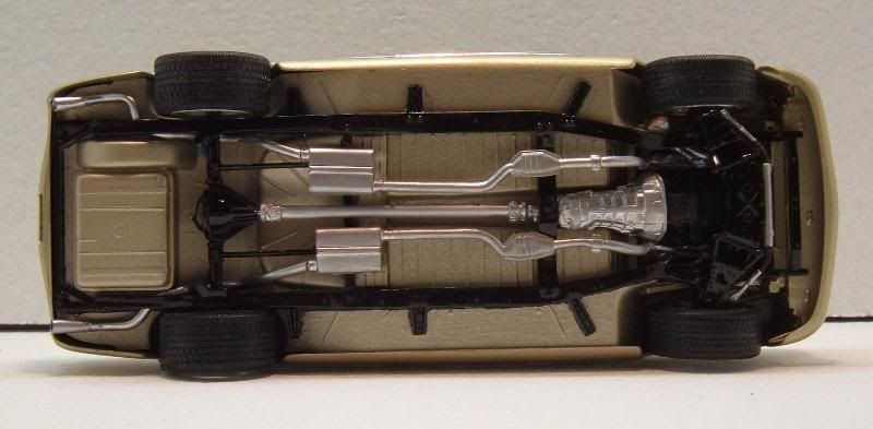

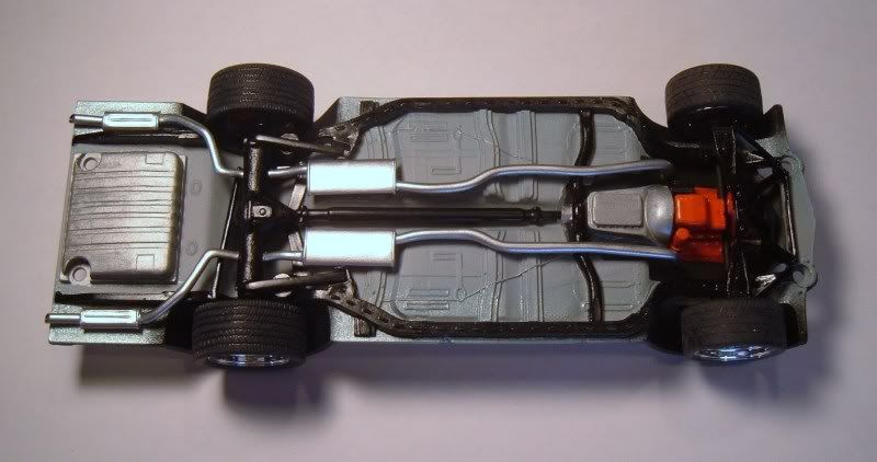

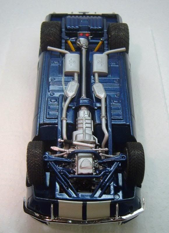

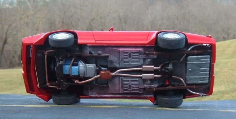

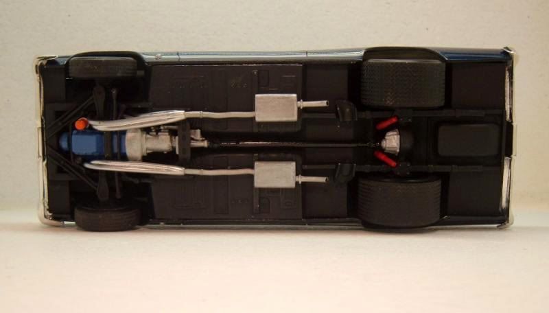

If you are going for a factory stock model, you will have to research each car specifically, as there are many variations to finishes. I like to paint the main undercarriage flat black. Then I use rub and buff and very lightly highlight raised areas. I then paint the other main parts (rear end, etc) a different sheen of black or metalizer. I also like to pick out small details and bolts in different colors. Just breaking up the monotony of black helps a lot.
Chances are, you will be the only one to notice it much. Most people look at the top of a car and don't have much concern for the underside - I still think its fun to detail, though.
Ill see if I can find a picture or two to post.
Here is one:
This one was just done with different metalizers:
And at the other end, here is a weathered chassis:

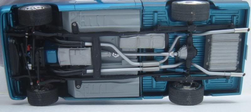

As you can see, I like chassis detail. Funny thing, as I went though the albums of my built models, I didn't have chassis shots of many of them... and I went to a lot of work on those.  The above chassis is on an AMT '55 Chevy pickup and was done to represent a working vehicle. Note that every vehicle has some degree of dirt and wear on the chassis. Even new cars on the lot have the start of toning on the exhaust system and rust on bare bolts. I also like to do some weathering, anything from a light dusting for a new car to bring out detail highlights like Erik did above.
For varying dark tones, collect different brands of black, semi gloss black, flat black etc. You'll find that when you put them next to one another, they vary in color and effect.  You can also use Testors Metalizers, I like them without the fixative coat.  There are also dark grays that work on chassis. I like the Testors Euro dark gray (I believe this once was called Panzer gray) because it's very dark, almost black.  I've used this for bottom floor pans.  You can also add different tones by using Testor Dullcote or semi gloss over any of the above. I also like the Poly S / Floquil weathering set that includes colors like "mud", "rust", "grimy black" and "dust".  One brand of these is acrylic (preferred by me) and one is more enamel. The acrylic is easier to blend with water for weathering.
I also like to use earth tone pastel chalks.  I bought a set at a hobby shop that is just the earth tones and that $10 box has lasted forever. I leave the sticks in the box and sand the sides of them to get dust to either brush on the model or to work onto the model with Testors Dullcote.

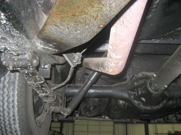

One suggestion I have is  RESEARCH!  I regularly go to eBay Motors to collect detail photos from the car ads. Some sellers post 20-50 photos and I'll often save an entire set on vehicles I'm interested in. Some put the cars on a lift and shoot several shots of the chassis. That's where you'll get the detail you need to build a killer chassis.
Here's an example of a reference shot.  Not the greatest picture but what I had on hand. This is actually the Deora show car.
Even the parts photos are useful. What's the underside of a used tranny look like?  Here ya go!

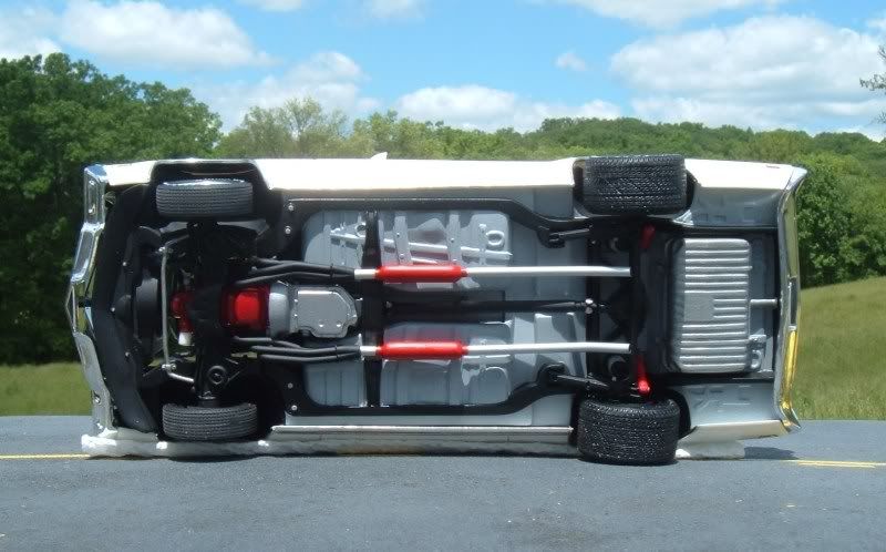

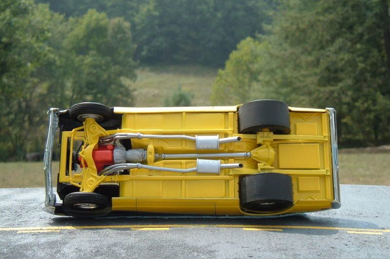

I never paint my chassis' flat black or semi gloss black anymore unless it's a curbside build. I used to, but like you said, it's a "yeah whatever" type deal. Like Bill said, do some research and see how the real cars look underneath. You'll be hard pressed to find a real car that has a flat/semi gloss black floor pan unless it's one that has been undercoated. Most cars have the chassis primered and sealed with body overspray on the edges. Newer cars have practically no overspray on the floor pans. It also depends on what type of build you're doing. Hot rods,street machines and customs usually have the floor pans painted body color. Stock or semi stock will have the primered chassis with overspray on the edges and the chassis (if separate) a semi gloss black.
Here's a few examples
Even though this was a curbside build, I decided to detail paint it
And for a comparison. Here's an old build that I painted flat black. :rolleyes:

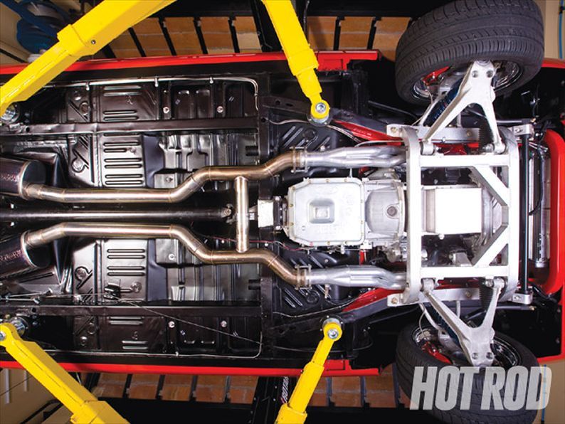

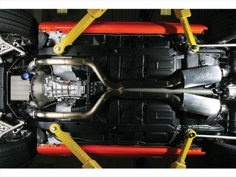

Actually, it is quite common to have a black undercarriage.  Google "<insert car name here> undercarriage" and you will get results, most of which show a semi gloss undercarriage.  I do both, but it's not hard to find black.
Camaro:
hrdp_0712_07_z1972_chevy_camaroundercarr
Charger:
hrdp_0901_03_z1968_dodge_chargerundercar
Some other car:
56 Ford:

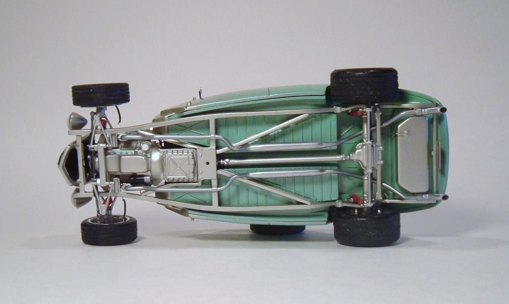

I built this Mustang a few years ago and weathered it as if it had seen just a few years of regular service.  I used paint washes and artist's pastels.
You're off to a good start!  Research and look at pictures online to fill your mind with the natural patterns of dirt and rust that occur as chassis age and soon this will be second nature to you.
