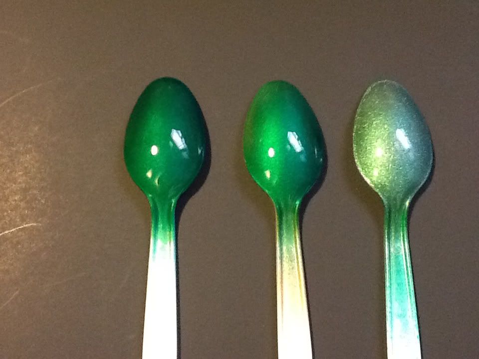

Ok so I'm not sure where this would go, other than Q&A. Here goes I have three options. More importantly it is accomplishing something. Painting spoons comes out better than my cars.
Before I go on I will post what I done, starting with the left
The pearl powder is dry brushed
1: Copper base, candy green (no clear yet)
2: Copper base, pearl powder, candy green. ( no clear yet)
3: Copper base, candy green, pearl powder, pearl clear

I like the far left best. I like the middle one also. The far right, not at all. Too much unless you're painting a buggy or a bass boat.
I agree with this unless you want to accomplish a 60's theme flake paint look.

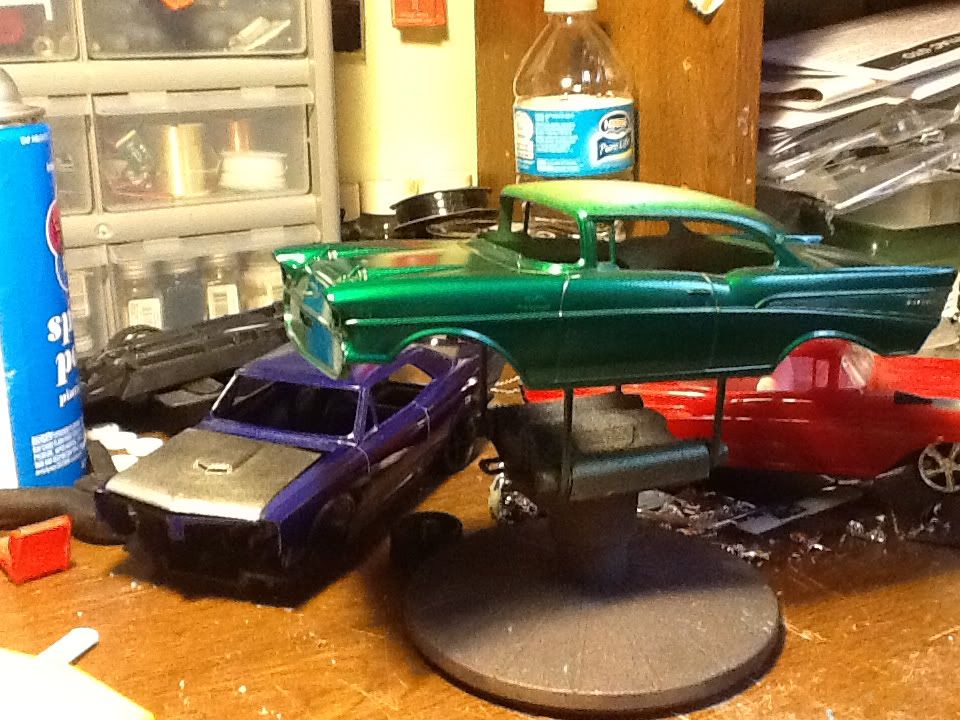

Well I went ahead with the paint, I was preparing this for a car show and stupid on my part I did not think about the mold lines. I bought this kit built w/o paint. So I did not see them until the paint was on. So it goes on a shelf when I'm done lol.

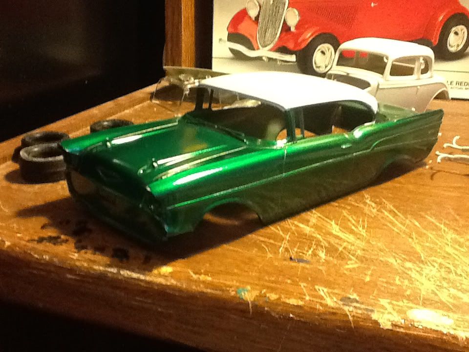

Well here it is, it will get a gloss white top to go with it. And the stock wheels.
I have a red one just like it that will get the same treatment without the mold lines lol
Edit: This is the second option
Copper, pearl powder, candy green (no clear yet)
Edited by Kaleb, 11 January 2013 - 10:05 AM.

Joshua....I was just going to mention what Greg had said.... I have never seen anyone dry brush pearl before. Any time I have used it I have mixed it in with my clear or mixed it in an inner coat clear. laying down a few coats then coming back with 3/4 coats of clear. By the way the color looks good on the '57.
