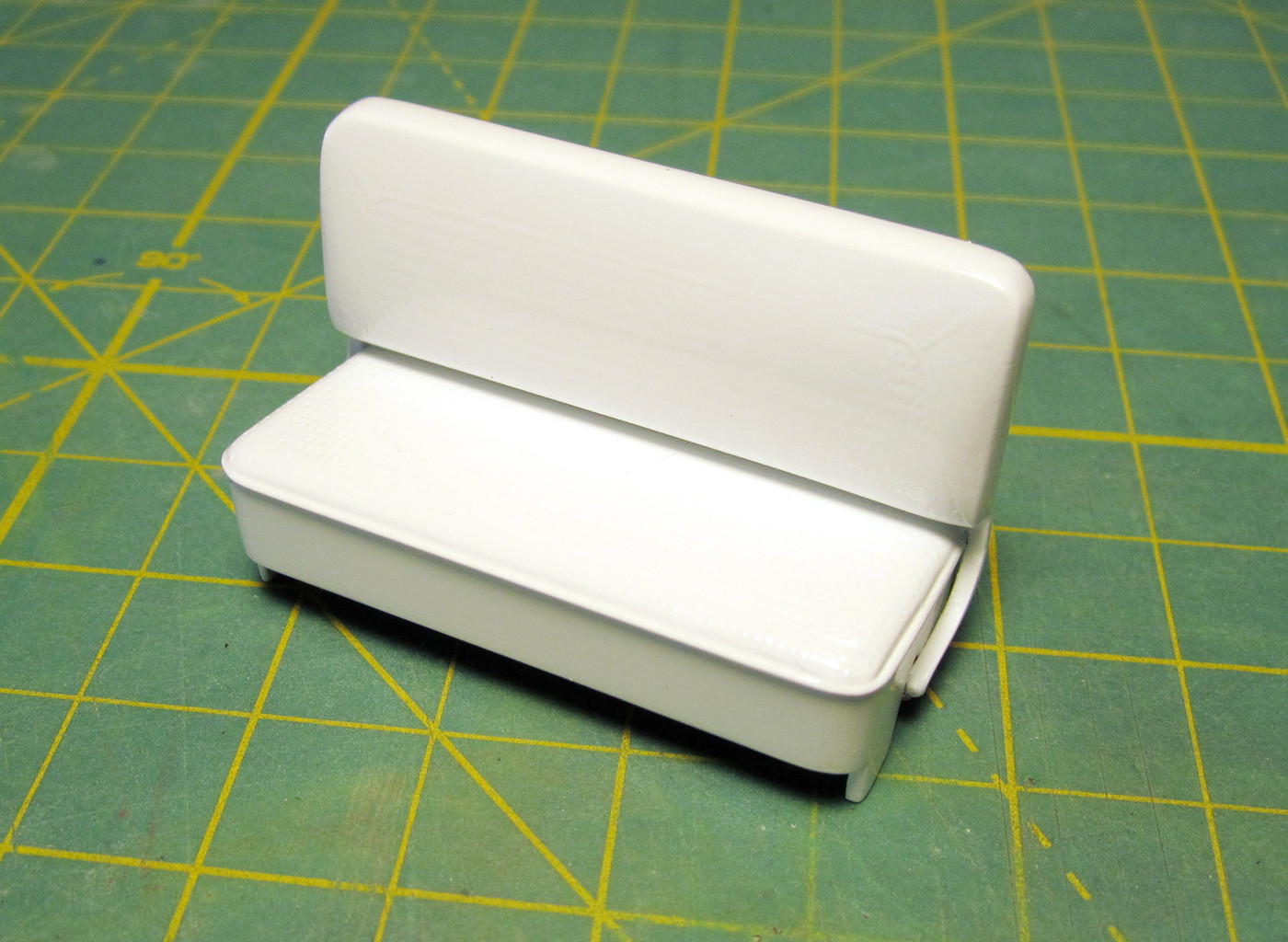

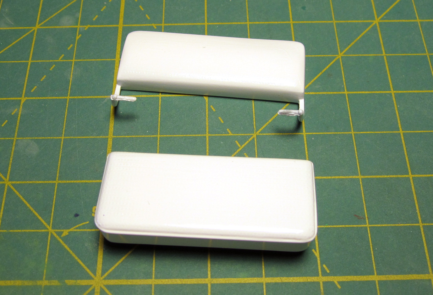

I first painted the seats House of Kolor White base and then sprayed inner coat clear over it afterwards. Next step is to get the decals on the seat for seat material:
Had to mock the seat up:

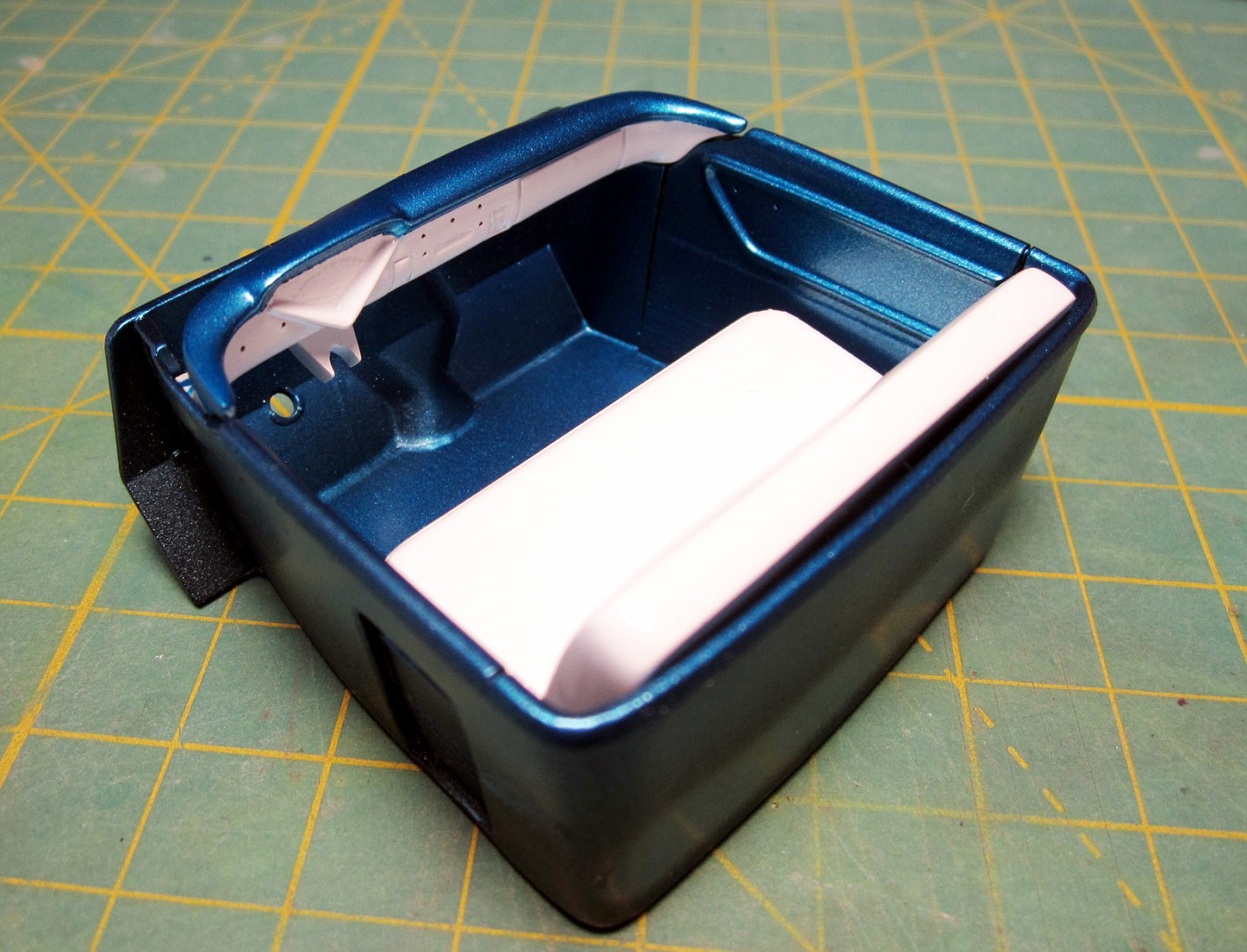

Here is the interior bucket, it was first prayed with HOK black base then I sprayed PPG's Toyota Speedway blue over it. I left it just the base with no clear on it:

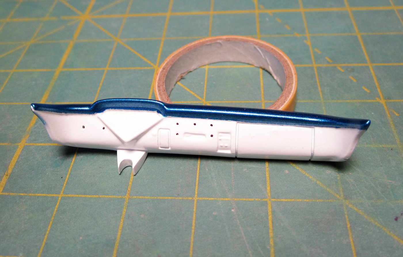

Here is the Dash, It was sprayed with HOK white base first then sprayed HOK inner coat clear. After the inner coat clear was dry I taped the dash off and then sprayed PPG Toyota speedway blue:
Here I placed the dash into the interior bucket:

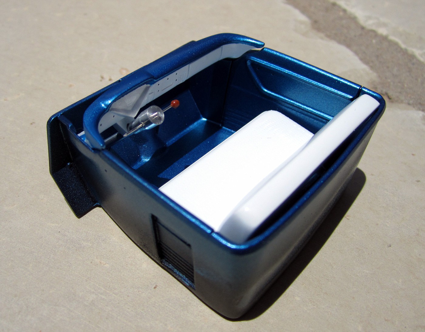

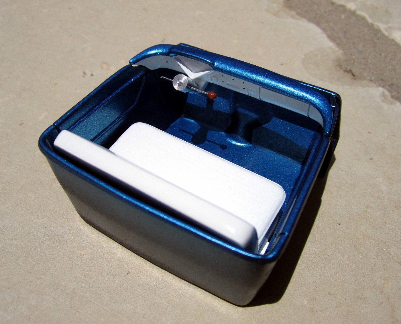

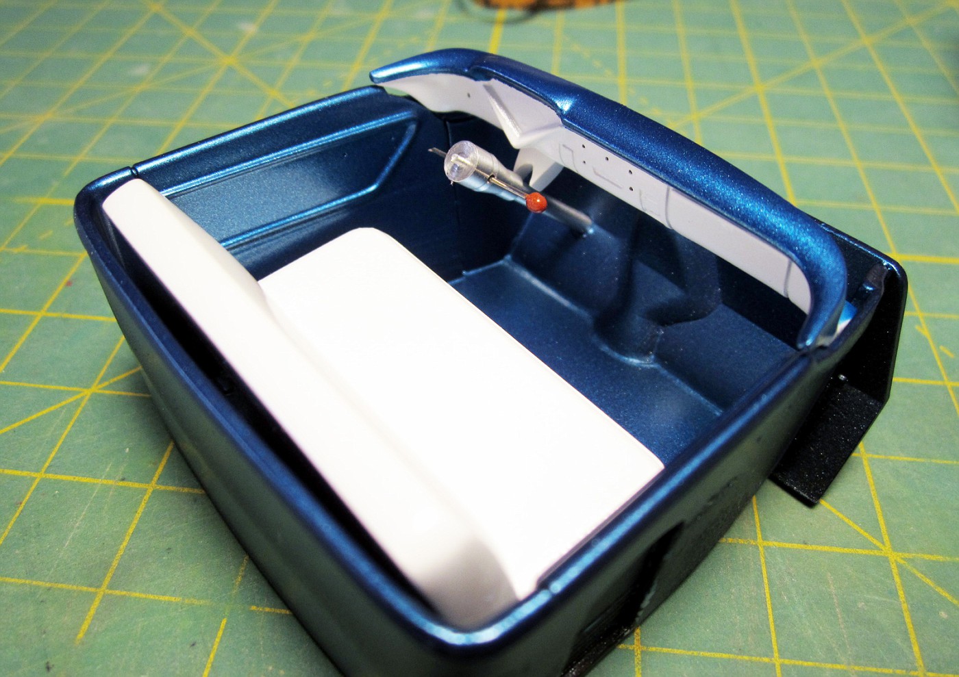

Here I stuck the steering column in to see how it looked with the color:
Outside shots:
Another one:

awsome progress !!!!!! :wub:

The blue and white looks great!   Nice choice!

Dave... Thanks bud... I really like the color combo. the color is a little lighter in person but was trying to shoot for a color close to the real car I took pics of.

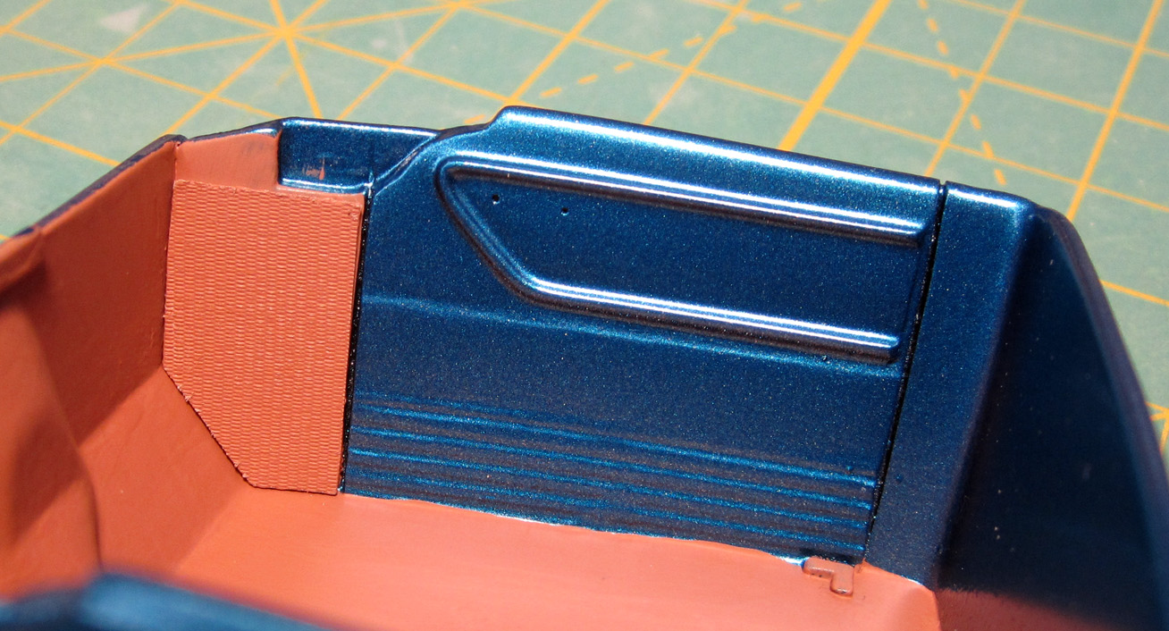

So I was able to make some more progress on this build today. I was able to get the kick panels made up and the floor painted and flocked.... and here is the results.

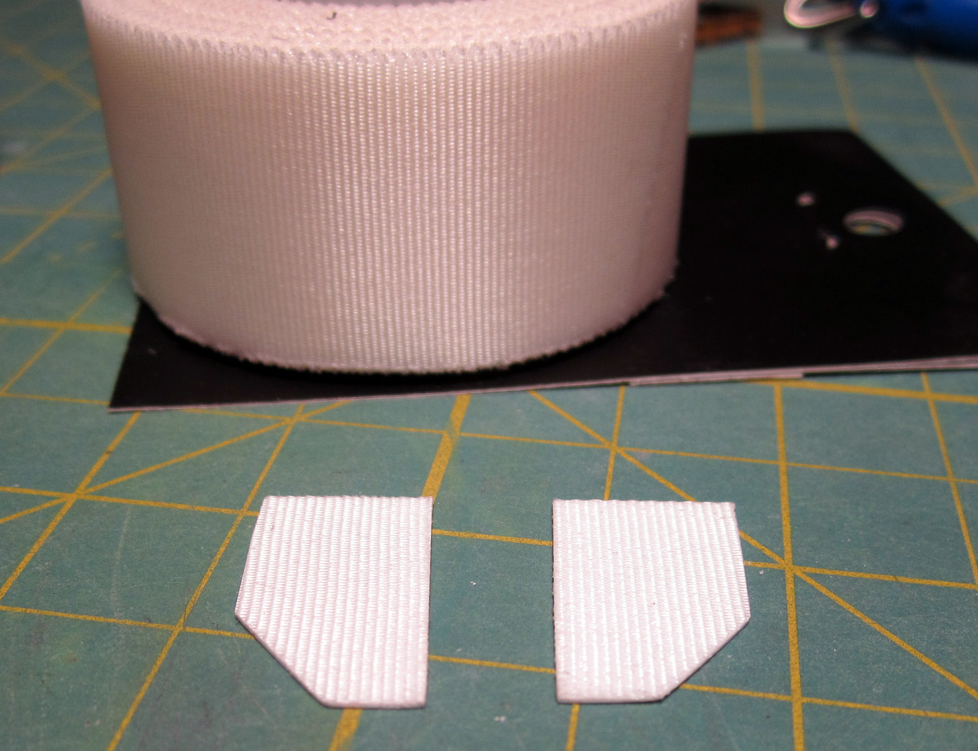

I started out with making the kick panels from .020" thick styrene and then I covered them with with medical tape for the pattern of the material:

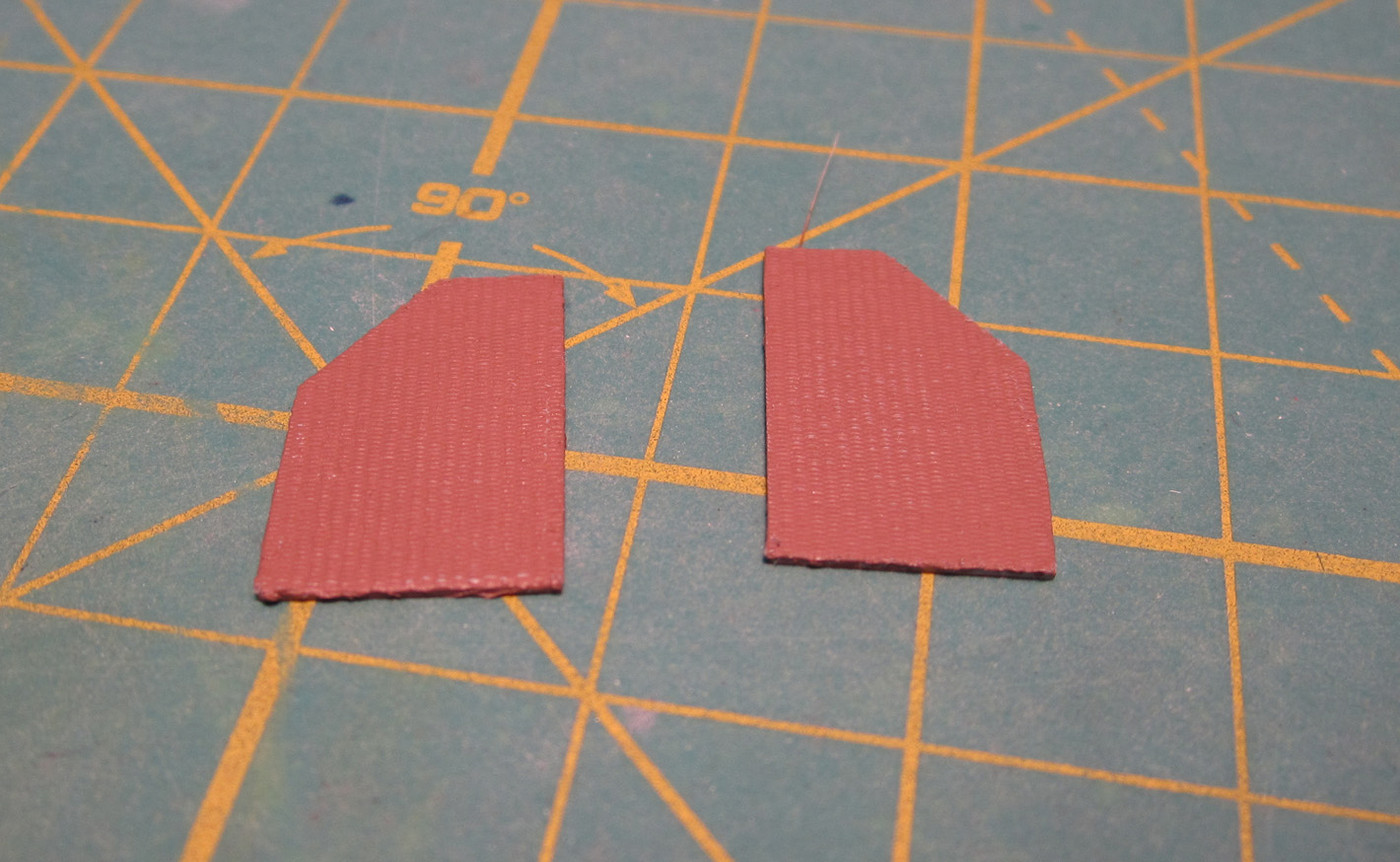

I next sprayed primer on them and then painted them with a brownish tan color:

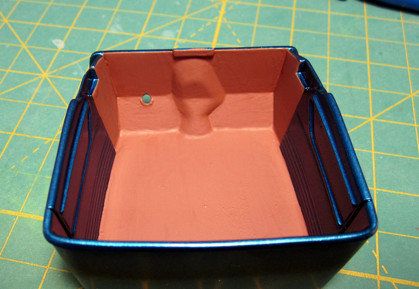

Then I painted the interior bucket with the same brownish tan for the base of the flocking material:
I then had to lay the kick panel in to see how it looked:

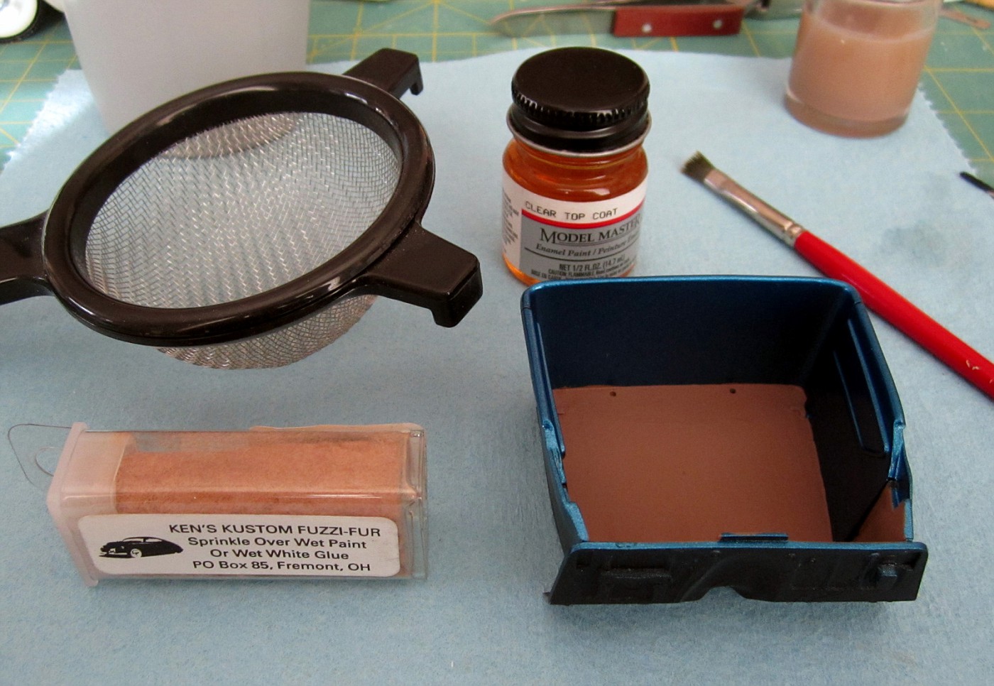

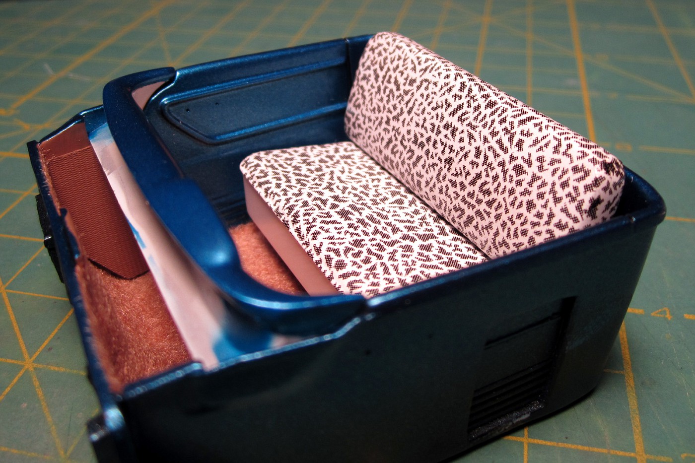

Here is all of the materials used for the flocking process:

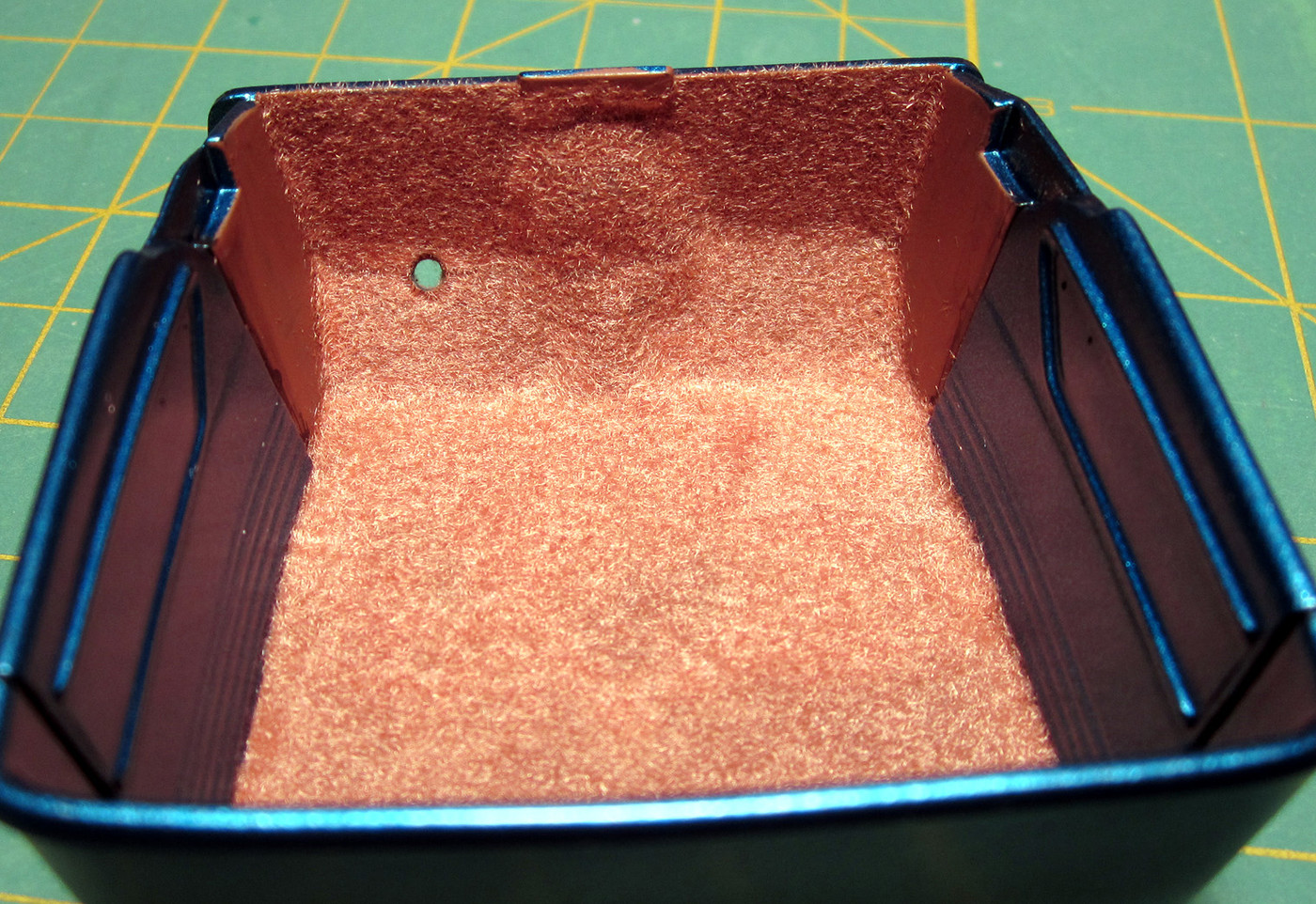

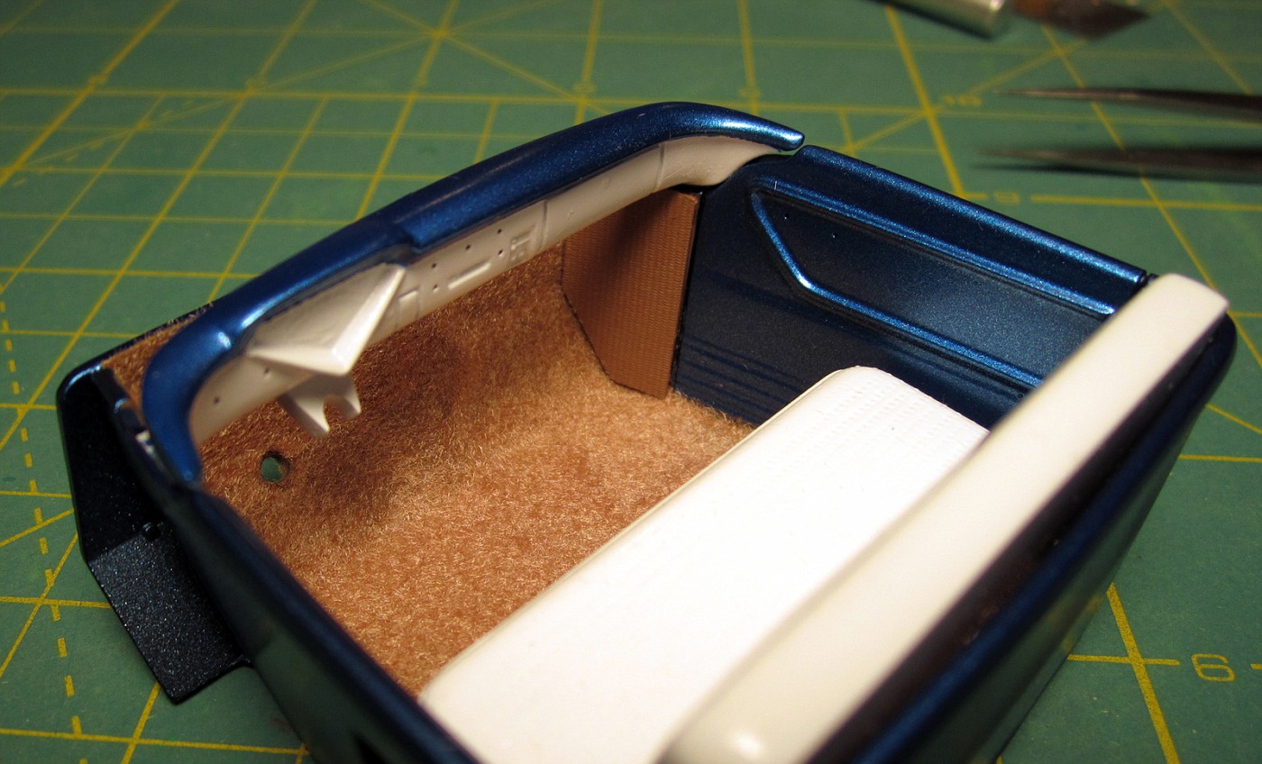

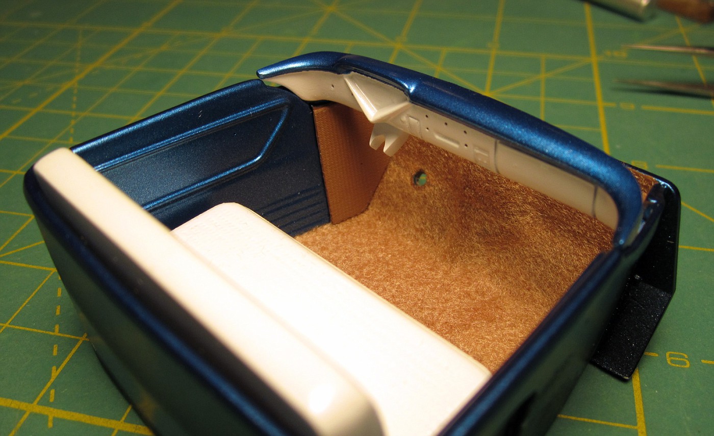

Here is the interior tub after flocking:
Here is the interior mocked up with the seat, Dash and kick panels:
Here is the view from the passenger side:
#57 Alyn
Alyn
  • 1,034 posts
  • Location:The Kansas Rockies
Posted 30 May 2013 - 01:30 AM
Chris, that blue and white is a knock out combo on the dash.
Very cool vibes

just stunning !!!

This is killer! I love that interior!

Very nice work as always, Chris! Looks like it doesn't matter what do you build, you do it perfectly! That interior is sweet, those colors fit perfectly together. I can't wait to see more.
