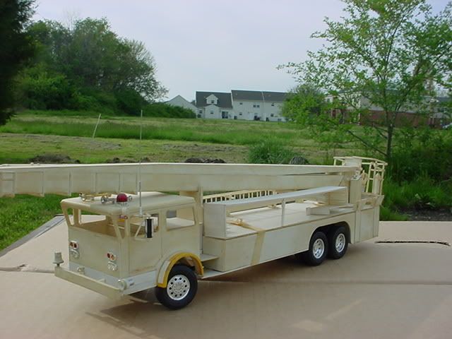

Evergreen sheet is you best bet. It's nice white sandable plastic.  You want the PLAIN packs.  It comes in different thicknesses and I have the .010", 0.15"  (really thin, almost like paper) and the .020", .030" and .04" in my stash.  You get 3 6" x 12" sheets in a pack, the last one I just bought at a local Hobbytown was $3.89.
For a camper shell,  I'd work with .030" for a first project. The .020" can flex if it's not supported with framing from behind on large panels. In the photo below, nearly everything in the photo was made from Evergreen. The body is the .030" and the part of the roof that bends over the top curve was made from the .020".
Per Shawn's advise above, figure out your piece on card stock. Much cheaper to make your mistakes there! Once you get it mocked up, transfer your work onto the plastic sheet and cut it out. See my photo above to see a mock up. To make sure your sides match, if I was to cut this from plastic, I'd tape two pieces of plastic sheet together and cut them out together. Even the cut for wheel well would be sanded to shape with the two sides together.
Hope this helps!
